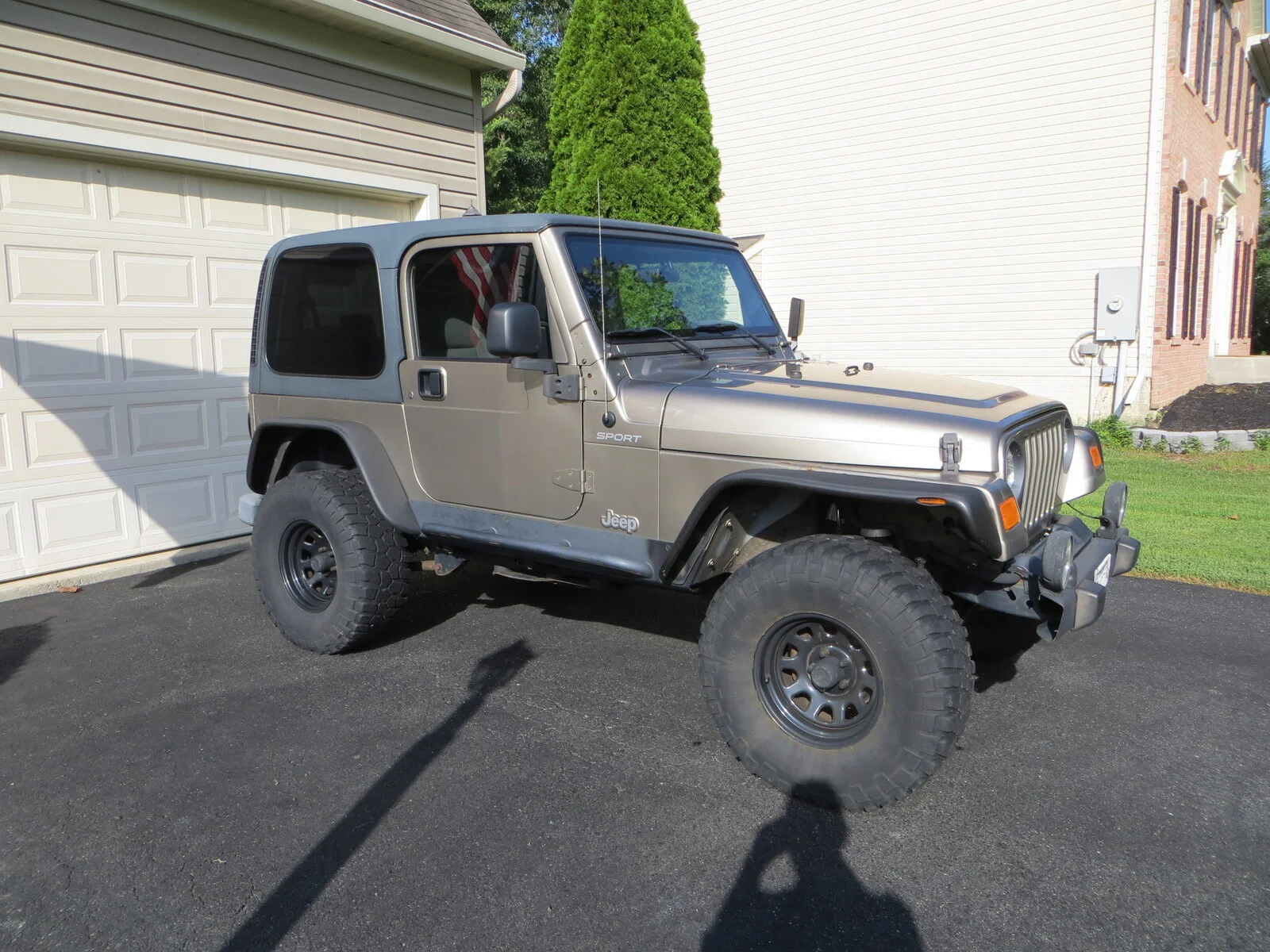

Picked up this 2005 TJ Sport in March 2007 with 23k miles on it. My wife (GF at the time) always was giving names to things and this Jeep was no different – Upon seeing it that first day, she named him ‘Homer’ and it has stuck ever since.
At the time, I was still in college so upgrades and mods were done on the cheap and in very incremental stages.
Started off with a 1.25 JSK BL.
I can not say enough about how much people need to AVOID this and similar product. Now removing it during this latest build upgrade, I have found tub damage from the JKS BL flexing, collapsing Body Mount Brackets. Just a terrible product. (I can share if there is interest)
After the BL, Homer got a BB rubber puck suspension lift and 33’s.

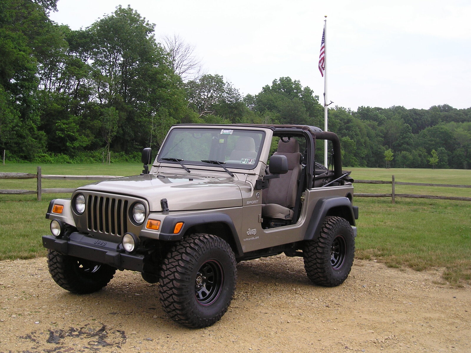

Not long after, flat fender flares (Xenon brand) went on which completed his look for pretty much the past 10+ years.
The Jeep rode in that shape for over a decade with several trips to Rausch Creek in PA and Big Dog in VA. During that time, Homer did receive many upgrades along the way. Such as:

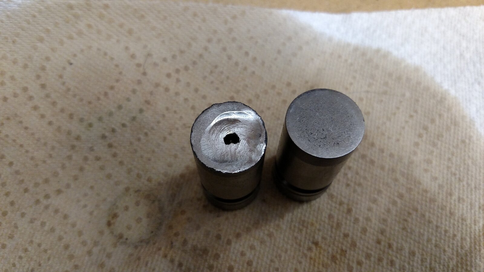

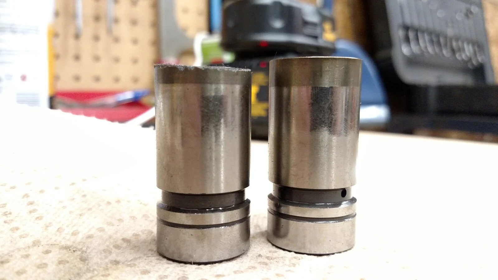

At 122k, Homer went into a rough engine condition while driving home from work. He felt like he was missing a cylinder so I tore into the valve cover and, based on a Jeep mechanic buddy’s advice, I tried break loose the cylinder 6 valves with a deadblow as they weren’t operating and it’s an issue on older I-6 engines.
Well, that wasn’t the issue….
Dealership never broke in the new flat tappet lifters so this one just wore down and final bled out.

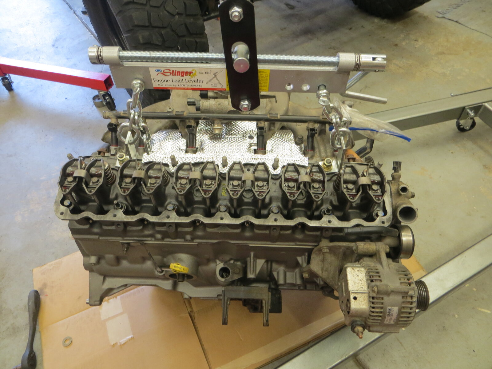

So I ordered an assembled long block and went to work. Engine came out, swapped over what was still good, upgraded a lot of the moving components at that same time. Cleaned up a lot of the wiring loom, new clutch, Novak NP231 cable shifter, ball joints… Home was down and torn open so a lot of little things got worked on, too.

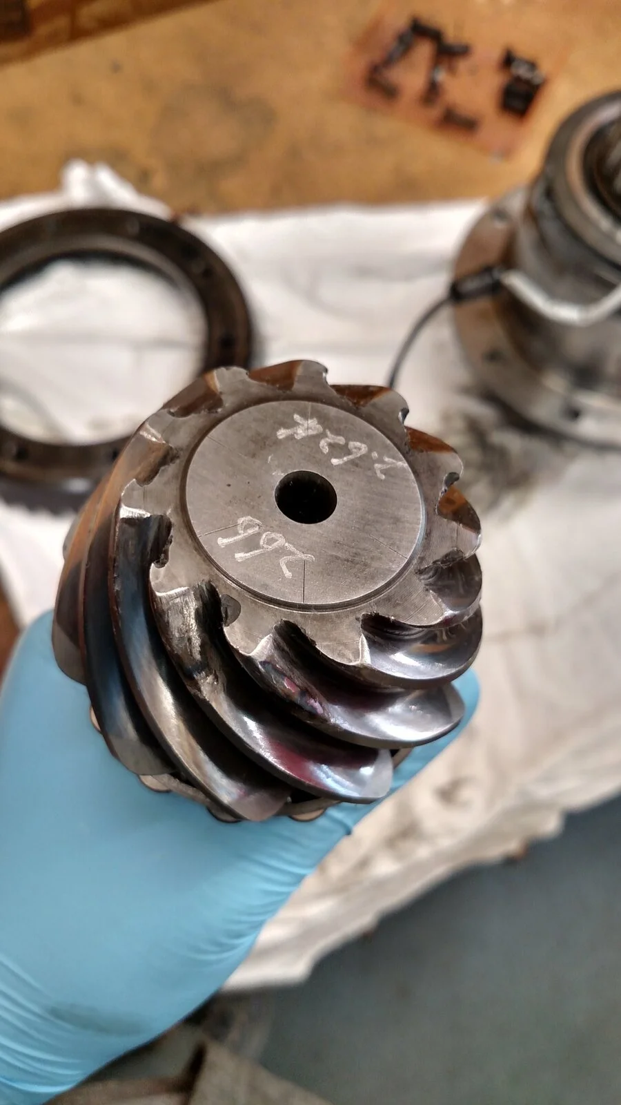

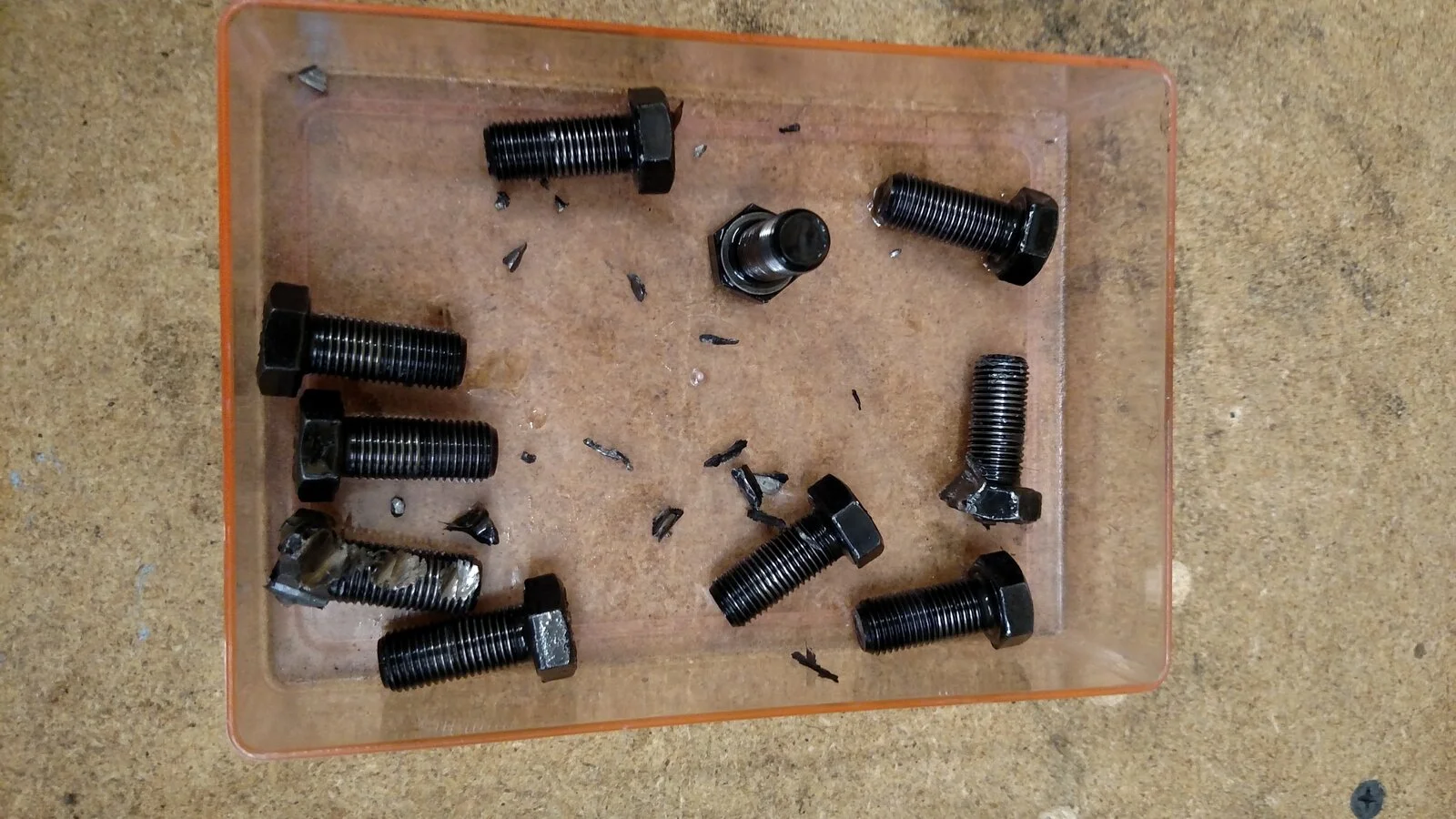

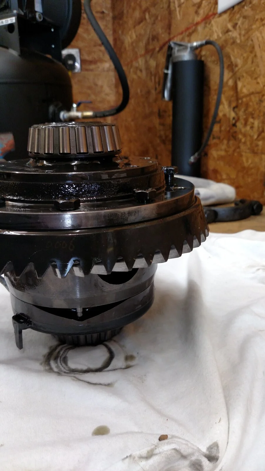

Fast forward a couple months after the engine went back in and Homer was drivable again, I started hearing a clunk in the rear end.
So, I tore into it and couldn’t believe what I found:

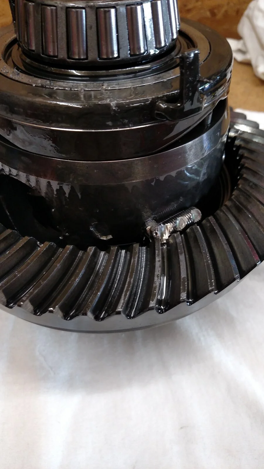

The ring gear bolts had backed out…. At this point in our lives, wife and I had 2 vehicles and each had a day jobs in opposite directions. So, I needed Homer back on the road quick. So I picked up new ring gear bolts and (using a wood clamping workbench bc my vise wasn’t big enough for the E-Locker) I put in new bolts. I cleaned it out the best I could and put the diff back together. 30k miles later – the gears haven’t exploded. BUT – I haven’t been off-road in that time too…

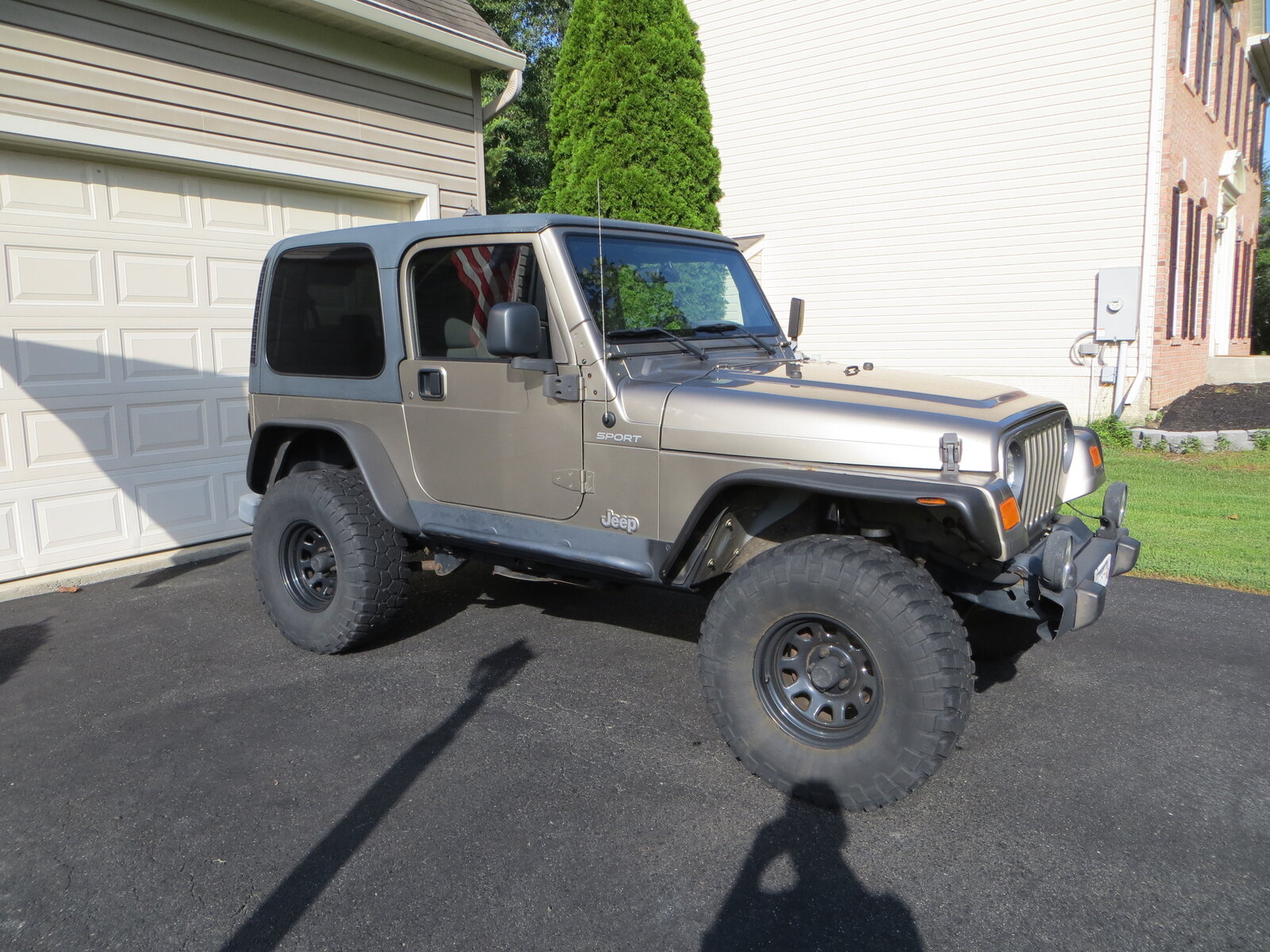

Starting Feb 2021, I started tearing into Homer for a well overdue build and upgrade. Like all good builds, I started with one plan, bought parts for it, and then changed my plan as I got into the build, and so I bought new parts.
Here’s Homer the day he went into the garage in 2021.

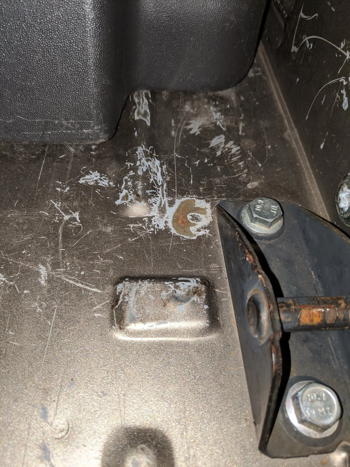

Nice rig! Excited to see how this one goes. I am interested in seeing the tub damage from the BL though. I've heard stuff about the JKS lifts but have no idea how to ID them.
Thanks! He's been a great Jeep!

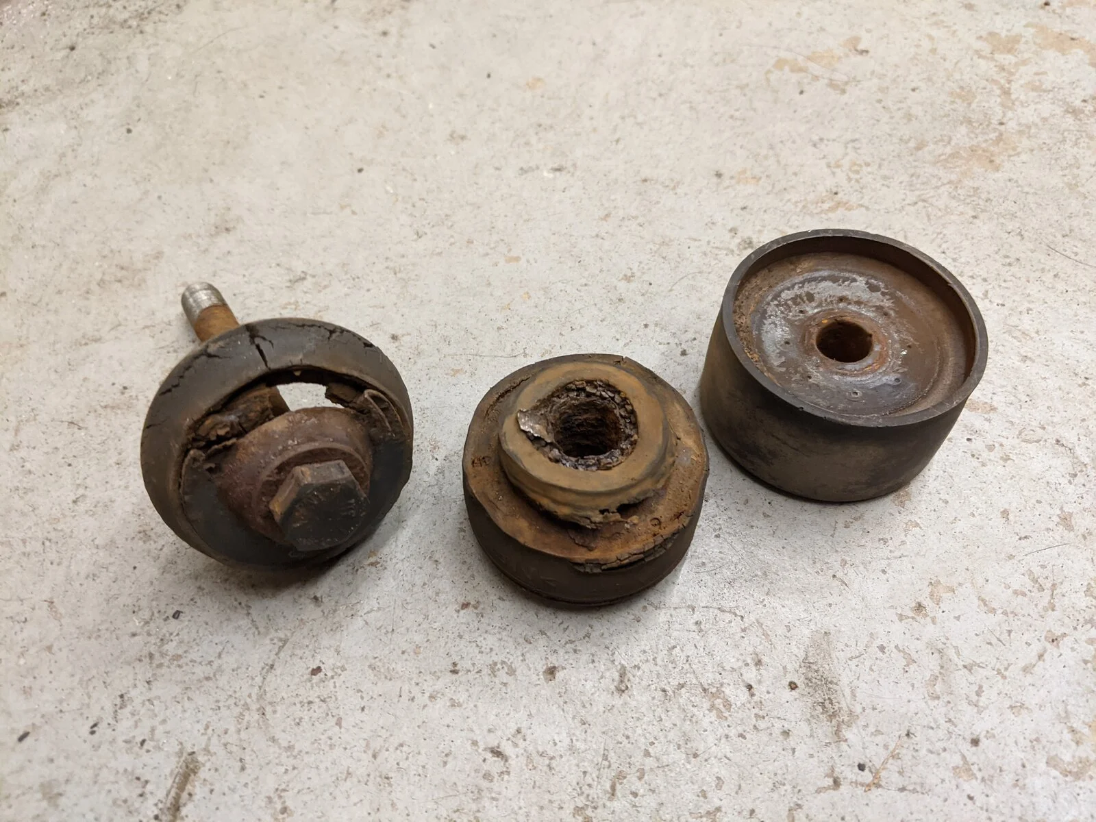

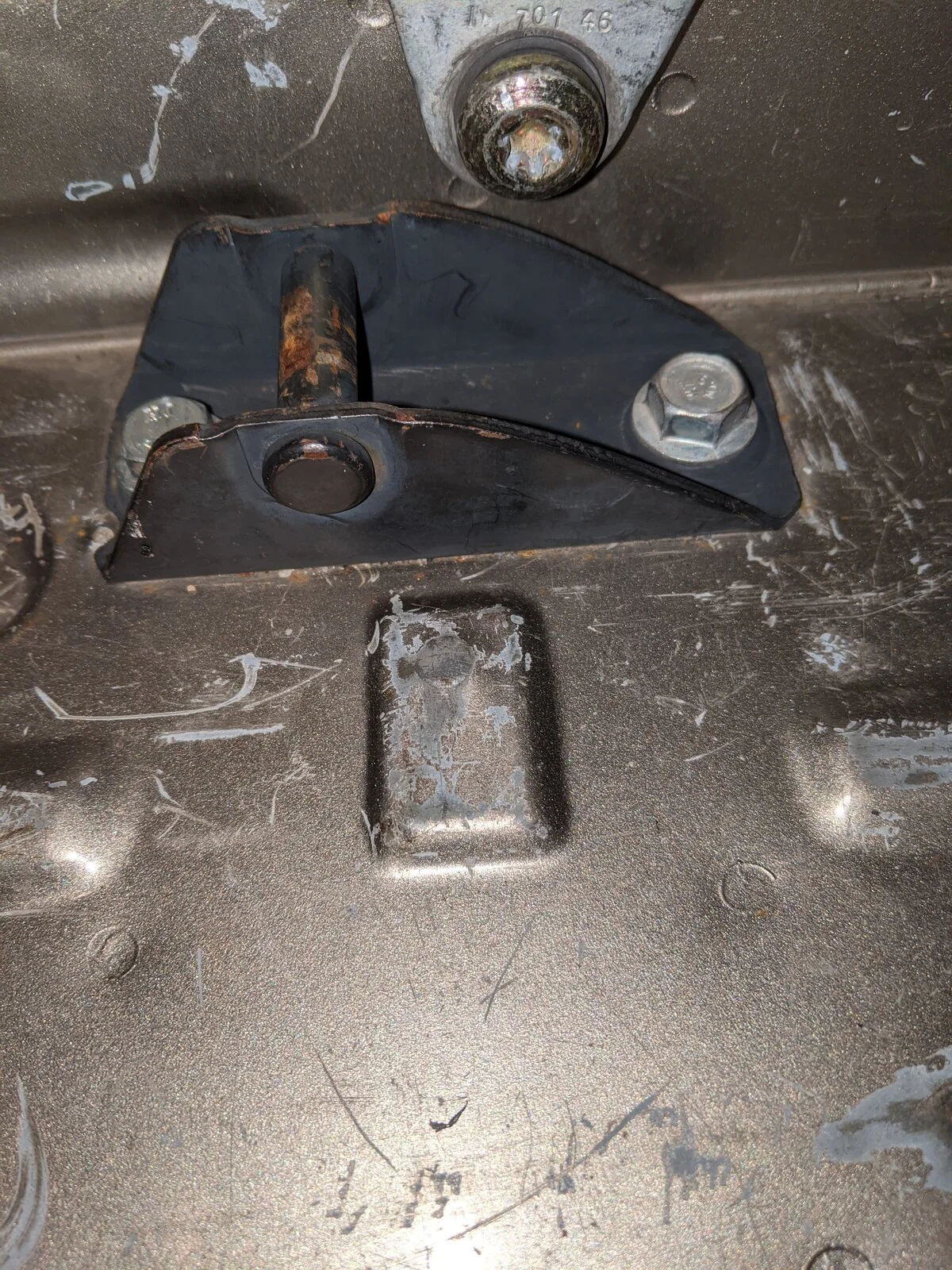

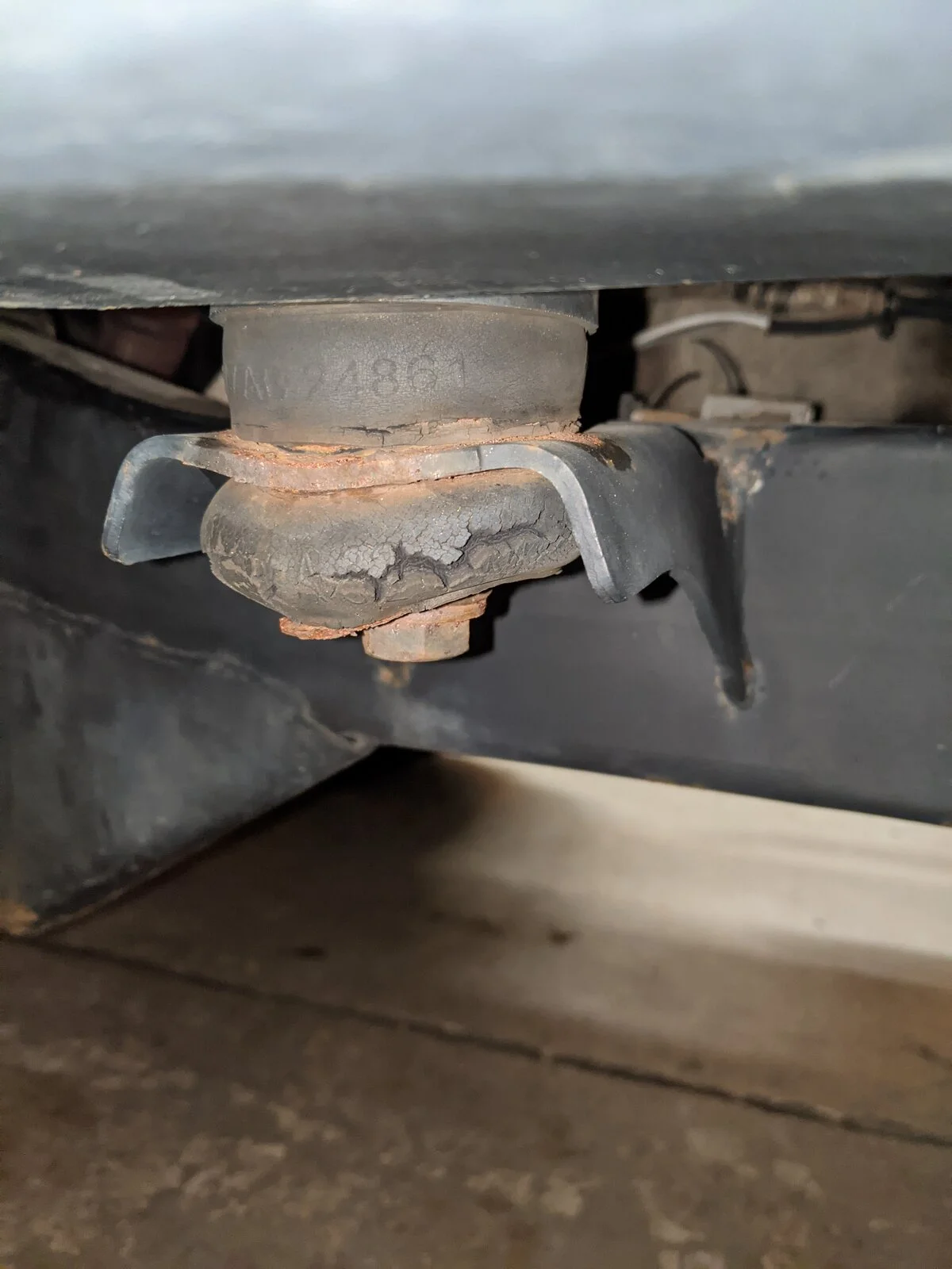

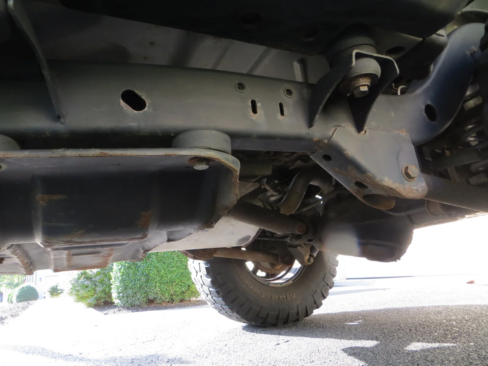

JKS BL Damage:
Rear pucks collapsing and allowing bolts to hit tub:
1.25" pucks measured under torque:
That's after 10-ish years being installed.
Not sure why this body mount would deform other than a bouncy house living above the solid body mount...

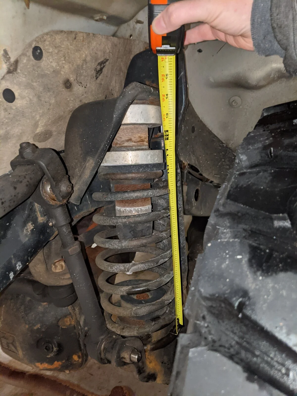

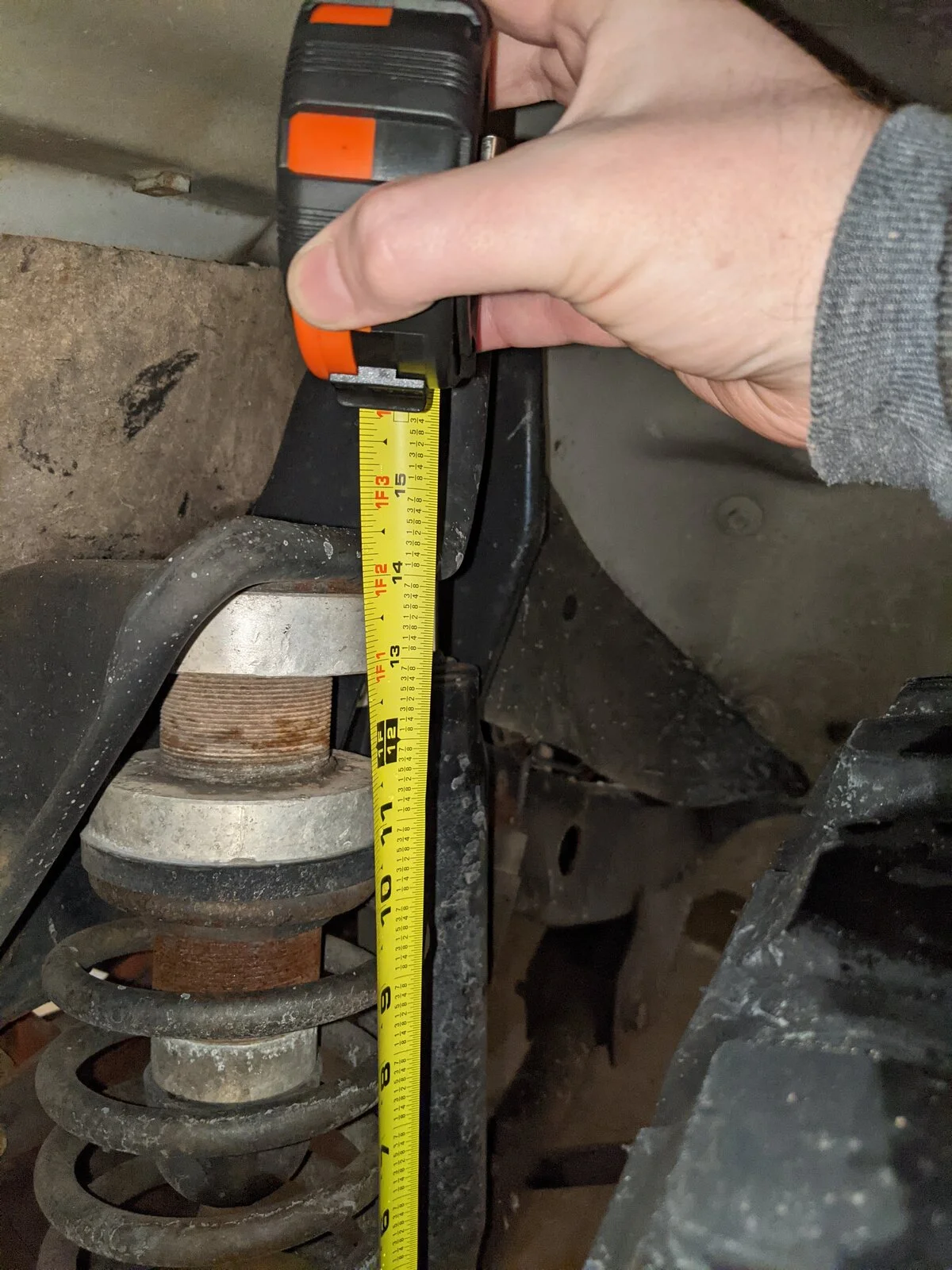

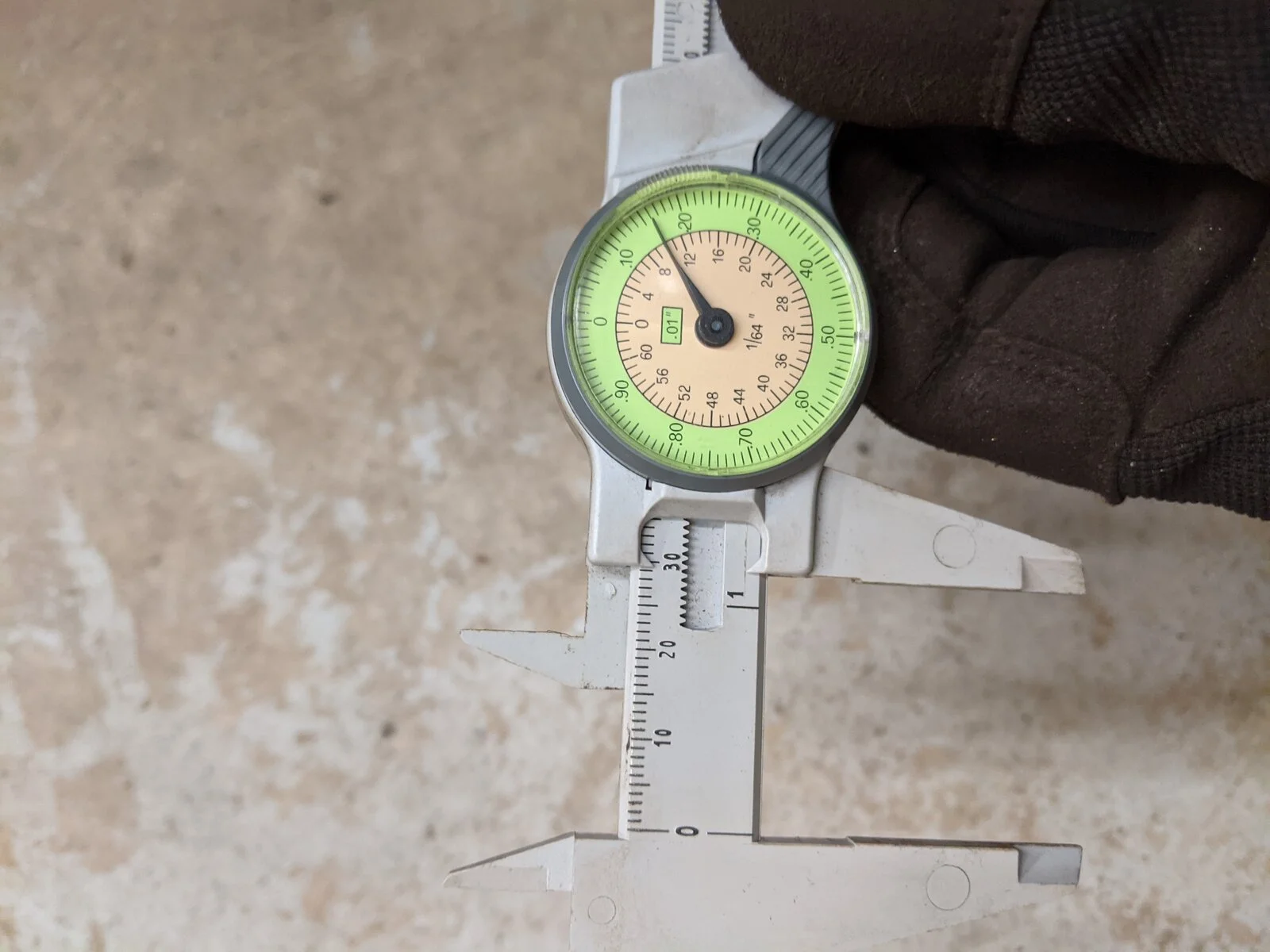

I measured several of the JKS BL pucks as they came out of the Jeep after a decade-plus:
That caliper measurement is of the JKS puck.
Pucks settled around 0.10" each...
I don't have a before photo of the torque box damage I've been repairing (Check out my recent posts in the 'What did you do to your TJ today?' Thread and I can post updates here as I catch up on the build) but I believe the 'spring' effect of the JKS pucks caused damage both to the mounts and the torque box.

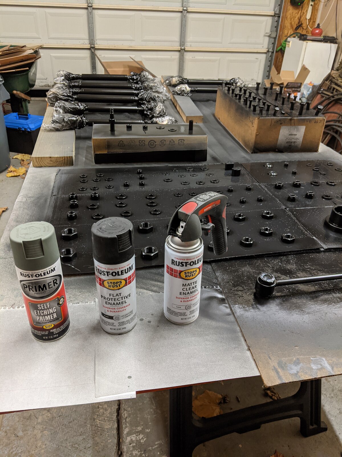

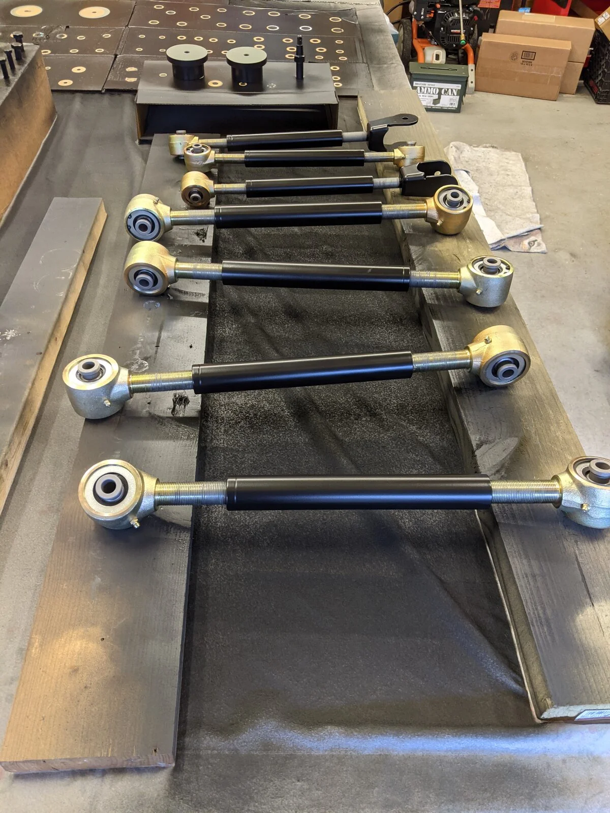

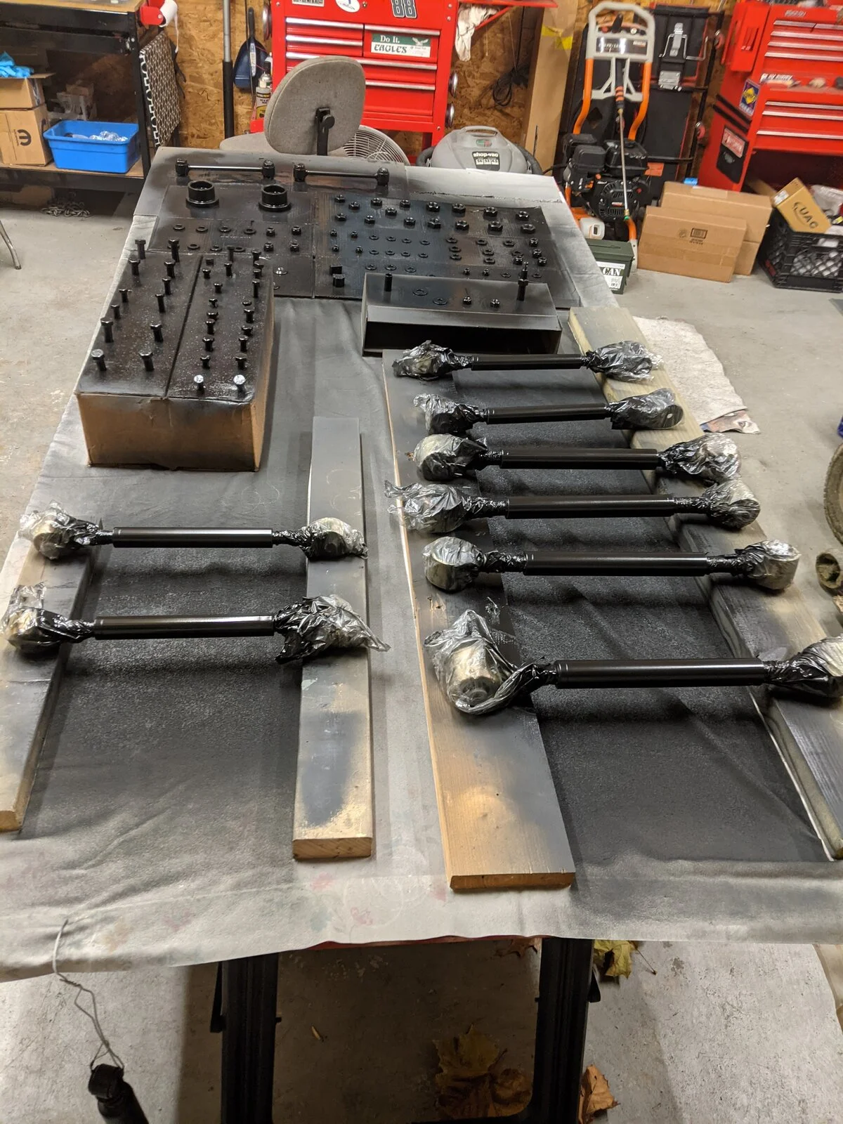

Before I tore Homer down, I got to painting some of the parts I had started accumulating.
I ordered a Savvy 3" lift kit, expecting I was going to stick with 33s. While some like the aluminum raw, I'm a fan of the black-on-khaki look on my Jeep so as much of the parts that can get painted black will get painted.

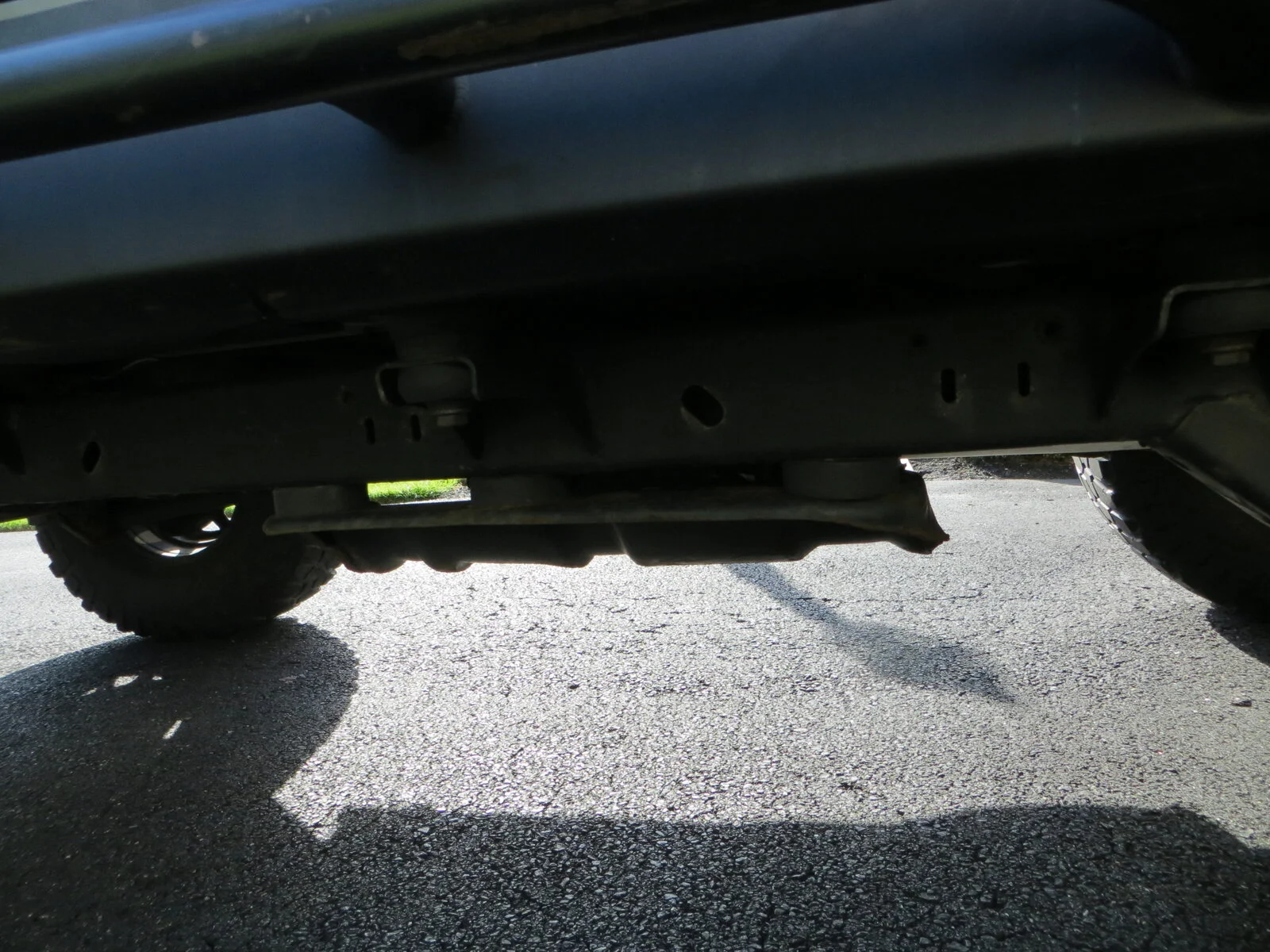

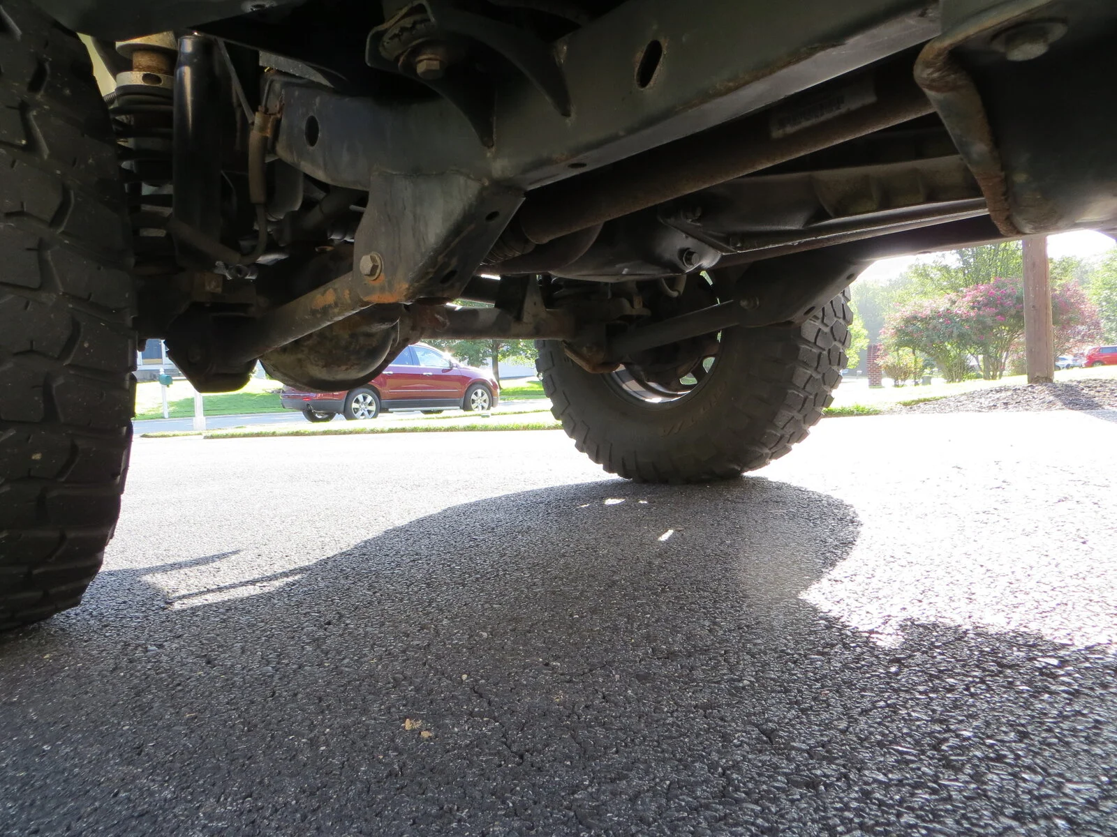

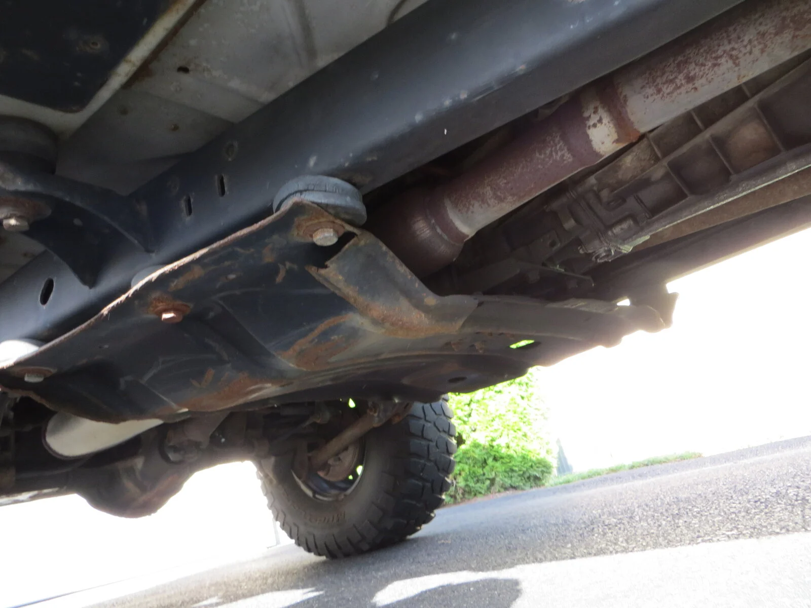

I've been lucky that the frame has been in good shape (surface rust only) and I've hit it with Rustoleum a time or two during his life to extend the frame's life. Living the rust-belt/salt life...
Surface rust around some of the factory welds. Early on in my ownership, I did drill a few additional drain points around the low-points that typically rust out.
I have picked up a scope camera that I still need to run through the frame inside. I feel blessed that the frame is in this condition, even if it need some work. My going-in plan was to paint the frame with flat black Rustoleum and matte clear coat Rustoleum before Homer left the garage (plans have change that in the priority list - so I'll get back to that plan to wire wheel and paint)
Status when it went in the garage:
I've hit the area where the TC touches the frame multiple times (every time the skid is off the frame) with Rustoleum. It's a surface rust breeding ground... Solid to date.

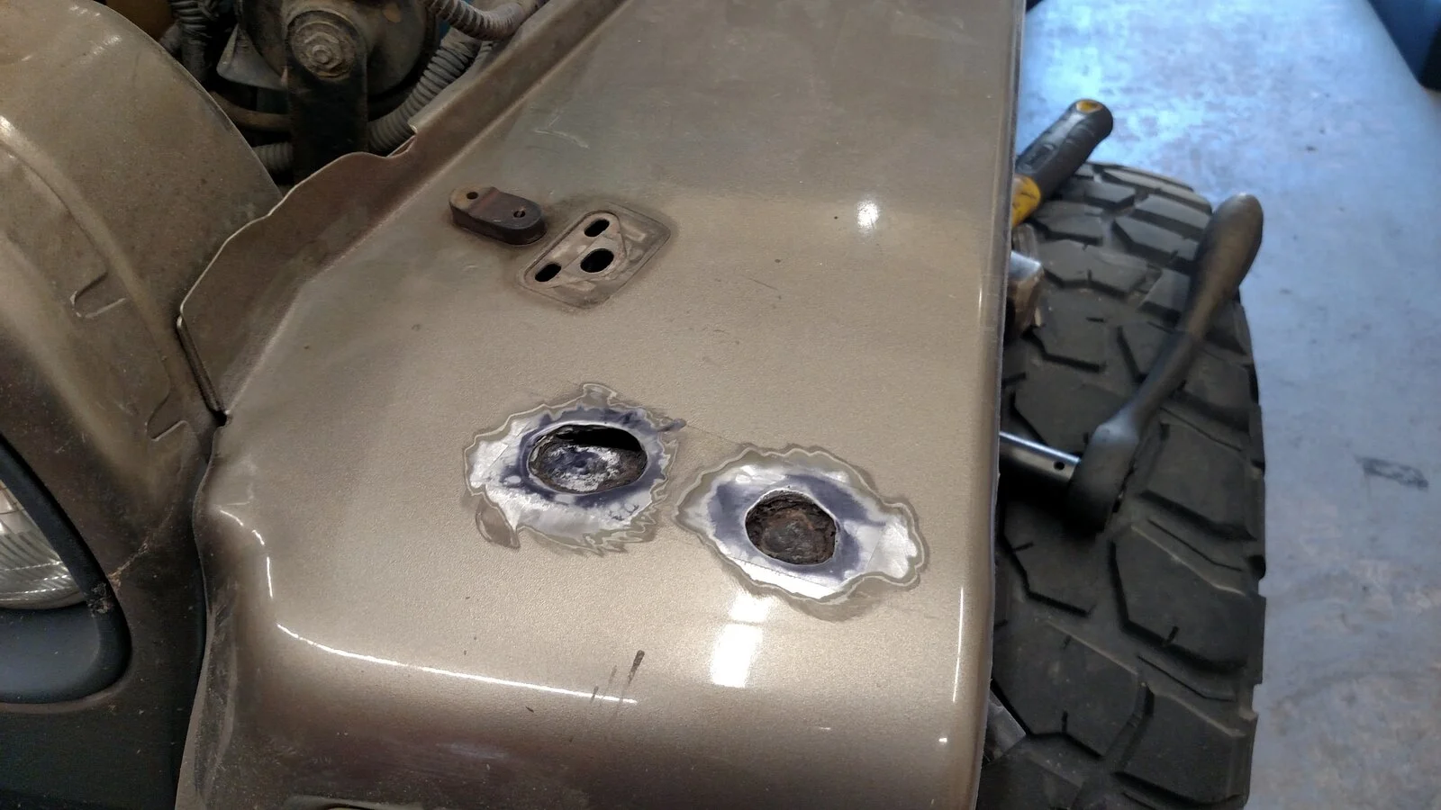

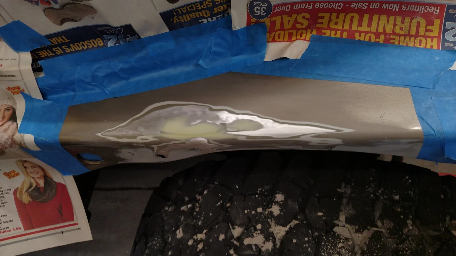

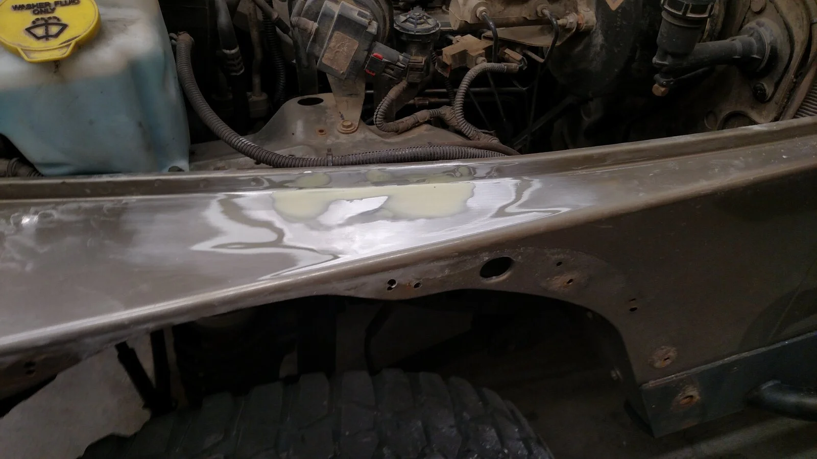

In 2017, Homer showed some obvious rust damage on both front fenders.
As I mentioned earlier, I auto body work in one of the few automotive activities I loathe as a shade-tree mechanic. Welp, I had a decision to make in repairing this damage:
1) Repair the damage with Bondo and paint the repaired areas
2) Buy a welder, repair the damage, paint
3) Turn it over to a body work shop
Option 3 wasn’t going to happen. While I hate the tediousness of auto body work, I want to get better at it to be serviceable as I can’t turn over every rust spot to surcharge service for the rest of my life…
So I decided to save the funds that would go into a welder and try the Bondo route. So I purchased the recommended 3M abrasive brushes, grinding bits, sanding blocks, etc to get the right tools in hand.
“Maybe if I have the right tools in hand, I won’t mind auto body work…” I thought to myself. And off to work I went…
I found myself somewhat enjoying the job and I felt good about the final product. Unfortunately, I can't find any pictures of the final painted product but I promise it definitely met the 10-ft standard.
I was upset after purchase (and needing to use them immediately) that the paint & clear coat I purchased were water-based color coat so it couldn't be wet-sanded... Ugh. But I was happy to have the repairs looking like 'decently matching' painted areas again. Better than rust.
Don't forget what I said about my feelings on auto body work...
Not that using bondo on a rust hole is a great idea but if you knock the hole down first it takes longer for the rot to reappear. Lil somethin i learned patching up rotten cars by the ocean for financially challenged peeps who needed the leaks to stop.

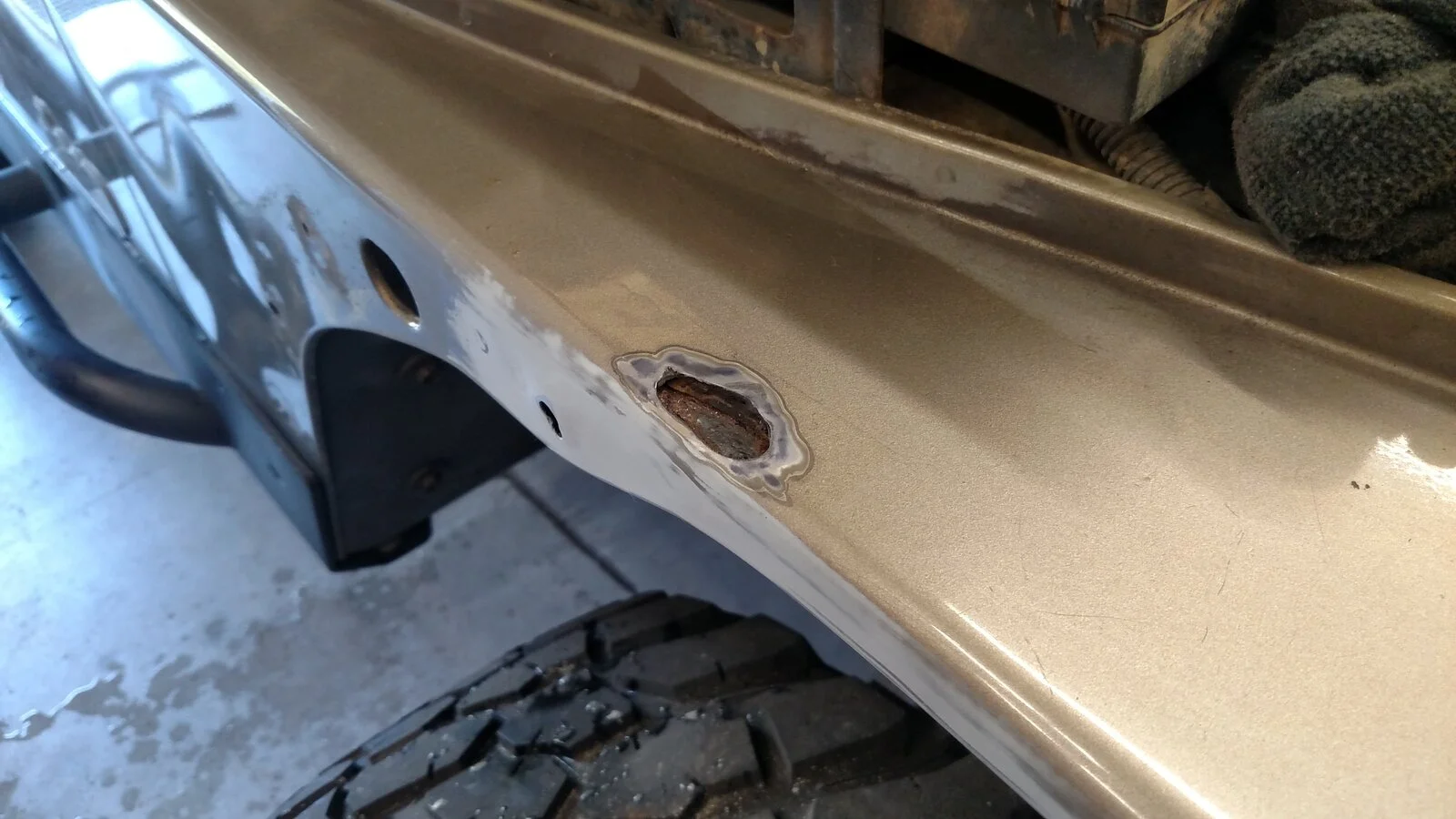

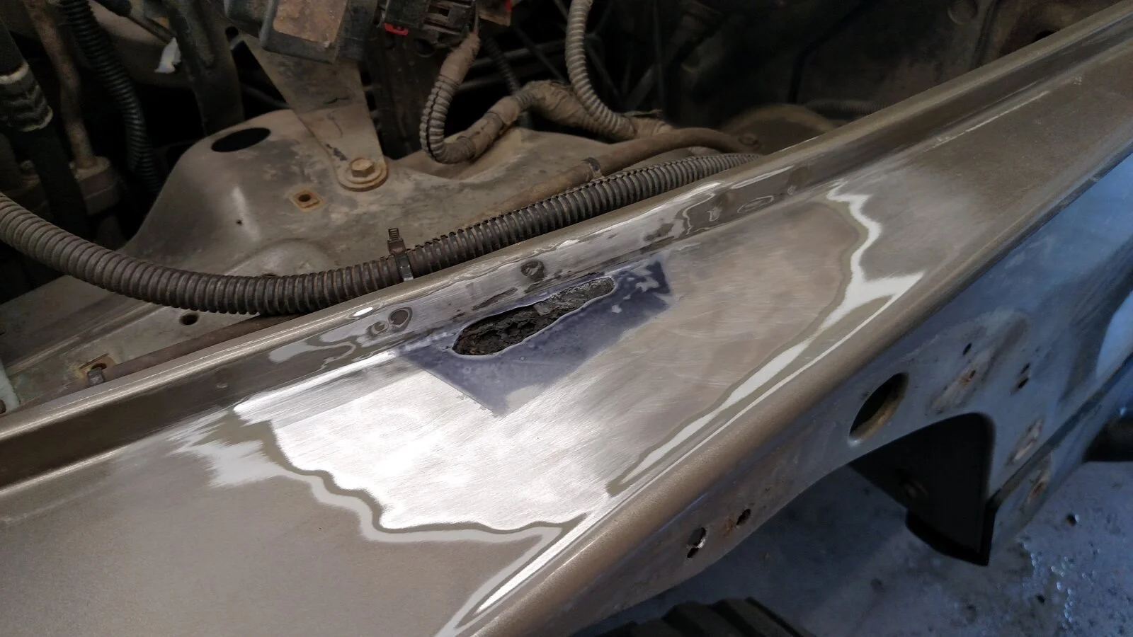

Three years later, it was obvious I hadn’t removed the cancer so it started to show up around the Bondo that filled the ‘repairs’ I attempted.
Upon new inspection, it was clear that the passenger fender rust was way deeper ingrained than the small rust I tried to repair. This is a shot looking up in the wheel well just below that last on the fender top I tried to repair.
I already said it – auto body work ain’t my thing… Still much, much to learn. Clearly.

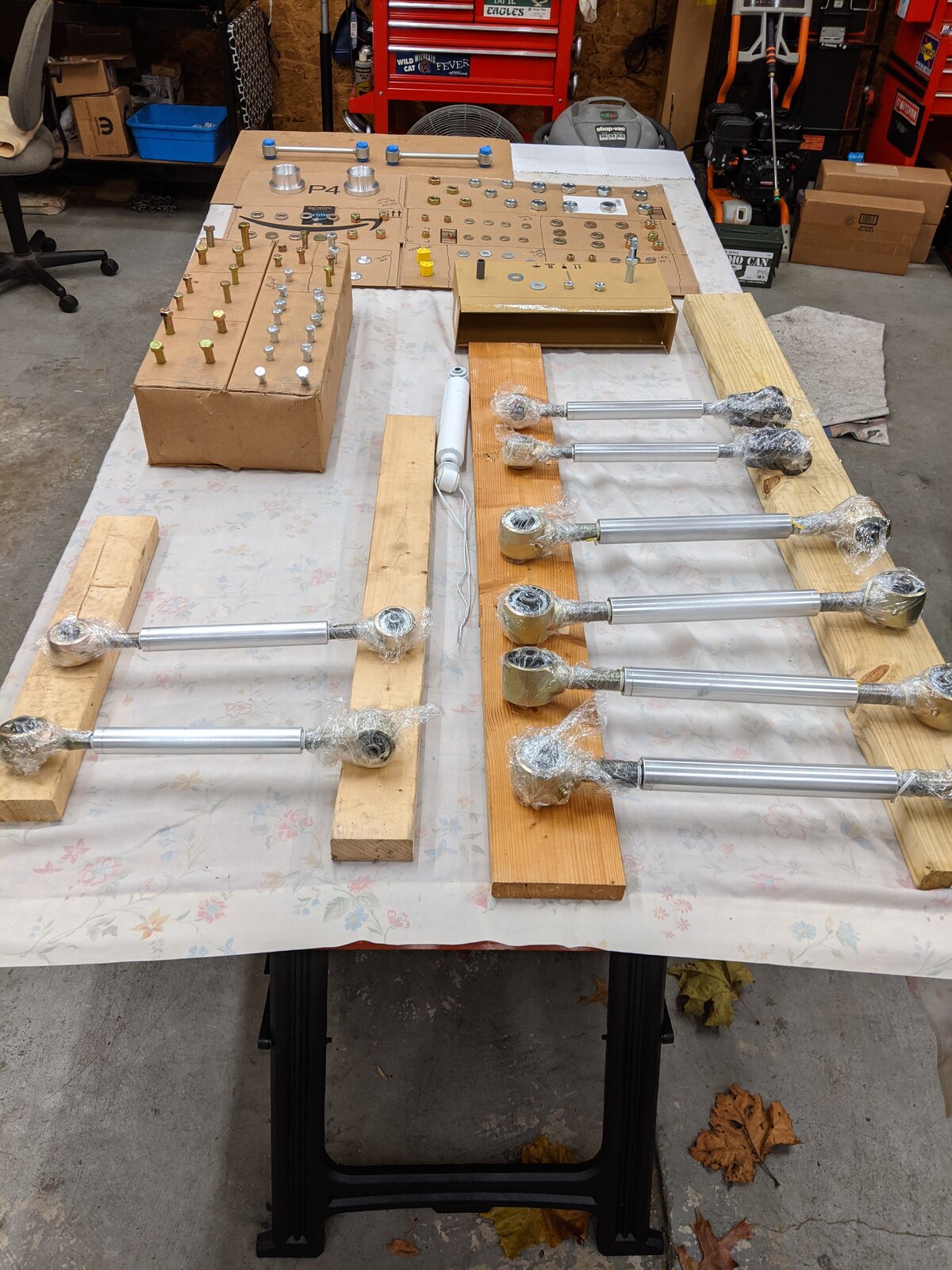

Spent a good bit of time getting parts together before I tore into Homer. I figured I'd get it all done at once....
That's not working out to well. In a rush now to get the Jeep driving and through emissions testing before registration is suspended in August.
All the parts will go on, this just isn't going to be a 'one-and-done' teardown.
