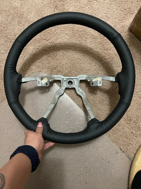

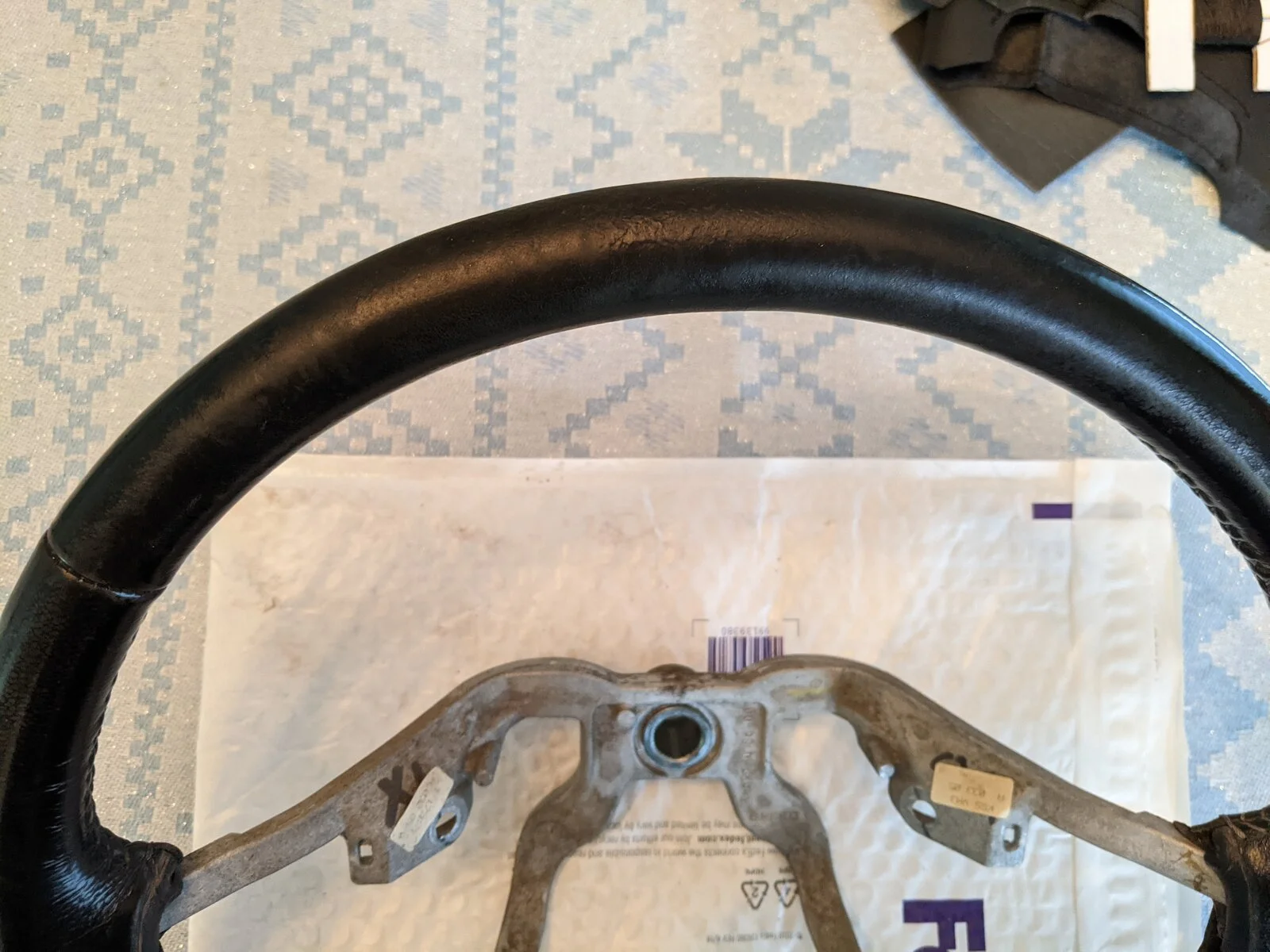

During the midst of the teardown, I also pulled off the steering wheel as it was worn down at the top of the wheel where I typically hold the wheel.
You can see the leather breaking down here, added texture at the top of the wheel.
You can see how the stock leather spin on the wheel over 150k miles...
Used Redline leather and their install service (pic from Redline after they installed the new leather):
Excited for the new wheel once he’s drivable again.

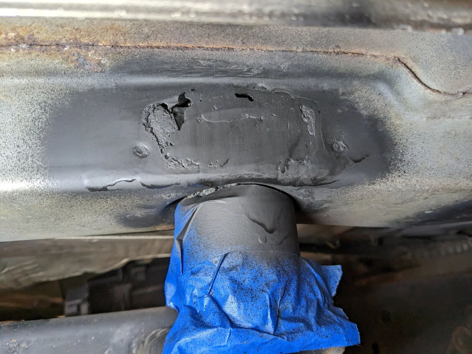

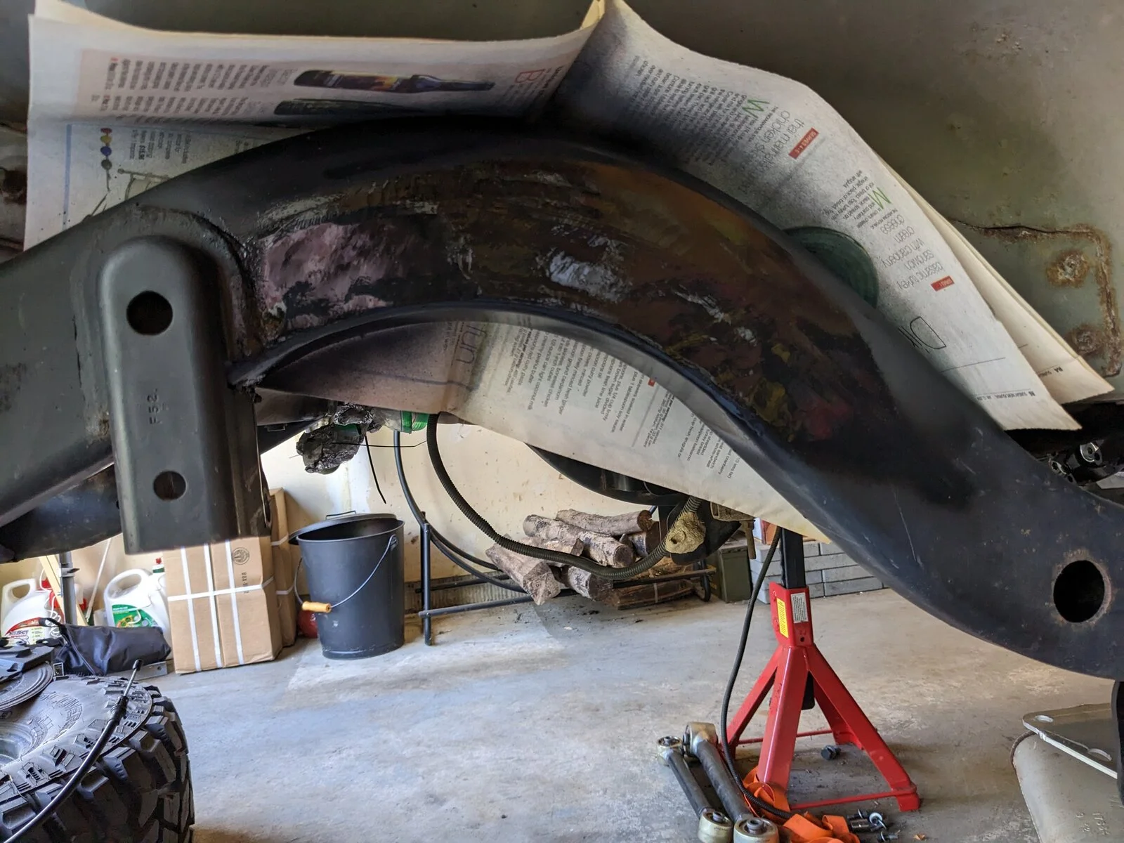

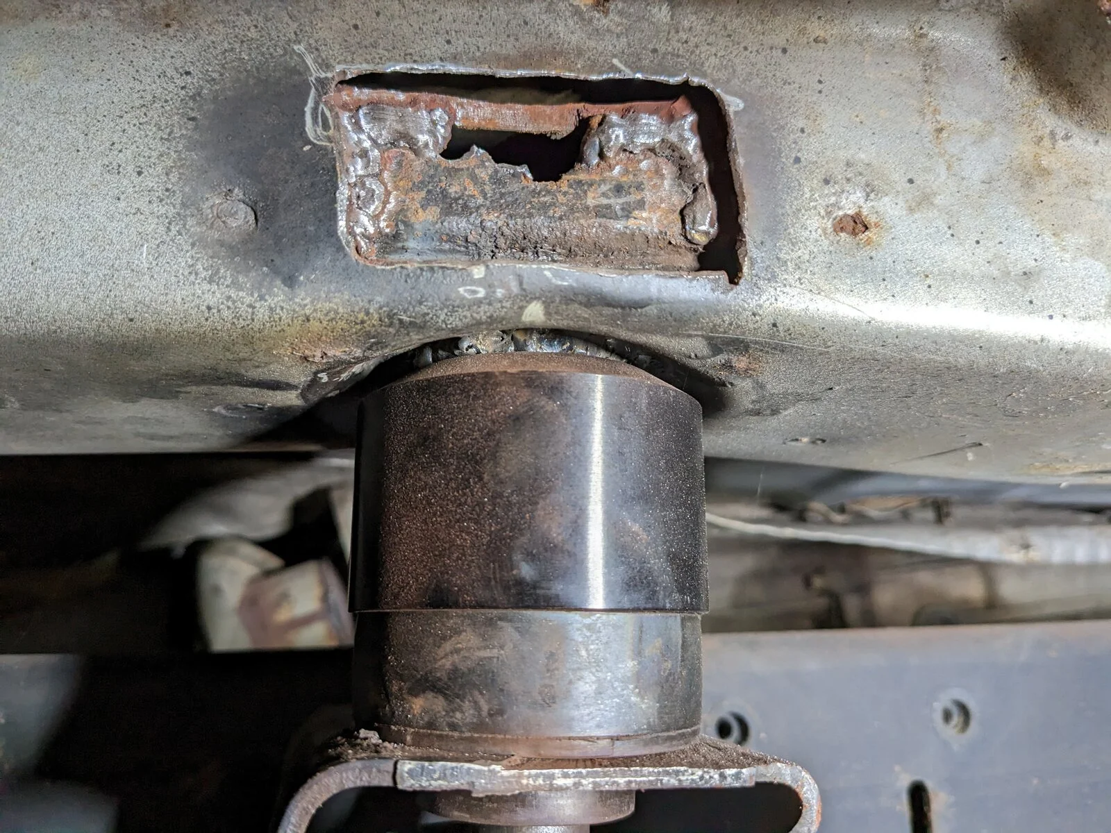

The garbage JKS BL lift product let the body flex too much and one of the results as the torque box cracking above the middle body mount on the passenger side. So, I wanted to repair it before getting the Jeep back on the road.
While the boys were in the hospital, I started cutting the rust out and welding the repair. That’s about when I stopped progress on Homer. My restarting point was to get that area reliable again.
At this point ‘good enough’ on bodywork became the de-facto position. I WILL return to the repairs but I need good-enough that damage won’t increase (outside of existing rust doing it’s job further).
Grind, weld, grind, weld, add material & weld, grind, weld, etc.
You can see that as I welded (especially on the left) that more rust exposed itself that must be removed. As you saw in my earlier bodywork, I didn't remove the cancer enough then on that spot...
I know I need to remove the cancer here but I don't have time to get the Jeep through emissions or risk losing my registration, which would require a new safety inspection and registration fees... So, good enough repair, knowing I'll return.

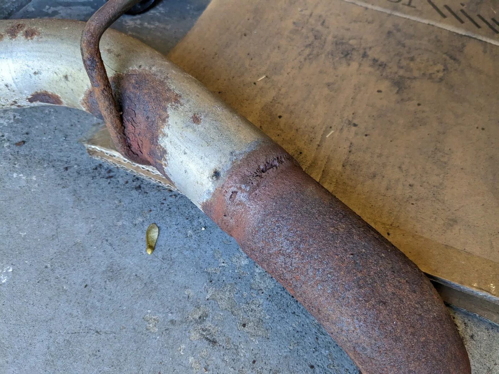

With that wrapped up, it was time to turn back to the TT, so the exhaust packet needed to be modified. Recommendation seems to be 1" so I went with that in welding up the mount.
UCF Aluminum TT going in. I previously (pre-kids) did a dry fit of the TT but the exhaust wasn't an issue because I still haven't re-hung the exhaust after replacing the manifolds.

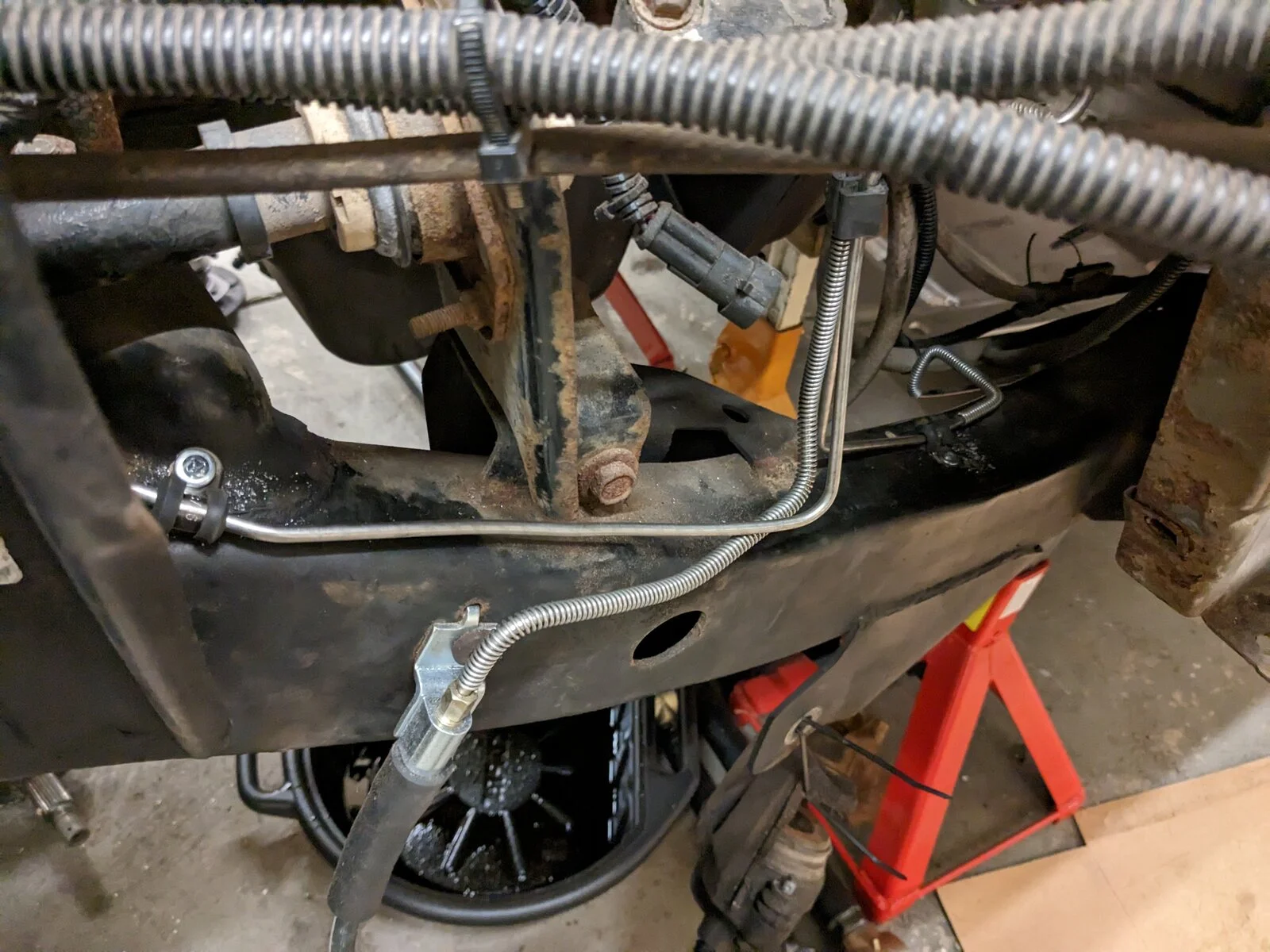

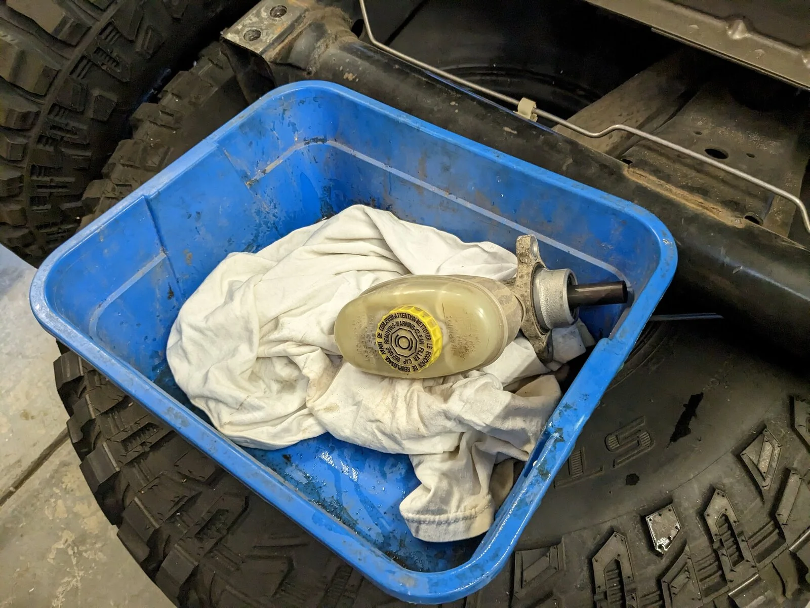

Time to get the brake lines in.
Pulled the master cylinder to bleed it before filling the lines once the axles go under the Jeep again. @mrblaine was able to set up me with a set of plastic screws to match the line ports to help with the bleed.
I picked up SS lines from Classic Tubes and all new softs lines front & rear. Even through I ordered the right kit for my setup, the rear lines on the axle didn’t match up to the stock setup so I picked up a set from Crown.

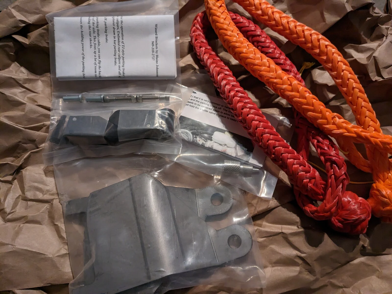

After that, an order went into the BMB for some new upgrades I decided to go after while the axles were already out.
  • Sway bar brackets for tie rod flip
  • Parking brake reverse kit (install in prep for a future outboarding)
  • Brake bleeding lock-out tool
  • Added a set of soft shackles (since I was already ordering parts and their a great deal from WRG)

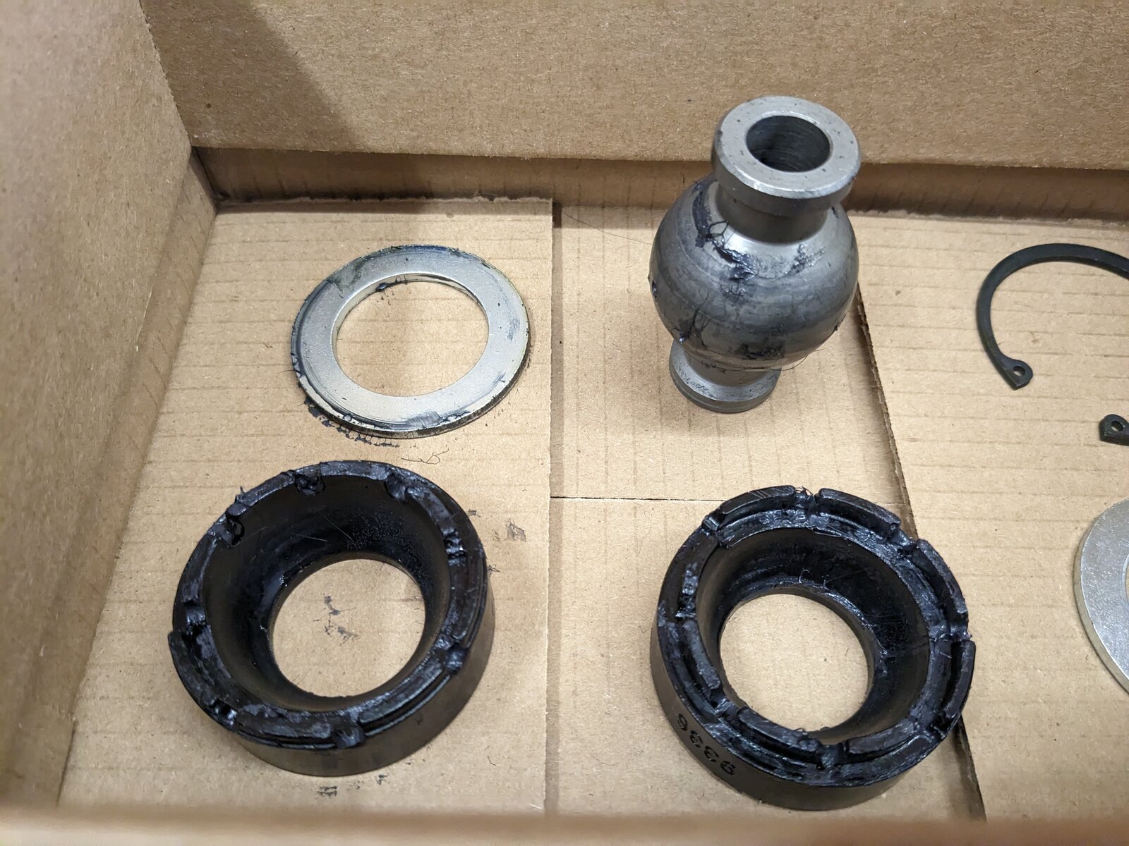

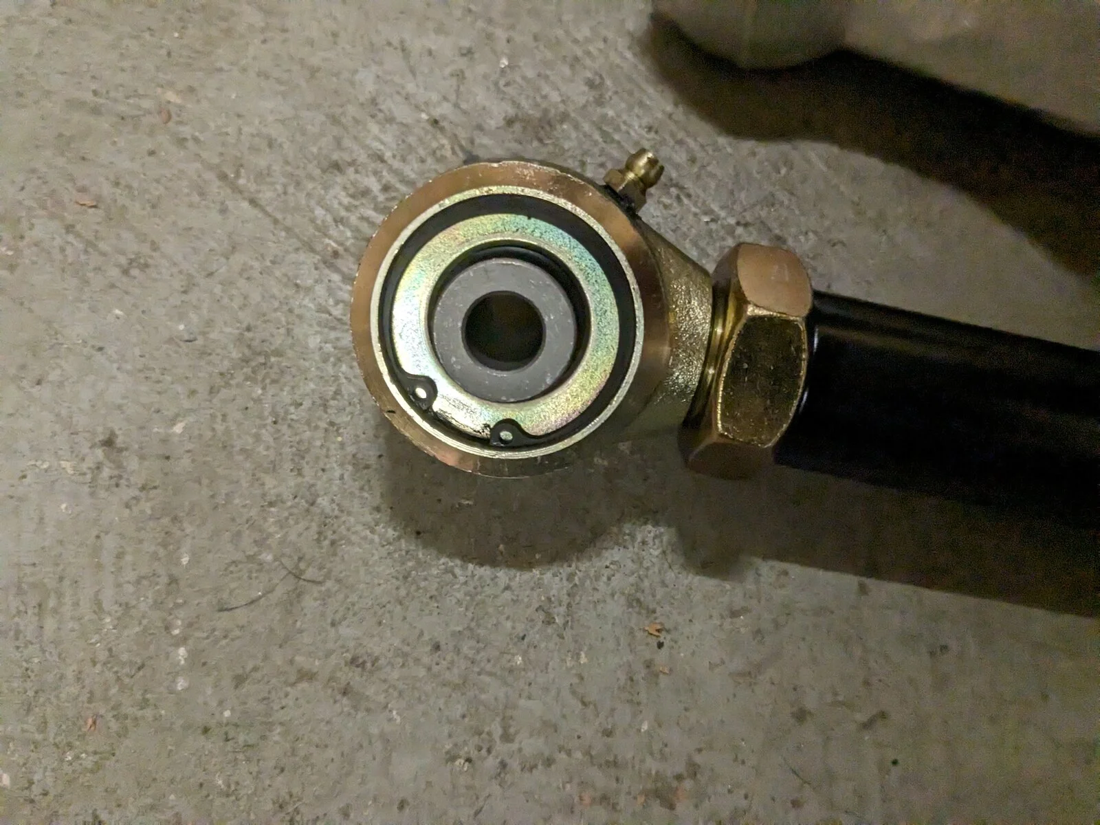

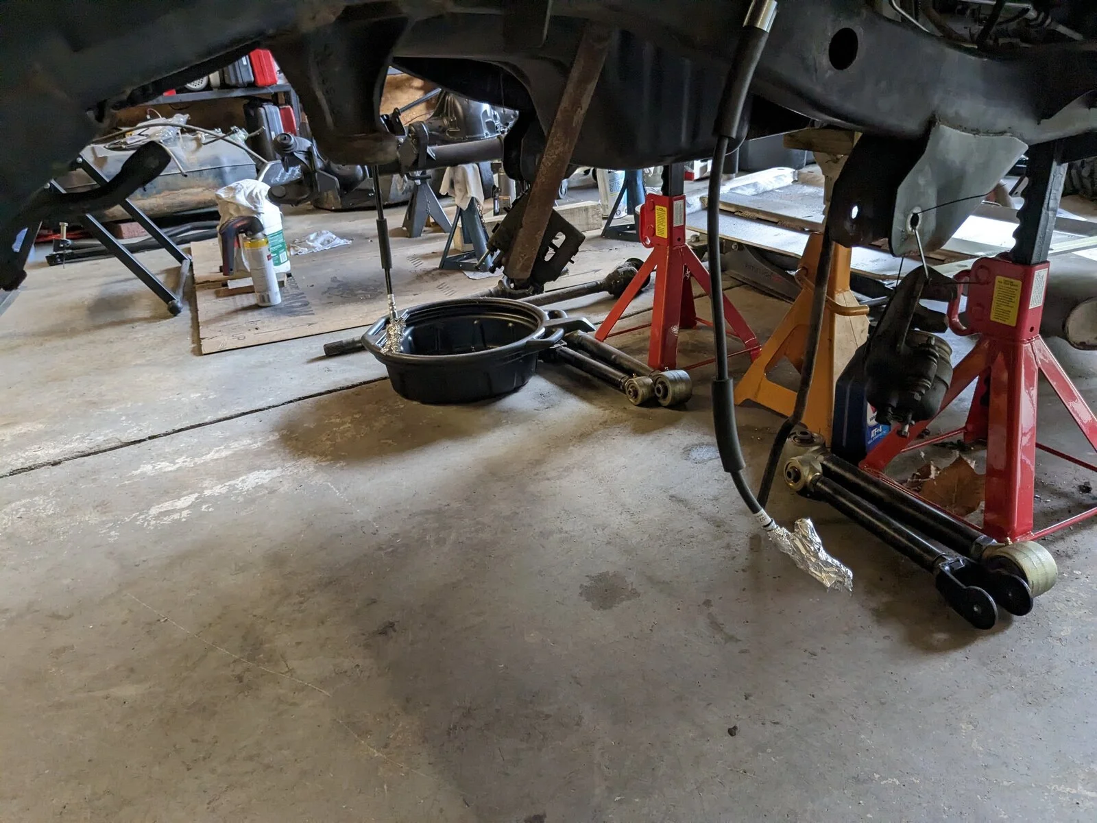

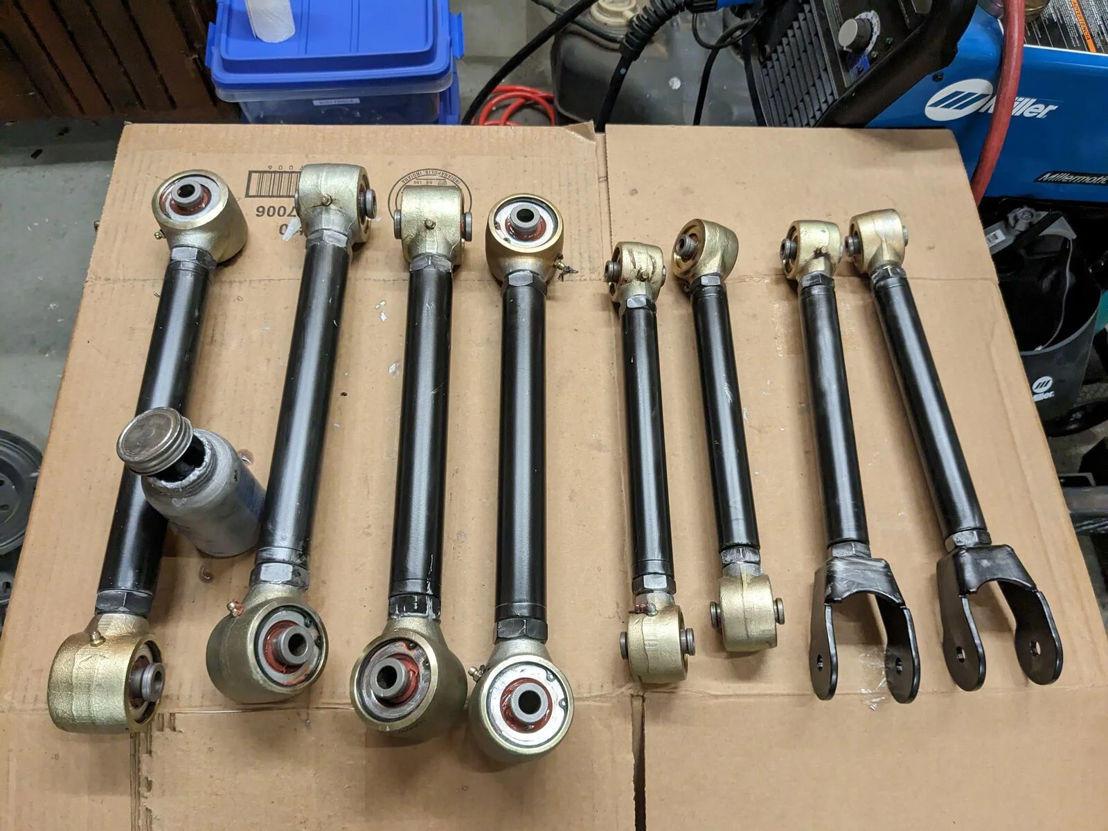

After seeing many mention the JJs come pretty dry, I torn into all of them for the lift kit to open them up and lube them.
Yup – pretty dry in there from the factory…
Beginning:
End:
Took a good day's worth of work. Also anti-seized the threads into the Savvy arms. The JJ Tools from Currie are worth their weight in gold for this job!

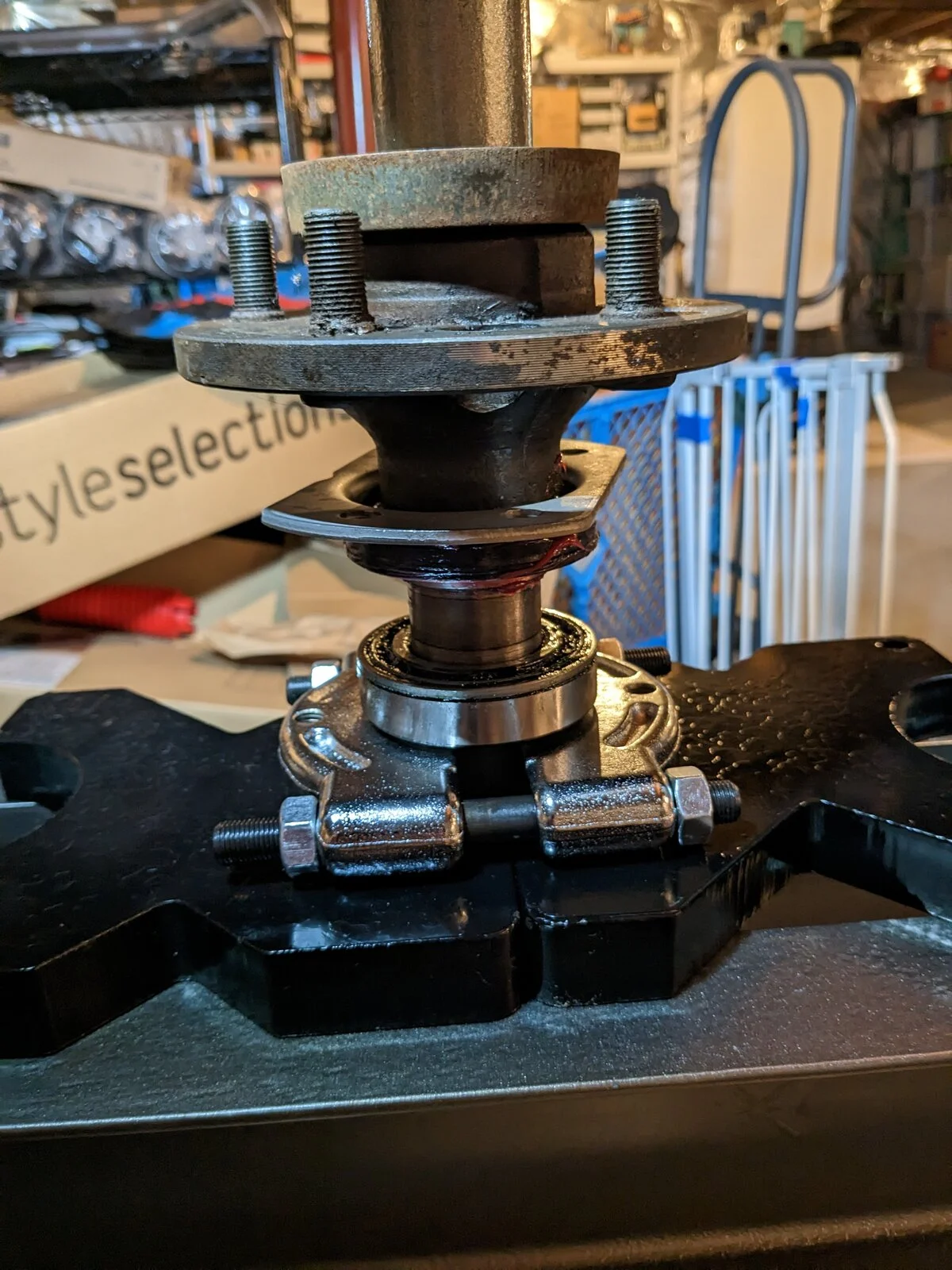

I had picked up a used set of Dana 44 axle shafts as trail spares. I figured I'd keep the original axles as spares and put new bearings on the old spares.
Well it's a good thing I never needed them because I didn't realize that the mounting plates weren't right for my axle so I doubt I would have been able to get them on the Jeep if needed on the trail... Live and learn to do more research...

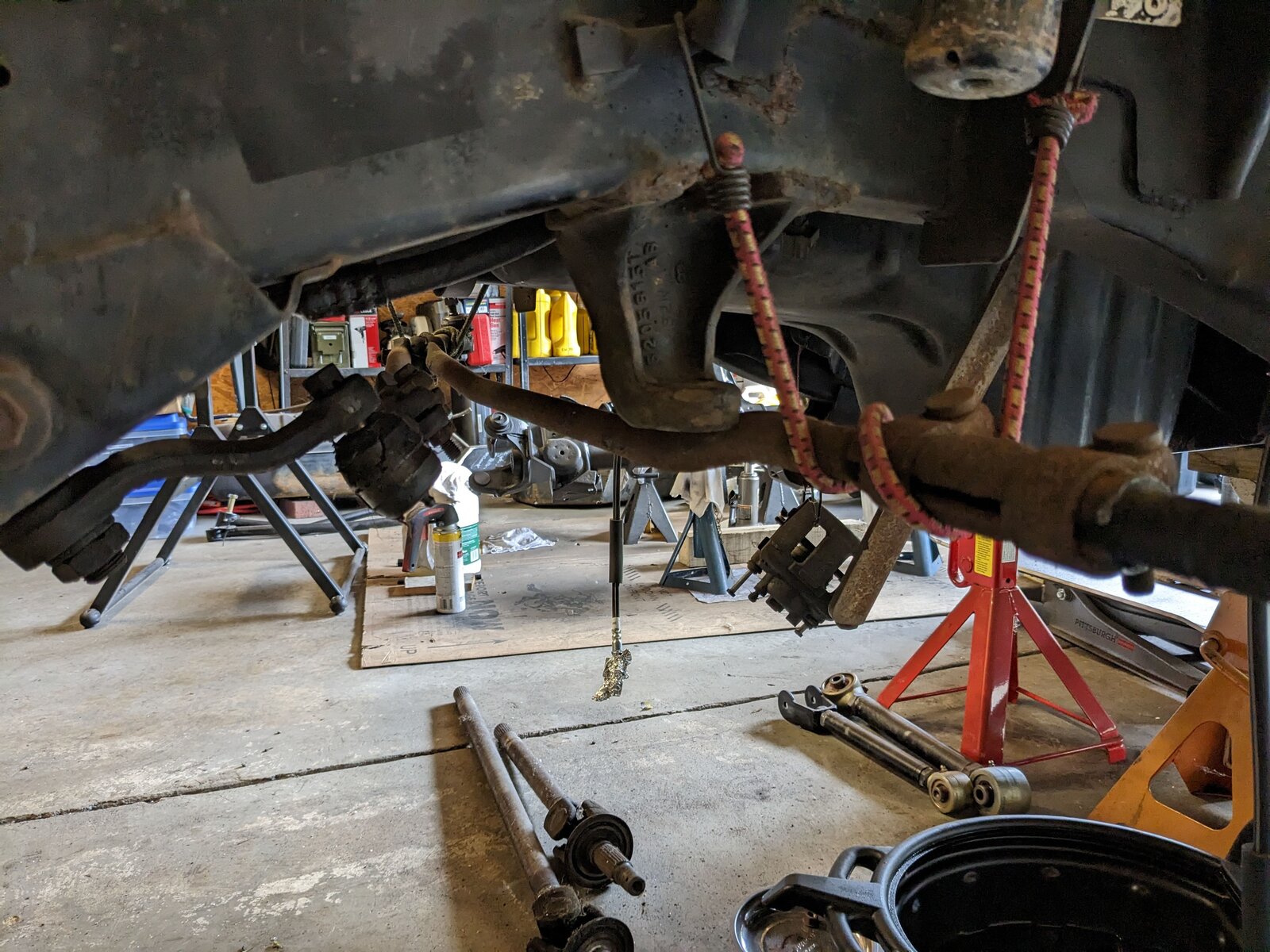

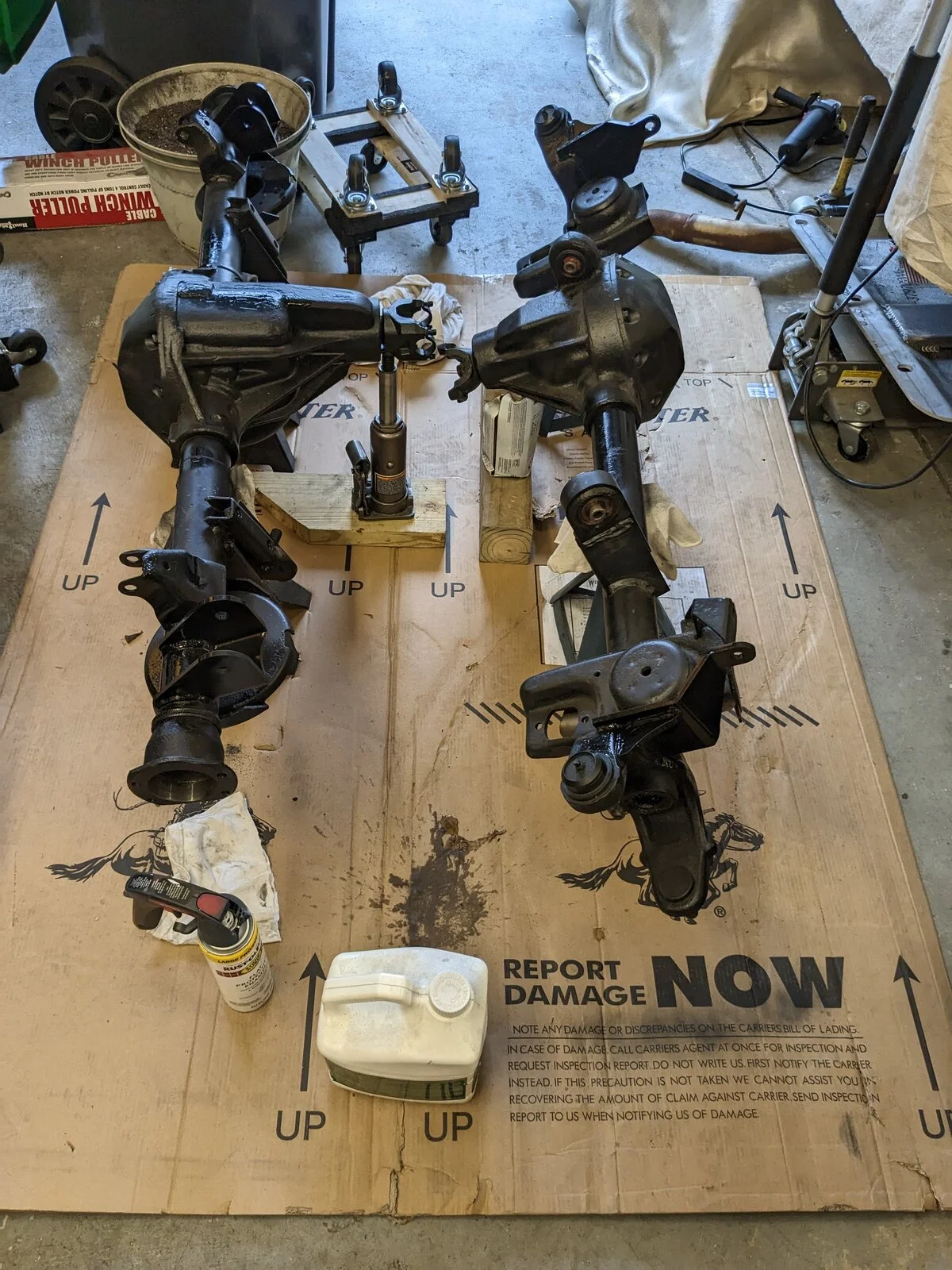

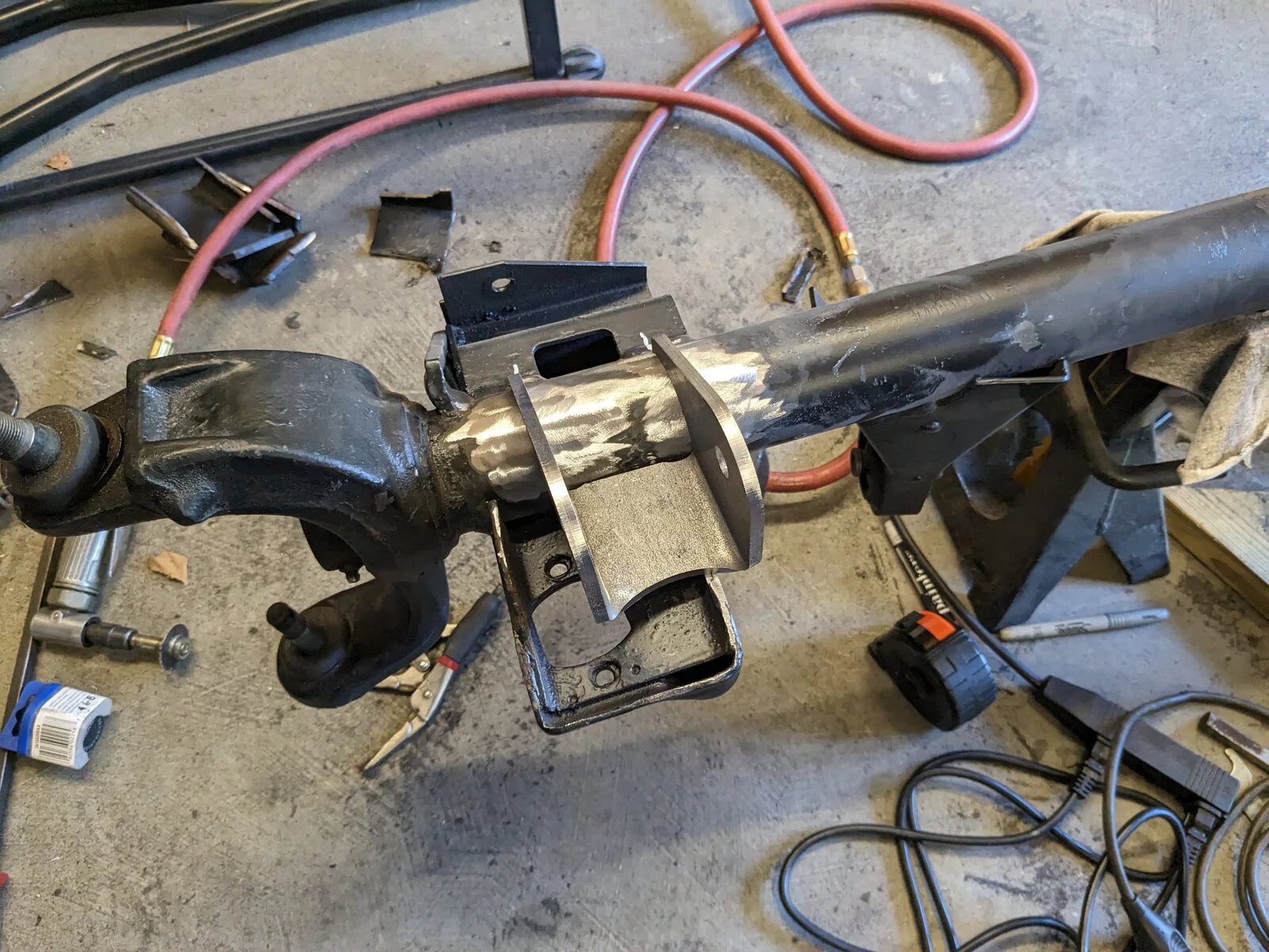

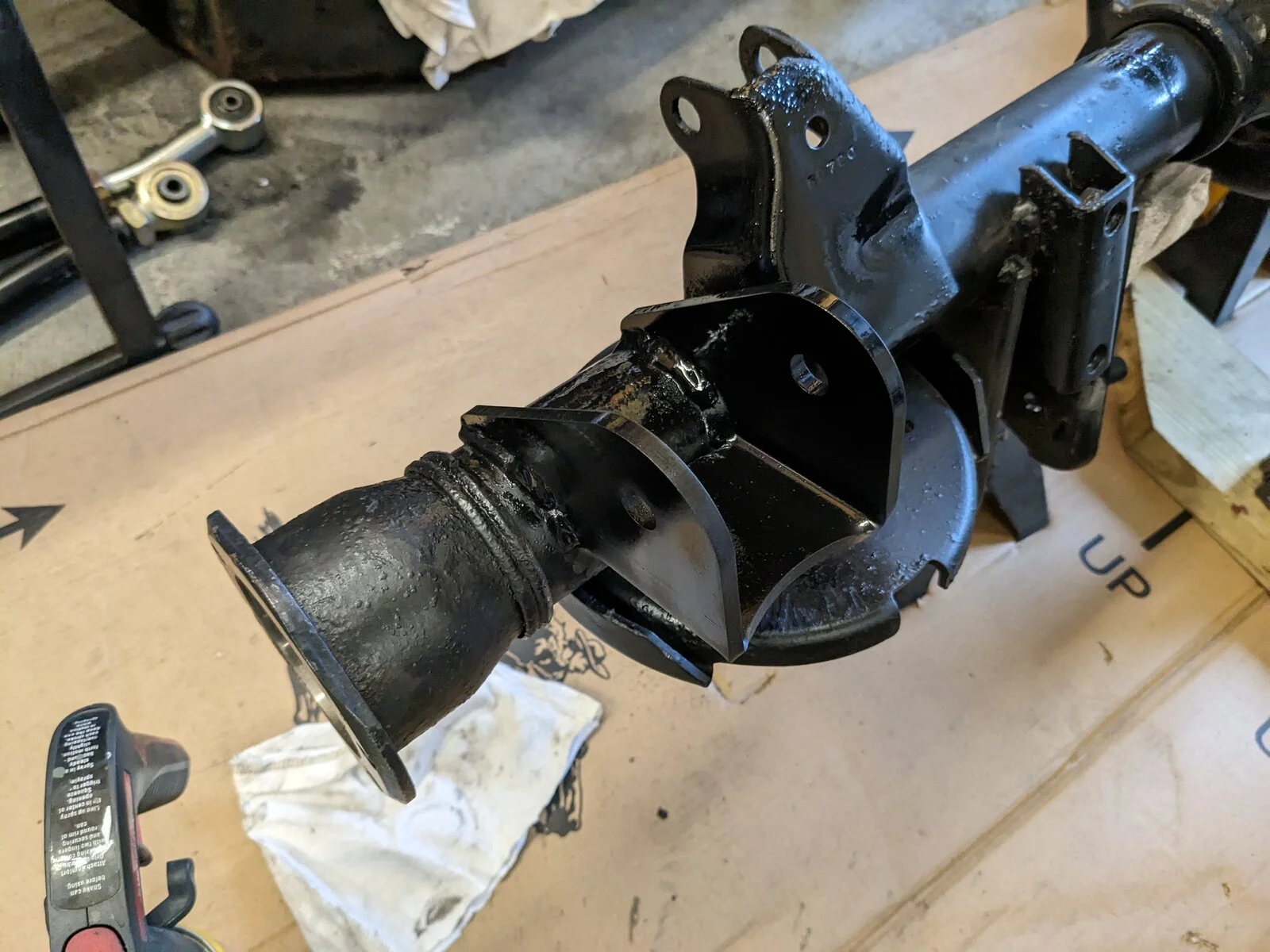

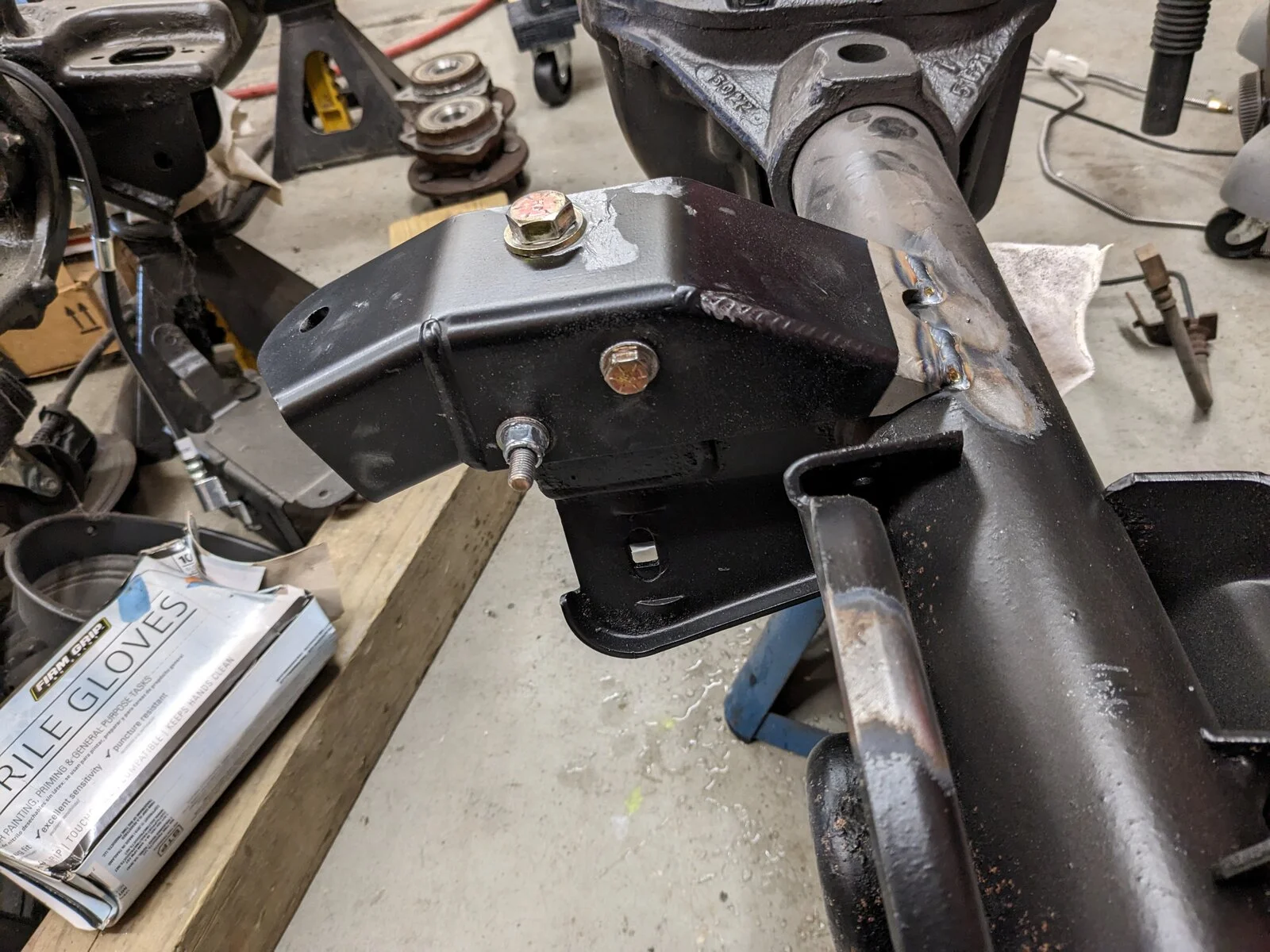

During this week, things really started picking up after I was able to start surgery on the axles.

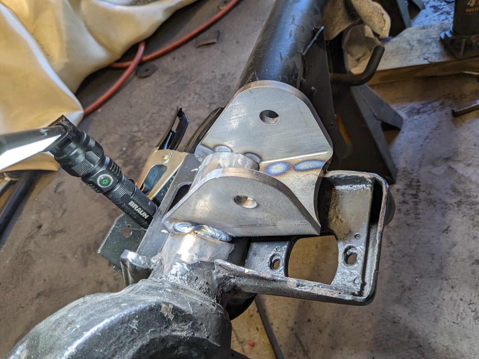

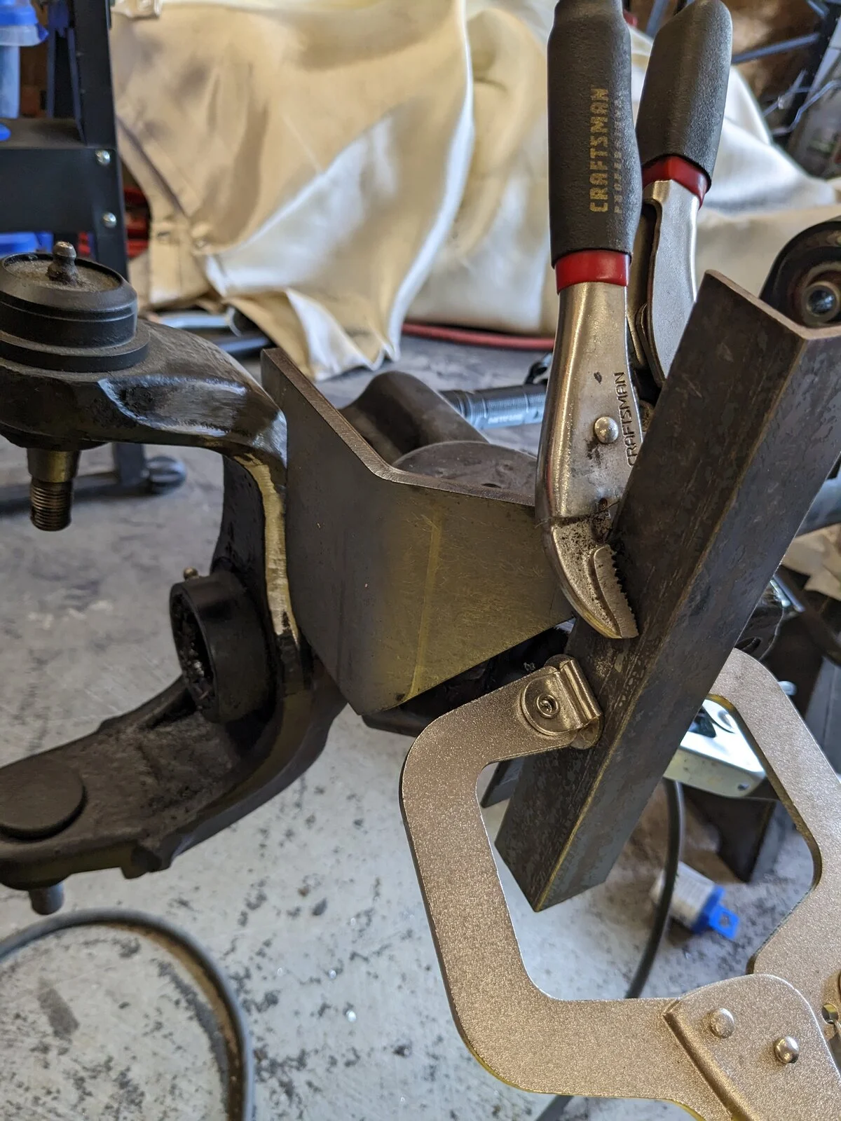

My passenger rear lower control arm mount had a pretty good bend in it from a previous off-road trip and I was ready to upgrade so I went with the Iron Rock Offroad mounts for front & rear axles.

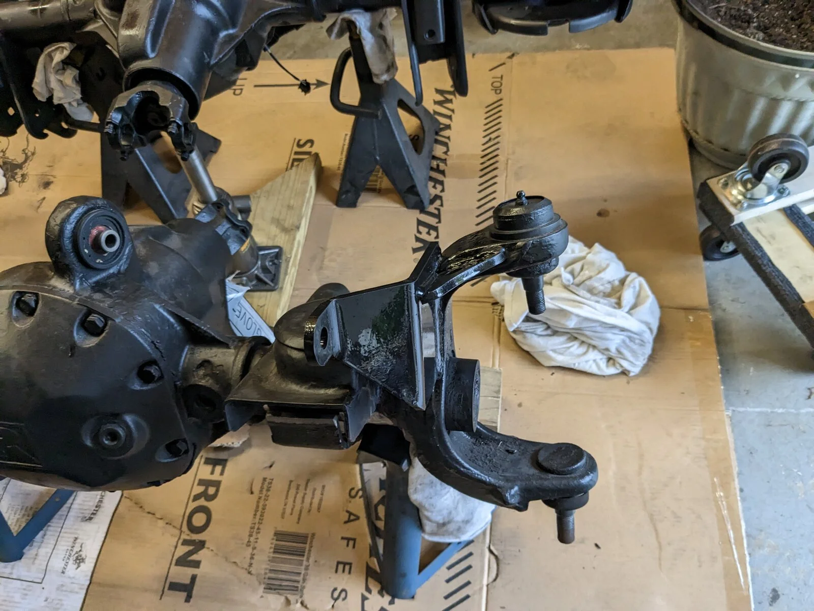

Front axle before surgery:

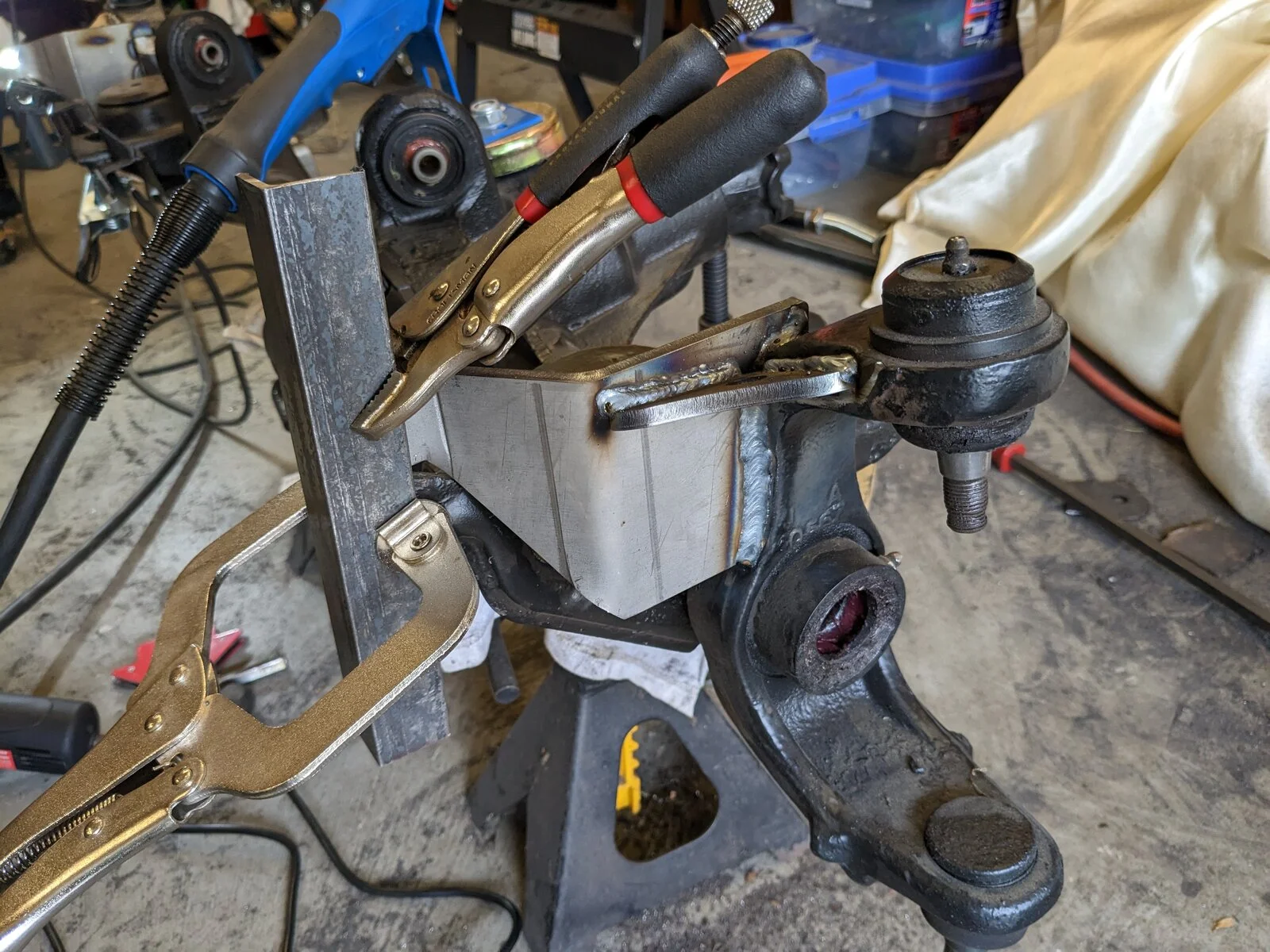

Mocking up the new mount:

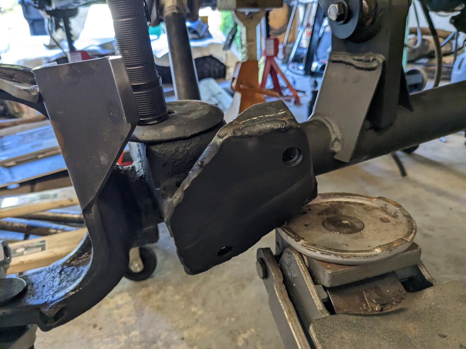

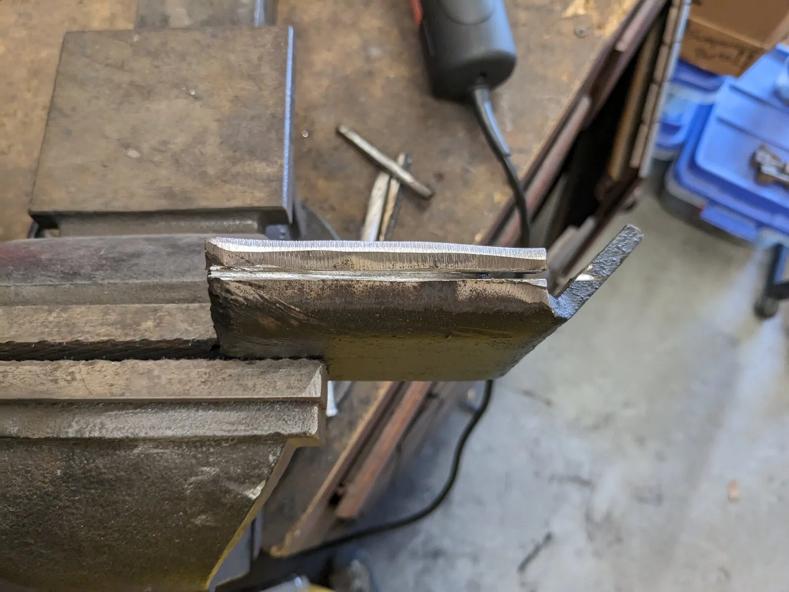

I removed the one, mocked it up and welded about an inch on it. Then went to remove the other one and burn an inch on it for the first one to cool. Then back to the other side for a second inch. Trying to keep from putting too much heat into the axle tubes and minimize any warping.
Still needed to finish welding these on.
I'm very impressed with the Iron Rocks Offroad mounts. They are even pre-angled slightly inwards, matching how the stock mounts are angled.
Reactions: Apparition

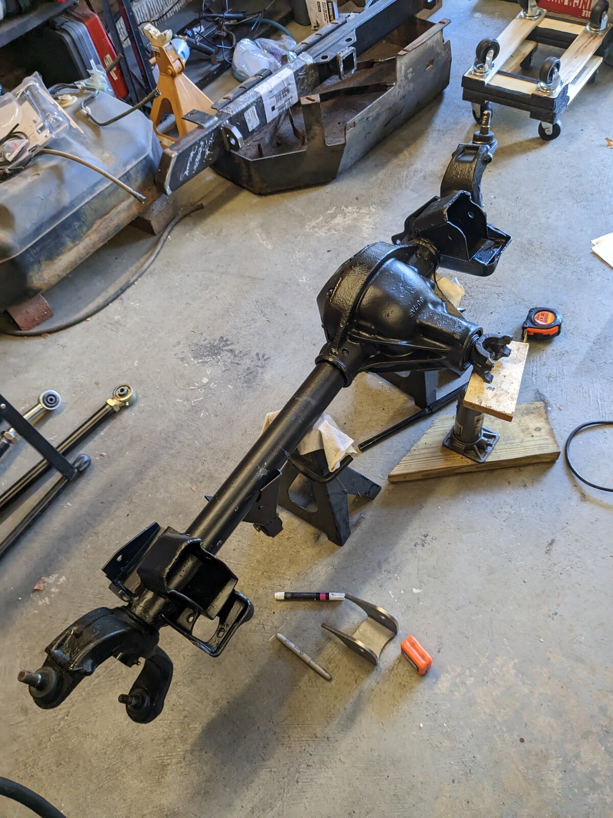

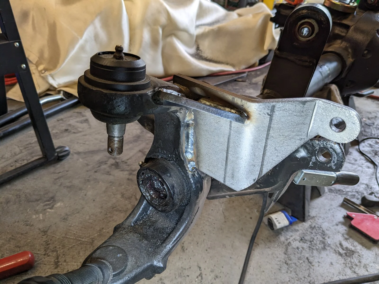

Started the day by finishing the welds on the front axle lower control arm mounts. Needed to trim down the mini skids that were on the previous mounts.
Next turned my attention to the front axle’s sway bar links. Burned in the new BMB brackets.
And then out with the old sway bar brackets.

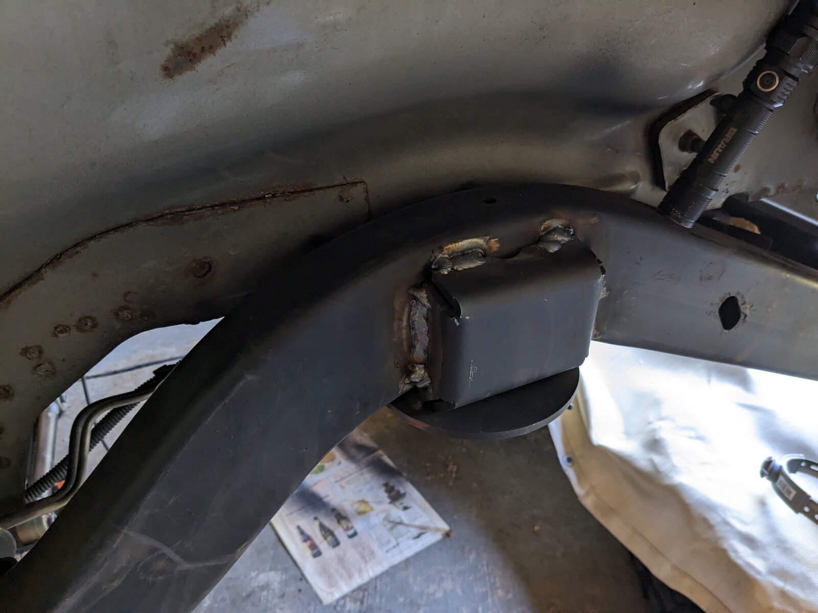

Rear axle up next. Time to get the bent bracket gone. (Didn’t get a good picture of the damaged one. Damage wasn’t terrible but there wasn’t a clean way to get something on it to bend it back into shape with some heat. So in with the new, thicker mounts.)
Finally some paint to cover all the new parts. Still putting coats on throughout the evening.

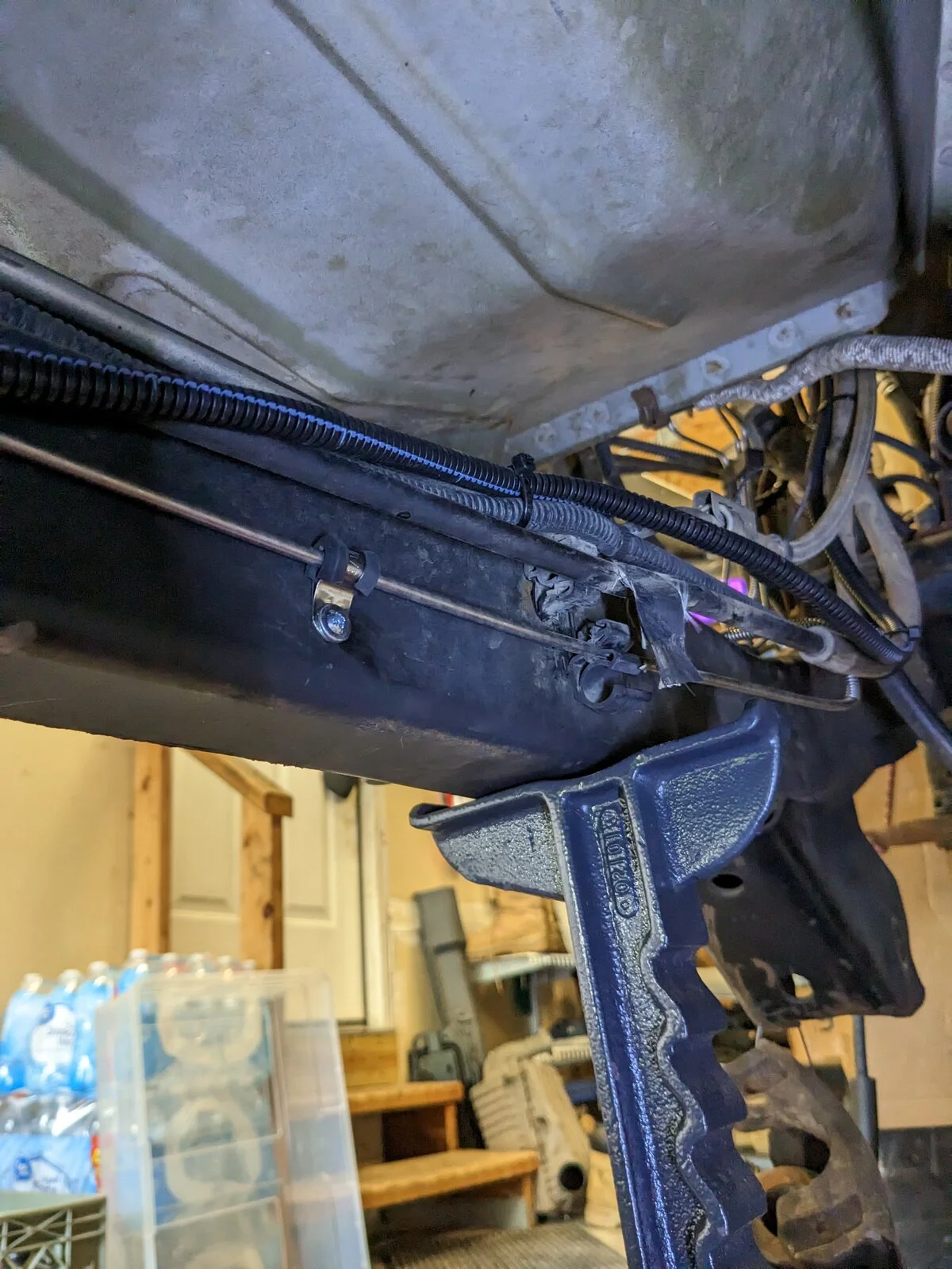

While waiting for the rear axle mounts to cool between each inch of weld, I installed some additional clamps to keep the brake lines from rubbing. 3/16" rubber clamps and self-tapping screws (with a small pilot hole to help).
You can see the stock plastic bracket cracked when removing the old lines, so this is a great solution to hold the lines.

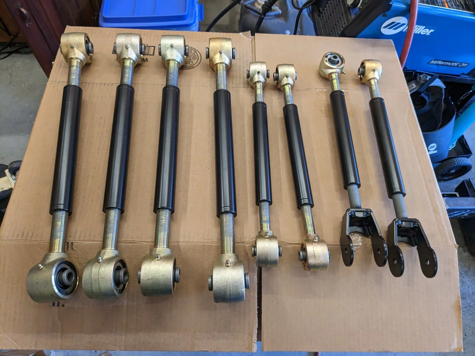

Are those double adjustable lower CAs? I didn’t know those were a thing. Thats pretty cool. I also actually have a set of those gusseted CAs (in your one picture) on my TJ. They are a discontinued XJ Currie model.
Do you have a part number for that Durango alternator from Napa? I may be looking to upgrade there soon.
Yes indeed, double adj CAs all around. JJs with aluminum arms. Went with the 3" edition of Savvy's kit originally then purchase 4" Currie springs when I switched plans to 35s. Savvy's Kit
Hmm. Good to know about the arms. I bought them used through a buddy years back and was told they Skyjacker for a TJ. Wouldn't surprise me if they were for an XJ, since the XJs use the same arms as the TJ. I purchase many an XJ arm from the boneyard to replace my lowers after a offroad trip before I put those fixed tube arms in. Those were definitely longer than stock and added to my rear shimmy that I lived with (and dropped the TC to 'try' to help) for way too long.

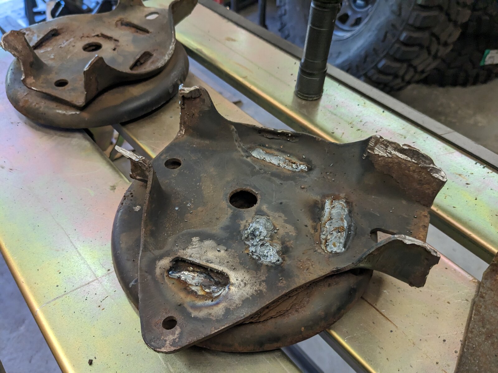

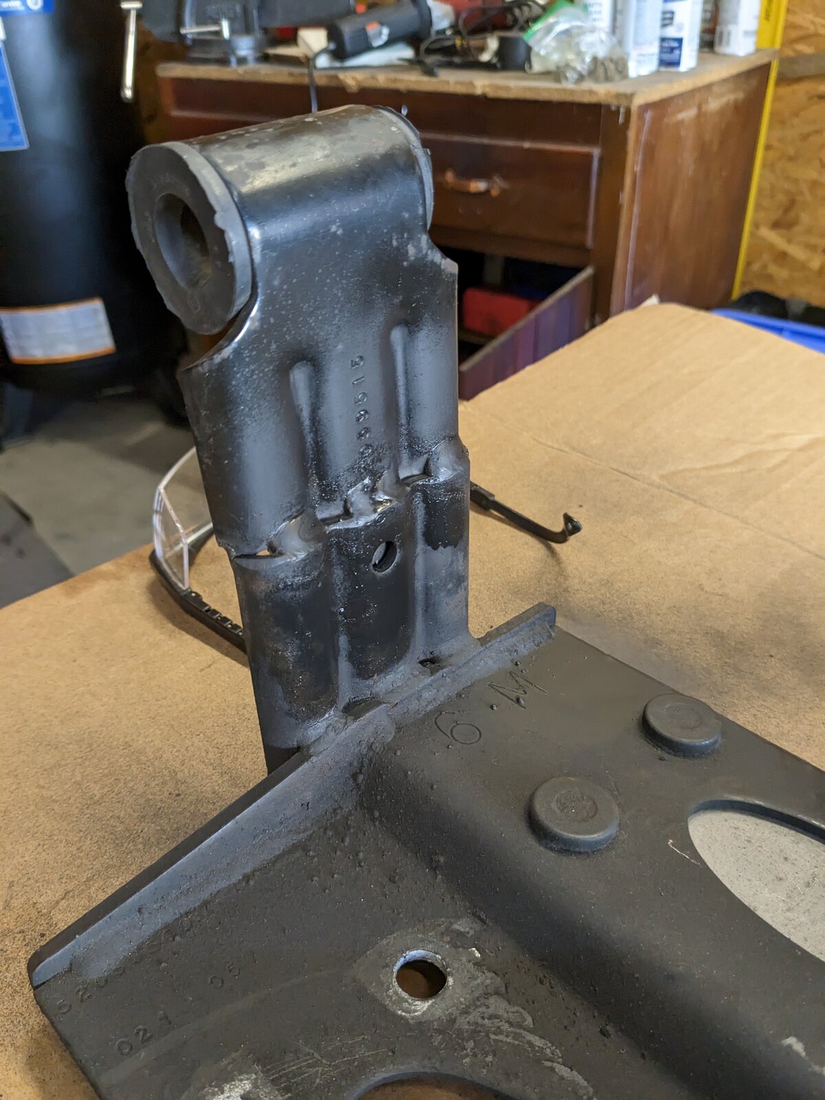

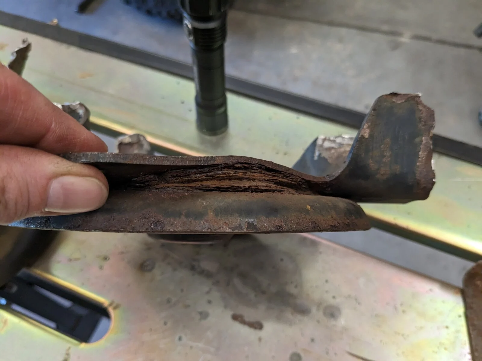

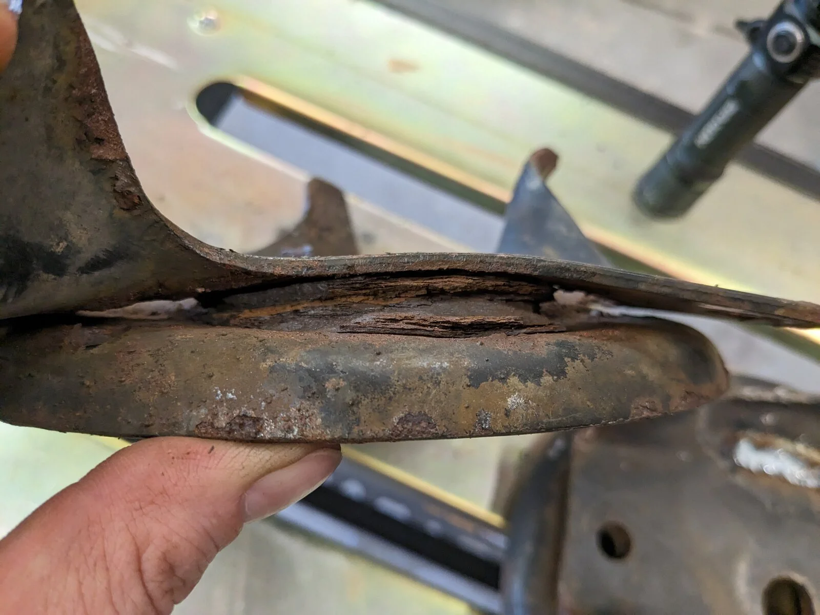

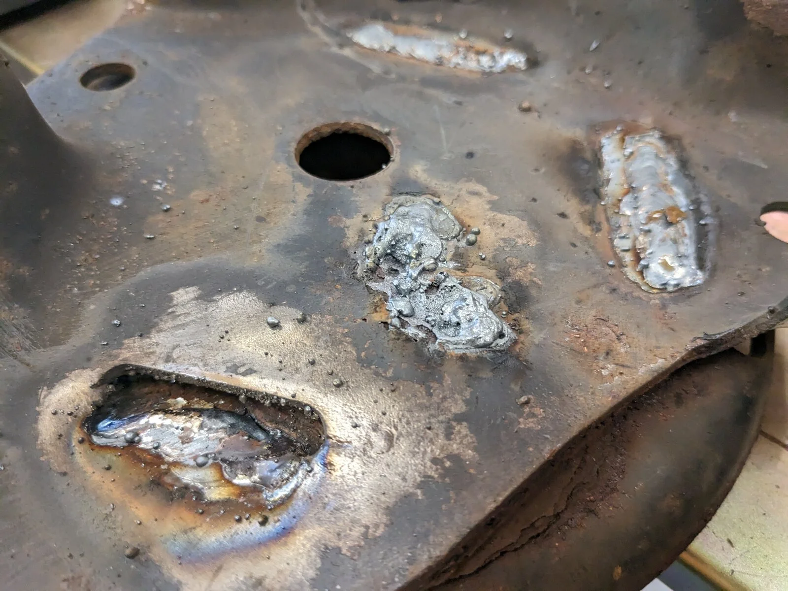

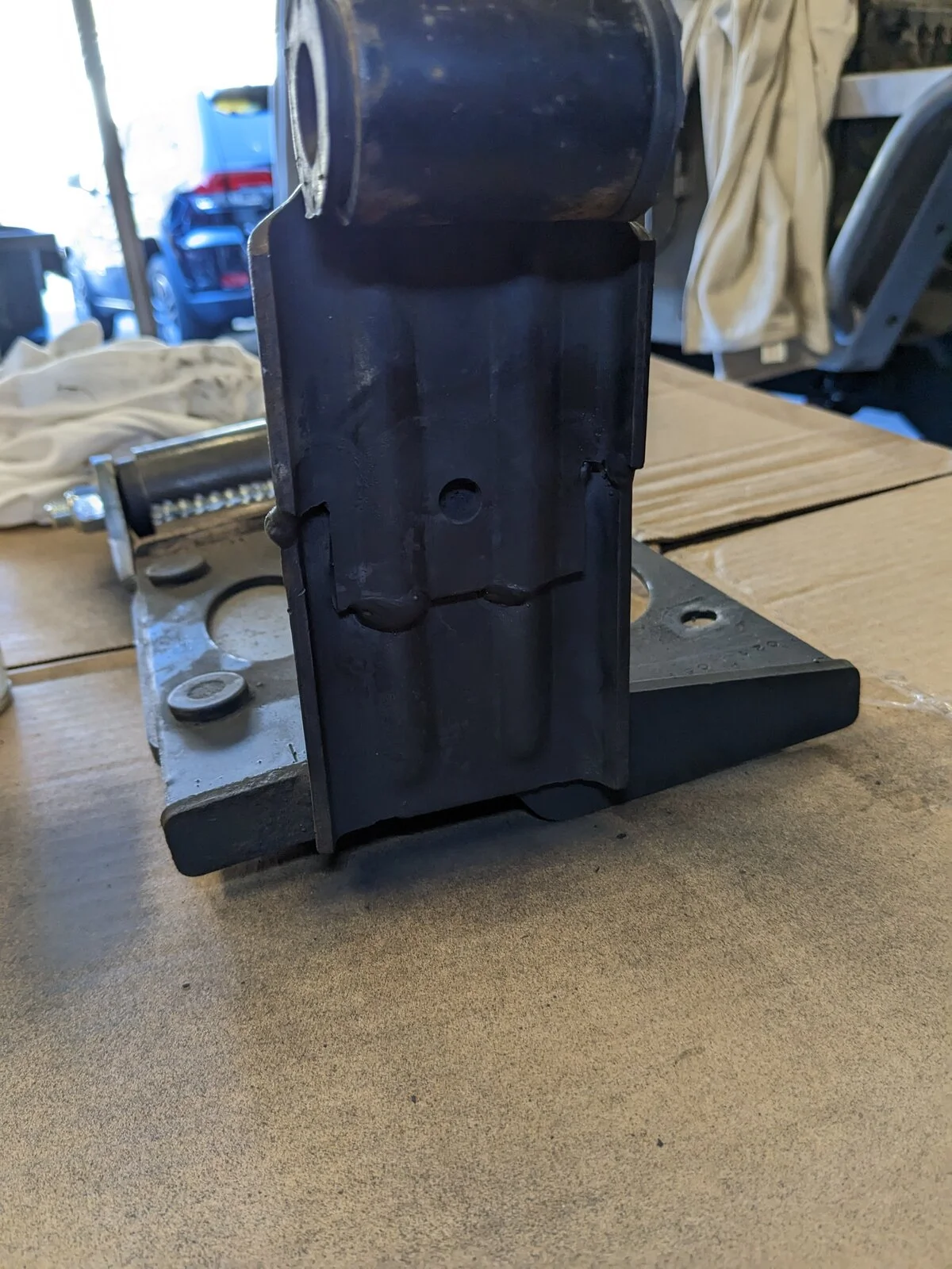

Was able to clear some time today to work on the rear perches. Removal was ok on the passenger side. Before I ground down the frame remnants, I figured I'd fill in the stock dirt catchers to avoid future rust.
Well, I also found a small spot with some rust damage in the top, so I figured - let's just burn some metal into that too.
As I started to weld, it sputtered and sputtered...
Huh, I guess I could have looked before I welded... Nah, still learning that lesson from early about living & learning - this time about looking before I throw down hot metal... <shrug>
Removing the driver side, it wasn't in any better shape.
I'll be doing some research on the forum for recommendations. My first gut feeling is to see if Iron Rocks has them, given how much I like their control arm mounts - but I'm reminded of that lesson to learn and research...
See, I'm trying to learn the lesson that keeps hitting me in the face. :p
So the flap disc took care of the frame. Filled in some low spots with some hot metal and then everyone got a coat of Rustoleum flat black (still wet in these pics)

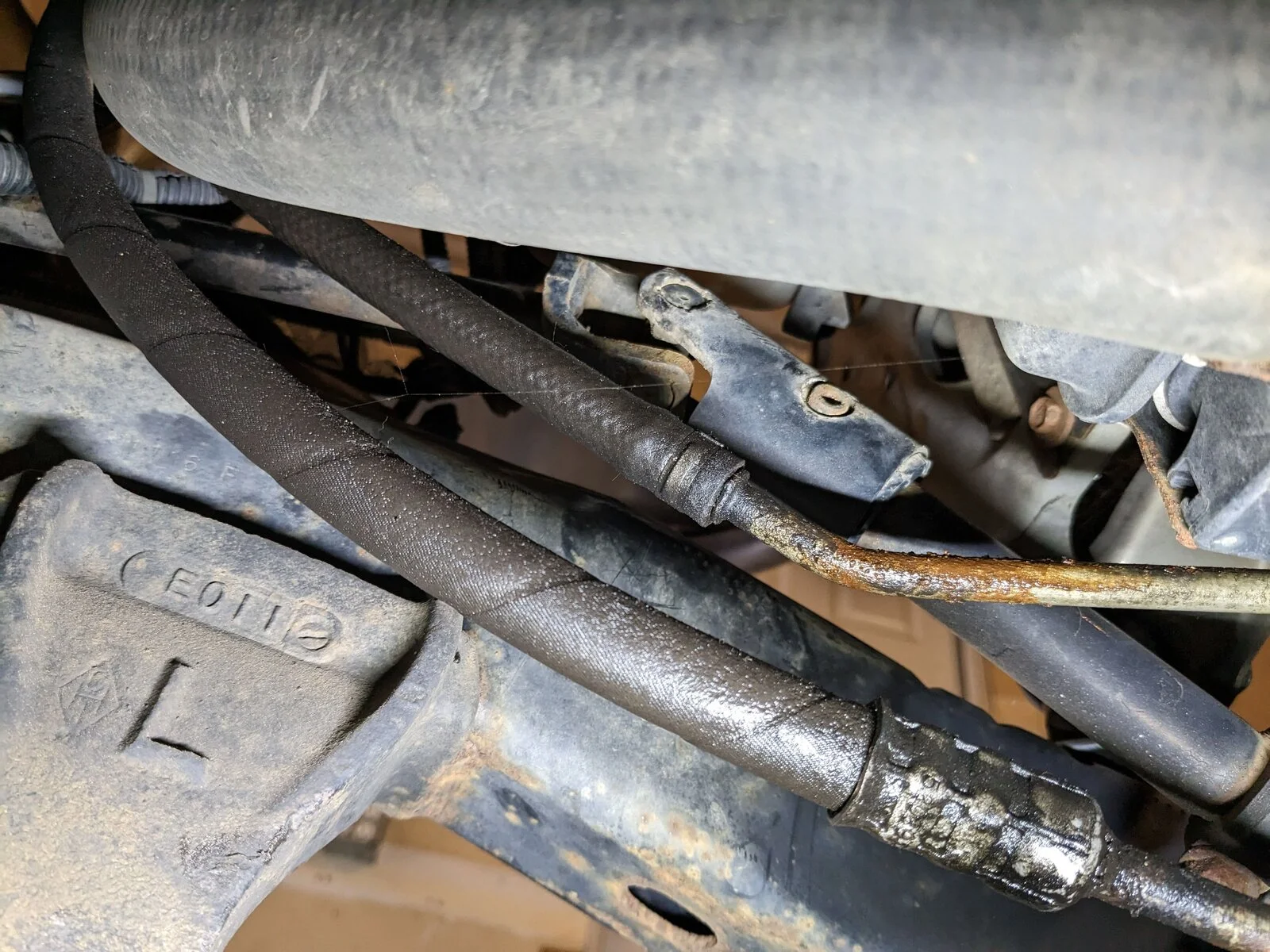

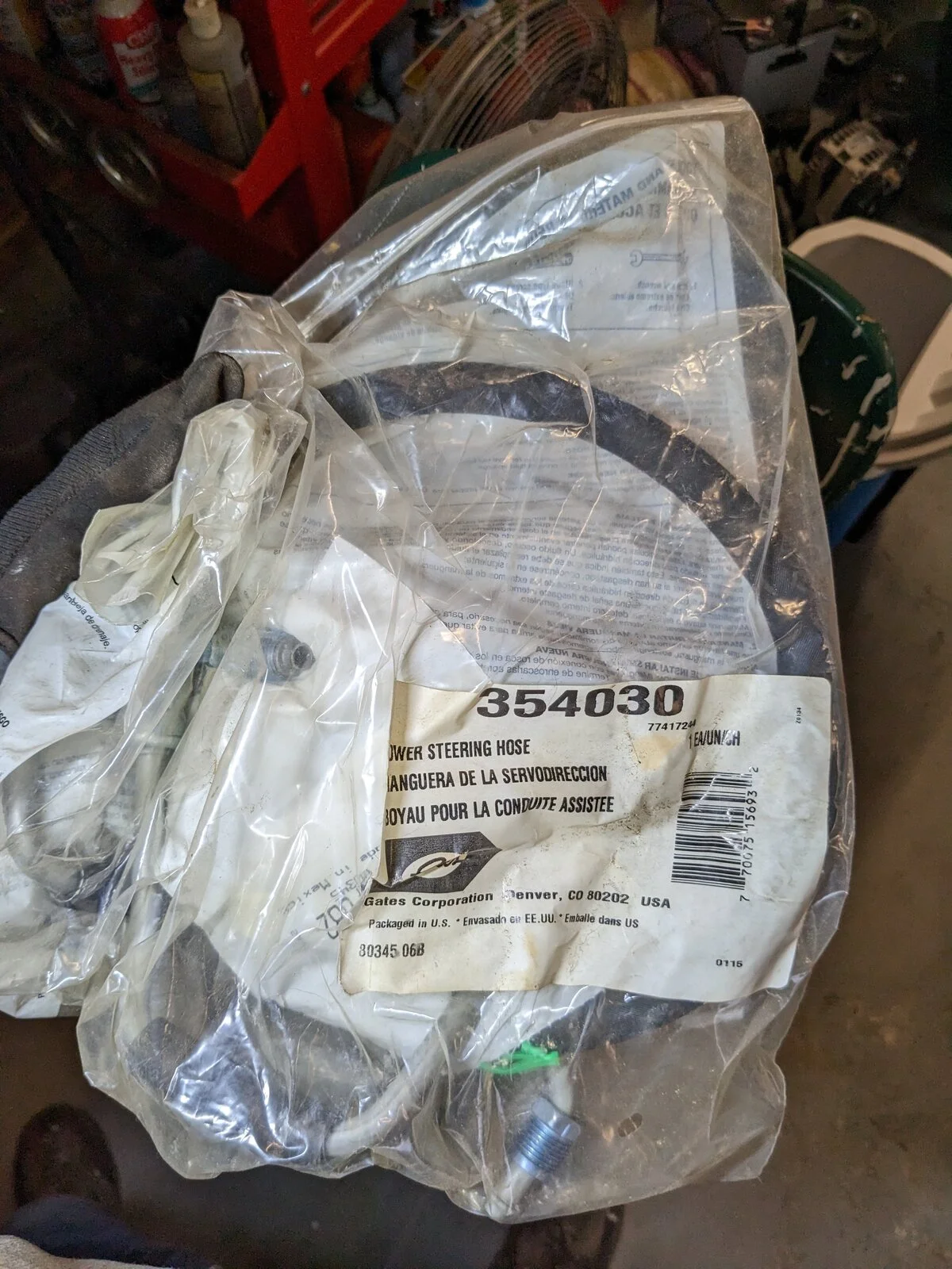

Found that the power steering return line is rusty and leaking. Replacement ordered.
I previous saw the pressure line showing signs of leaking at the pump where the hard line joined the soft tubing. After cleaning it, I haven't seen fluid. But, I bought the tube at the time anyway.
In the above image, I assume the fluid on the pressure line near the pump is from the return line leak. But, I have it already, so it will go it with the new return line.

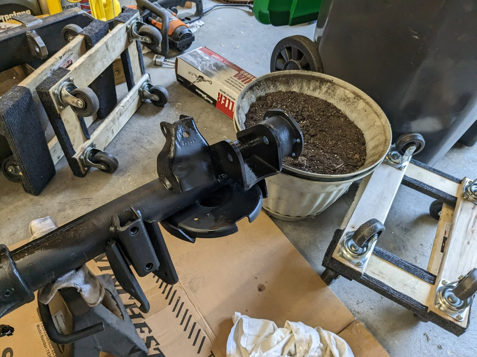

All right, time to catch up this thread. Been meaning to get back to updates but focused on the build during wrenching and then life (twins) during non-wrenching times.
For May:

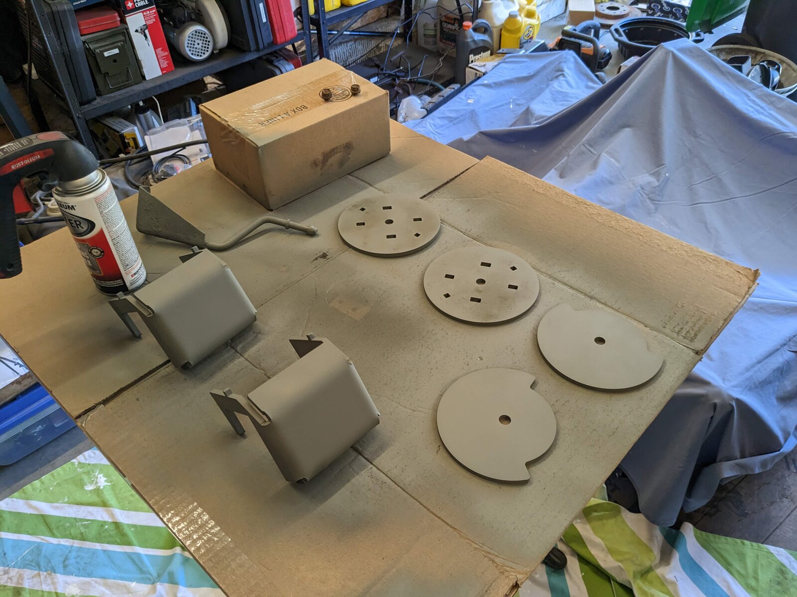

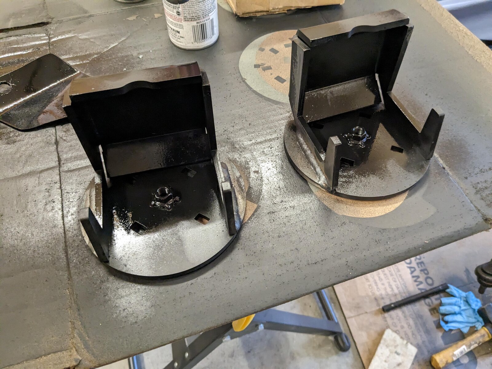

Ordered the Ballistic Fab rear perches.
Primed:

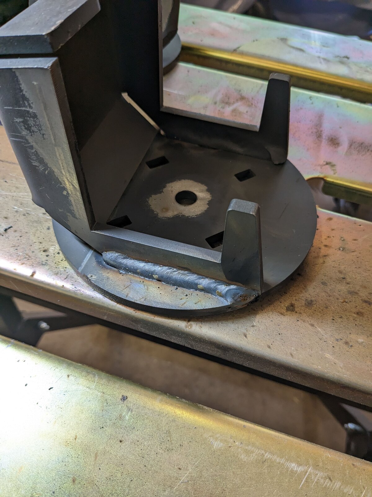

Welded perches together
Installed the nuts for the upper bump stops:

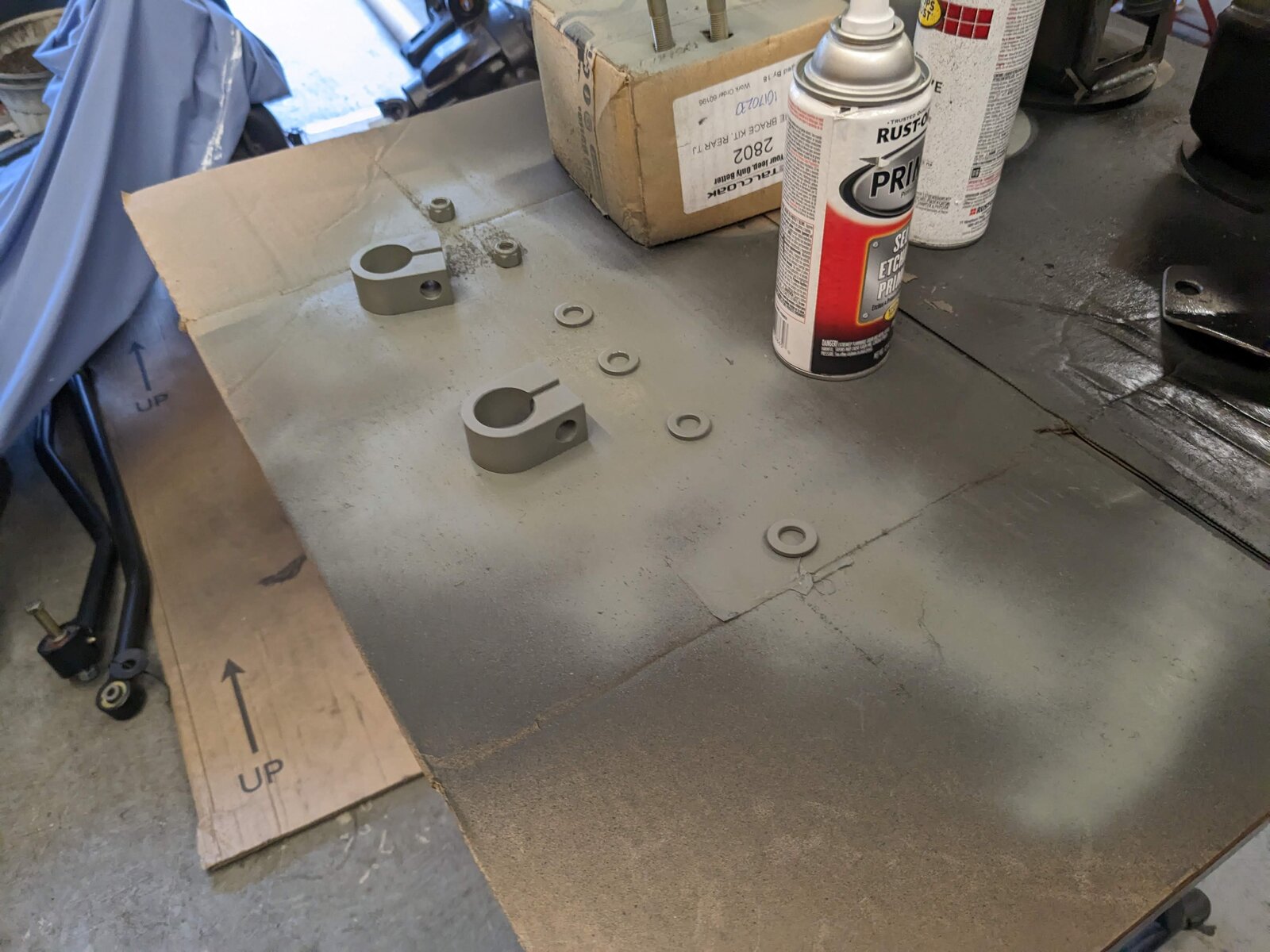

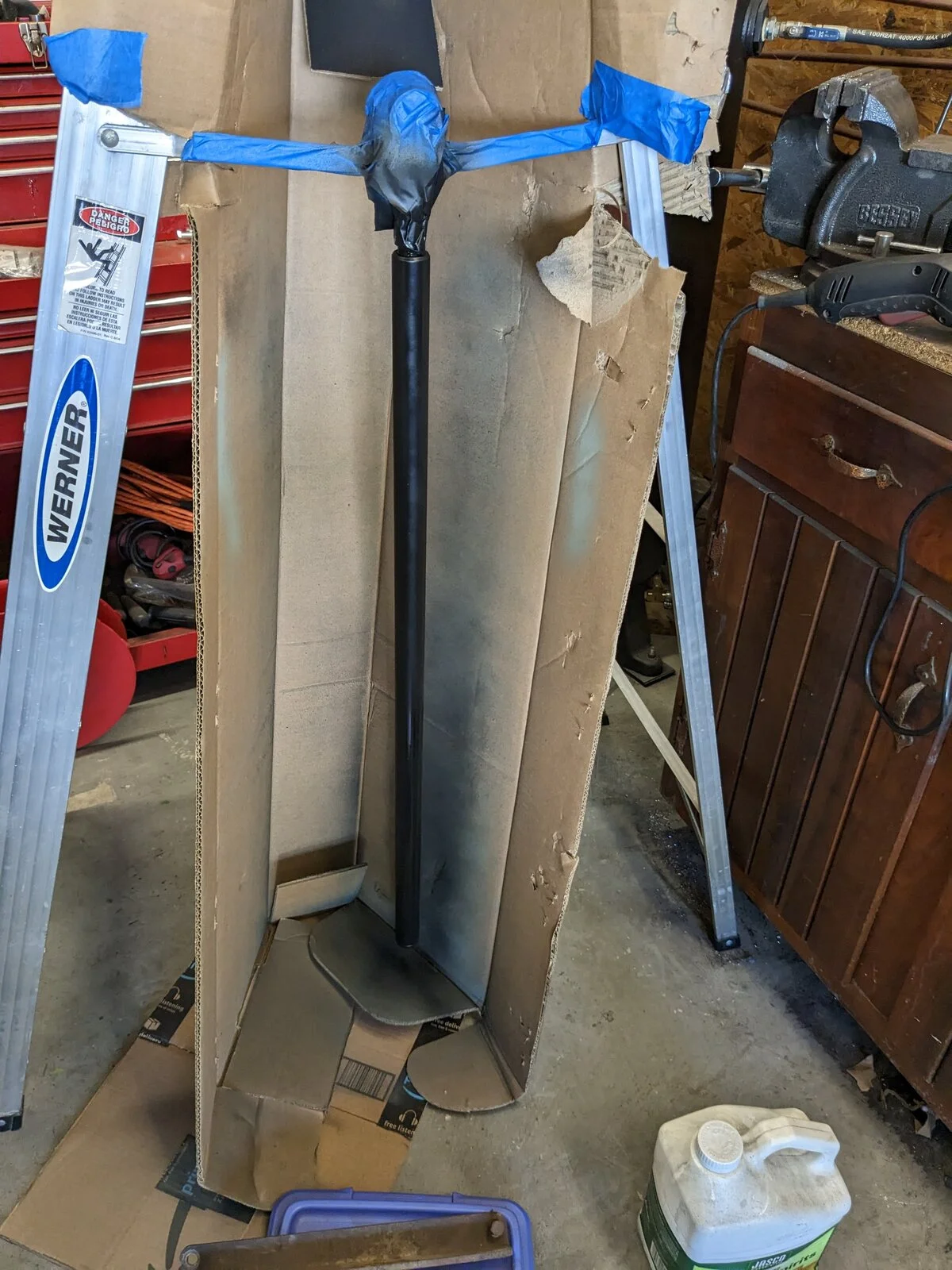

Started Primed the BMB Tie Rod. I bent my tie rod way too often on previous trips so even with the tie rod flip, I still wanted strength to avoid bending it any more (hopefully).
During May we took the time to get the boy baptized!

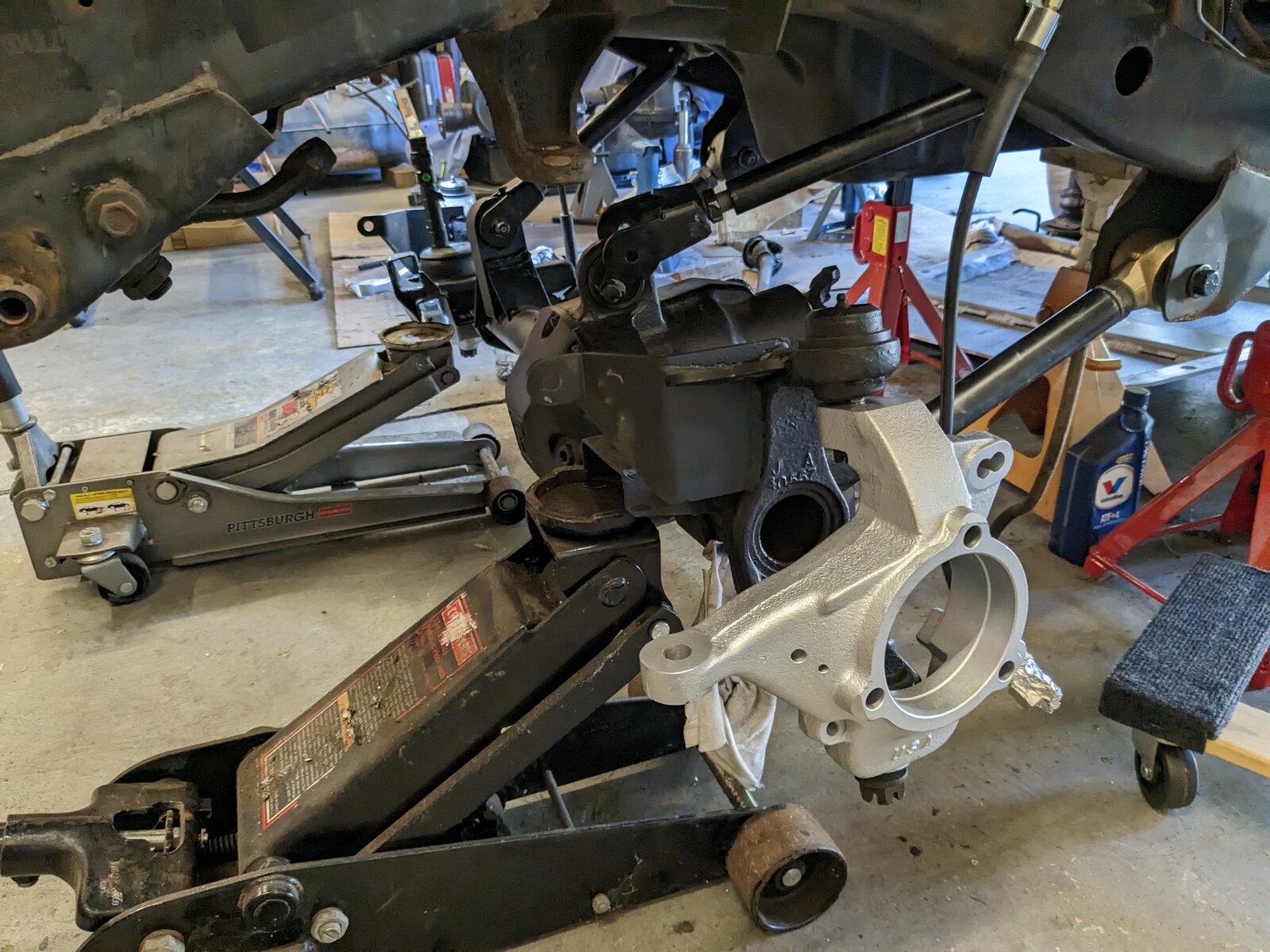

Got the front axle in place, this way I could comfortable torque the BMB knuckle to spec without the axles on jack stands and flopping all around. Big thanks to @mrblaine for being willing to swap out my non-flip knuckle 2 years after I received the kit (but did not install) when I decided to go with the flip.
While the Dana 30 was out I looked over the TB/Steering Stabilizer bracket & thought it looked flimsy overall. Searching on the forum, I saw that @mrblaine had created a bracket with his hydro assist kit and ‘stole’ his design for my own attempt.
Rustoleum paint on the tie rod

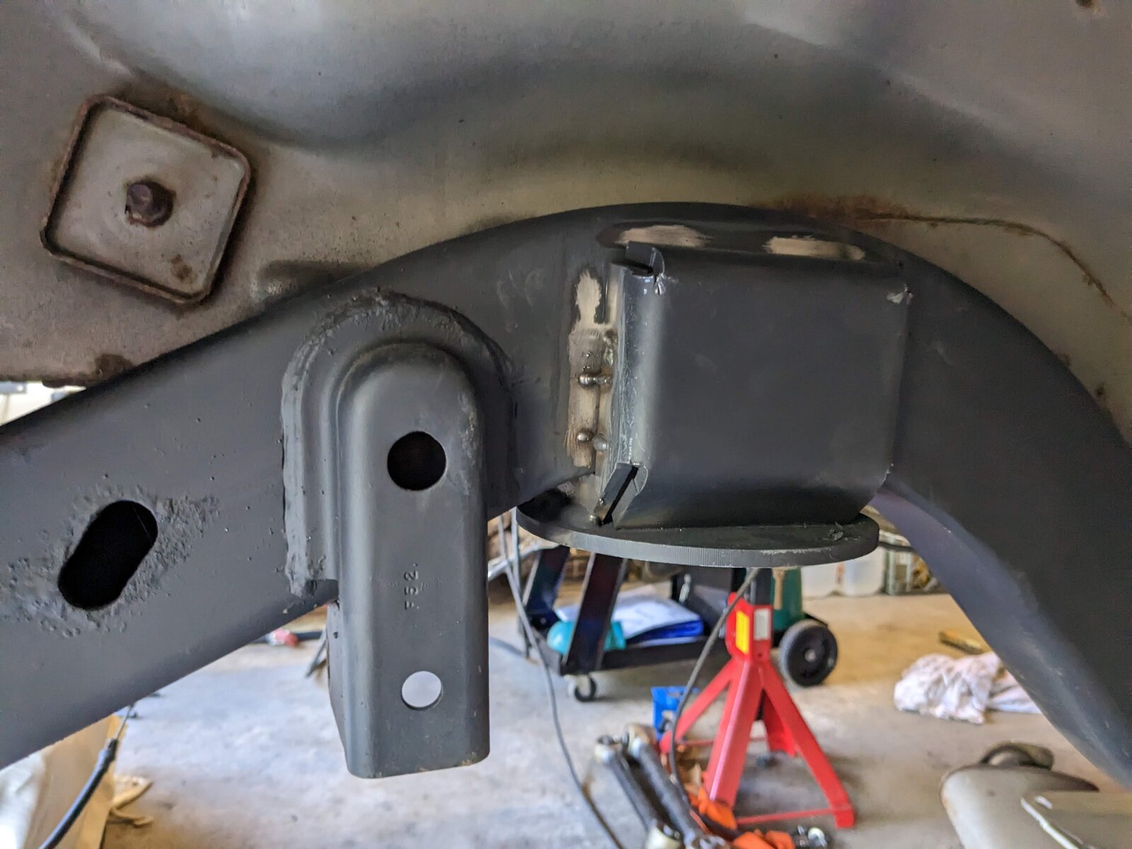

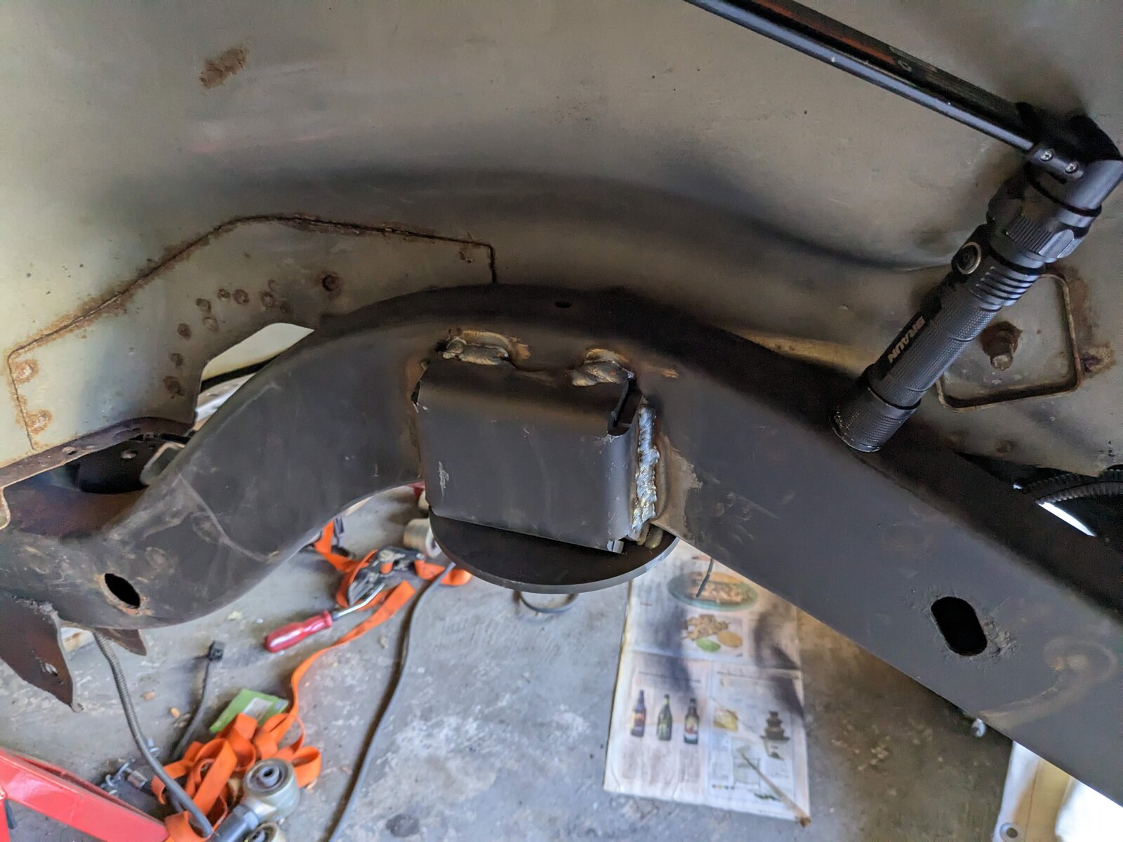

Rear perches install

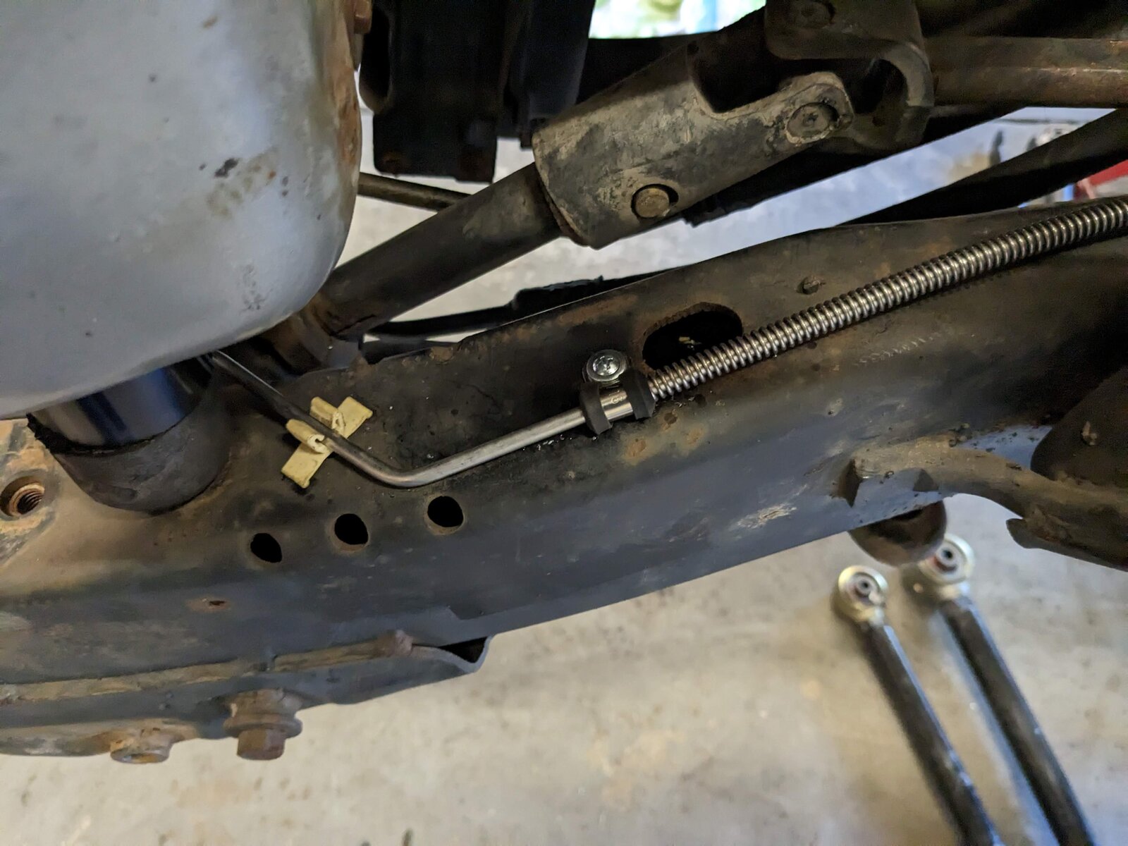

Got the stainless hard line brakes installed. I'll find some better pictures. Used the self-tapping screws & rubber-lines clamps @mrblaine recommends. Made the install a breeze where I couldn't re-use the stock brackets.
Primed:
