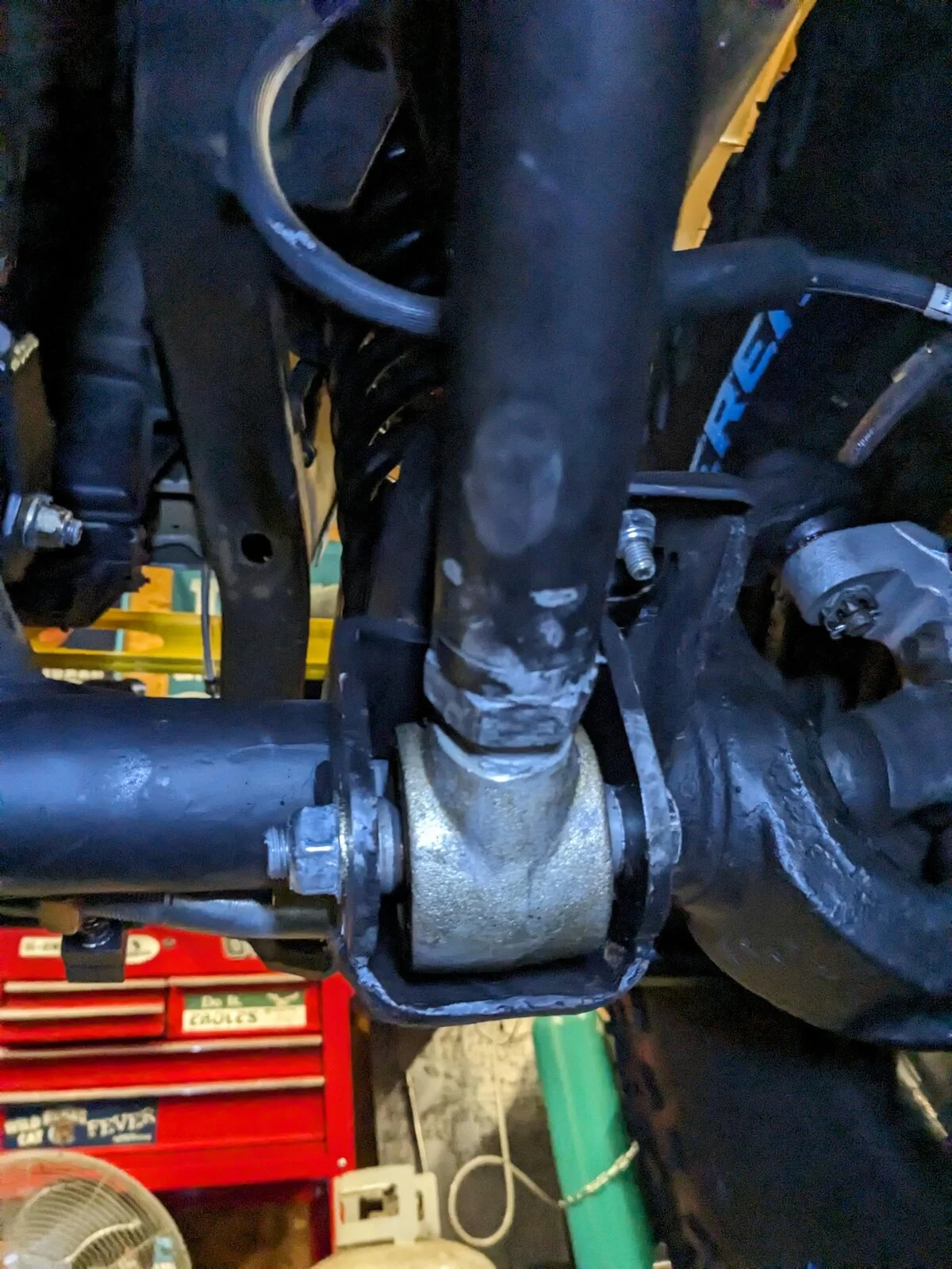

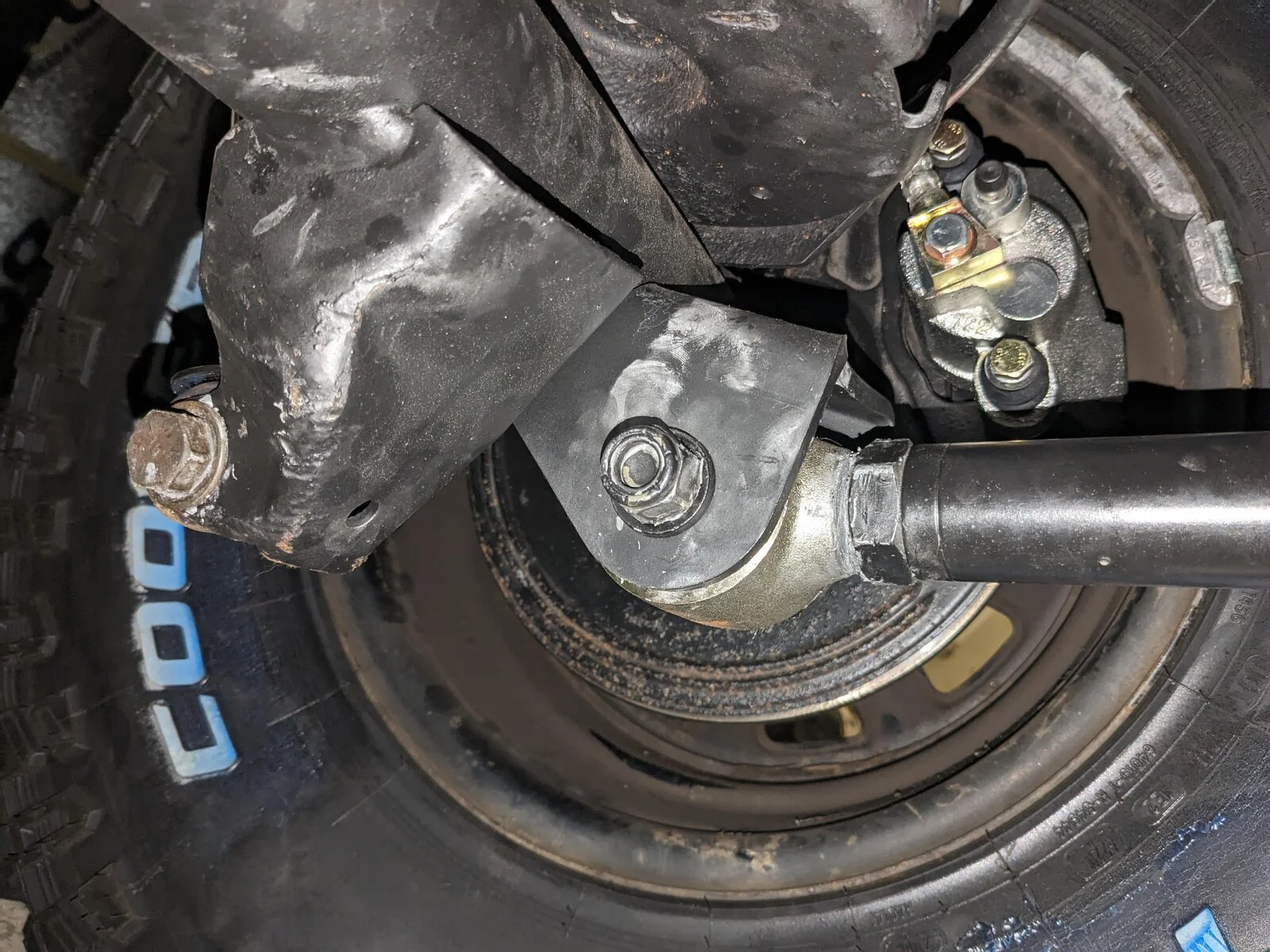

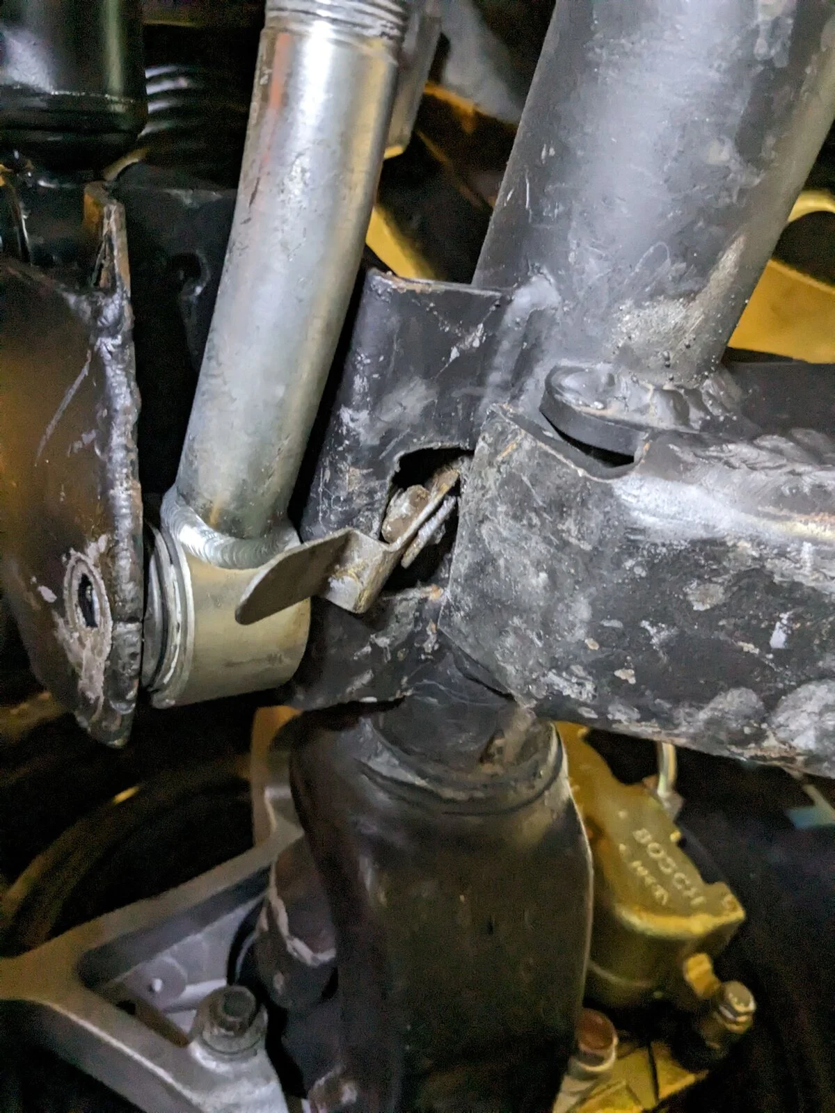

Then I went to remove one upper's bolt at the axle and loosen the jam nuts on the lowers. That's when I found this on the passenger lower....
No way this could be contributing to darty & twitchy conditions... 😶
So I fixed put that joint back together. Only about 50 miles on it and not sure when it came loose but there was no visible damage to the bushing.

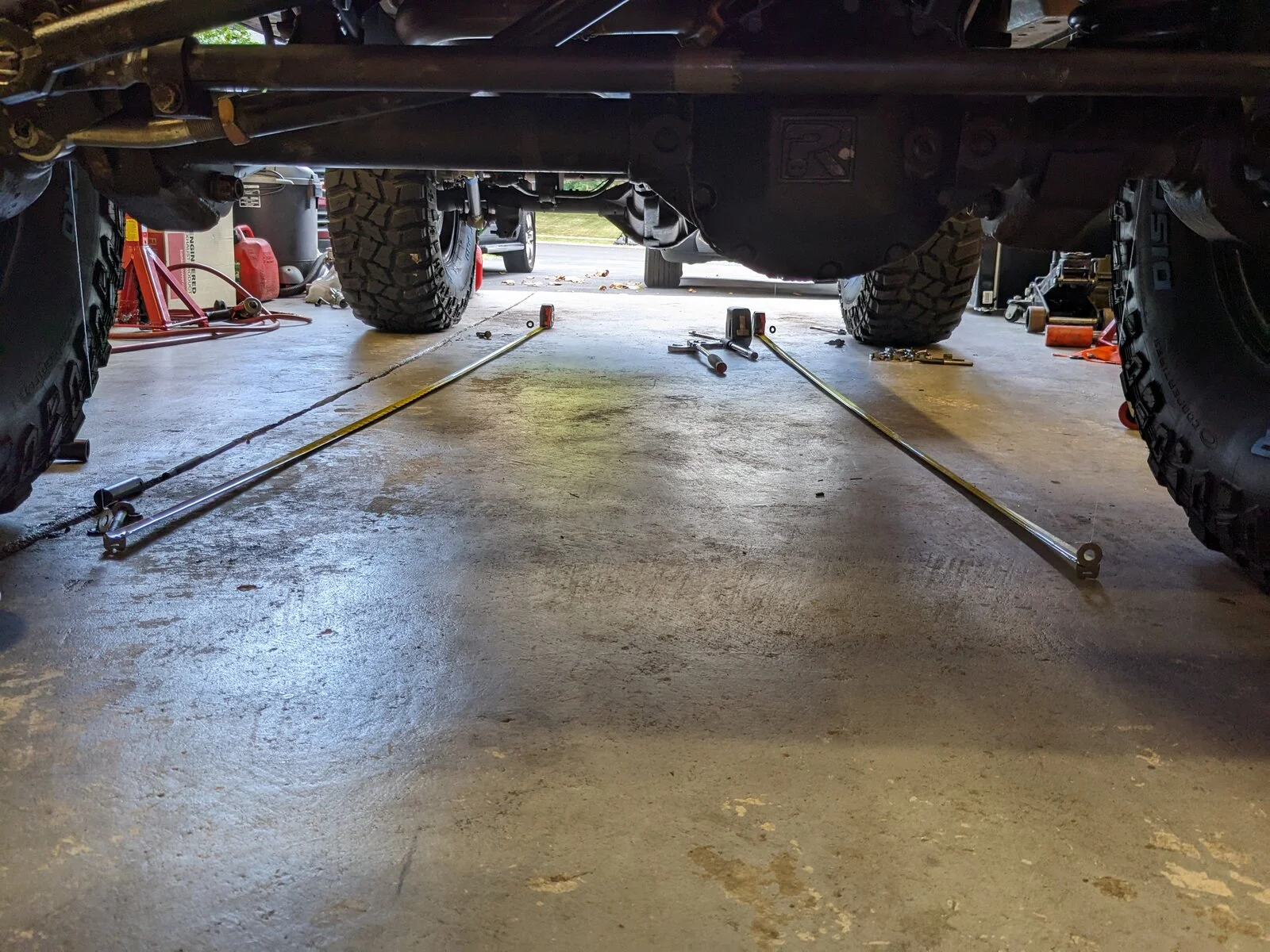

Got a little bit of time out in the garage today to adjust and measure the axles.
Measured the front axle just inside the C to the front of the first side body mount bracket and the front of the TC skid. Made 1 fill turn of the passenger front lower to bring the sides into alignment.
Measured the rear just outside the spring mounts to the middle TC skid bolt. Looked good.
I tried to see if the axles were square by dropping some finishing line over the axles with washers. Used a laser level to transfer that to the floor and then ran a couple tape measures down each side. A really rough estimate but best I could do on my own.
It was within a 1/8" which is what I was hoping to be, given how much variability is in this attempt at a measurement. If it was a bigger variance than that, I'd have wanted to try a better way to measure.

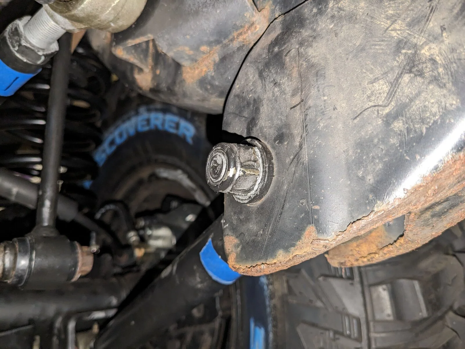

Finally got to wrenching this weekend. Friday, I went out and installed new lower control arm nuts from Gerald at Savvy after I reached out due to the nutserts being concerningly low on thread engagement.
Original hardware from Savvy had thick washers and nutserts:
New hardware is standard Grade 8 washers with top lock nuts:
Much better!! (y) Look at that thread engagement 😍

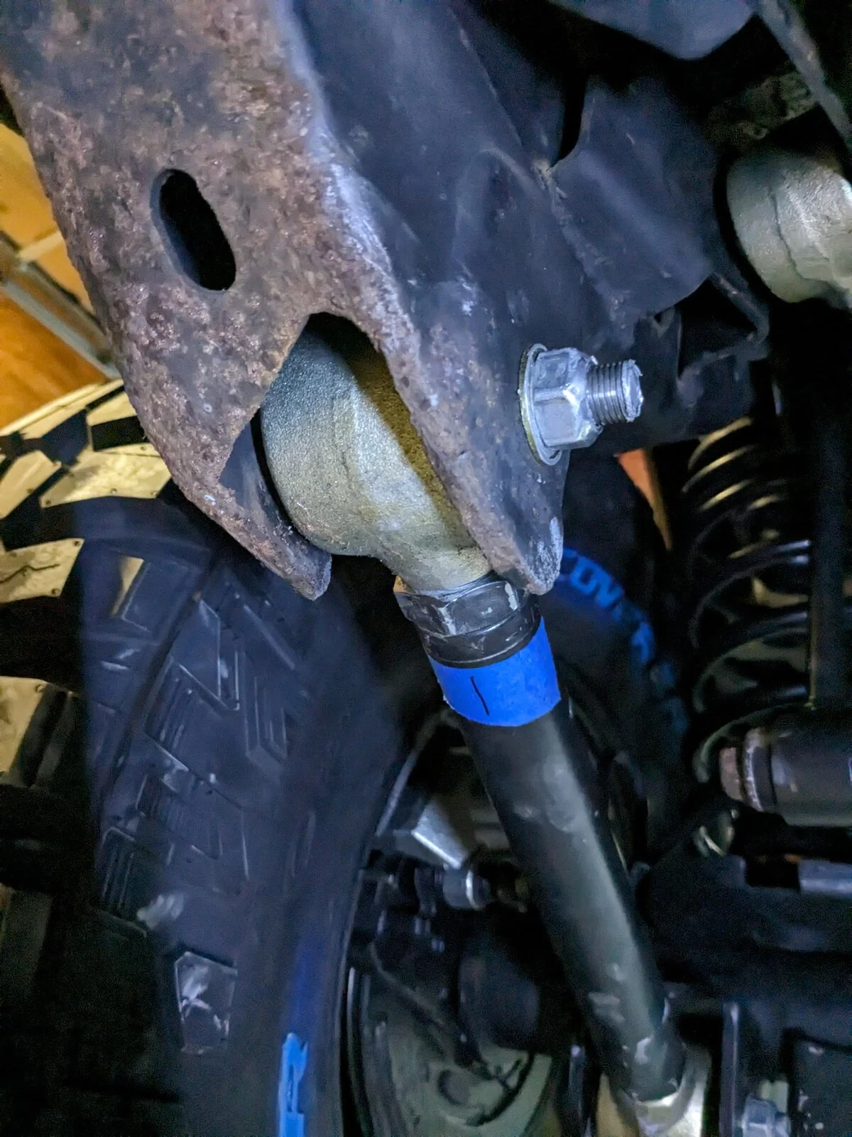

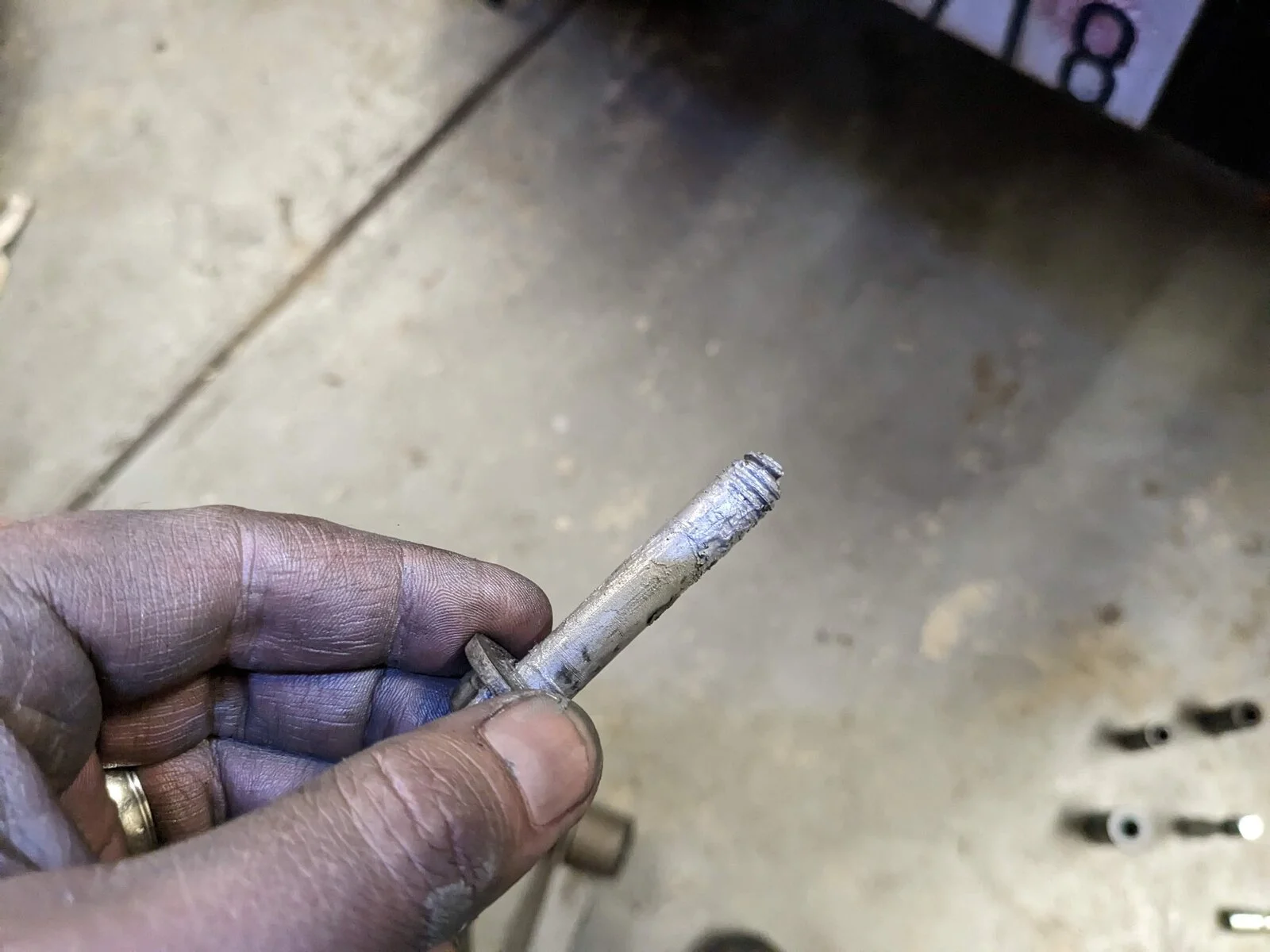

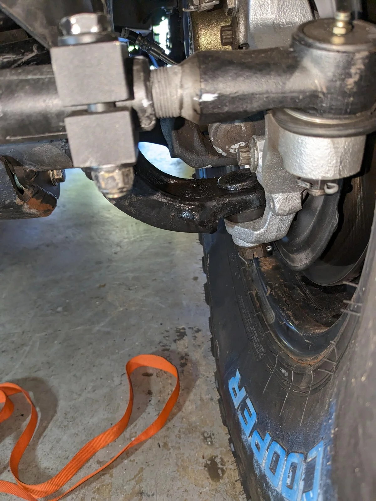

Apparently Currie updated their track bar design to change from a rubber bushing at the axle to a JJ. When they went to JJ - they upgraded the stock bolt to a 1/2" bolt.
Well OEM 10mm didn't like the torque spec of a 1/2" bolt...

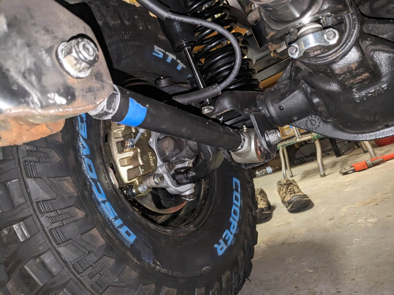

Also, as I replaced the lower control arm, I must has welded in the new lower mount on the driver side about 1/4" off from stock. I had installed the axle without the brakes installed.
Found the bolt wasn't coming out with the brake rotor in place...
So today, I pulled the tire and rotor and the dust shield flexed the needed amount for the bolt to come out.
Installed the bolt with the new washers from the differential side on this side.
I picked up 1/2" bolts (2.5" and 3" as I wasn't sure what size would work best) this morning.
That's when I realized the rubber bushing and it sized for the 10mm.

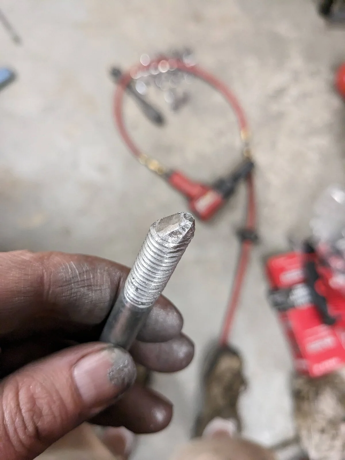

I foolishly tried to drill out the sleeve to fit a 1/2" - hoping to use the 1/2" bolt in the bushing while I ordered and awaited the new Currie JJ design. After getting 1/8" into the bushing after several minutes on the drill press - I realize this was a fools errand.
So I went to Lowe's and they luckily had 10.9 10mm.
Unfortunately, the bushing wasn't 100% square and the OEM taper had made that work. So I put a rethread tool on the bolt and then hit it with a flap disc. Removing the rethread tool them made the threads at the end of the bolt usable.
I put the tip offset to match where the rear hole was off-set.
I also welded up a nut holder for the 'blind' nut
Bolt went in and the new blind-nut all worked. Trackbar is back in with all the hardware but I needed to stop before I torqued everything. So that will be tomorrow's starting point.
Hopeful to drive again (with the suspension at proper torque & no JJ's falling apart... Compared to this journey so far) this weekend...

I also have ordered the JJ track bar for the front at the axle. So that will bump it up to 1/2" and a JJ which should help in getting the bolt installed (compared to this weekend's bolt modification).

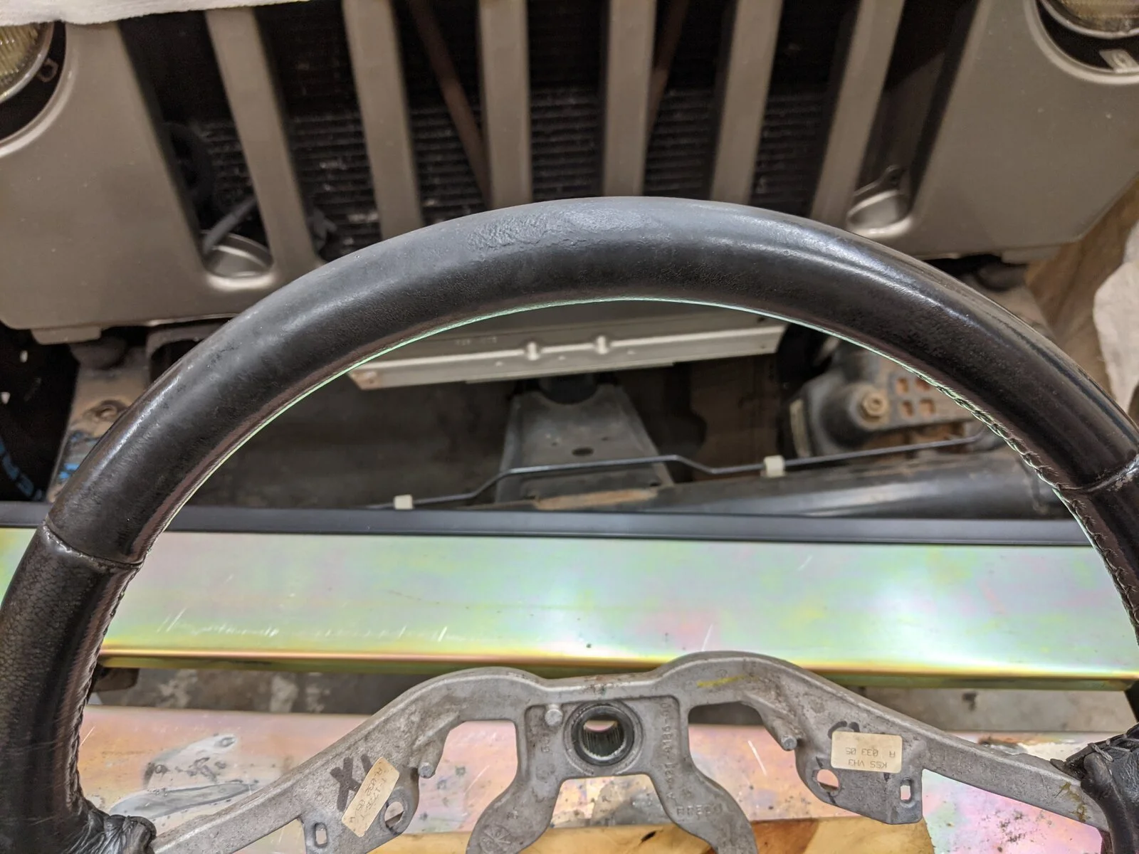

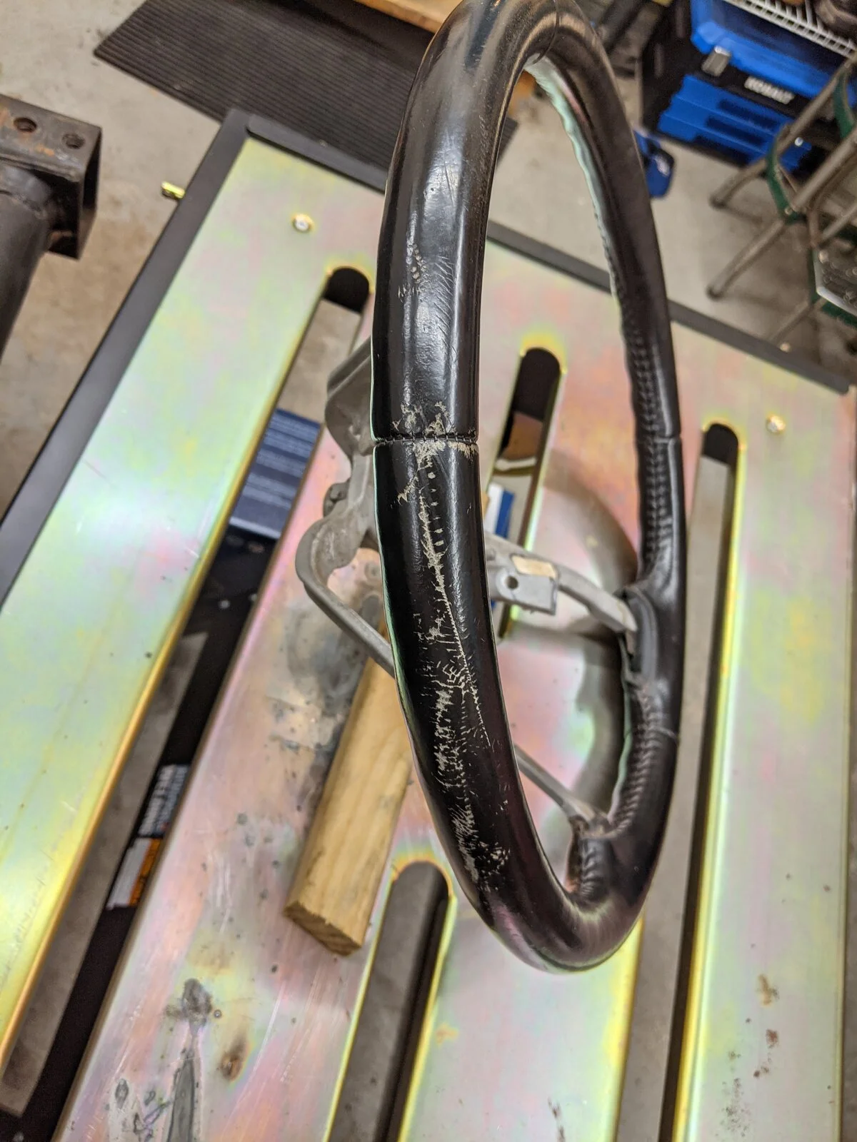

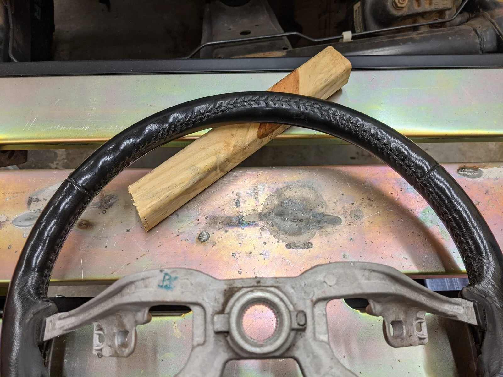

I don't believe I posted this yet. While the other upgrades were going in, I replaced the steering wheel leather.
I typically drive with my left hand on the top of the wheel. Over time, this has worn that area - and on humid days the wheel was deteriorating and coming apart in my hand.
Old wheel:
Wear on the wheel:
Leather may have shifted some...
I carry a pocket knife regularly and sometimes the latch caught the wheel when hopping in:

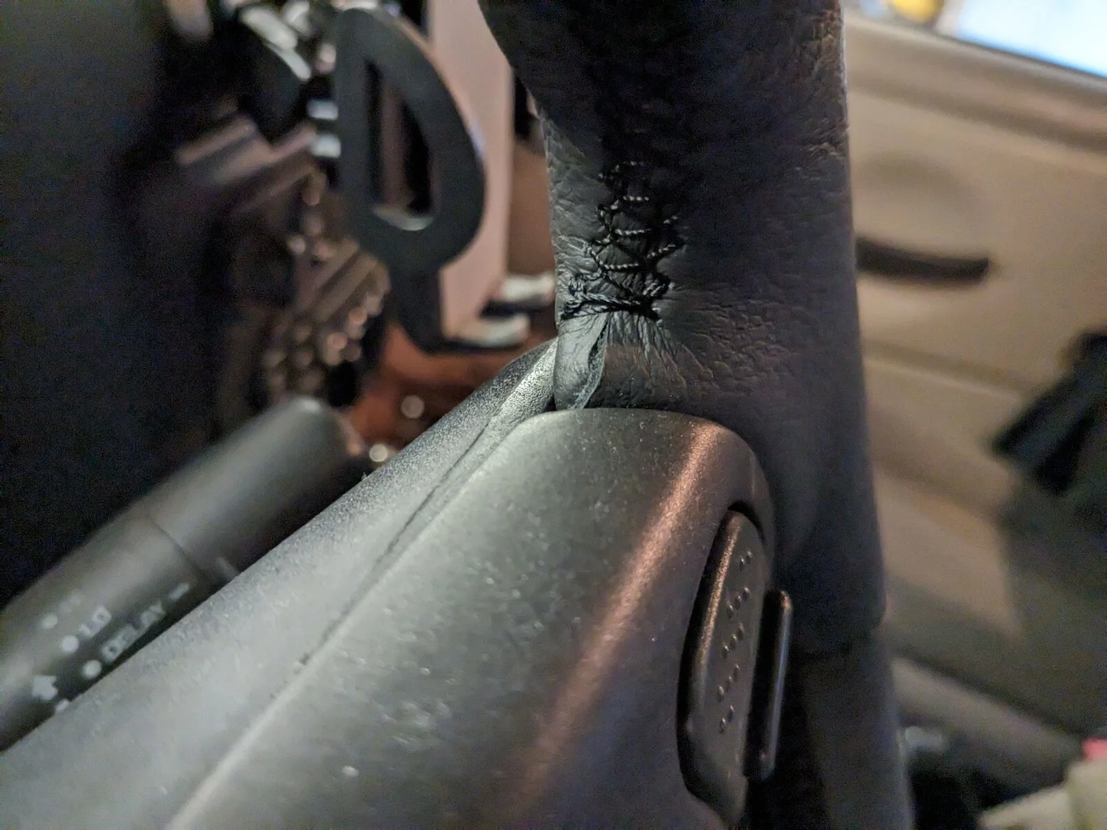

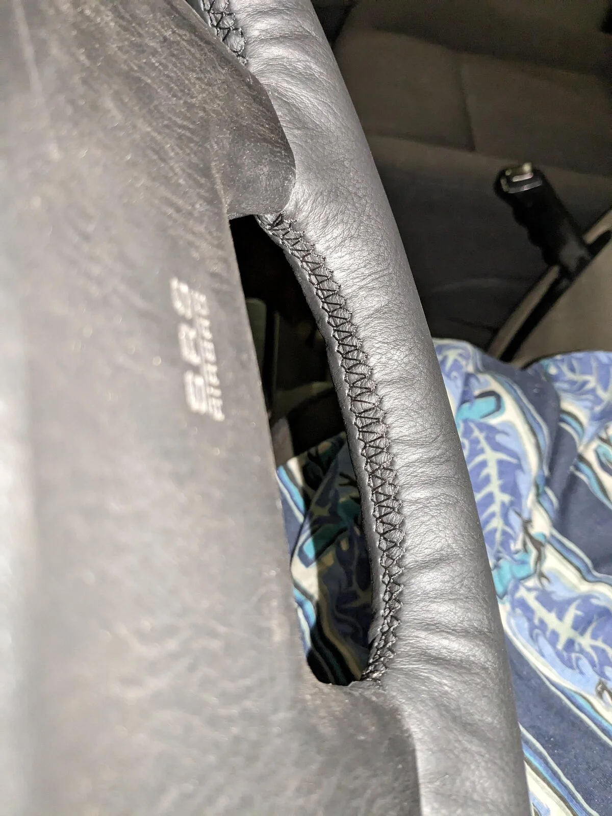

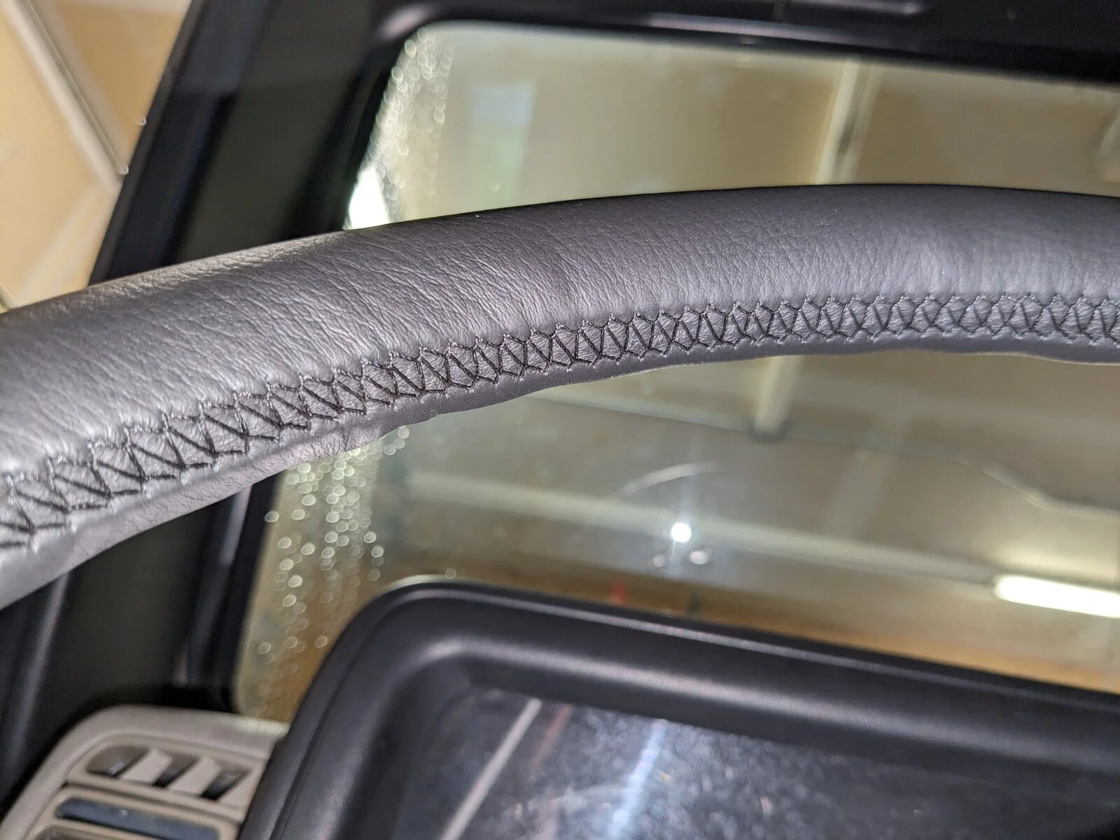

So I ordered a new steering wheel cover & padding from Redline Goods. I knew my sewing skills weren't up to it so I added the installer payment where I ship out the wheel and an installer puts on the leather.
Wheel installed with the leather. It's not OEM smooth but it's pretty good. Way better install than I could do and way better than a cheap $20 cover...
(Blue sheet in the background is to keep my greasy clothes from rubbing on the seat ;))

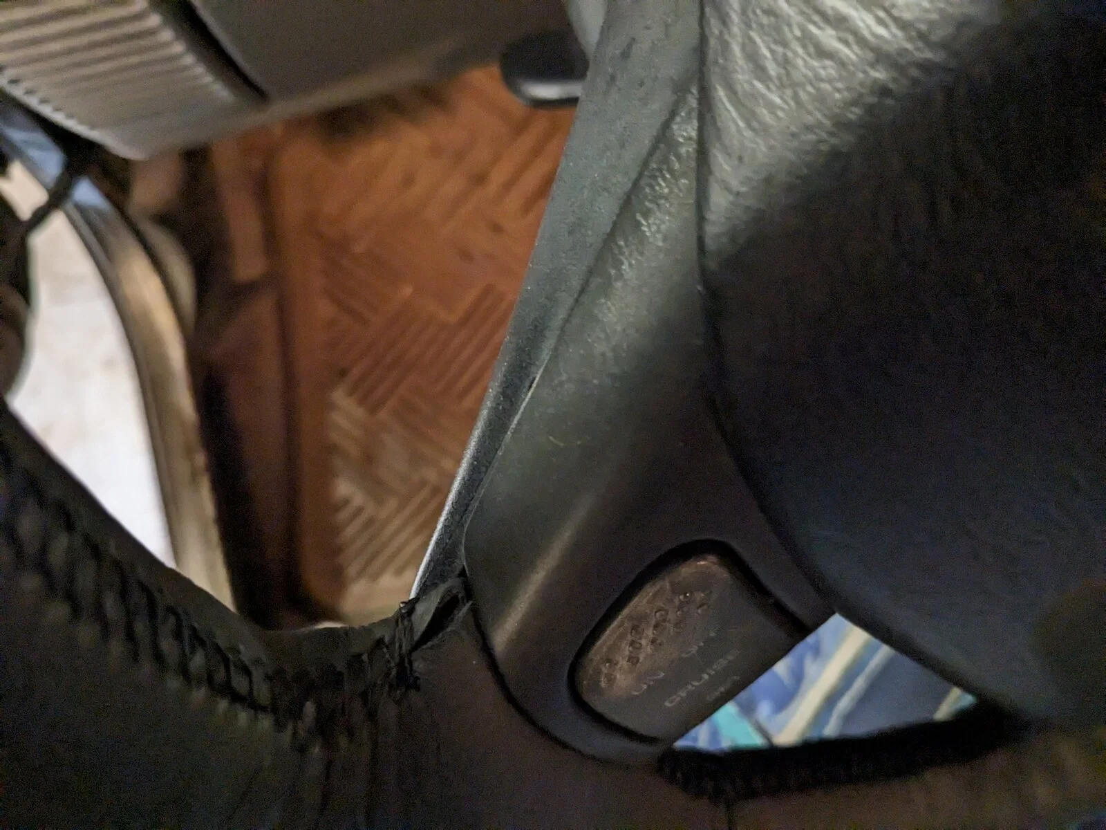

My only issue is just above the left switches:
I wish they had brought the stitching down more to close the gap. Installer did a little better on the right side.

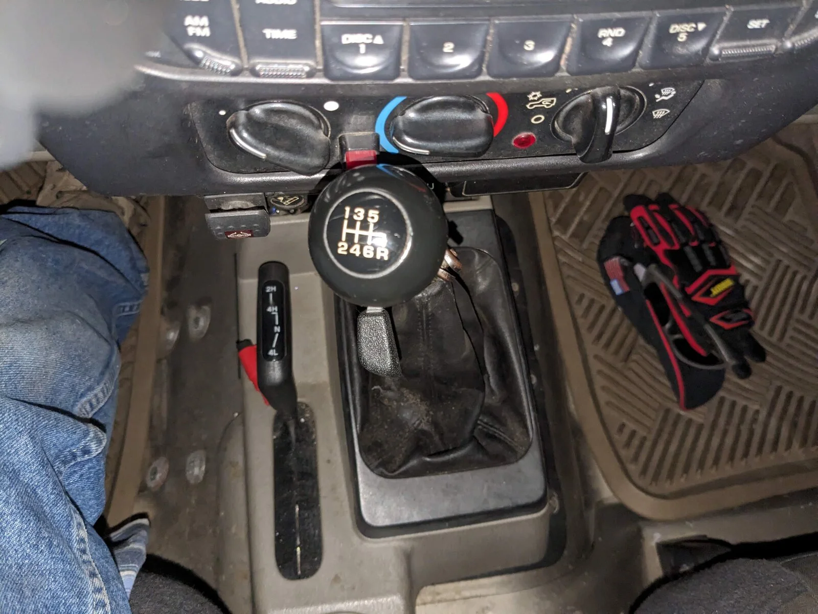

Shifter needs bent back:

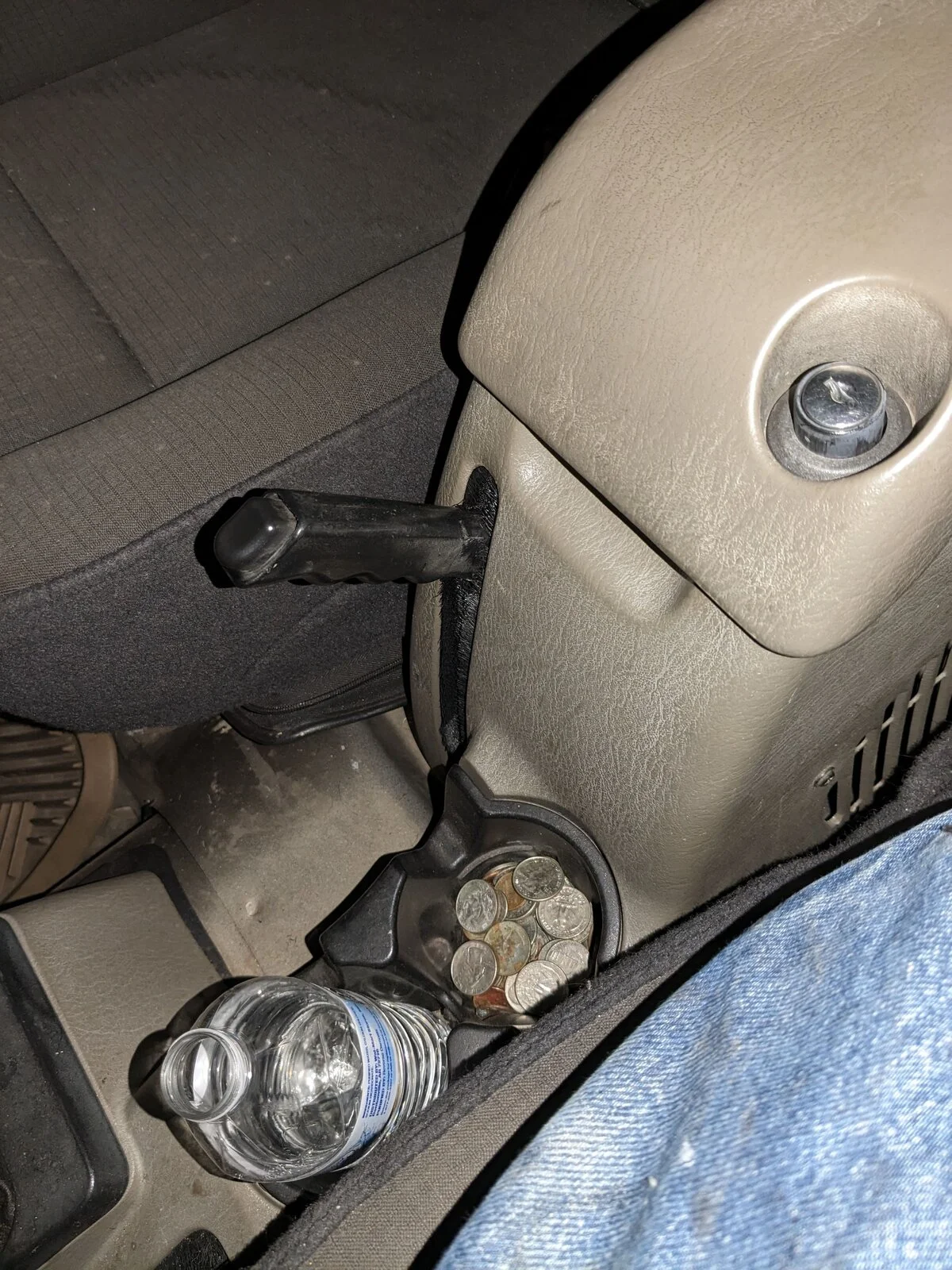

Need to adjust the parking brake
