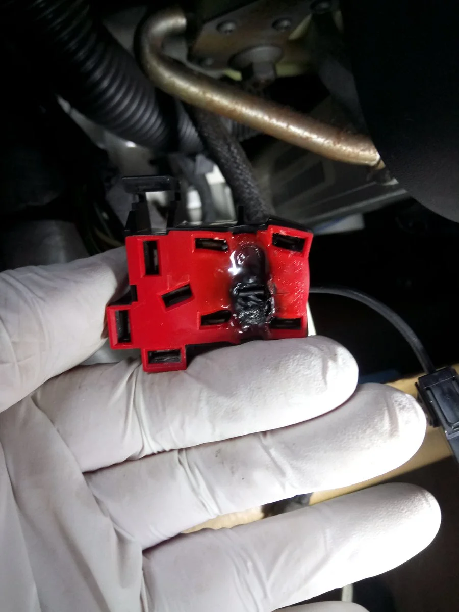

Probably I'm wrong,
i also had a burnt smell in the TJ, it was a melted plug on the light switch.
