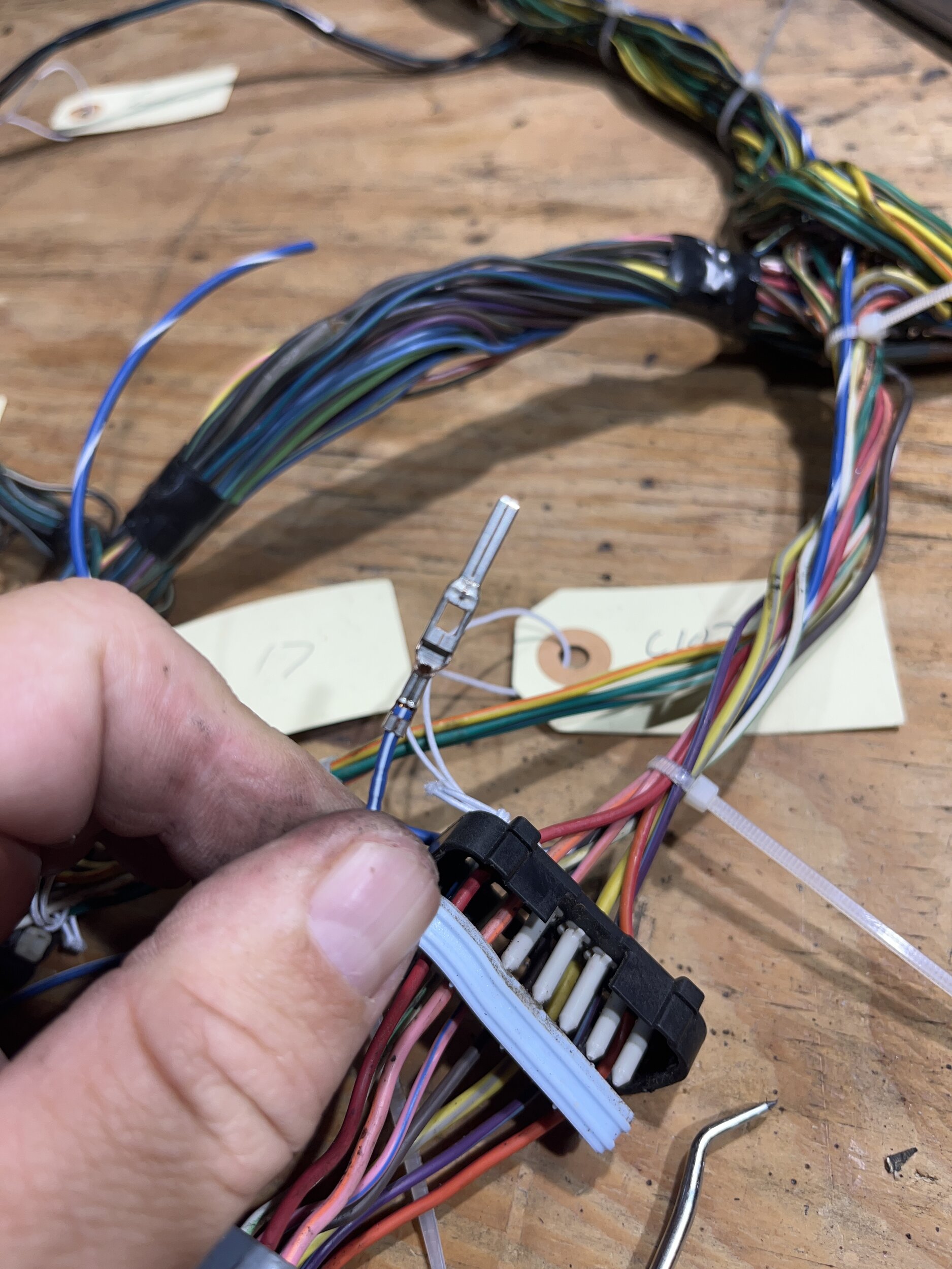

I’m in the process of replacing a few damaged wires in my body wiring harness. Instead of just putting butt connectors inline, I’m unpinning the wires from connector to connector (probably overkill, but that’s the way I want to do it). Does anyone know the name or specs of the terminals in the c102 connector?

How on earth did you know that?? Are all the terminal styles documented somewhere? Would be great to have a reference for that.
It’s a very common connector line used by most OEMs. Not jeep specific at all. I do a lot of wiring so I am familiar with a lot of connectors.
For me, the challenge is even knowing how to search it up. If we had a reference for all the connectors and the terminal type it would make some repairs much more feasible. I know I would much rather re-pin a wire than replace an entire connector and splice in every wire when only one or two wires are problematic.
In the old drawings you will see Delphi. They split in 2017 and Aptiv becoming what you see now. Personally I prefer the Deutsch HDP series. Equal parts, just more forgiving in my experience. But that is coming from working on airplanes not cars. Did you get everything replaced and connected? Was there any other damage to the harness? I am going to do a frame swap and looking for hints as to what I might run into.
Finally got it up and running. There were 3 or 4 wires that were damaged where the harness goes under the firewall. Found 4 other wires with damage, however I believe 2 of the other 4 were self inflicted while removing the harness. All good now, no check engine lights and starts every time I turn the key. Good luck on your restoration.
