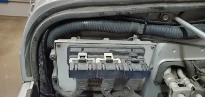

This is true, though not going as quickly as I'd like. Did a survey of my V1 design installation a few weeks ago, now going on 2-2.5 years installed. Still doing the job and holding up well, though I have noted a few items for revision in the V2 design.
