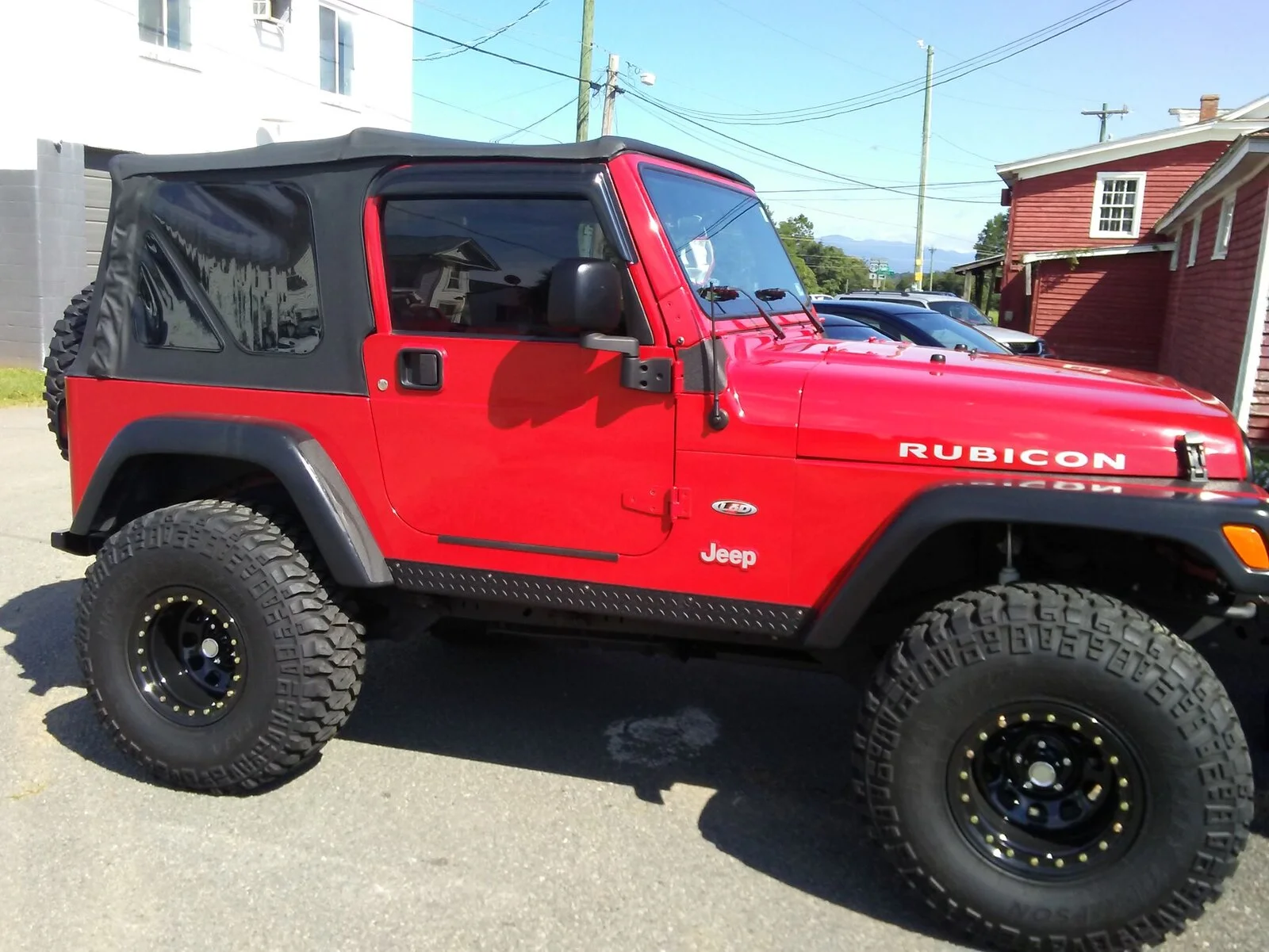

Apparently the lift wasn't done right if it's that bad. You need at least 4.88 gears with 35s and a 5-6 speed. 5.38 or deeper for the 42rle. My Jeep rides and handles much better than it did stock with 31s.

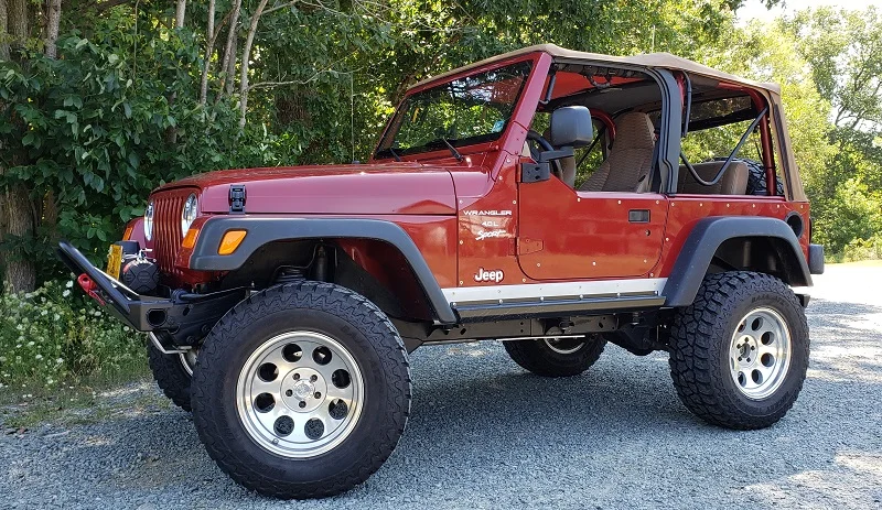

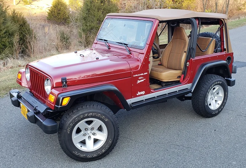

I'm with Chris. Run a 1" H&R spring, 1" BL, a 31" tire and drive it for fun. I've run everything from stock to 35" tires and my absolute favorite is a TJ on 31" tires.
Sure they look cool on 33s or 35s, but the driving experience isn't the same. Can it be? Sure, but you have to spend a ton of money with someone that knows what they're doing. Below is a TJ I built last year. The first picture is on a 4" lift and 33" tires. It drove decent, but lost the zippiness I'd grown accustomed to in a TJ.
Picture #2 shows it when I lightened it, took it back to 1" H&R springs, with a 1" BL and 31" tires. It was much, much more fun to drive in this form. If I ever get another TJ, as a driver, 31" tires and a lightweight build will be the standard.
The good news is you can still wheel them like this. You just need to tuck the skids and focus on tire placement.
