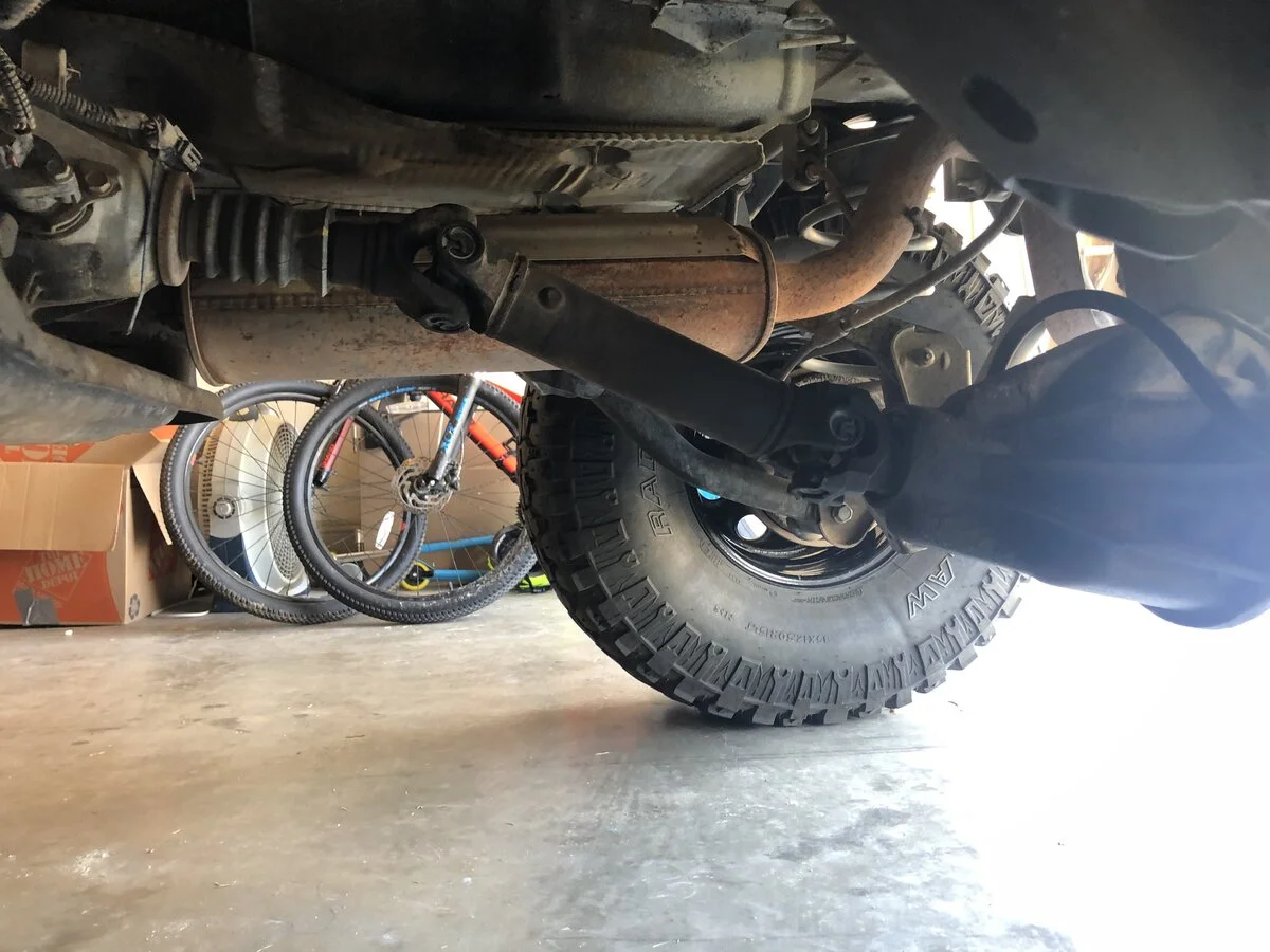

Quick question, can I install adjustable control arms before installing a SYE to see if I can eliminate driveline vibrations?
I can add pics if it helps.
This was all done by PO.

I just want to see pictures of how big this transfer case drop is ;)
Don’t roast me to hard.

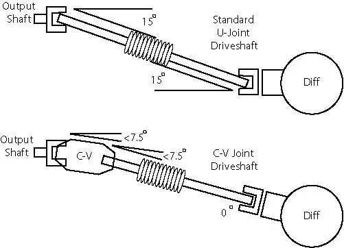

Installing a lift will change the pinion angle out of specs and will need to be re-adjusted. Here is a good representation of how your pinion angle should be depending on if you have a SYE (C-V joint) or not. We have a similar lift on our '04 TJ with no SYE. We had to get adjustable UCA's to get the pinion angle adjusted properly to eliminate the drive-line vibration that we had. Once adjusted, the vibration disappeared. If it doesn't work, then you will need to check other portions of the drive-train for wear. The angles shown below would change depending on the size of the lift. The take-away is that without a SYE, the output shaft and the input shaft for the diff need to be parallel. With a SYE, the driveshaft needs to go straight into the diff input shaft with no angle. Until you get the SYE, you should also have a transfer case drop to help reduce the angle.
