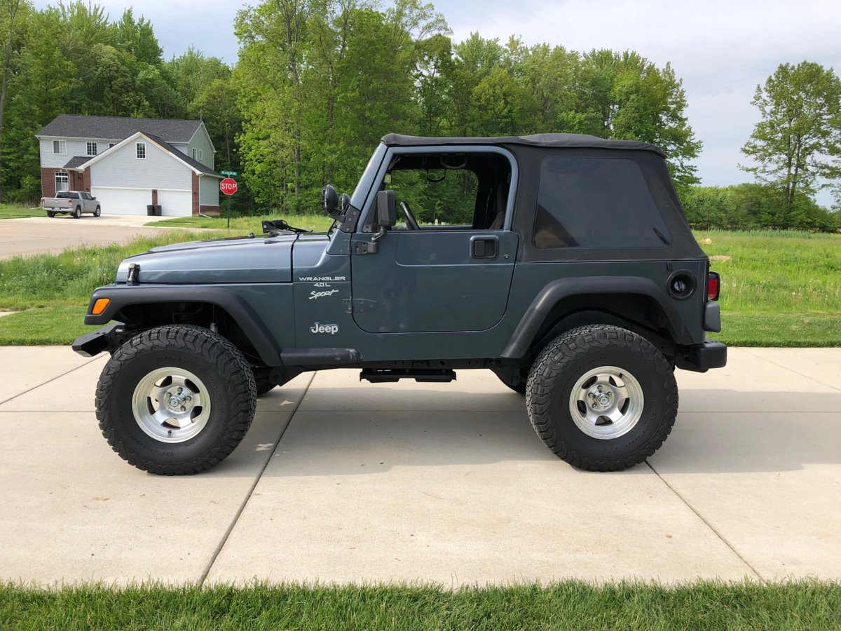

33x10.50x15 KM2's on 15x8 M/T Classis II's with 3.6" of backspace..shown with 6" metalcloak flares
Reactions: BobK
That looks great. What made you choose 10.5 vs 12.5? Just curious since I haven't made up my mind yet.
I originally bought them for a 4cyl YJ, so was looking for lighter weight and less rolling resistance, but then the YJ got these 31's that came on the TJ when I bought it instead
I haven't noticed any downside to the narrower tires in either my everyday driving or any of the wheeling I've done with them so far
