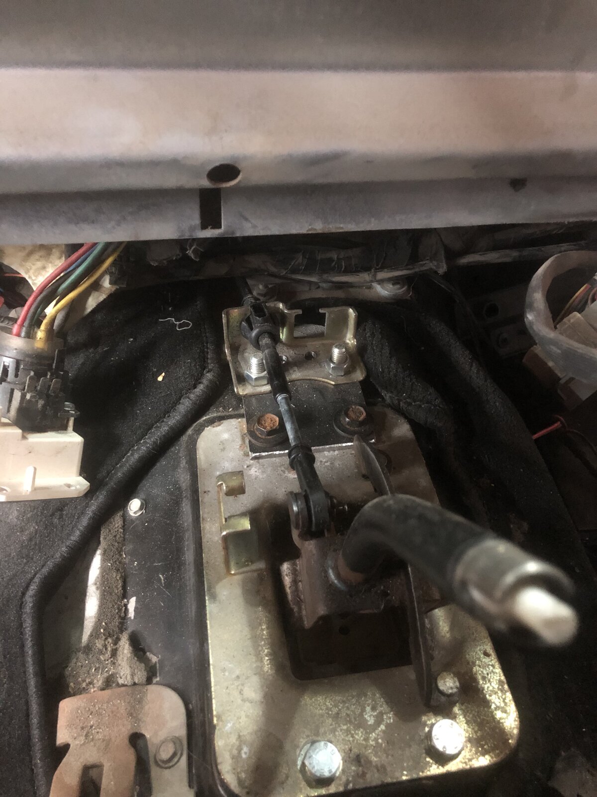

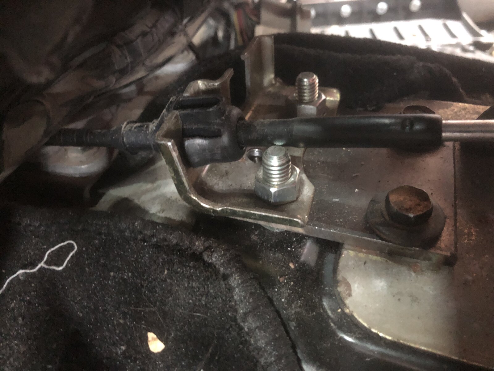

That would be great to see a pic of your modification you did to the shift cable mount.

So I cut the bracket off and added an extension plate and tapped out the bolt holes once I figured out the exact location.
