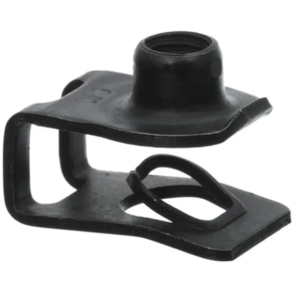

I don't remember off the top of my head the bolt size, but figured I'd share to not forget to get the nuts since they're single use (they're stover style locking nuts). Part 6506546AA

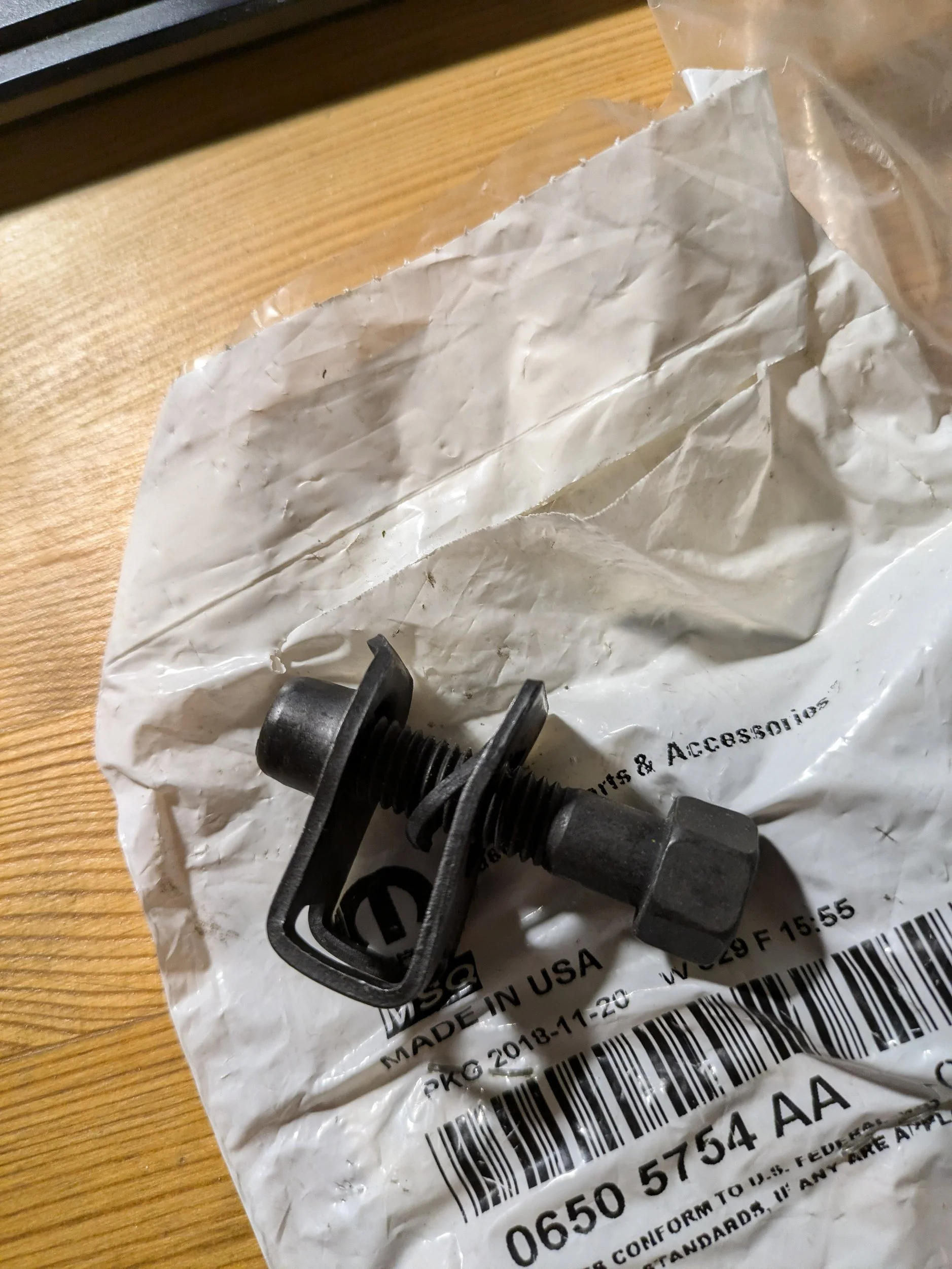

Does anyone know what size / thread count bolts to use for the OEM captive nuts part # 6506546AA. I have tried 10mm 1.5 pitch bolts & 3/8 course thread bolts. Both of them stop when I get the first turn in. The factory bolts part # 6505754AA are at least $30. There has to be some size / pattern that works for this nut
