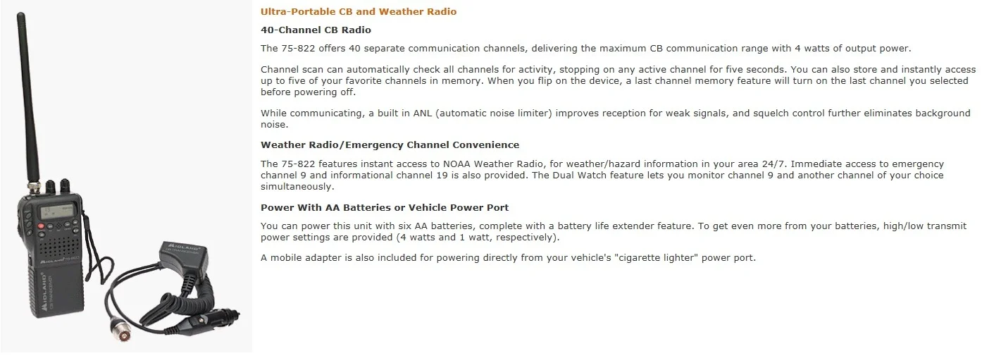

A family member just gave me a nearly brand new portable CB set-up that includes the following:
Midland 75-822 40 Channel CB

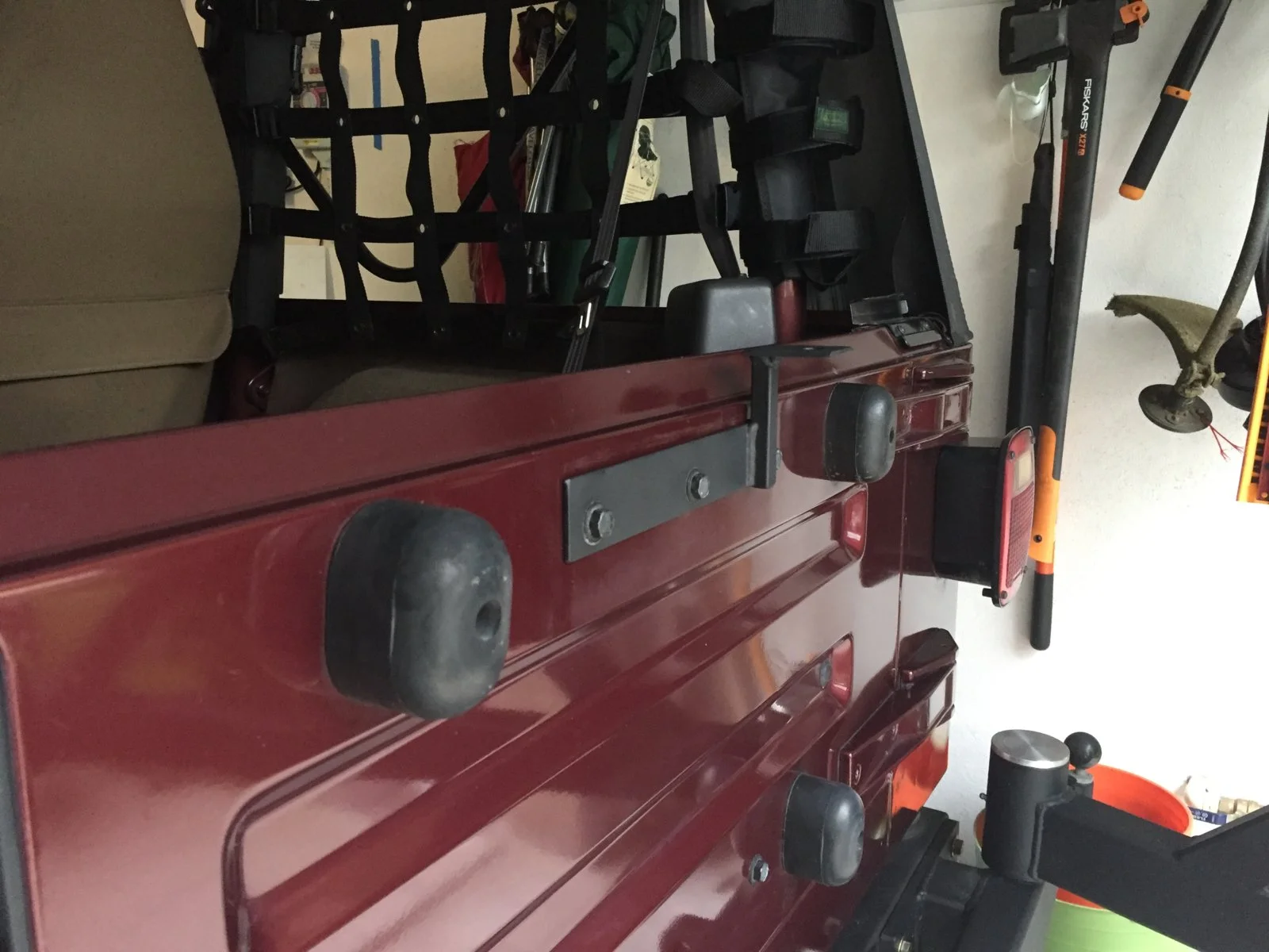

Updating this thread. Life got in the way so everything has been sitting around until this week.

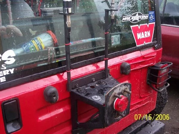

I had ordered the Teraflex antenna mount and the Firestick quick disconnect along with a new stud. Once I started fussing with the antenna mount I realized that I didn't really like the design at all (honestly for mostly aesthetic reasons and I just didn't want the antenna on the side of the Jeep) and I looked for another alternative. I previously ran across Arizona Rocky Road mounts, but their very tall design didn't make sense for my application. If I keep the bracket on all the time the original design would have it sticking out way over the gate and I didn't want the possibility of the dogs whacking their faces on it when the net is up, or interfering with loading bags in and out of the back.
This is the dual mount, but you can see how tall they normally are.

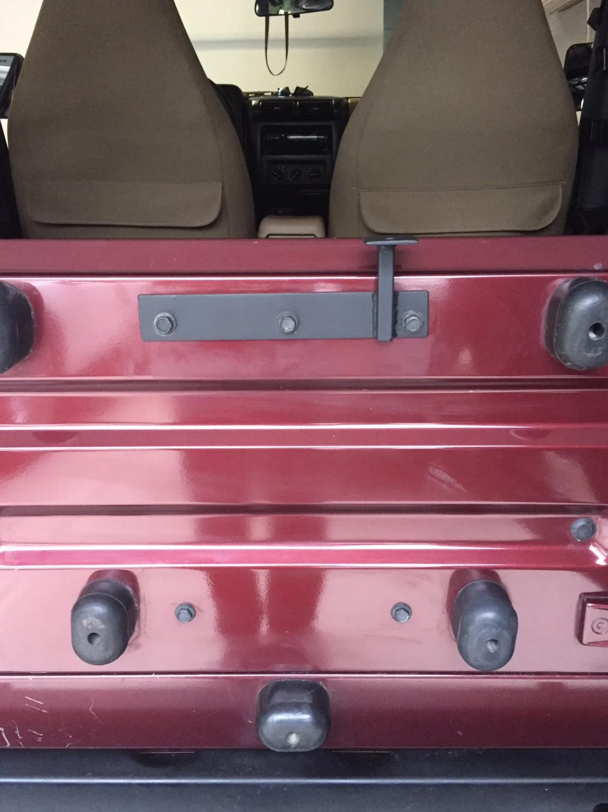

After looking at my pile of parts and trying to figure out the best way to move forward I decided to email Rick and see if he could change up his design to meet my needs. He was totally open to it, and I do believe that I have exactly what I want.
I'm going to use the Firestick Firering cable that I have with the ARR antenna mount and not use the quick disconnect. I'll experiment with TJ spring to decide if it's necessary. The ARR mount puts the antenna in the middle of the Jeep, which is great as it keeps the antenna out of the path of branches on the side of the trail.
I just test mounted it last night, but I think I've got this going in the right direction. I need to scrape out the paint around the mounting bolts and stud this weekend and then get it all mounted, but so far I'm happy.
