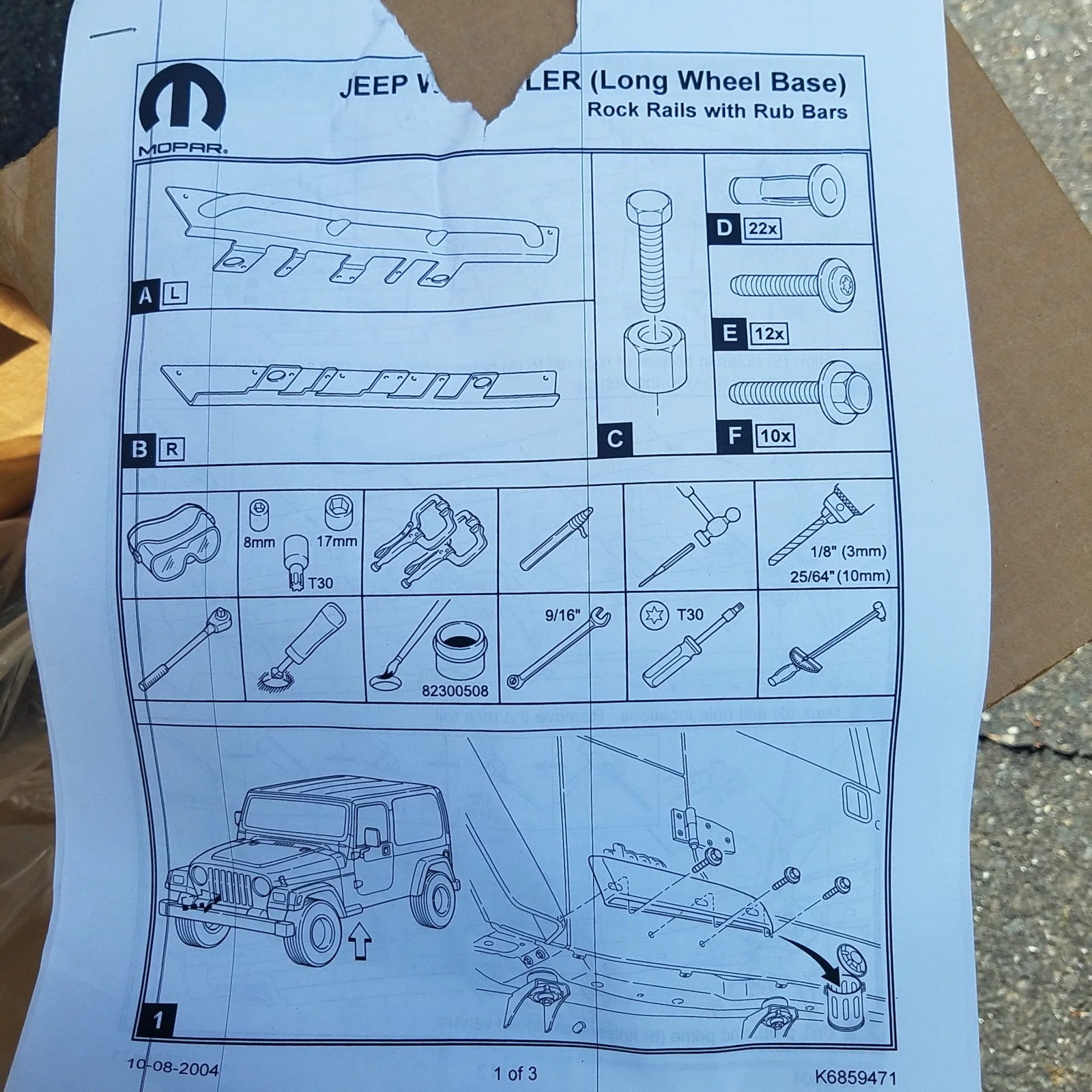

I have not put them on, I’m guessing it’s just plug and play from what it looks like. I have a 2004 rubicon tho. On my instructions it is different for 97-03, it showed a drill and stuff.. when I get home from work I will try to remember to send the full instructions I got with it

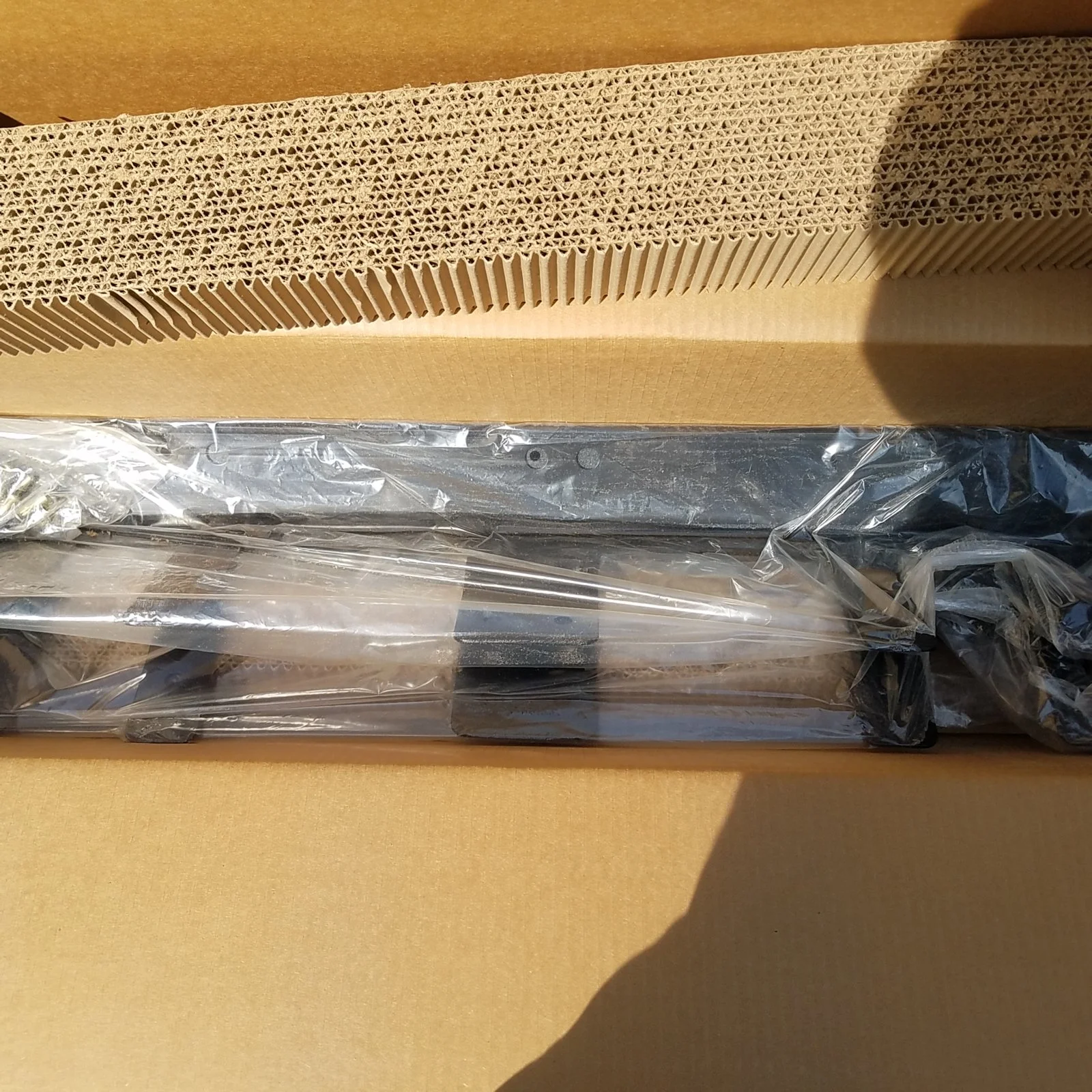

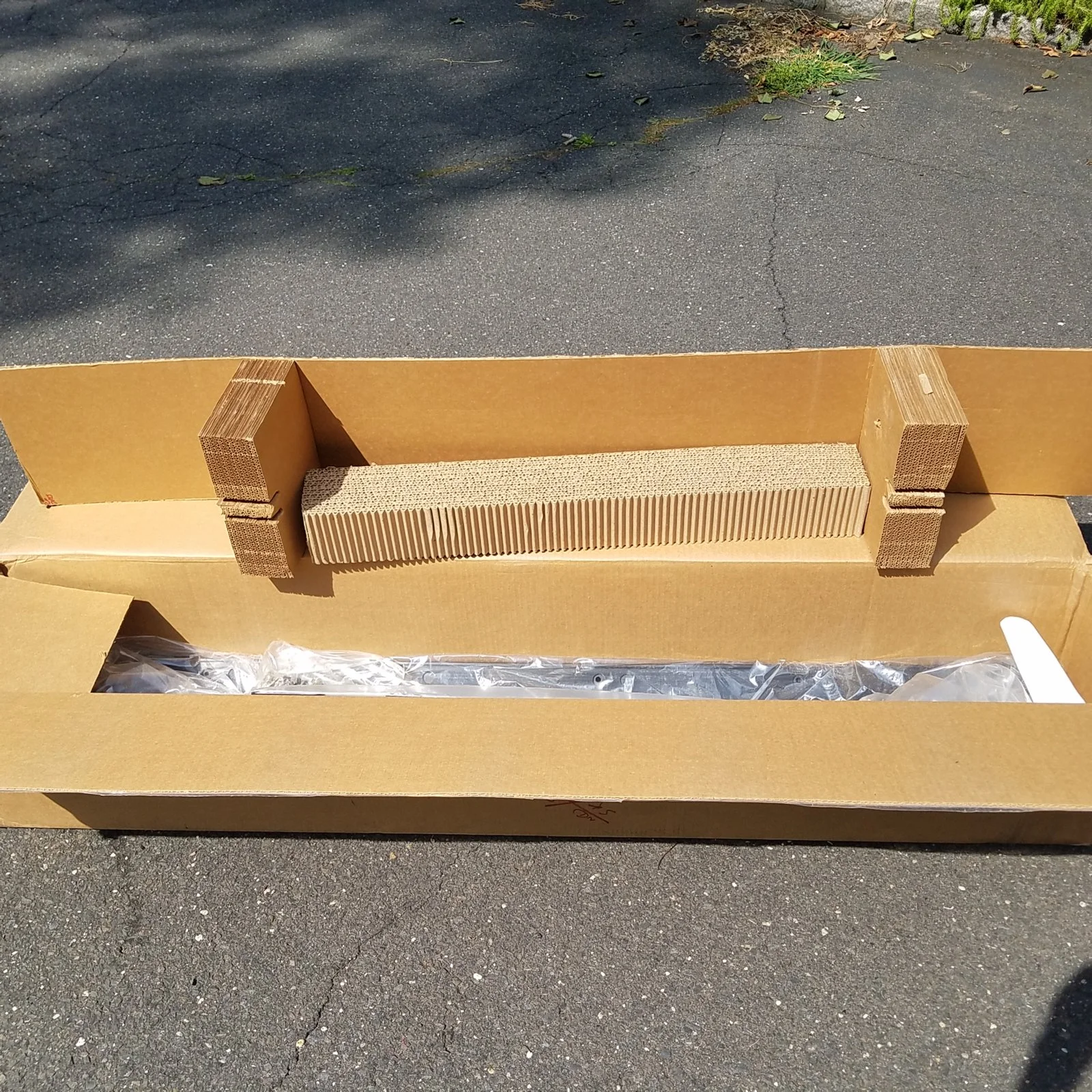

About a week after sending the money order the rock rails arrived, well packaged.

Install was a breeze, and no special tools are required. Directions are included, with tools listed for the install.

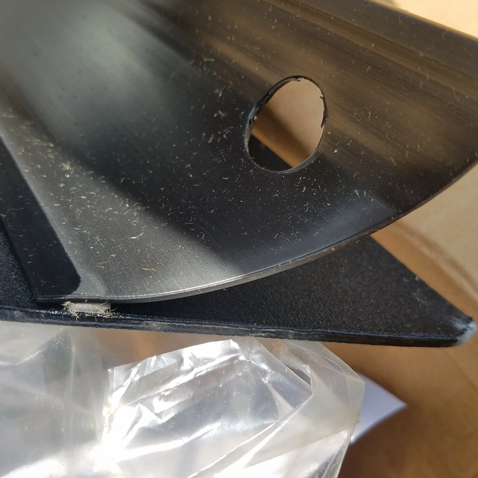

The rails have a rubber protector that sit between the rock rails and Jeeps body.

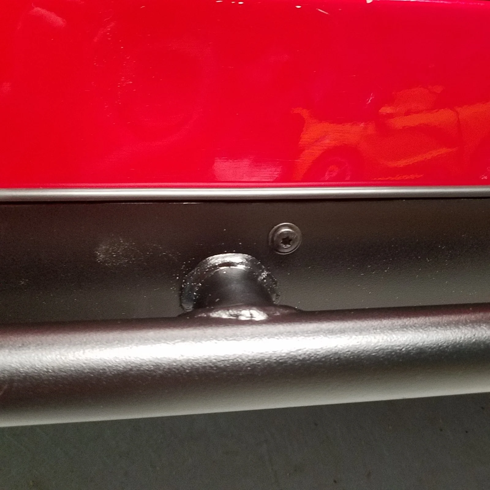

The rails connect to the body, and use the existing mounting holes located on the underside. You just use the supplied hardware to install, the nutserts and related tool. Nutserts are awesome!!! Then you must drill into the lower side of the body, use more nutserts, and then screw the rock rails into place.

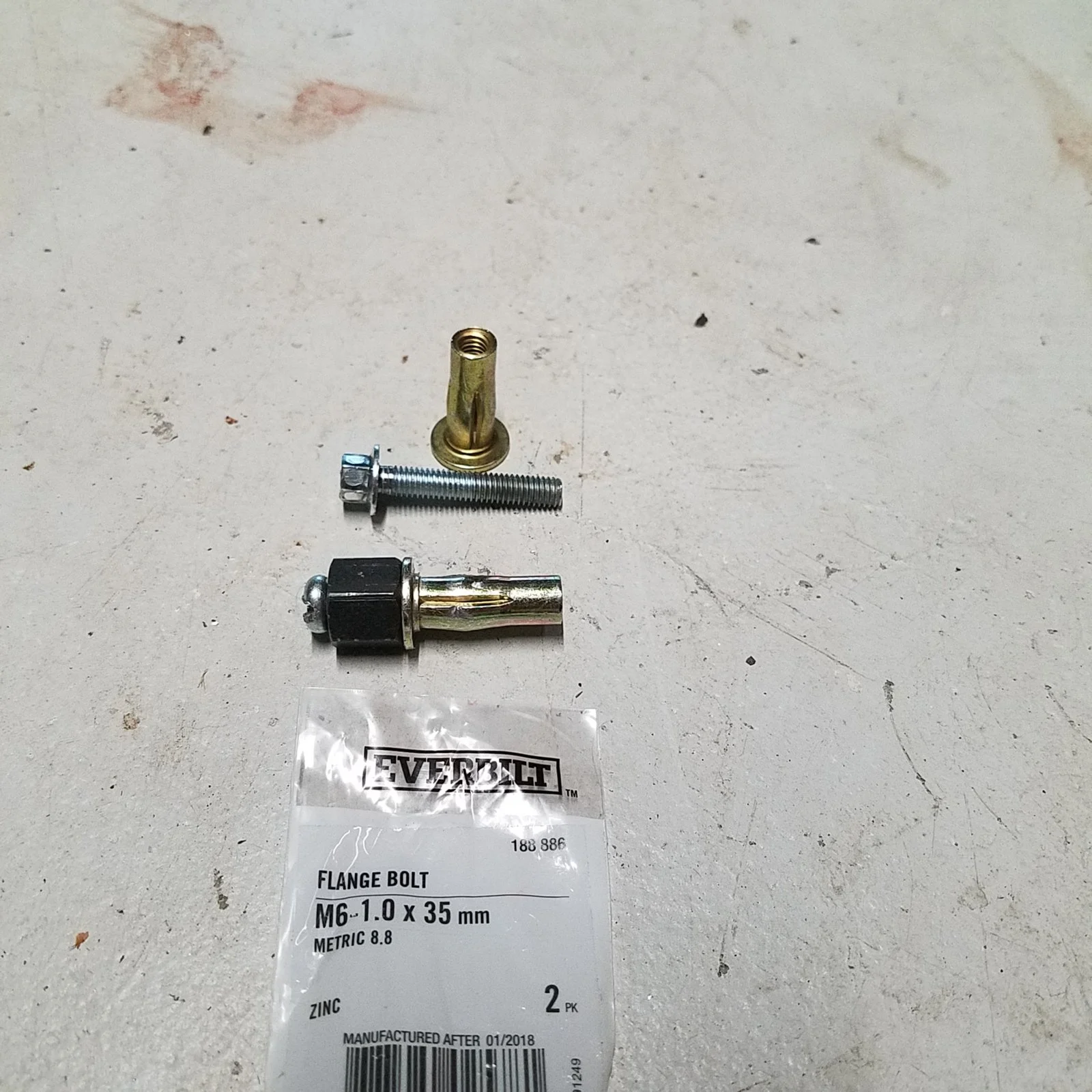

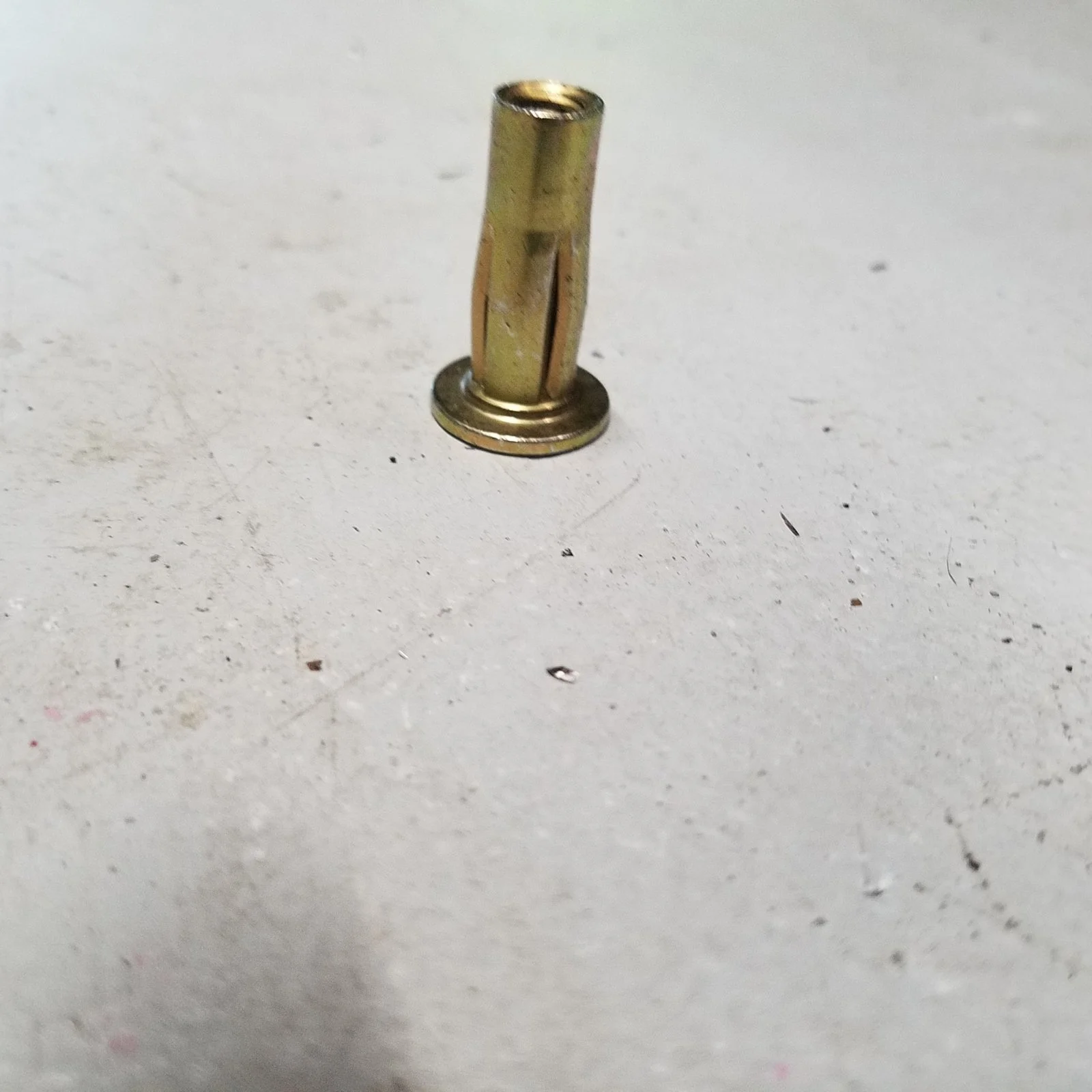

This is a variation of a nutsert. You drill a hole and plug the hole with a nutsert. You then use the supplied tool to crush it into place.
Nutsert
The tool, which is a bolt and nut. In the picture the tool is already inside the nutsert. Also, I had an extra flange bolt on hand just in case the tool broke.

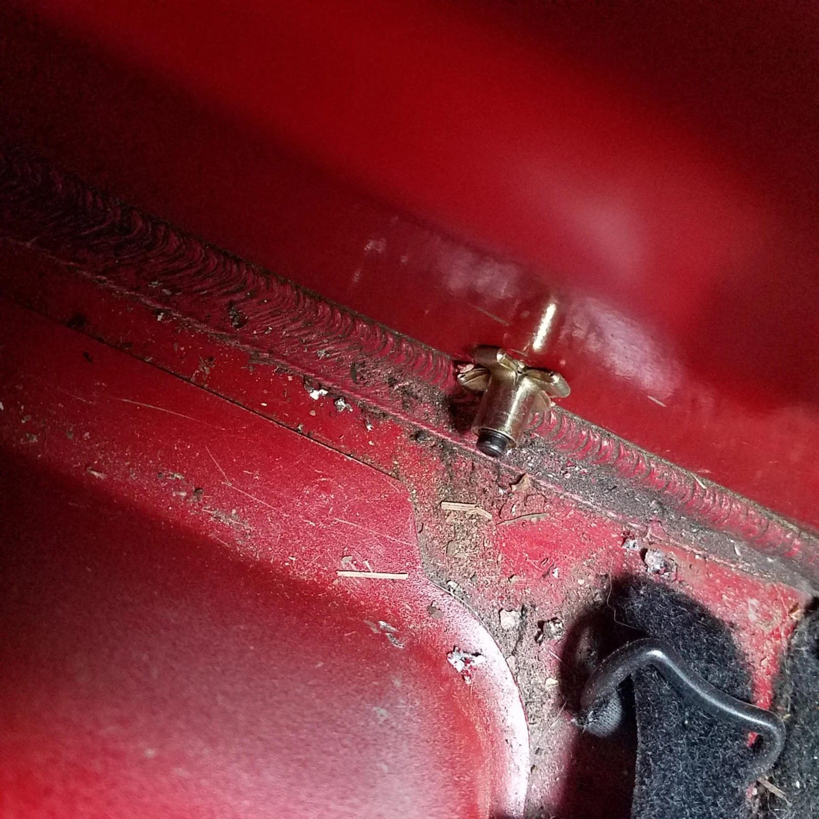

This is the nutsert after getting crushed and now ready to accept a screw. In this case the screw is already in there. This is where I drilled into the side of the body, passenger side where the spare tire jack parts are located. The carpet covers it up.

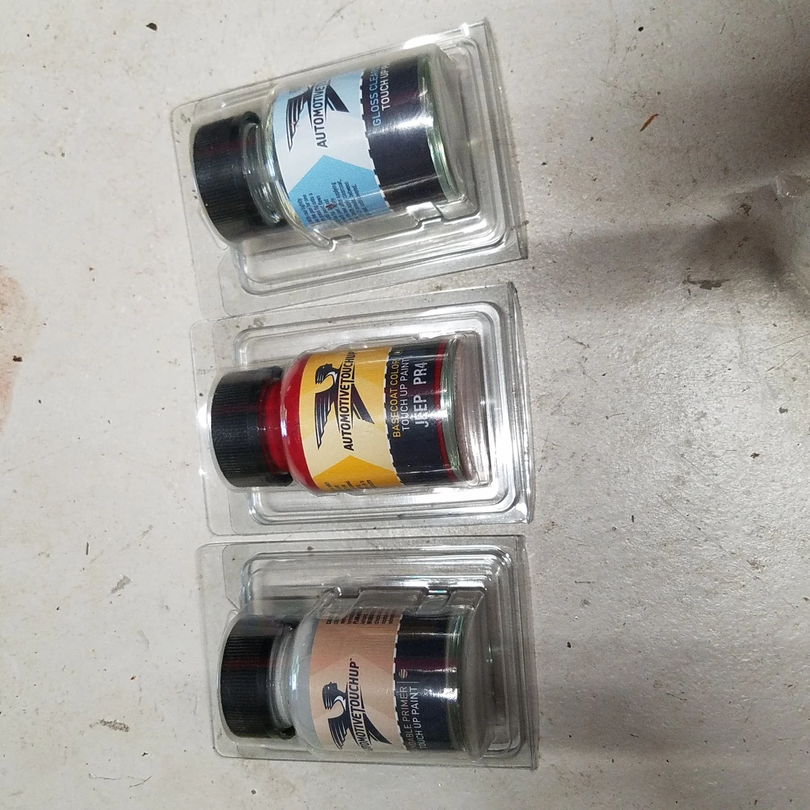

Before installing the nutserts, it is recommended to paint the holes to avoid rust. I purchased some primer, paint and clearcoat to do this, but also to touch up other areas of the Jeep, like rock chips and around the tub where it meets the hardtop.

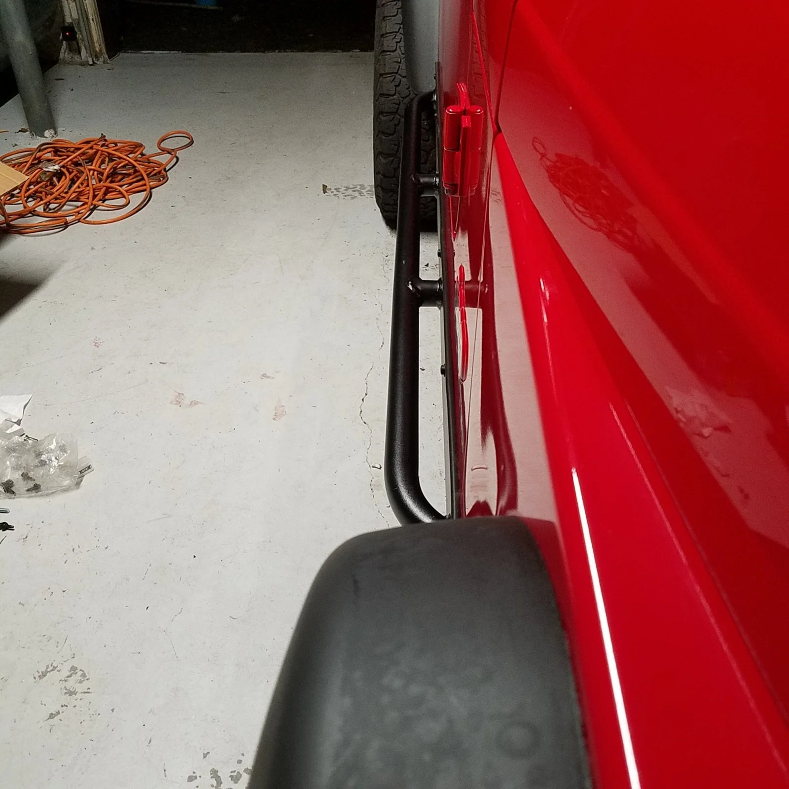

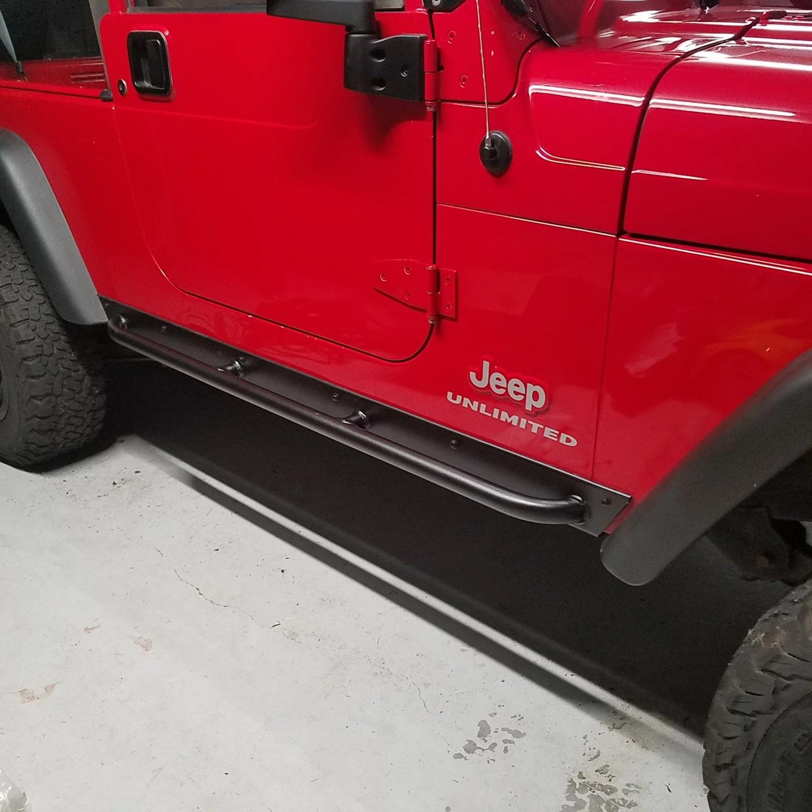

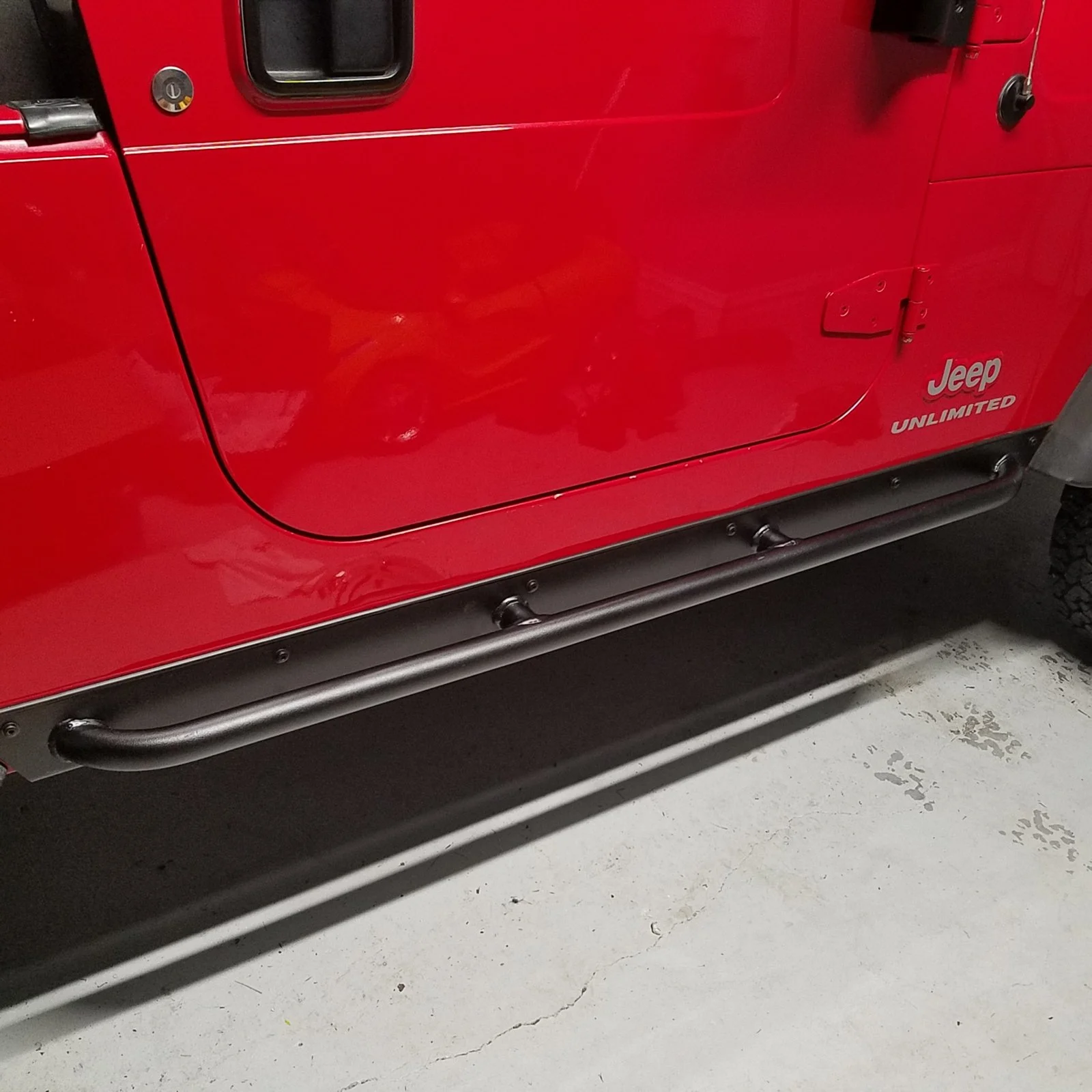

The finished product.
20180902_214605.jpg 20180902_214618.jpg 20180902_214626.jpg 20180903_075802.jpg
Nutsert
View attachment 54129 View attachment 54130 View attachment 54131 View attachment 54132
