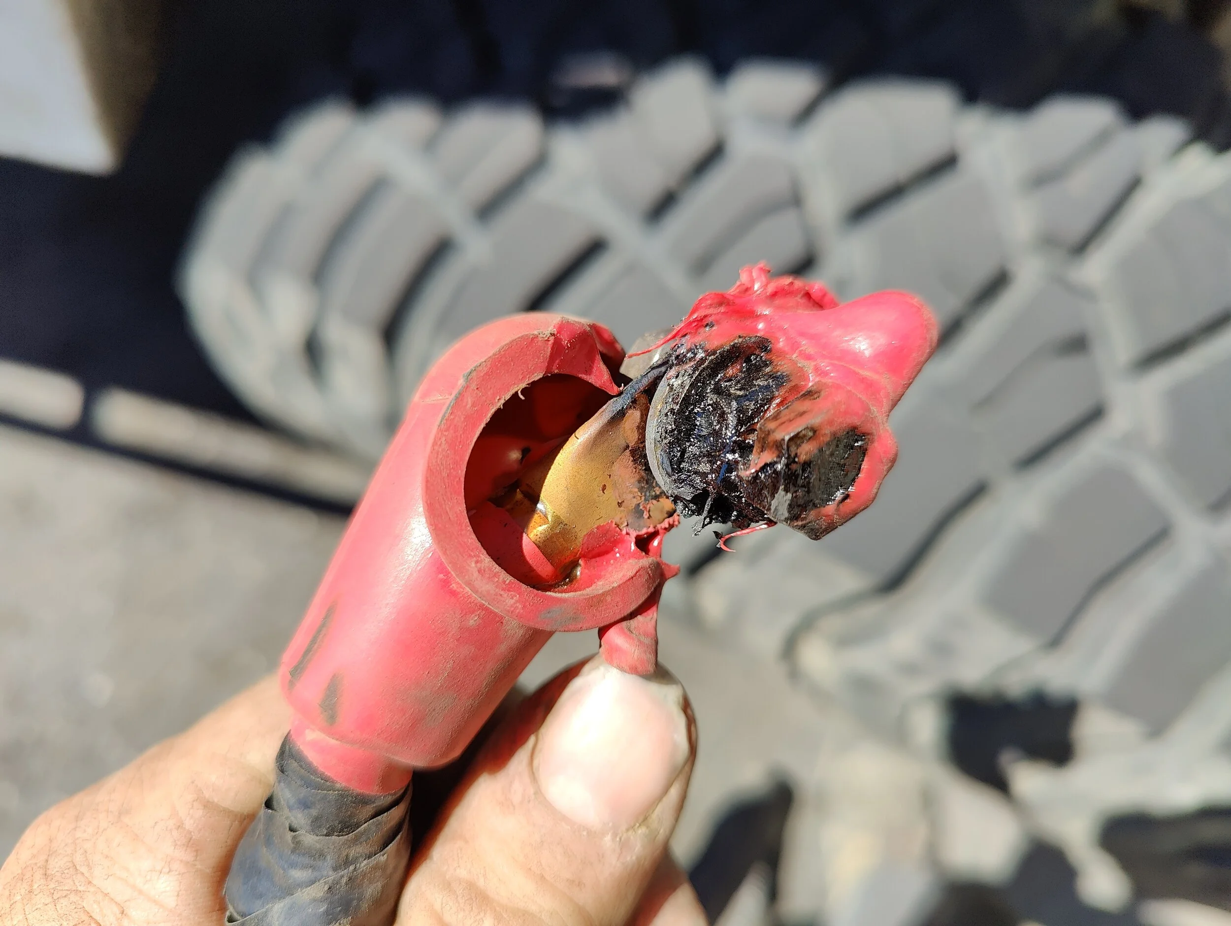

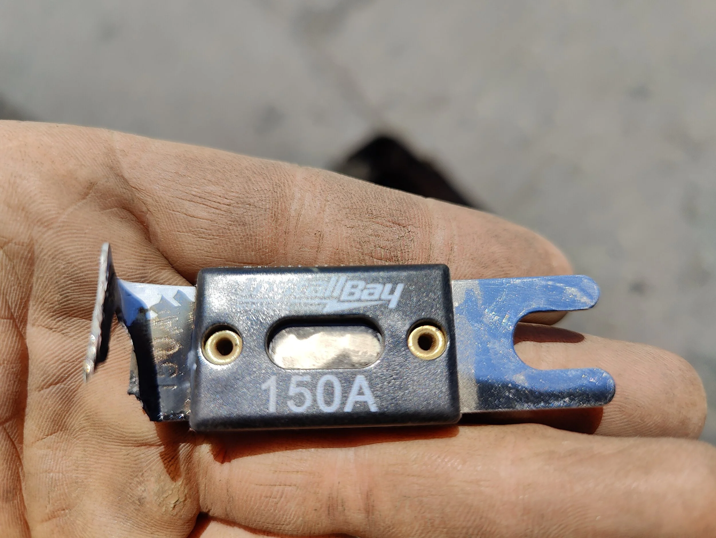

So the check gauges light came on and everything looked fine except the voltage. Got home checked the battery voltage it was fine roughly 14.5v running and 12.4 not running. Took the battery and alternator to the Napa both tested fine. Cleaned all battery cable connections and tightened at all ends including the ground at the block. Checked the harness on the back of the alternator it was a little melted so I replaced the plug. Light went off for about two days and is now back on. However the alternator is still charging the battery and it’s running fine. What am I missing? What should I check next.
