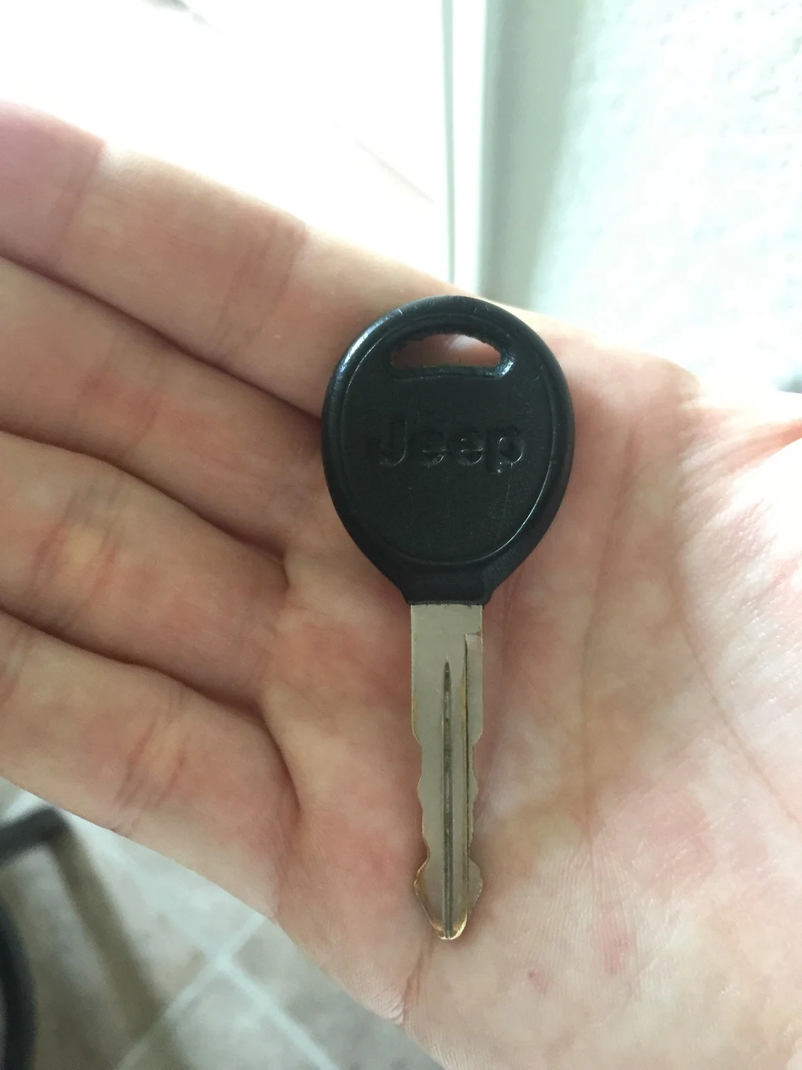

Hi. That looks much darker than my gray chip key, yours looks black almost... You can go to Walmart or place that does keys and there is a scanner they out near key which would confirm if u have a chip key. Do u have the chip key icon in upper left of dash board that comes on when starting it up? Forget what year they started the chip key offhand.
Nope, no key light.
I don't think I'm chipped either, I didn't see anything about it on the window sticker.

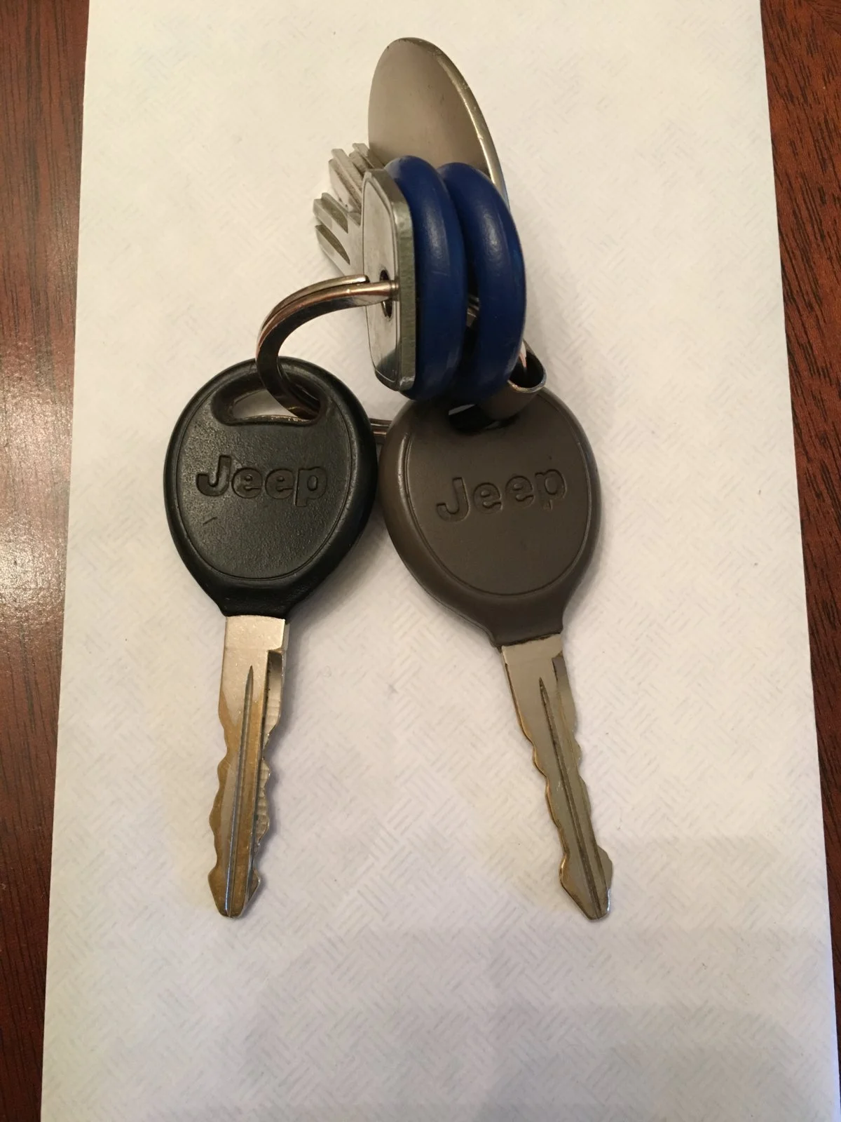

I have a 1999 Jeep wrangler and my sentry key light stays on most of the time but some times doesn't come on at all I have a grey original key and a black spare key 3 times now on various occasions when I crank up my jeep it cranks and with in a couple seconds it shuts down it does this with either key. My question is i was told that it is either the chip has gone bad in the keys or i need a new skim does anyone have an opinions on which I should try first?
