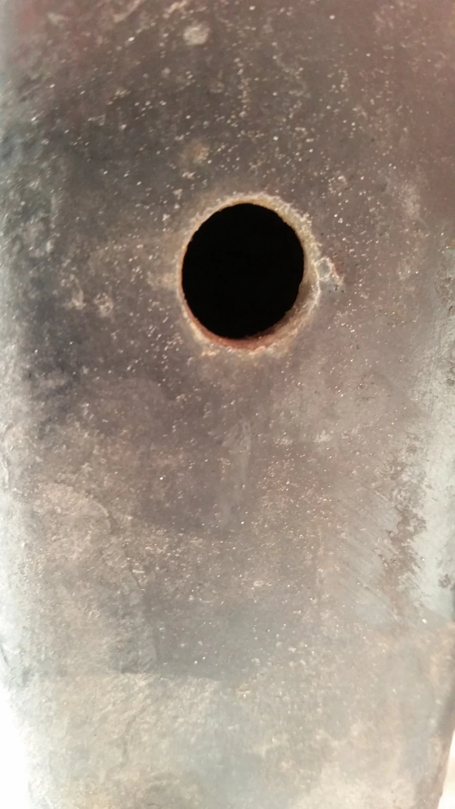

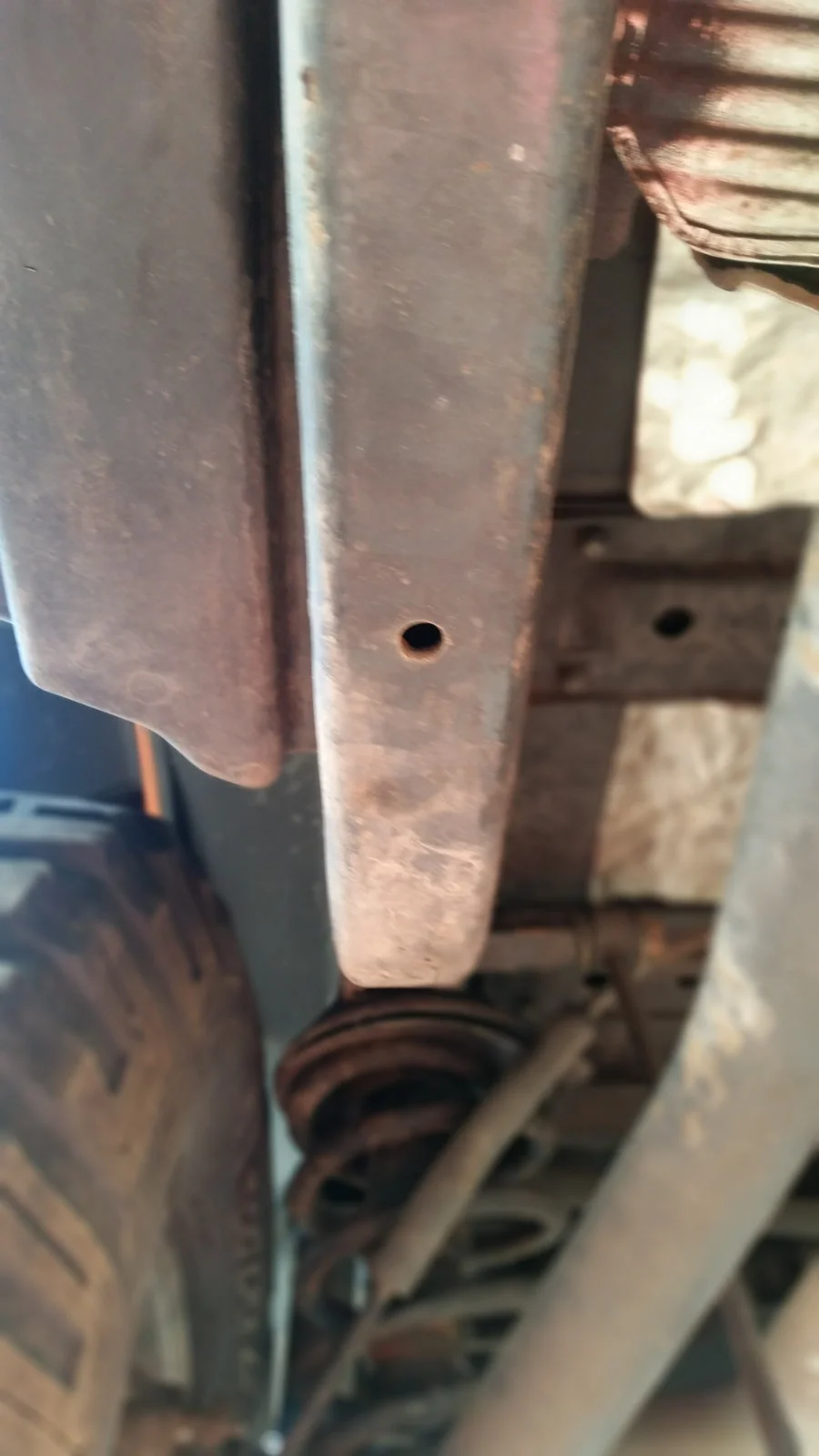

I only drilled two 1/2 inch holes.One on each side right in front of the rear axle arch. When I did my rebuild I found that was a major salt water collection point and it showed, even though I regularly flushed the frame

I did drill two 1/2" holes today right in front of the rear control arms, that should help get the water out.

I ended up drilling the two 1/2" holes in front of the rear control arm brackets (and hit them with paint so they won't rust), then flushed it several times over a couple of days. I used my air compressor with a long blow gun extension to reach into the frame and break up the large deposits of crud, which helped it flow out the drain holes.
@Stinger - those two 1/2" holes were the key to getting it cleaned out. Thanks!
Sure. Here ya go.;)
This maybe more of what you were looking to see. Just in front of rear frame arch.
