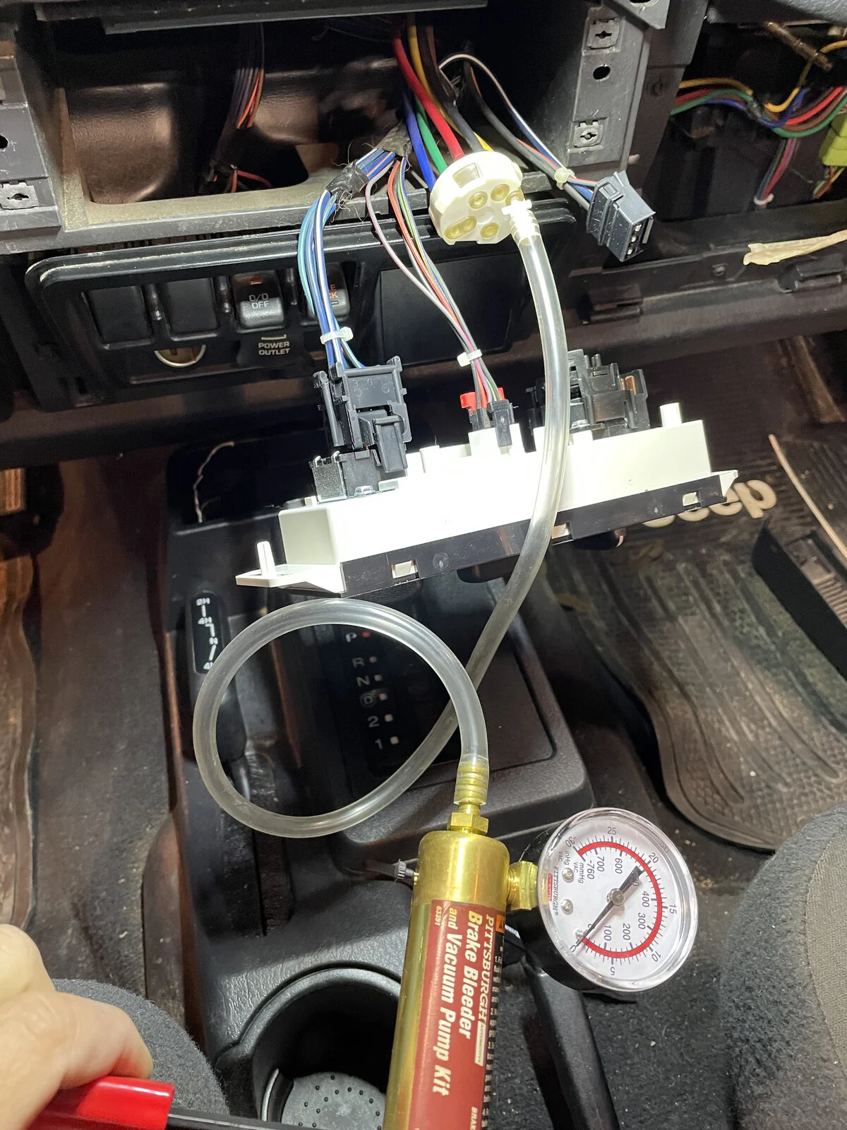

Sorting out my 06 Rubicon project- the fan switch started getting touchy, so I ordered a Carquest replacement climate control assembly from Advance-
Installed went smooth- fan works flawless, blend door switch very smooth, and ALL air coming out the defroster-
Jeep being new and mostly driven with the top off wasn’t sure if it worked prior....
Checked vacuum lines, cruise control worked too giving a good indication I had sufficient vacuum from the intake-
Vacuum tested all air lines at the switch -View attachment 321767
Every solenoid moved and held vacuum-
At this point I’m stumped-
So on a lark I get my old assembly, remove and hook up the selector switch - works flawlessly.
Verdict- the new assembly had a defective selector switch for the zones/AC.

The vacuum nipples on the earlier TJ's climate controls are slightly smaller than on the 05-06. That will cause a leak and the exact issue you had.
Did you buy a generic control panel, or one listed for 05-06 only?
Reactions: John Cooper
Asked for 06 , but makes total sense.
