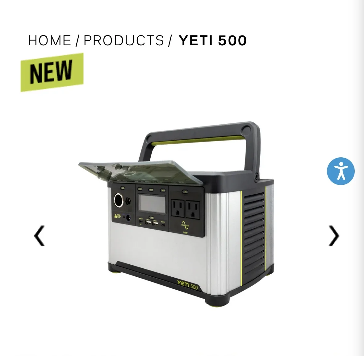

I was wondering, has anyone for any purpose created a closed loop solar powered second battery circuit?
Or would I be better off just buying a Goal Zero or other brand lithium camping battery and use that?
