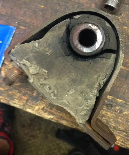

Generally you'll notice cracks in the rubber itself. As far as I know there isn't a definitive guide to how much movement is acceptable, but I would guess that if you felt like it had slack in it where there was no resistance in either direction, that would be indicative of a bad motor mount or transmission mount. The mounts are essentially rubber springs. So if you could rock the engine back and forth noticeably by pulling on it by hand, I would take a closer look. If it takes a prybar, odds are they are still fine.
Bad MM.

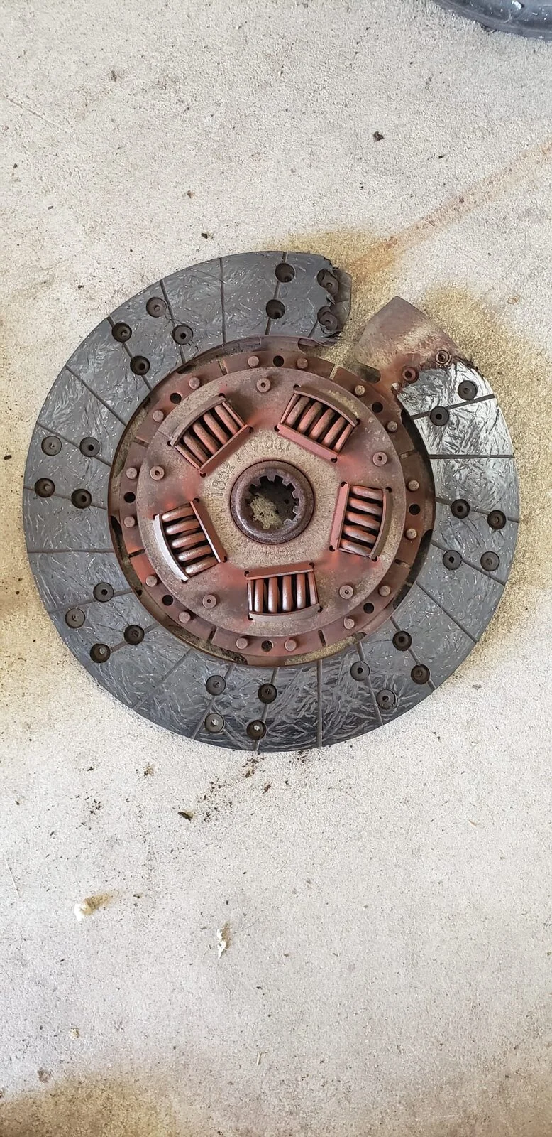

I got the old clutch out today and this is what it looked like. Whether or not that was the cause of my issues I guess it needed to be done. I'm putting in a new clutch kit and flywheel. Will see how it does once it's together.
