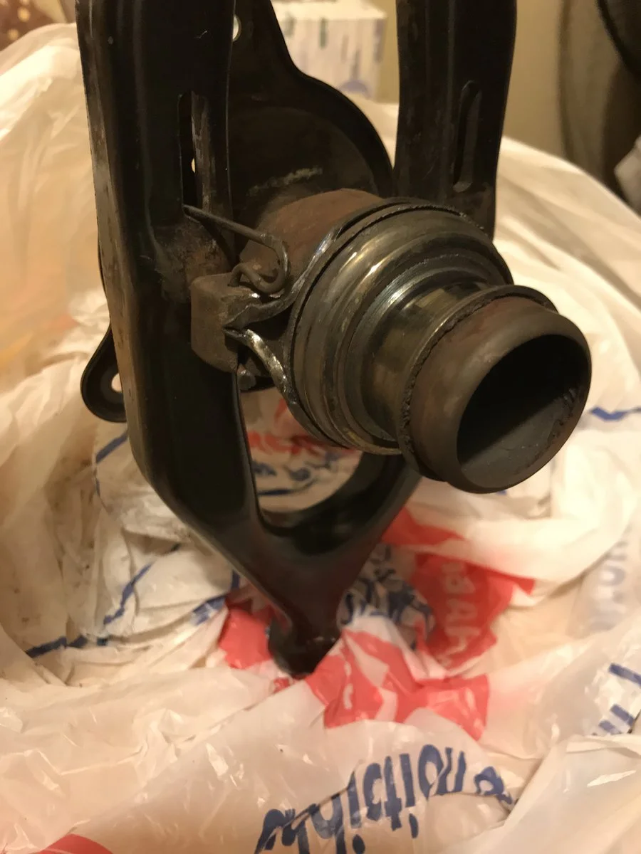

I just put a new clutch in and mounted everything back up. When I was putting a new slave cylinder in I moved the clutch fork and the pivot ball clip fell off. How can I get to it without dropping trans. 2006 tj
The pivot ball (iirc) is at least part plastic and can wear or crack or break. This can make the fork able to pop off the pivot. Replacement pivot balls are available. Replace pivot and retaining spring.
i had the same issue and it ended up being the throwout bearing. while i was in there i replaced the pivot ball and clutch retaining spring/clip, all parts that break easily/wear down. but either way i had to drop the bell housing to do the repairs; the parts all together are only about $60 in total.
Without the spring holding the fork in place it can dislodge itself. I would think one or two harsh potholes could knock a worn fork off a worn or broken ball.
Years ago I had the clip that holds the fork to the pivot ball break while driving. The fork was able to move freely in the housing and required a transmission pull to replace that stupid clip. Did the clutch kit and pivot ball while I was at it. 30 cent clip can cause a tremendous amount of headache.
