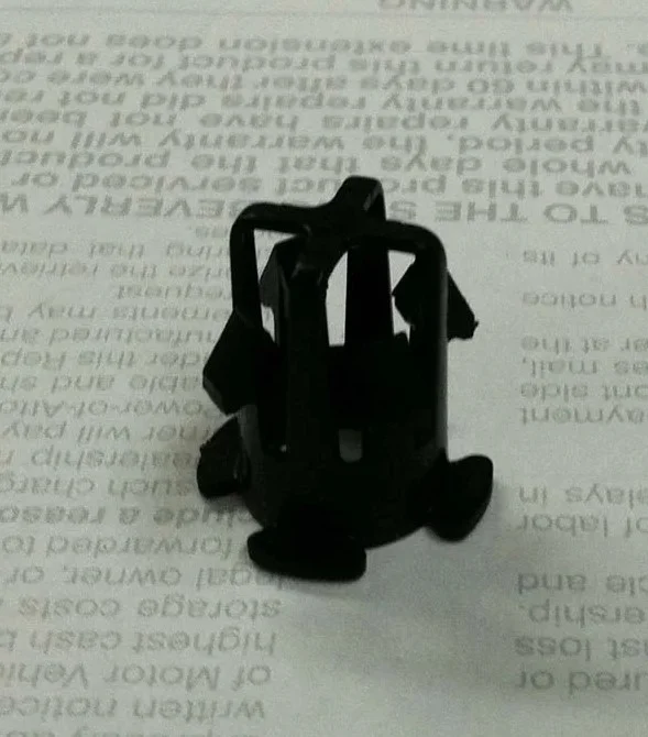

Ok got the whole assembly out. The basket on the clutch pedal basically fell apart! No visible leaks & it's not empty but definitely alot of squishing when applying pressure to either side. I'd say it was time even if there wasn't an issue!!
Are you referring to the plastic retaining clip?

Yes, barely touched it & it popped right off.

All of the replacement plastic bushings I tried were junk and failed in my jeep and 2 others I know of in VERY short order. I went with this fix and haven't looked back. Zero problems and solid feel.

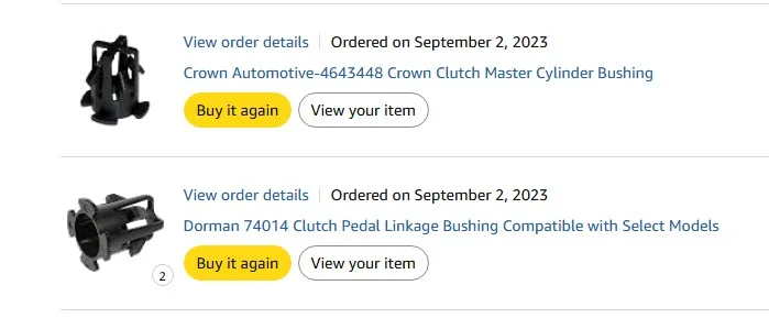

Here's the clips I ordered, apparently I ordered one of each to see which was the best. Couldn't tell you which one I am using right now but as you can see it's been 3 years and no issues.

That's why I keep zip ties in the jeep. When mine failed the first time I was at a stop light. When I figured out what was going on, I grabbed a zip tie and zipped it together until I could get home. Ordered the replacement bushing and it failed in a week. Did this a few times with supposedly different bushings before looking for an alternative and finding this e-clip fix.
