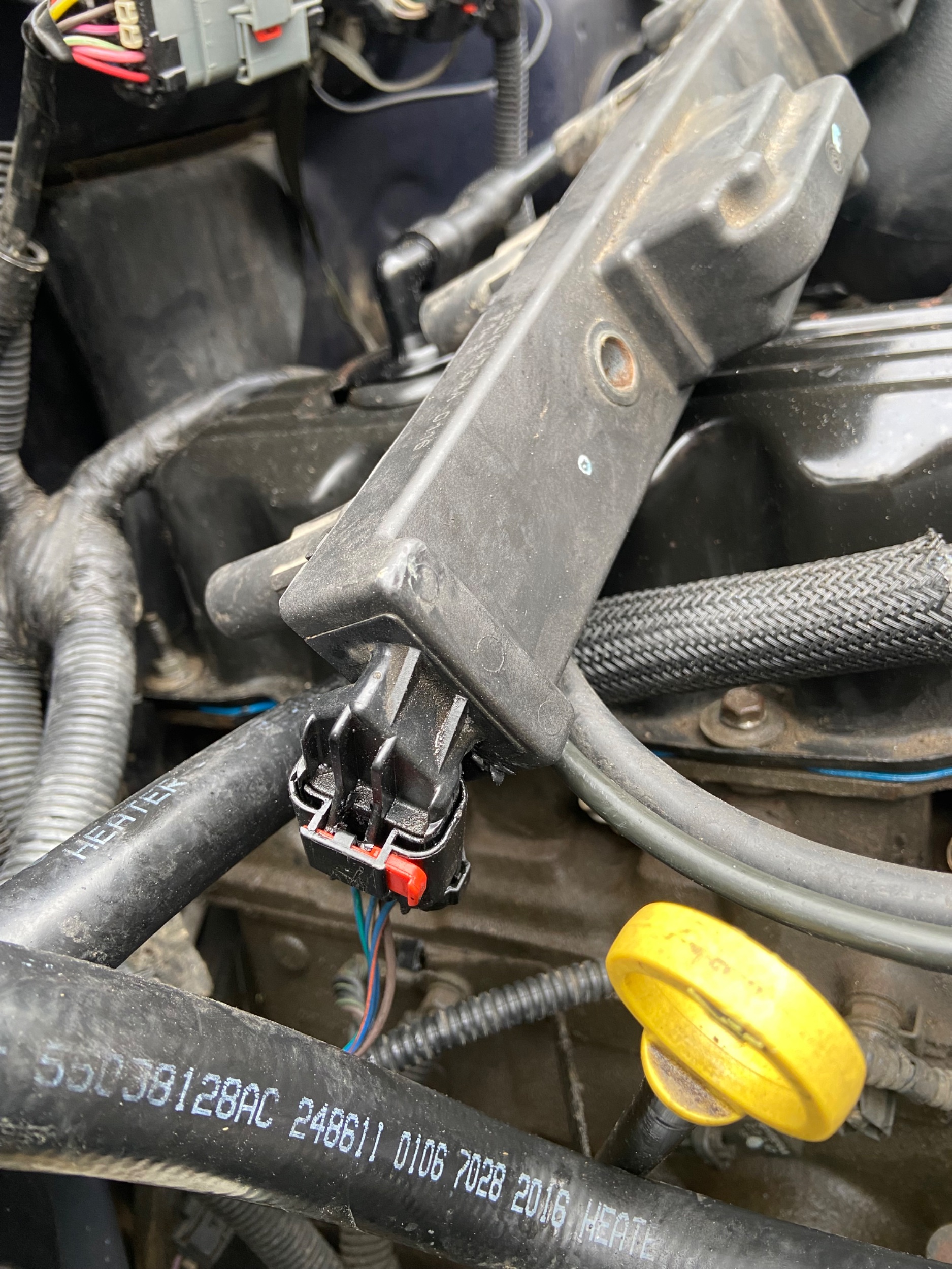

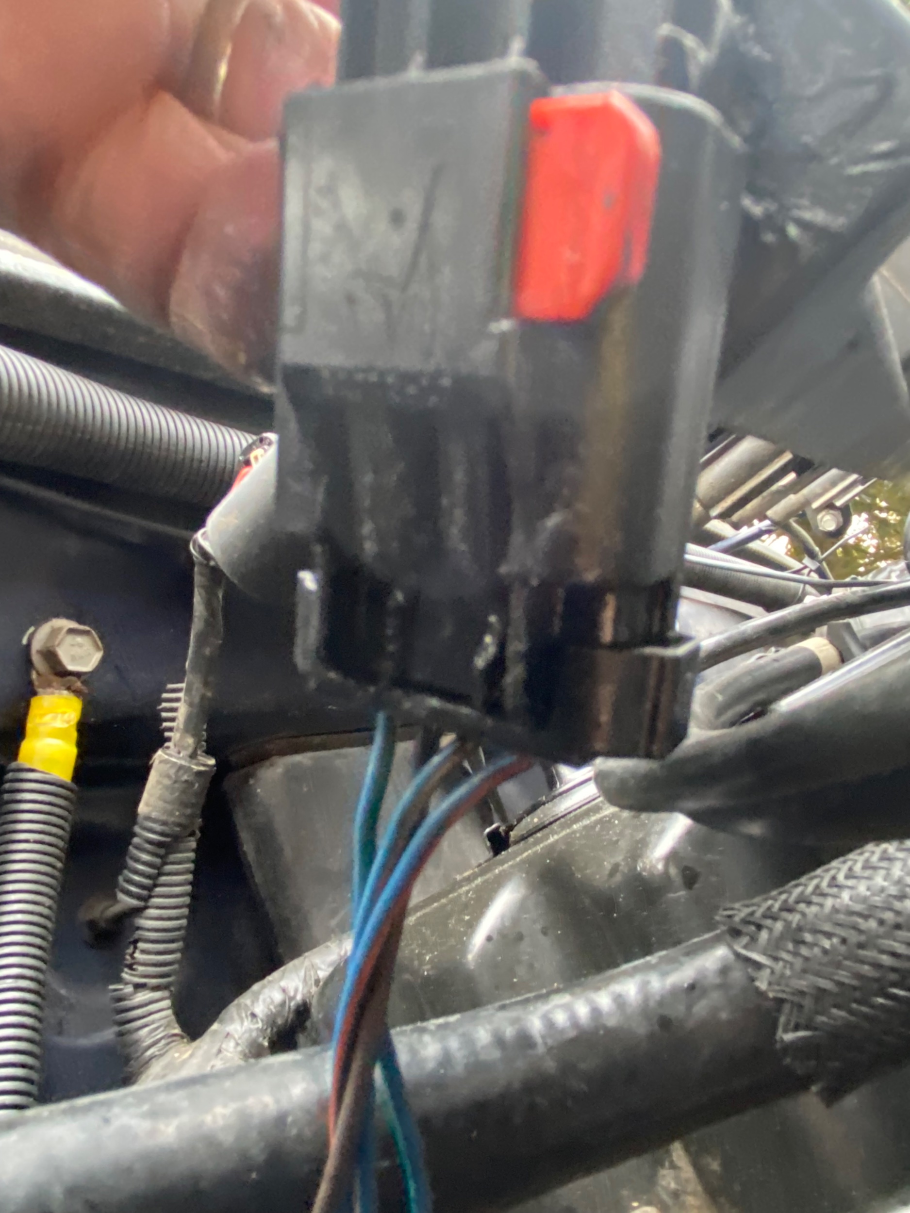

It’s stuck! I’m in the 2nd day of trying to to get the elect connector off the coil pack rail. The orange slider moves but there’s no push tab on the body of the connector. I’ve sprayed it with WD-40 but it won’t budge. I’ve even grabbed it with channel locks and wiggled. Nothing. I sure don’t want to break it.
Any suggestions ? Thanks.

You sure that safety tab is all the way out?

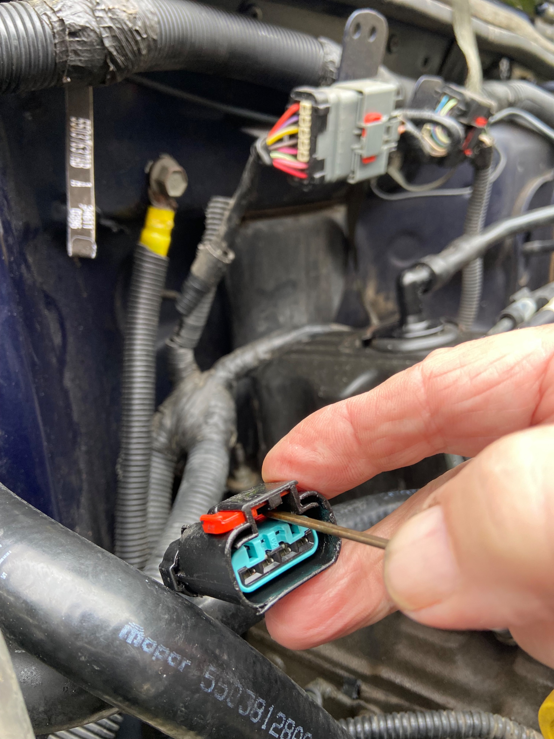

Well wouldn’t ya know- as soon as I ask for help, I successfully got the connector off.
I stuck a thin flat rod down into the connector and pushed it outward while pulling down on the connector body . Voila .
. it came apart… the flat rod is @ .050 thick . Actually it’s a brazing rod. Photo added in case somebody else needs it.
