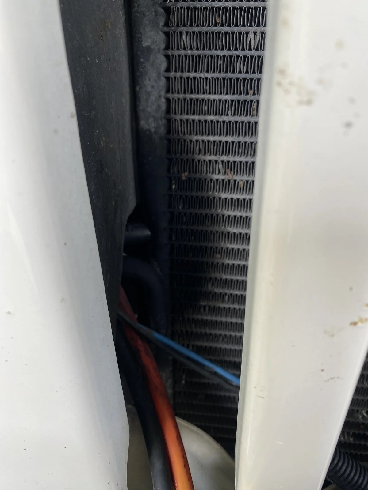

Hey everyone,
I have a leak on my condenser coil from two lines rubbing against each other. Looking to get replacement coil. Shopping around and found this website. Is this the best place to get replacement or should i look elsewhere? Link down below
https://jeepair.com/collections/con...-wrangler-tj-condenser?variant=32066961145941
Not aware of any reported issues with Jeep Air equipment and they have a decent rep. Make sure to replace the accumulator at the same time and measure the oil from each part.
Sounds good. Just curious of why accumulator needs replaced at same time?
Ah I see, serves as the drier core for the system. Thanks for the info.
Reactions: TJ4Jim
I know nothing about that seller but that's not a factory Mopar if that matters to you. Also, I'm not sure a factory Mopar condenser is even available any more. I recently installed a Denso on my 2005 Jeep and it worked just fine. I've had good luck with Denso parts. Got it from Amazon for about $100 with free shipping. Rock Auto has it cheaper but not free shipping. I was ordering some other stuff from Amazon so just decided to get it there.
Also agree with replacing the dryer. They aren't expensive and should be replaced when major components are replaced.
