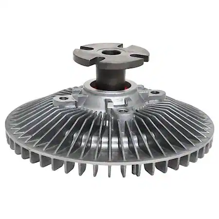

I don’t think a thermostat would cause your issue. They usually fail stuck open or closed. Maybe the viscous fan drive is nearing its demise?
What is a viscous fan drive? Edit: Sorry about the double reply! Not sure what happened there.

If the cooling system isn't exactly up to par the thermostat will be mostly open. The thermostat operates very smooth when it's in the normal range. Put one in boiling water and watch. it also is sitting in coolant so it responds quickly to temperature change. What doesn't is the fan clutch. The radiator has to start dumping heat for it to operate. After the radiator gets very hot that air starts to spin the fan faster and the radiator cools down. The fan clutch has quite a bit of lag compared to the thermostat. Long story short if you experience slow temp swings it often points to a general reduction in cooling capacity due to rust and clogs and other crap leaving the thermostat mostly open and the fan controlling the temperature. Just food for thought. Some people like to dispute just about everything because it's the internet, if you disagree I don't care, please don't quote me.
