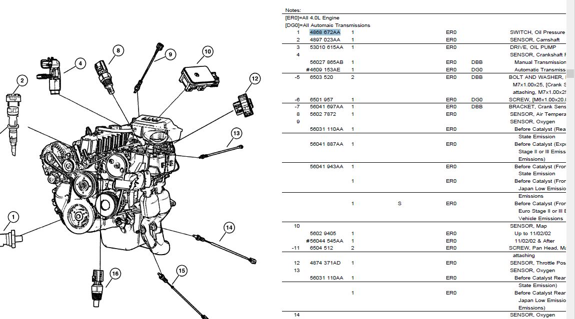

According to the Parts Catalog for your year 4.0L; the PN is 4868 672AA, but it has been superseded to 05149097AA.
That part is listed to fit:
CHRYSLERASPEN2007
DODGEDAKOTA2003-2007
DODGEDURANGO2003-2007
DODGENITRO2007
DODGERAM 1500 PICKUP2003-2007
DODGERAM 2500 PICKUP2005-2007
DODGERAM 3500 PICKUP2006-2007
JEEPCOMMANDER2006-2007
JEEPGRAND CHEROKEE2005-2007
JEEPLIBERTY2003-2007
JEEPWRANGLER2003-2005
MITSUBISHIRAIDER2006-2007
I went for a drive and got the check gauges light every time I slowed down to a stop. It runs fine and goes back up when I drive. Anybody know the correct Mopar parts number for an 03'? Every site I look on gives me conflicting numbers. Thanks.
MOPAR 5149064AB ?
4868672AA is what the 2003 Mopar Parts Guide shows but CharlesHS says that has been superseded by 05149097AA.
