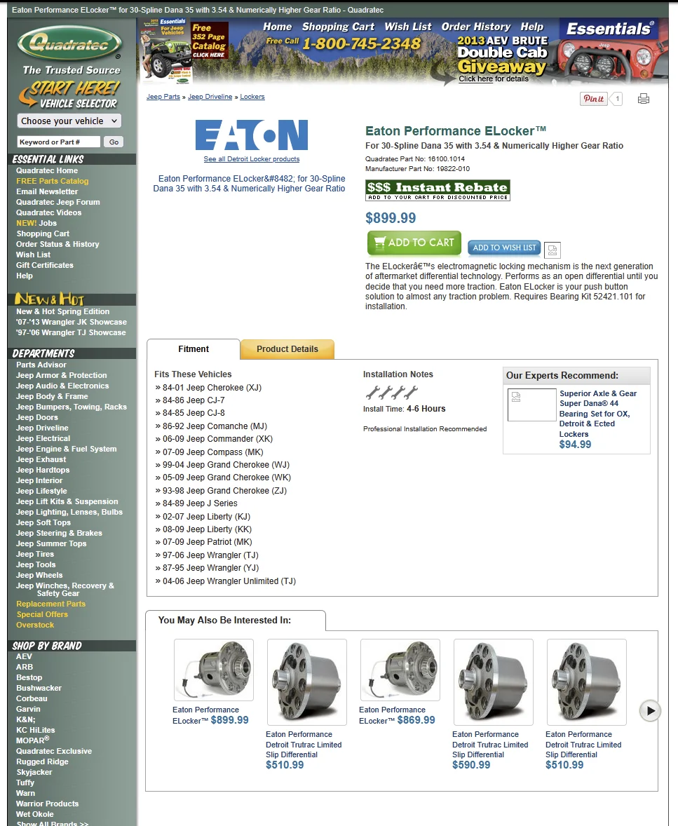

I definitely think that's the superior way to go. I want to do mine but am dreading the purchase of the locker. I miss the days when I thought $890 was extremely high.
Throwback to the old Quadratec website and a clip from 2013 when the locker was priced as stated above....
