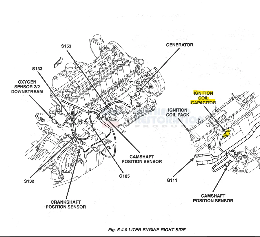

Sorry for reviving old post, pls don't bash me too bad. I've been trying to figure out what this was on my 04 TJ for over 8 years now, and finally found it today. According to google, this may be cause for your issues.
UPDATE: Google also says it's just to suppress radio noise, and prevent coil from feeding back a jolt that may melt wiring harness: https://www.wranglerforum.com/threads/filter-capacitor.184152/
