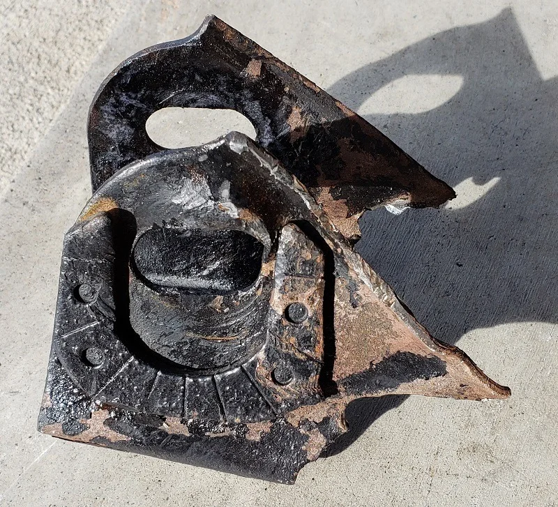

Cracked lower control arm mount

Definitely gonna give that a try and see how it holds up. Probably gonna change to thicker brackets eventually but at least to get me bye.
Screw that, just weld the damn thing and be done with it. That crack is there because the mount got tagged at some point and straightened back out. It is old, it hasn't increased, it won't increase, and a small bit of weld will tune it right up in the only area that matters. It won't hurt your feelings any more.
A TJ Front control arm mount is only welded externally...drop the arm and weld inside and out for greater strength.
The mount thickness is slightly more than 1/8". There is already more weld on there than 1/8" will ever need. I have Dana 60 mounts that are 1/4" that are only welded on one side and they never fail.

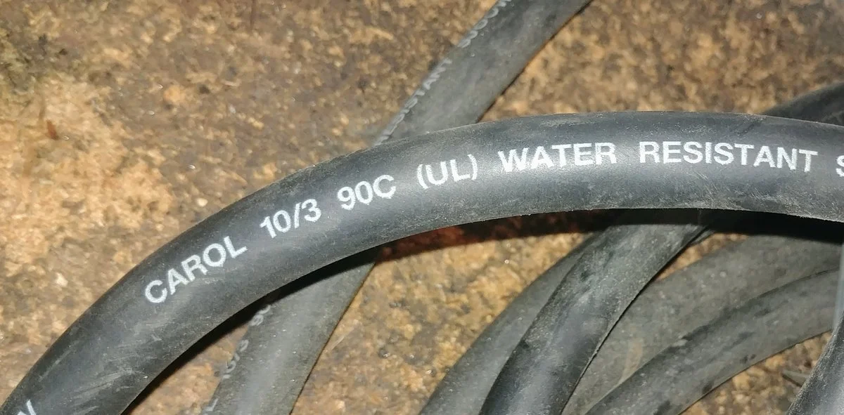

Not to mention the welding extension cord I made for my Miller is 10 gauge. I don't go small for shop electrical wiring.
I’m not sure what to say other than mine would weld up to it’s limits without issue so long as it had decent a decent power source. I like your extension cord. My current welder is a Tweco 211i and I butchered a 25’ RV extension cord and used it to replace the original 6’ power cord, best welder mod ever, no fiddling with an extension cord anymore

Thank for the tip, ive been wanting to drop thr jeep about 1.5 inches and will need to remove it to adjust the control arms. Looks like I've got a nice project for this weekend!
Well Mr. Blaine has good point...really when you hit something real hard it's going to wad up before it breaks usually.
Reactions: Justin Homan
As was said, this isn't bad at all. Recently, my Son went down in a hole with my Rubicon. The problem was, even though I told him not too, he turned wheel fully, pushed the tire against the mud bank and applied a heavy foot with the lockers engaged. The net result was half of the lower mount tore completely away from the axle. We strapped it, limped back to the office of the park we were wheeling at, beat it back into shape and welded it with a 110 welder.
We then wheeled for two more days with it like that and had no problems. Knowing this is a common weak link, we ultimately welded in new ARTEC mounts. Like Jerry said, I wouldn't show off my welds, but they held up just fine. On the flip side, this did make me start thinking about an on-board welder and improving my skills. This is what I removed!
