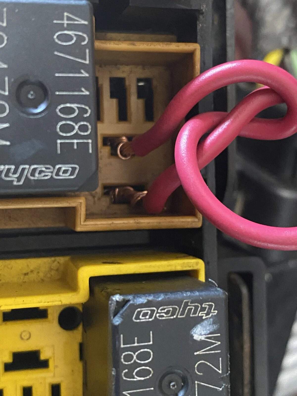

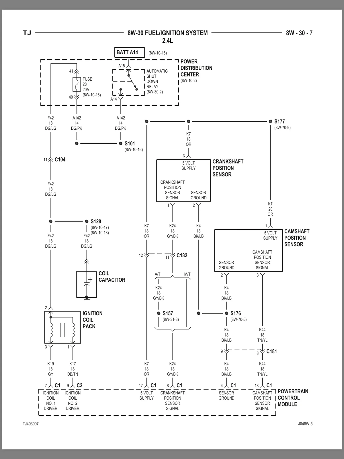

Just to close this out - I bought some Jeep Liberty connectors and replaced them but still no start. I replaced the CPS and the ignition switch but no start. Retraced my steps with the wiring diagram and everything looked in spec.
