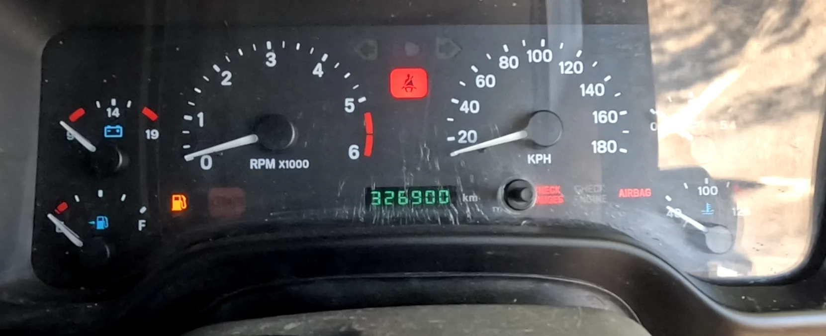

  • Performed dash self-test as one forum suggested. All dials and displays are functioning.
  • Tried turning the key between ON and OFF positions thrice within 5 seconds, according to the suggestion in the two previously-linked forums. No codes show on the odometer. No "donE", no "55". Nothing, except the current mileage and trip meter.

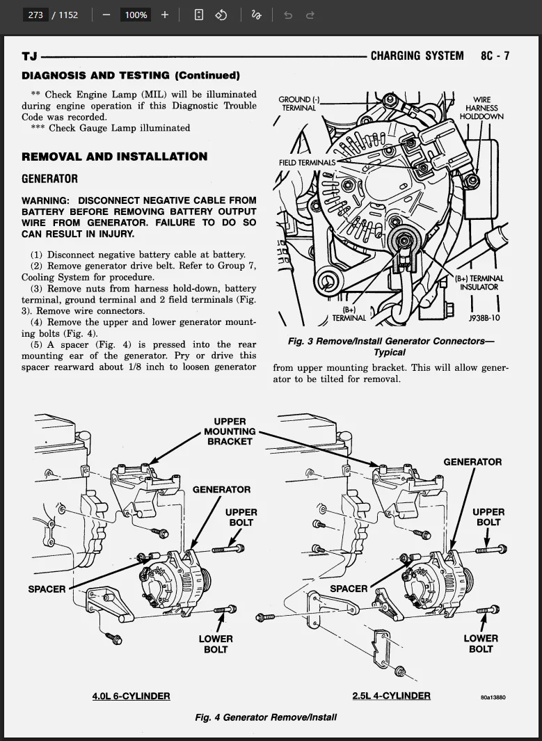

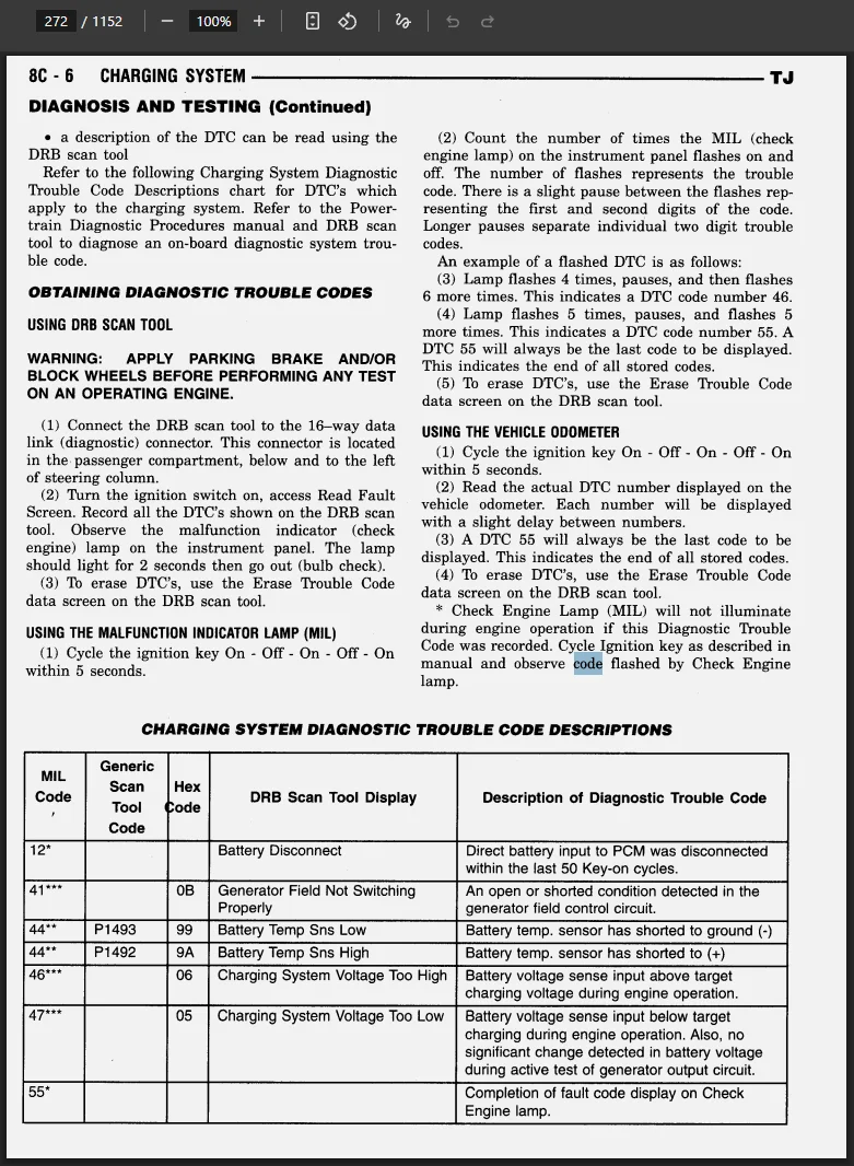

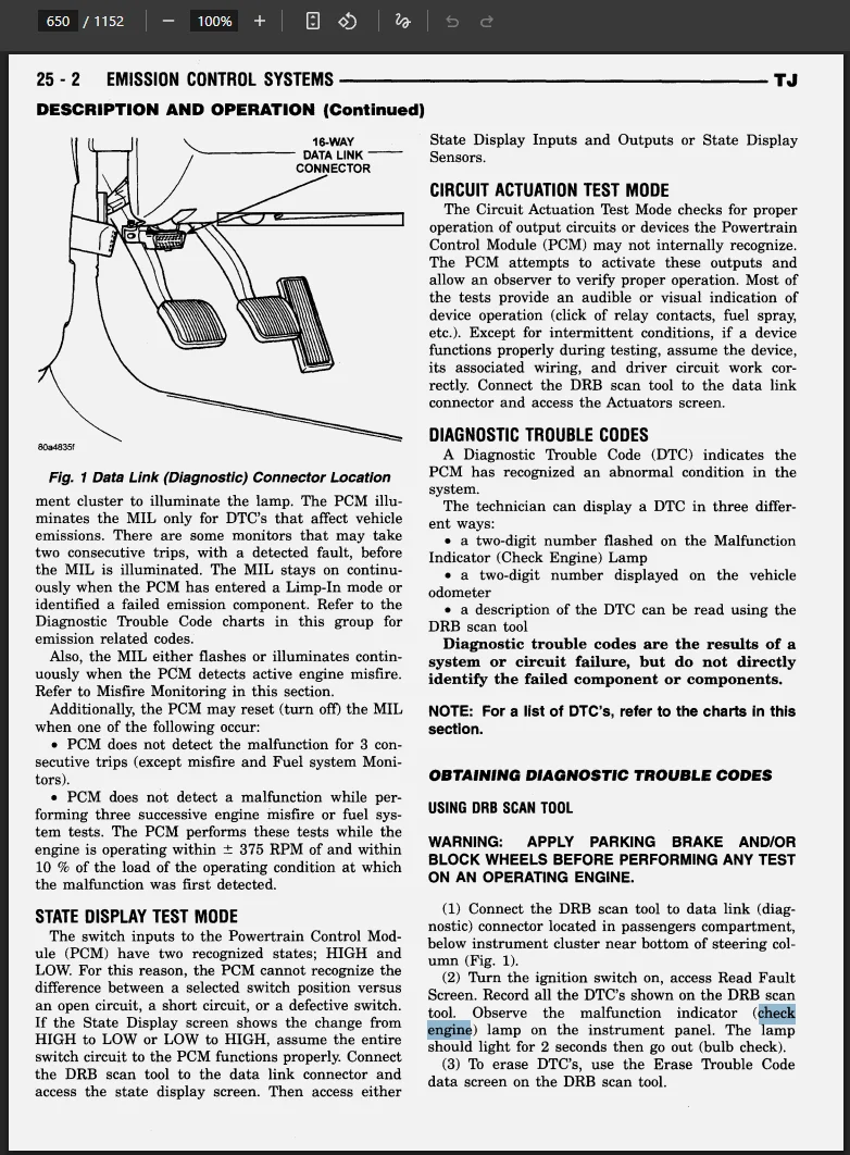

I checked the 1997 Service Manual, available from this forum.
Page 272/1152 suggests using the key trick to get the odometer to show diagnostic codes. So it should work.

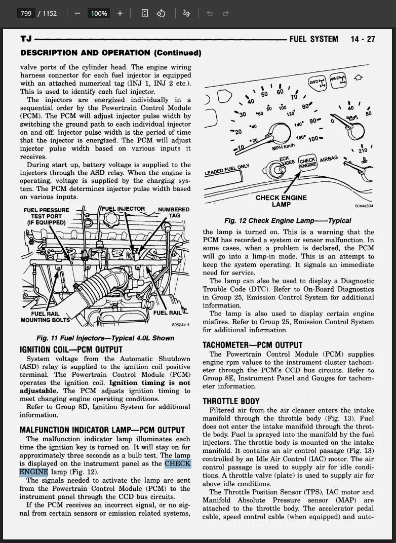

No, "CHECK ENGINE" light does not turn on at all. Fuel and "CHECK GAUGES" lights stay on for ~3 s, seatbelt and "AIRBAG" lights stay on for ~8 s.

You are right. The "CHECK ENGINE" lamp should illuminate for a couple seconds.

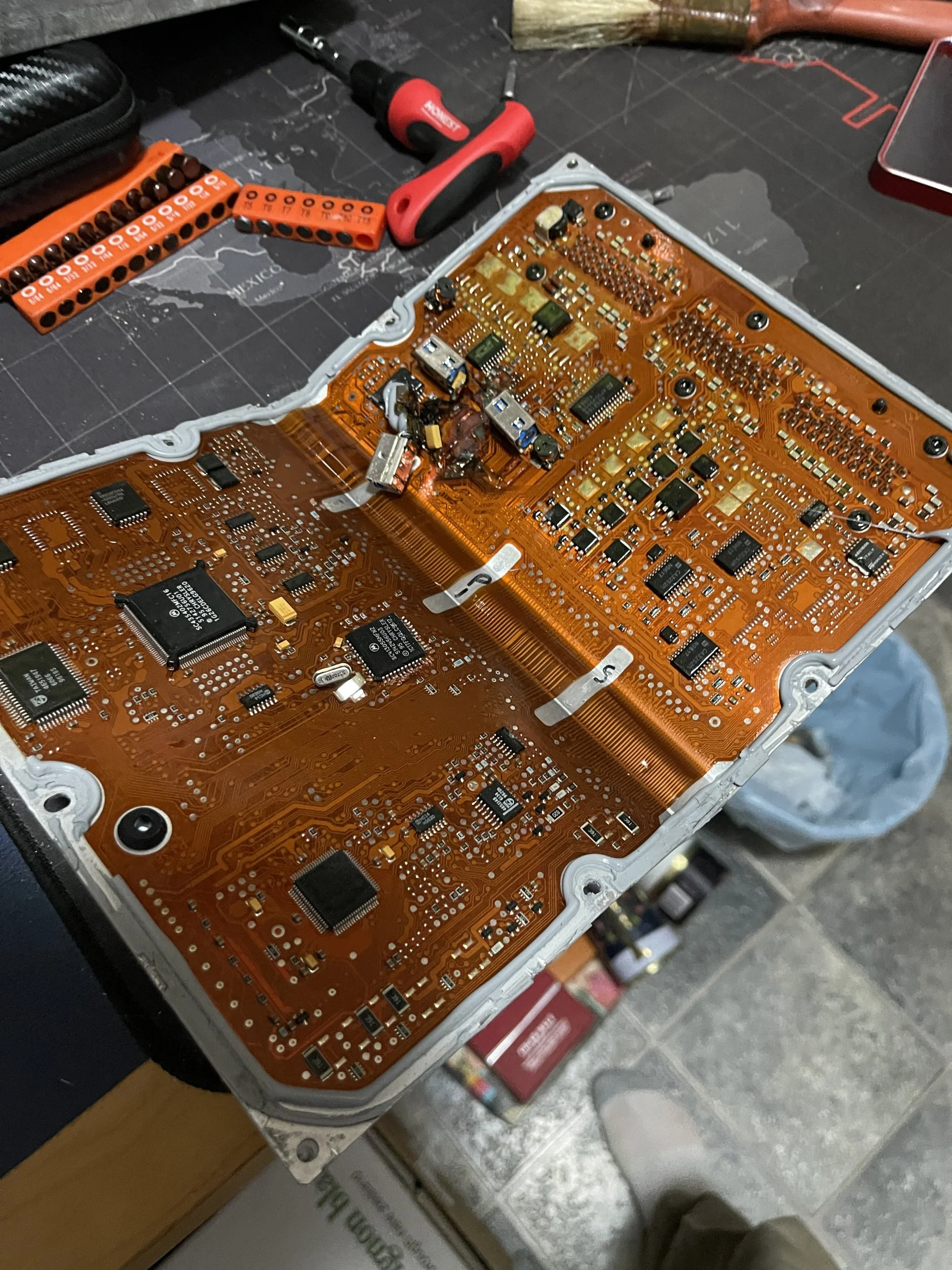

Well, what I thought was the PCM was actually a computer module for the airbag, so I reinstalled that.
I found the PCM on the left hand side of the vehicle next to the battery (I have a RHD Jeep here in Aus).

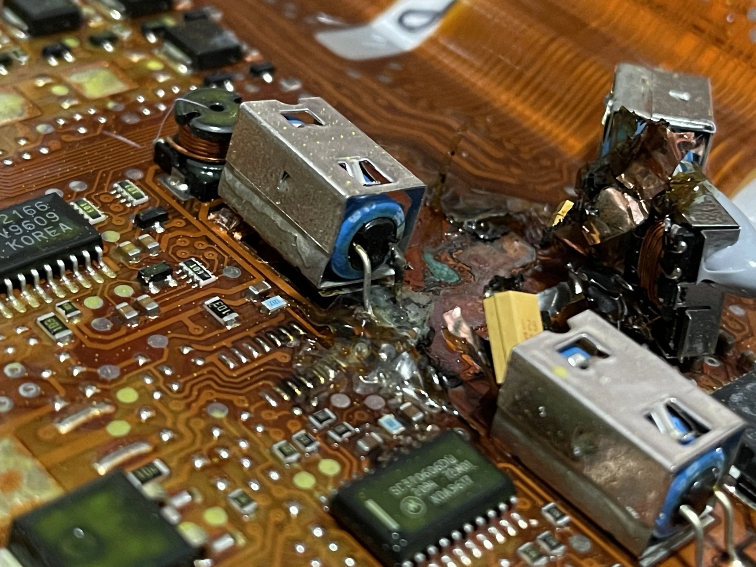

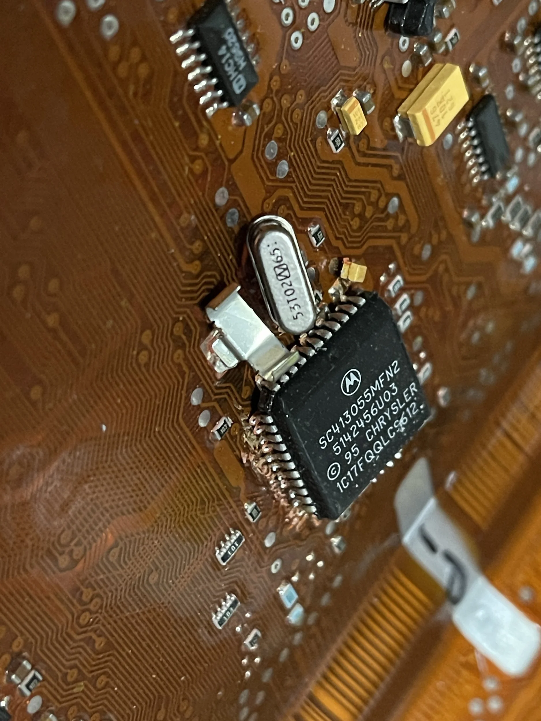

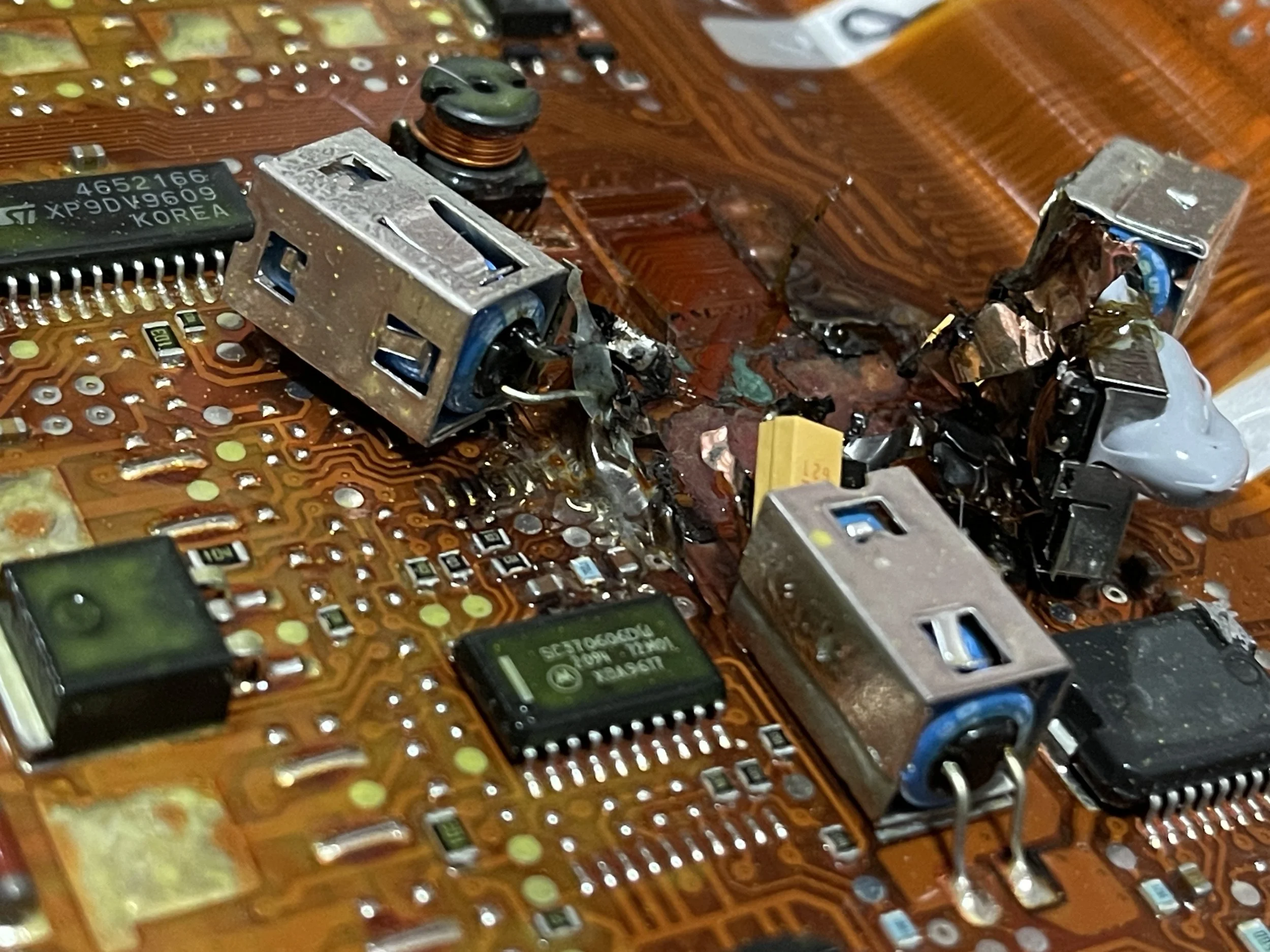

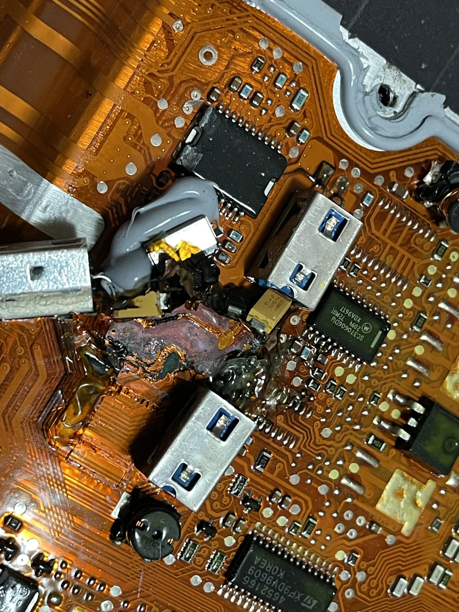

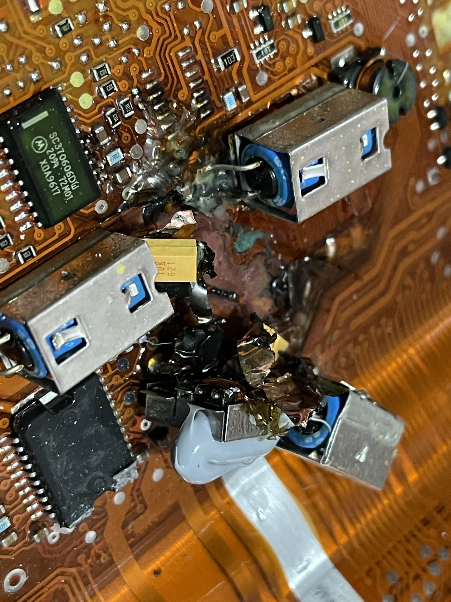

I removed it and opened it up. I tore some componentry off the board in the process of opening the aluminium housing, so I definitely need a new PCM now... One is supposed to bend the aluminium housing open, as if one was opening a book. I tried to slide it off, which sheared a few components off.
There is a patch of discolouration on the board, perhaps from an arc event or a leaking capacitor. I have attached photos. In fact, in a post by @Wranglerfix himself, he showed a photo of a PCM board damaged by a leaking capacitor.
