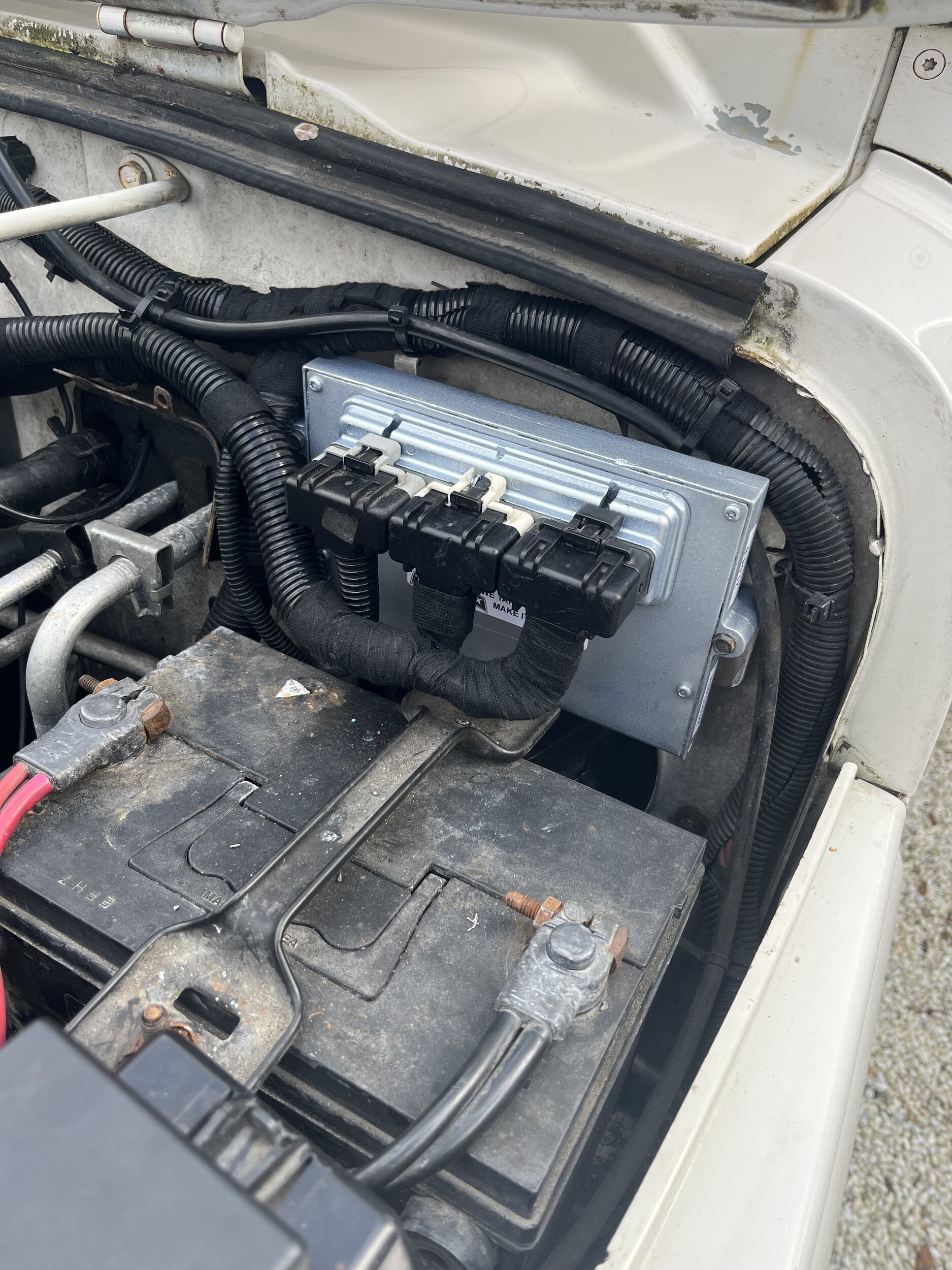

Finally just fitted a new PCM from Mark at wrangler fix, still the same, crank no start.
