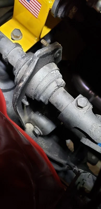

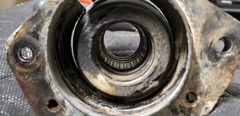

As Jerry said, spray some lithium grease on the firewall boot. I also was chasing steering wheel creaking, on a high mileage TJ, and discovered something I hadn't seen before. There's a boot under the hood, on the steering shaft, that has a bearing in it. I took it apart and found mine completely dry. I cleaned it, greased it and reassembled it. Creaking was gone!
