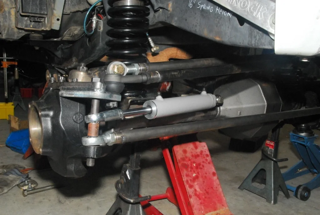

This looks like massive amounts of interference waiting to happen...

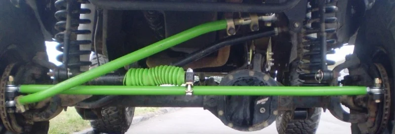

I didn't have a particular steering kit in mind, though the type that I see a lot of people pushing (and buying) would be something like this:
http://www.ironrockoffroad.com/11060.html
There's several manufacturers out there who make kits like that. The names that come to mind are Serious Offroad, Rugged Ridge, Rustys, IRO, etc.

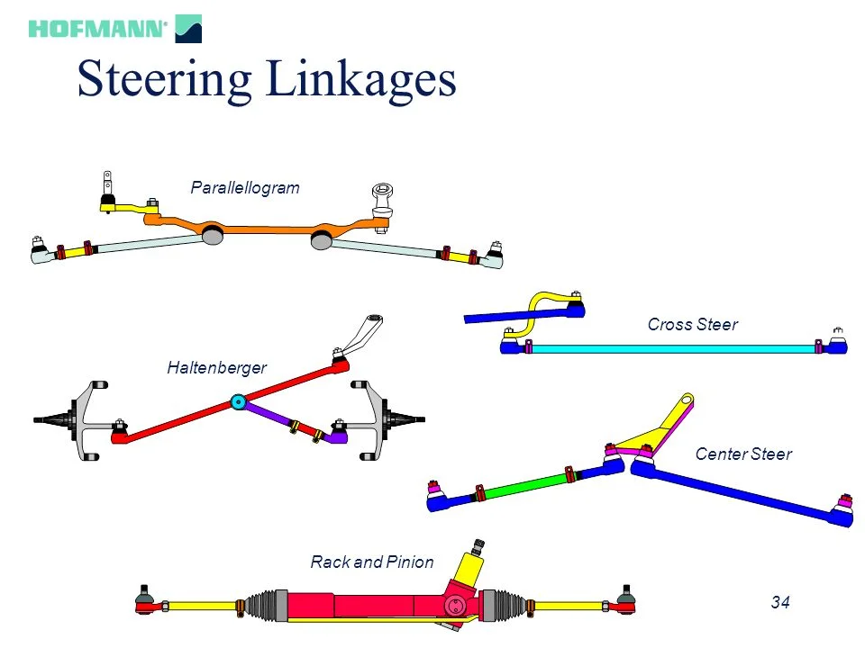

Also, @Tjcanuck97, here's a good diagram that illustrates different types of steering linkages:
Bonus points if someone can name a vehicle that uses each one of these steering system types (besides rack and pinion since that's way too easy).
Those are all iterations of steering I've built. There is no interference of any part with any other part and they all work perfectly. That one in particular is very nice due to the steering assist cylinder attaching directly to the steering knuckle. Also the same way the steering is set up on my crawler.
No kidding? It looks really complicated, but if you built it it's got to be good! Never seen anything like that before. Does it require a sizable lift?
There are a couple of issues that may or may not meet your criteria for good steering. First, they lie when they say that is a bolt in kit, it requires drilling of the knuckles and pitman arm. That is the first strike for me. That clamp at the lower end of the draglink will be a problem if you play in the rocks. If you look at the spaces under the rod ends where they are bolted to the knuckle, there seems to be very small to no gap. That is a problem that will loosen the bolts if that is true. Due to steering axis inclination, one steering arm rises as the other lowers when you turn lock to lock. That means there has to be enough misalignment in the ends to let that happen or the connection gets stressed. I'm also not a fan of single shear straight bolts on the TJ knuckle. The iron is too soft to always keep them tight and they will need to be checked often to make sure they haven't lost torque and are wallowing the holes out.
The upper end of the draglink needs more bend to bring it more neutral. That rod end is in danger of bottoming out at full droop. Also, the rod ends in the draglink only have a lifespan of around 20,000 miles if you use the rig hard. The tie rod ends last longer. To put that in perspective, each end in a version with a longer wear life will run you around 55 bucks so if you do the math, it's easy to tell they aren't using them.
The reason you see clamps on the draglink and not the tie rod is the tie rod is straight so if you bump it and break the jam nuts loose, it won't sag and start dragging on the draglink. The draglink has clamps with splits. You will bump it and turn the draglink on the threads but they won't be loose due to the clamps. It will drop and drag on the tie rod which means you will have to readjust it to fix it which may become annoying at some point.
On a scale of 1-10, I'd give it about a 5.

Haltenberger YJ
CenterSteer ModelT ?
Parrelellogram 1960s Pickups, Luxury cars, Buses
CrossSteer.... TopFuel, HotRods, Tractors
Rack&Pinion... over half the cars built since 1960.
