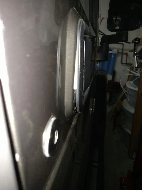

@JamesAndTheSahara, One of mine pops out about an 1/4" when I close the door (see image below). When you have yours out can you take a look and tell me how those are held in so then don't pop out any? I looked and really didn't see anything.
I replaced mine last fall and had a similar problem. The step wedge was not all the way down so I took a long slotted screwdriver and tapped it down further. Haven’t had an issue since.
Are you referring to the wedges on each side?
Mine don’t do this post install. Are your step wedges set to the factory reccomended amount?
...Are your step wedges set to the factory reccomended amount?
What is "set to the factory recommended amount?"
edit: never mind, I just fixed mine. I remove the seal along the window, lowered the window and tapped the wedges down further with a screwdriver. Happy camper now. Thanks!
