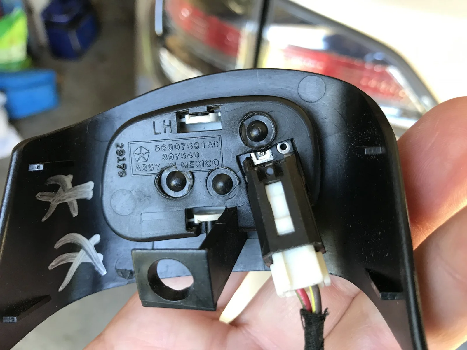

Chris, after taking the switches back off, I see the attached part numbers. These should be “AD” for a 1999 wrangler TJ, if I’m correct and they are not. Geez!!! The ones I have are for 1998, aren’t they? These are replacements from an eBay seller who sent me the wrong ones the first time. I’m going to get the correct switches and I’ll be back in touch. Dang!! Can’t believe I didn’t double check these!!!

Chris, sorry to wear you out, but you are the man to ask. The correct cruise control switches are the “AD” style for 1999 Jeep Wrangler, from what I’ve read. I see several for sale on EBay, but can’t help notice they have “ABS PC” stamped on the back of them. My Jeep did not come with ABS as an added option, so I just want to confirm that doesn’t matter and these AD style switches would work?
ABS doesn't make a difference with the switches, that has nothing to do with it at all to my knowledge. "ABS PC" is probably just some sort of labeling that actually has nothing to do with ABS brakes.
It's been 6 years or more since I last dealt with the switches, so I can't remember anything about the different part numbers. All I remember for sure was that there were switches for 97-99 models I believe, and then switches for 00-06 models. I remember them having the same connectors, so you'd never know they were different unless you knew the part numbers.
When I lookup that part number you have (56007530AC), it says it's for a 98, which must mean it's for a 97-98 model, so I would have to say you have the right switches. What is the part number for the other one?
I'm not 100% sure, but it's either behind the glovebox or under the hood. Both fuse boxes have labels on the underside of the covers, so you should be able to easily see which one is marked for cruise control.
That’s just it. My Jeep is a 1999, so these won’t work from what I’ve read. The other switch part number is 56007531AC. Shouldn’t mine be “AD”?
I’m not sure what the AD vs AC thing means. I think AD just succeeds AC as the more recent part number.
It sounds like you may indeed have the wrong switches in that case.
