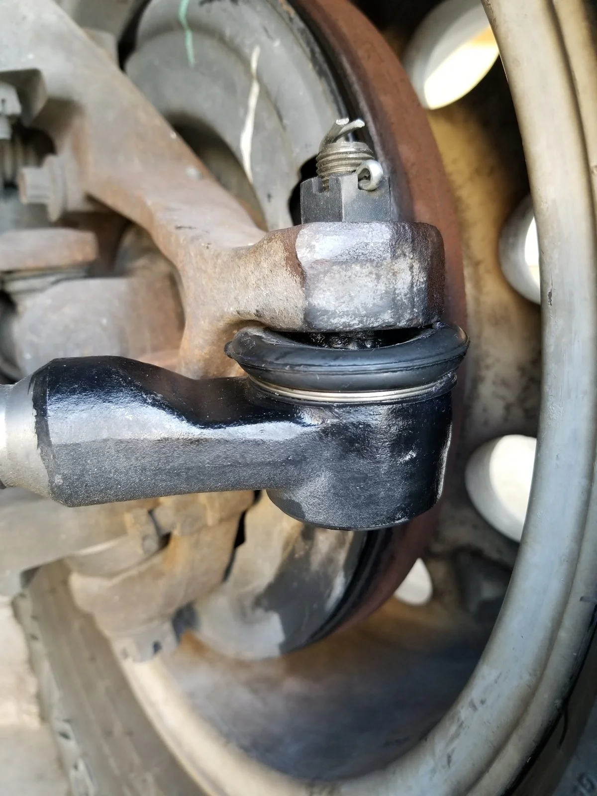

So I had issues with the driver side tie rod after the install. At first it wouldn't take grease. Had to tighten the zerk fitting and depressed the bead. It finally took grease. I don't think I over greased it but maybe I did??
I started hearing a little knocking and decided to check things out. This is what I found. It looks like the boot has collapsed. What are my options here in solving this issue?
Don't worry about the boot, you can add grease without fear of overgreasing the joint. This is not like the OE tie rod end where the little thin grease boot can be popped by going crazy with the grease gun. Even if the boot does start leaking grease no worries, just grease it often enough to keep dirt & junk flushed out of the joint.
Reactions: Gollywomper and JMT
Alright. Got more grease in it and turned the steering wheel left and right several times. It's not holding the grease and leaking out on the brake side. Can't really see or feel but there must be a tear. Guess I will have to order a replacement boot.
Reactions: KCsTJ
