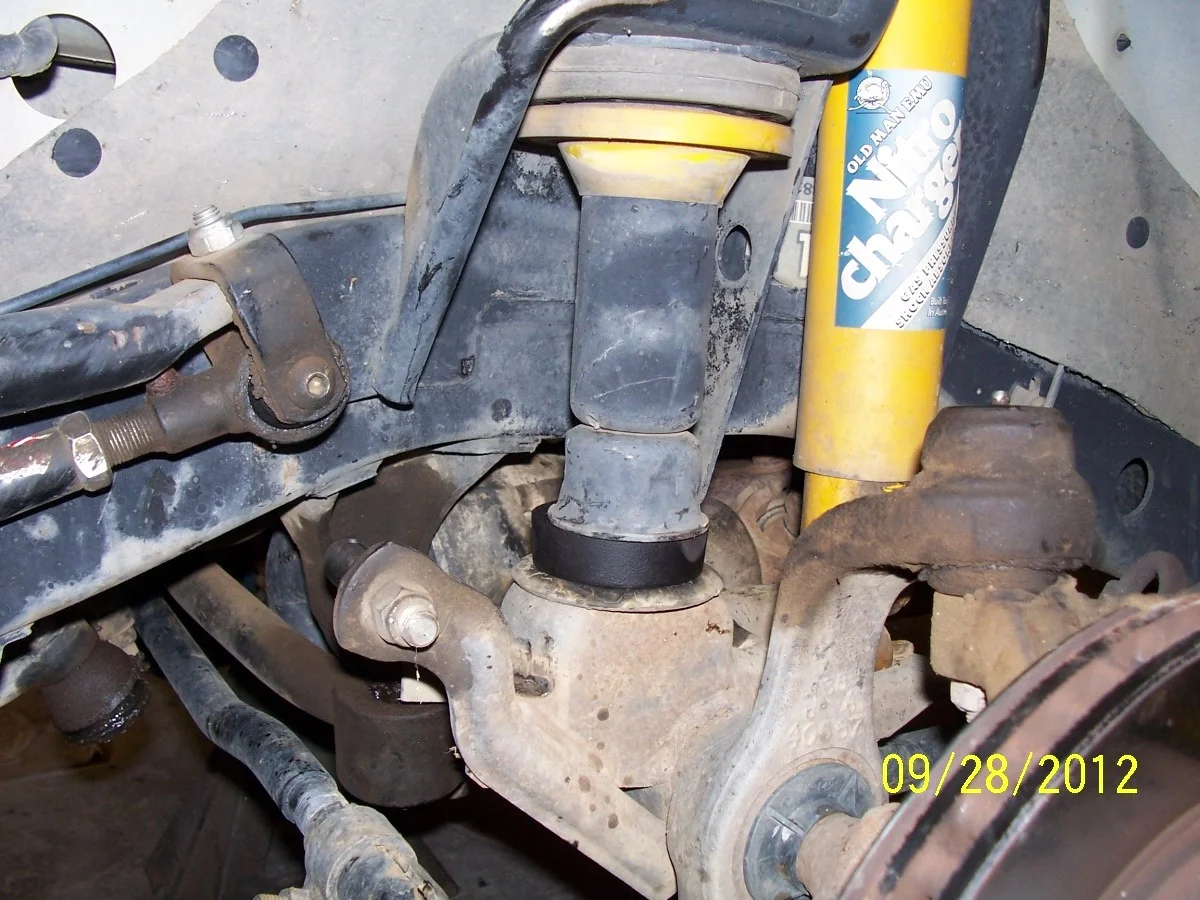

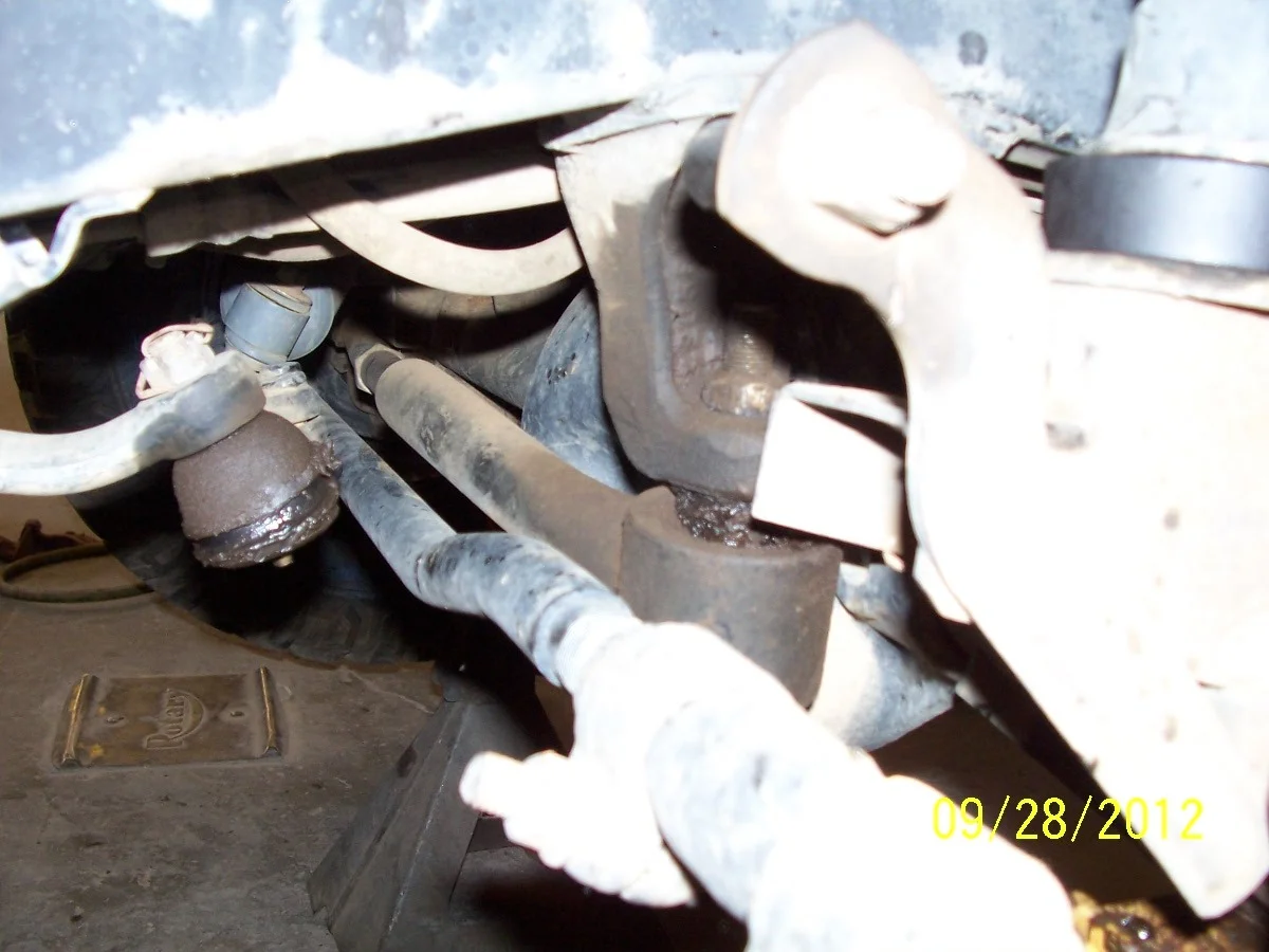

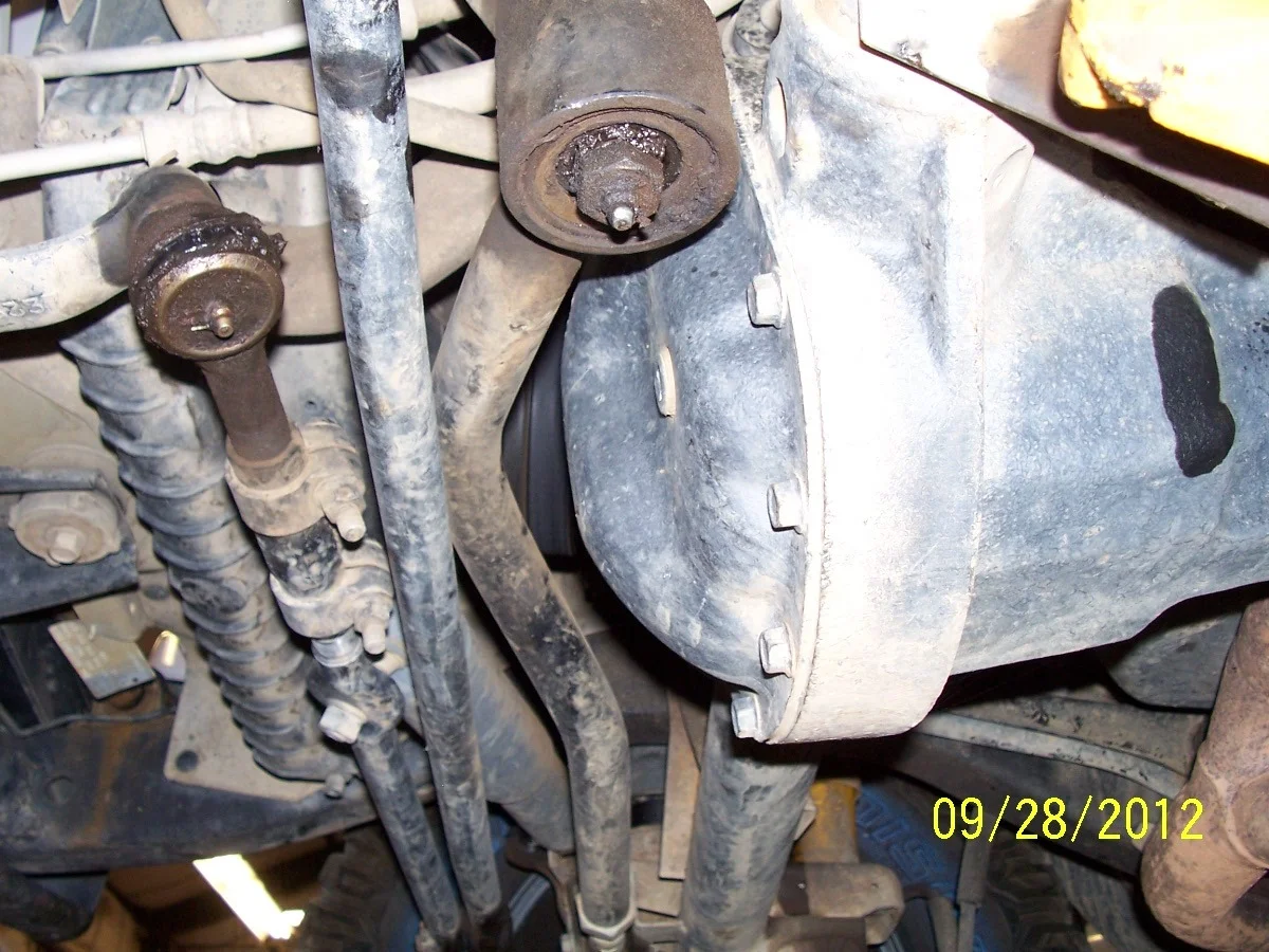

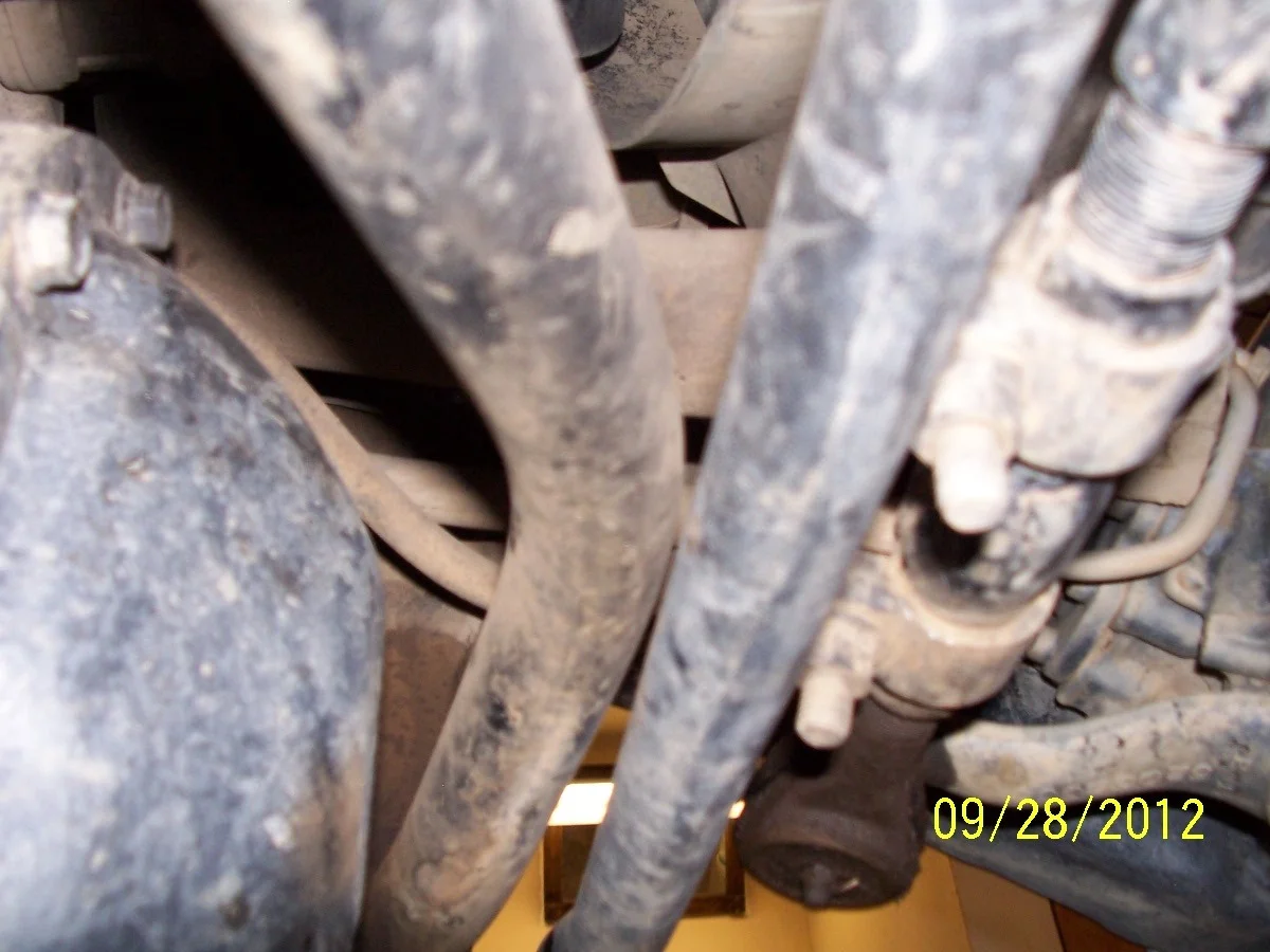

I only have Dana 30 experience, but the JKS TB clears with 0.75" bump stop extensions. Sorry, doesn't help. I'm a post whore too. The pics might help give you a visual to compare against a Dana 44 cover maybe.
View attachment 29835 View attachment 29836 View attachment 29837 View attachment 29838
Those pictures do help actually. I can see you've got an inch or so clearance between the diff cover and the track bar. I'm not sure how much further the Dana 44 diff cover sticks out in comparison to the Dana 30.

Mo' pictures, mo' betta'...
What's that look like when you start stuffing one side and drooping the other?
As you can tell by the date stamp, that was some time ago. I seem to recall having no clearance issues when I stuffed each side. That first pic of the JJ looks a little deceiving. I could stick my index finger between the JJ and the diff cover, so there was a bit more room there than it looks like. The tie rod came very close to hitting the TB though. I think, to be on the safe side, I'd go with 1" BSE's.
