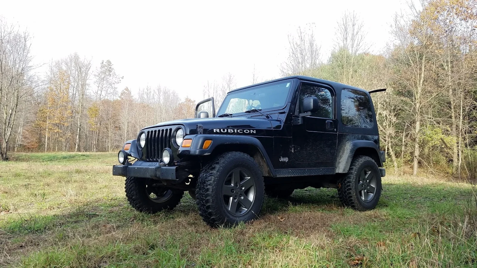

I run stock arms with a 3" suspension lift and they work for my needs. Better than most fixed arms IMO. Flexible and cheap ($22) to replace if you bend one.
p.s. When I had 32s on my old 98', I ran BDS 2" springs and a BL.
