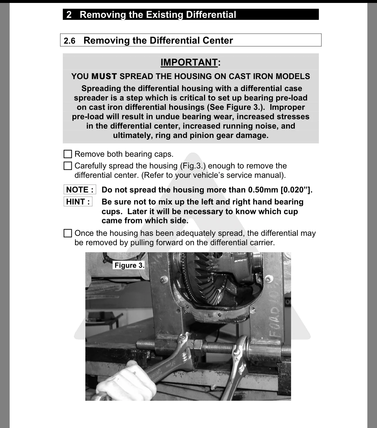

I have an ARB air locker in my front Dana 30 and need to replace one of the seals. Following the guide on the forums, I was about to remove the locker and then found this in the ARB install manual:
Will I mess up the locker if I don’t use a spreader? Also will it be a pita to get back in? I feel like I can probably remove it without one.
