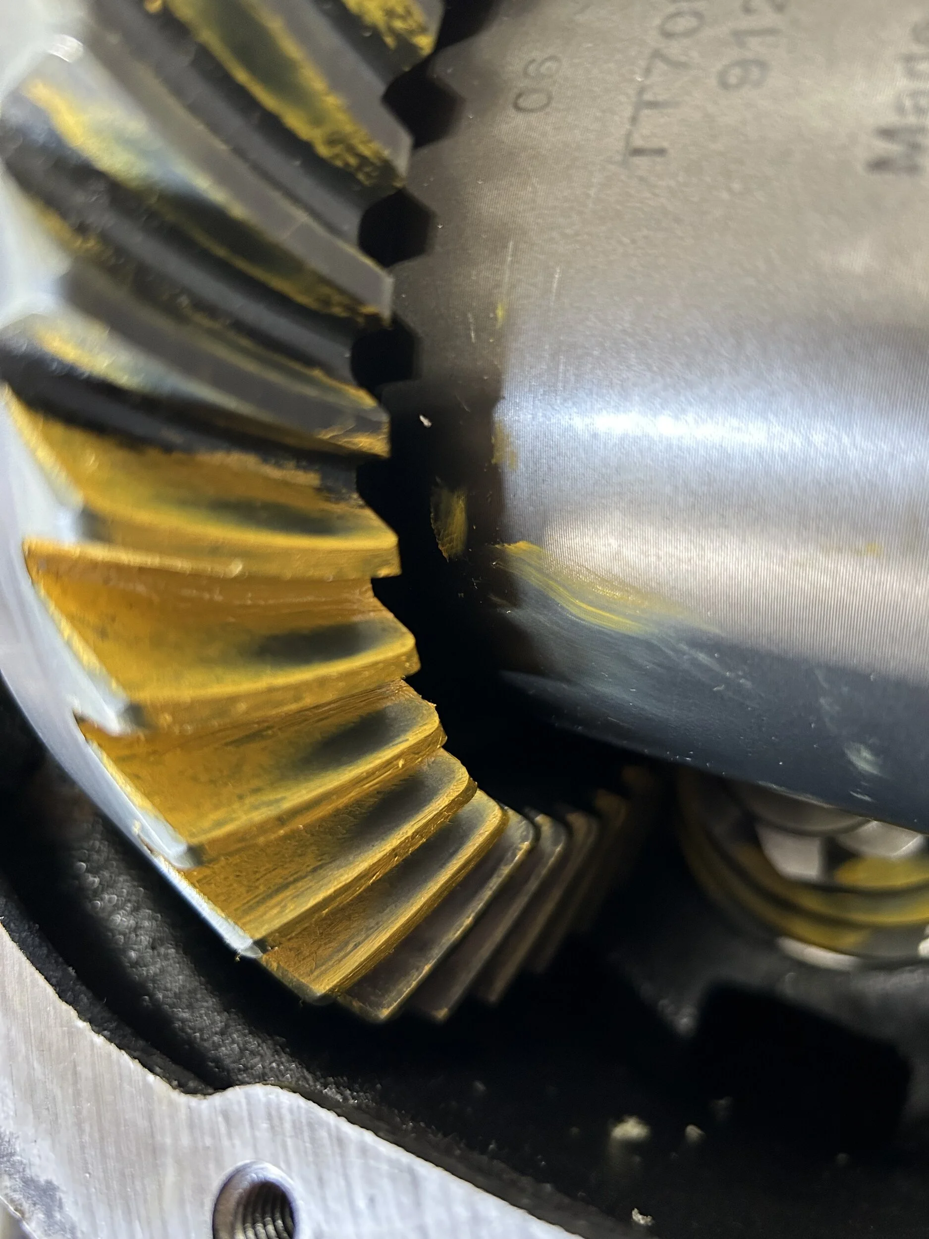

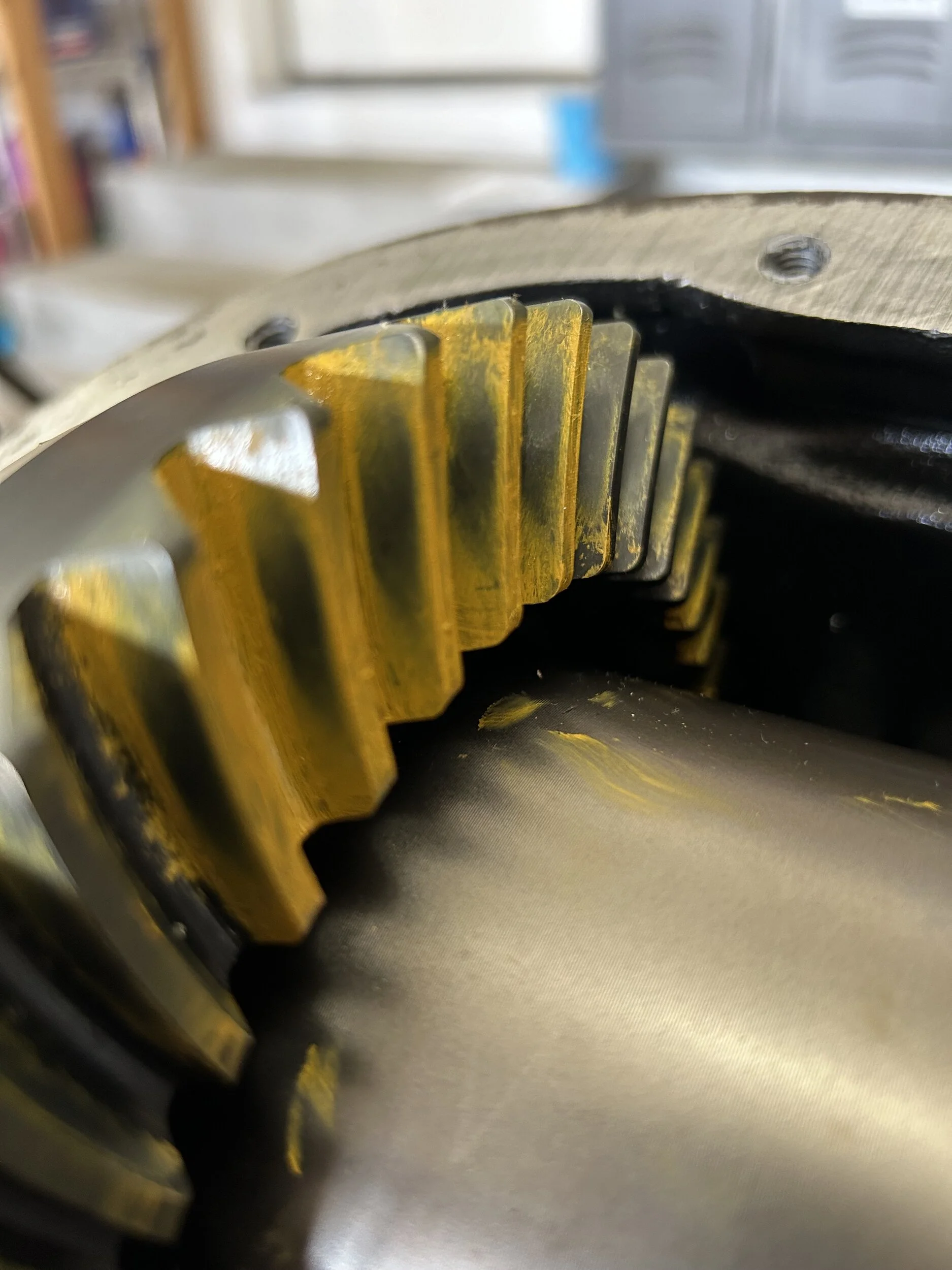

Looking for some feedback on this pattern.
Dana 35
Revolution 4.88
Eaton Truetrac
Pinion shim .042
Backlash .008
Pinion preload 12 inch/lbs
Ring gear shim stack=.149
Non ring gear shim stack=.173
Started with .045 pinion shim and adjusted to .042. Drive looks good (I think) but not sure about the coast side. Any thoughts?
Now I’m fighting the crush sleeve. I bought a Ratech Smart Sleeve but went a little over and hit 20 inch/lbs, and it just felt too tight. I tried the one that came in the master kit, but that sucked ass. I’m ordering another Ratech and pinion nut, I’ll be more careful next time. Thanks again.
