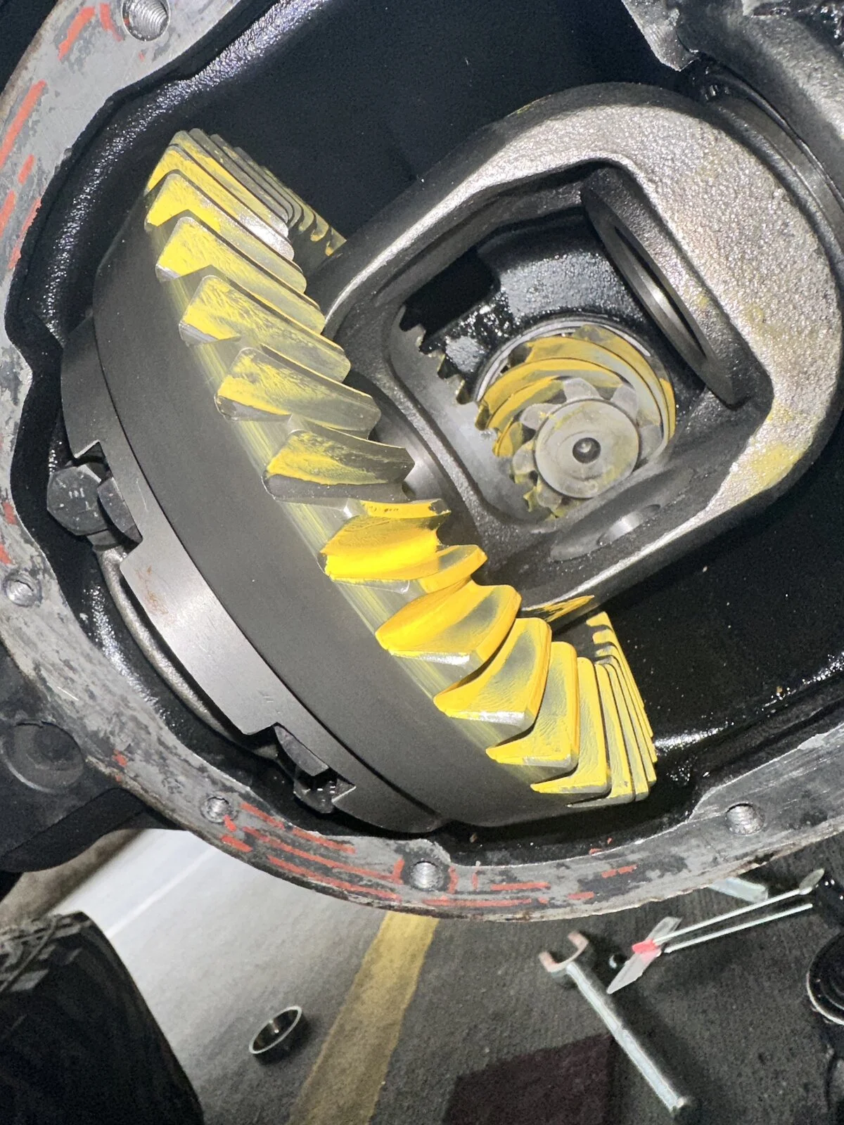

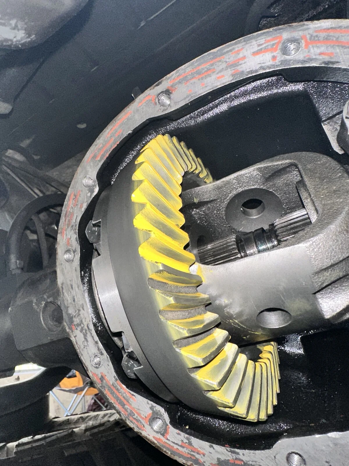

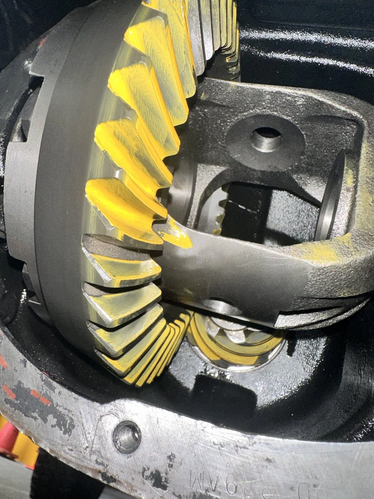

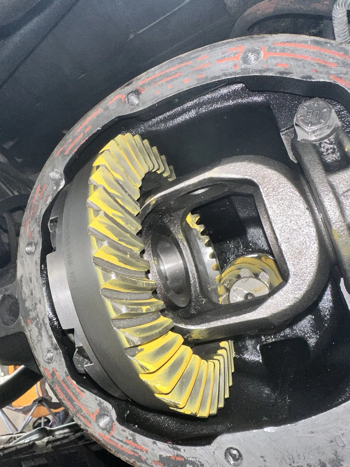

Throwing 4.88's into my Dana 35 (from 3.07). Made my inner pinion setup race. Extracted the factory pinion shim, annoyingly between the pinion head and bearing (0.042).
Built a stack equal to the factory shim and threw it behind the inner pinion race. Thick factory carrier shims wouldn't fit with my new carrier (was below carrier break), so made a new stack.
Got my backlash at 0.008. First pattern looked a bit shallow so added 6 thousandths onto the stack (0.048). This pattern has me pondering a bit. On the one hand, it doesn't seem deep but on the other hand, there's a hard line on the root of the tooth on both the drive and coast sides.
Does pattern look deep?
