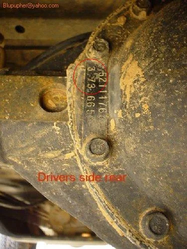

This is how to determine your present axle ratio. There's a steel tag bolted onto each axle's diff cover at its 9 o'clock position. The one below is indicating the axle is geared with a 3.73 ratio. Know that the front and rear axle ratios are .01 different from each other so don't be alarmed if one says 3.73 and the other says 3.74, that's normal. That .01 difference is only because of the slight difference in ring gear diameters between the front and rear axles.
