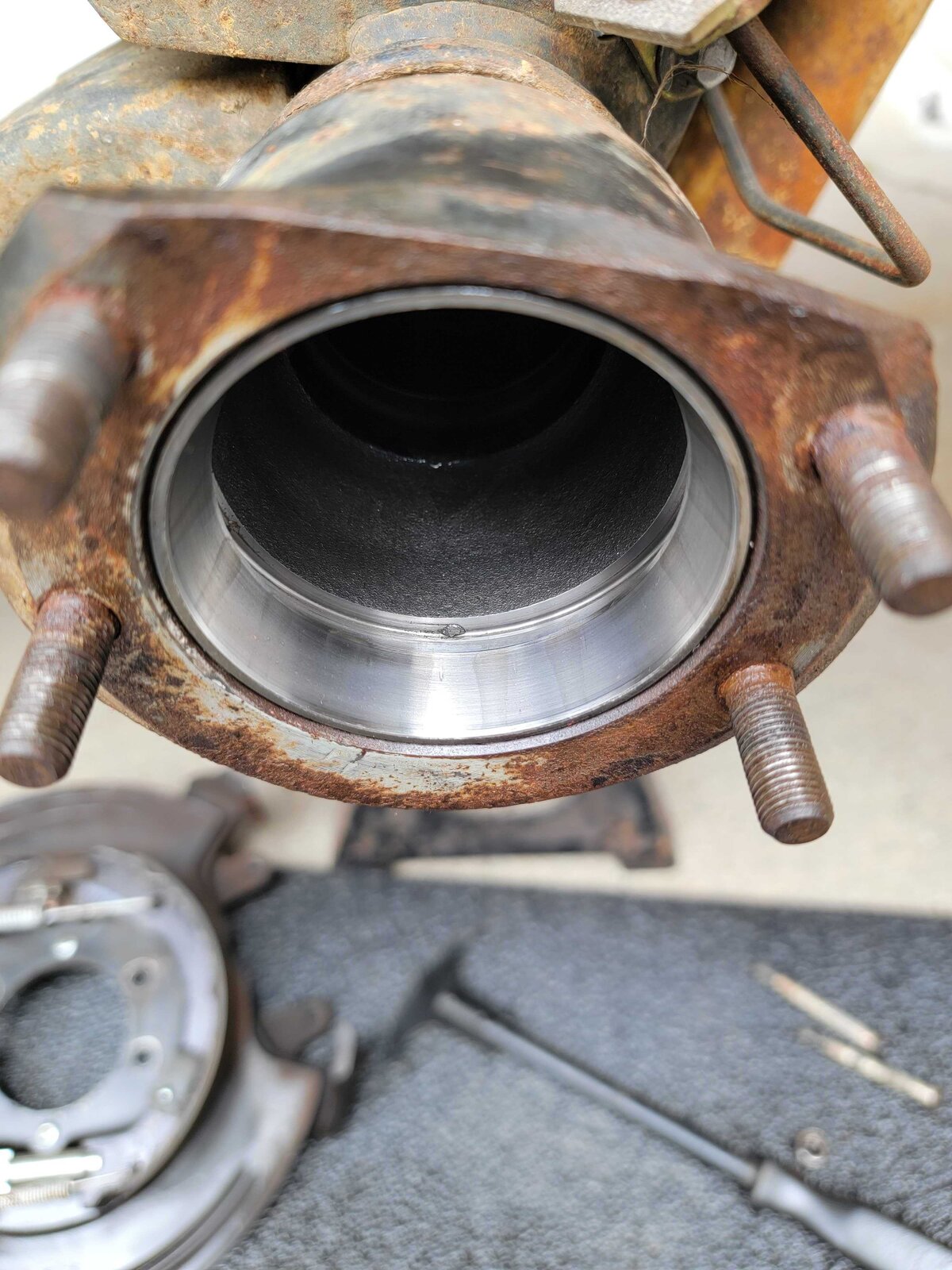

I have everything torn down, but I cannot get the driver side bearing race out. A couple things I noticed...
There is a chunk of metal in the axle shaft tube itself, right where the bearing race should seat. I have no idea where it came from, but I am wondering if it deformed the race ever so slightly to put a bump on it that won't let the race come out. I also noticed some very minor scratches, likely from me re-installing the axle shaft a month or so ago.
Any ideas how to get this race out? Do I carefully cut it, or do you all have any tricks!? I also plan on taking some emery cloth to the housing itself to soften those ridges.
