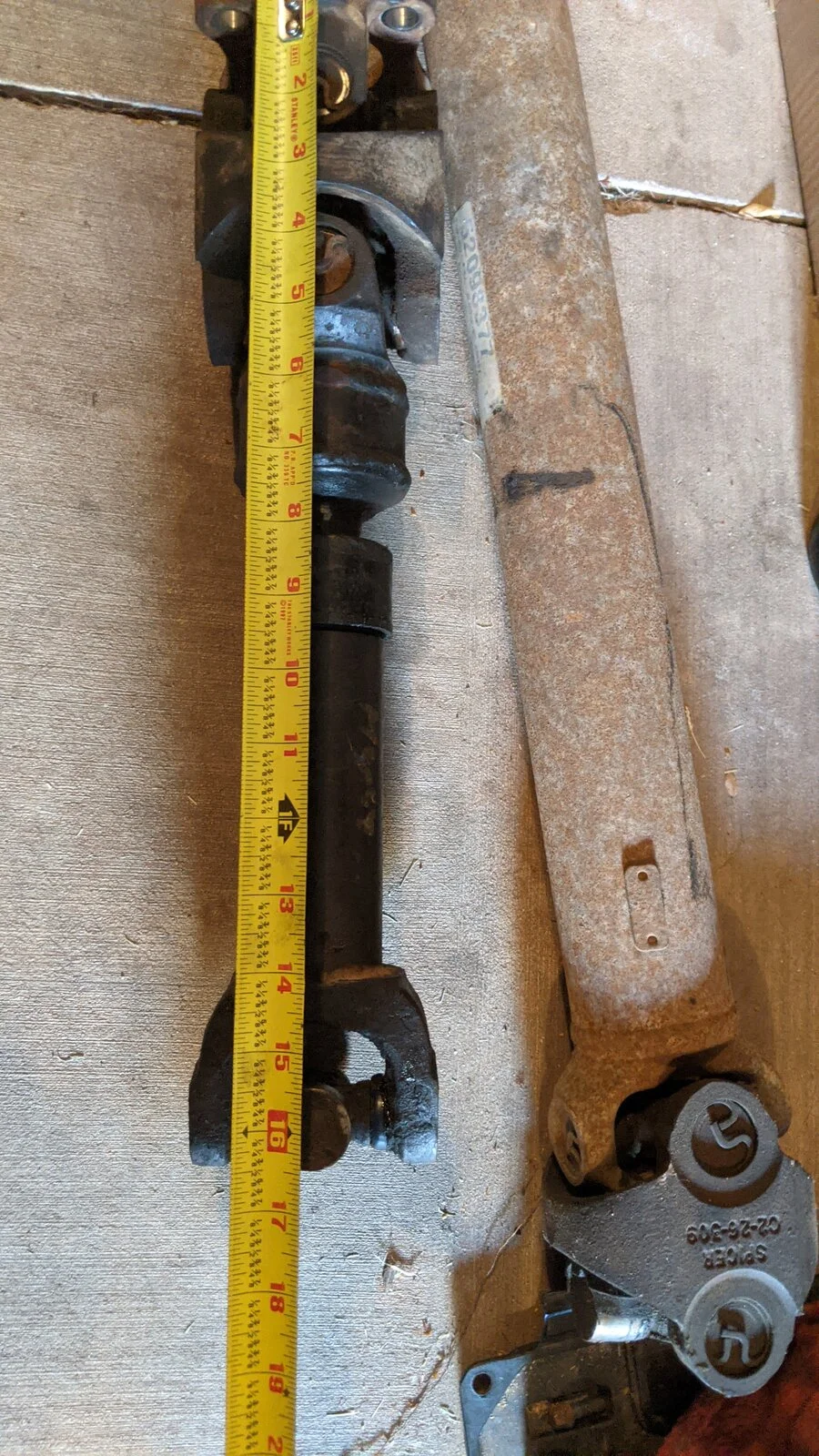

Hmm... I have a 4" Currie lift and both my front and rear DS are too long. I'm going to need roughly a 15" long one for the rear

Well I'm not sure then... From the CV flange on the rear of TC to the yoke is 15 1/2", my DS is around 17" fully compressed. My front measures 37" from yoke to yoke, my DS is around 40" compressed.
I had issues with the rear driveshaft being to long with the Dana 44 swap. That was with a cheap 2 inch lift that had probably sagged down to 1.5 so your mileage may vary.
