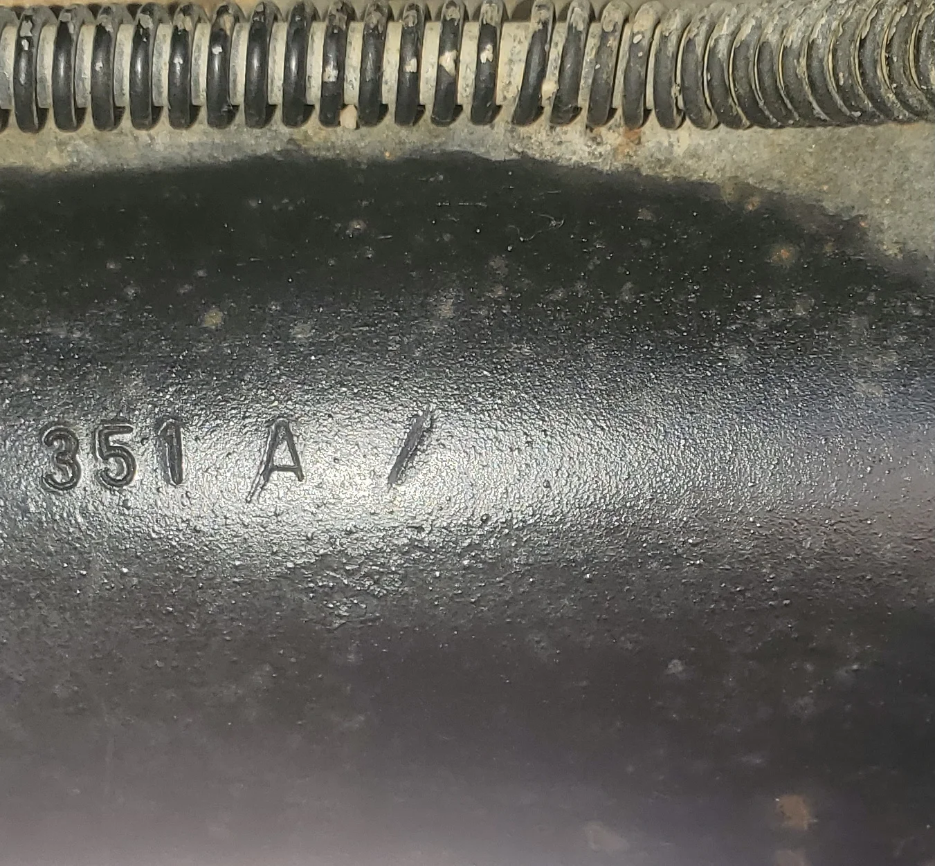

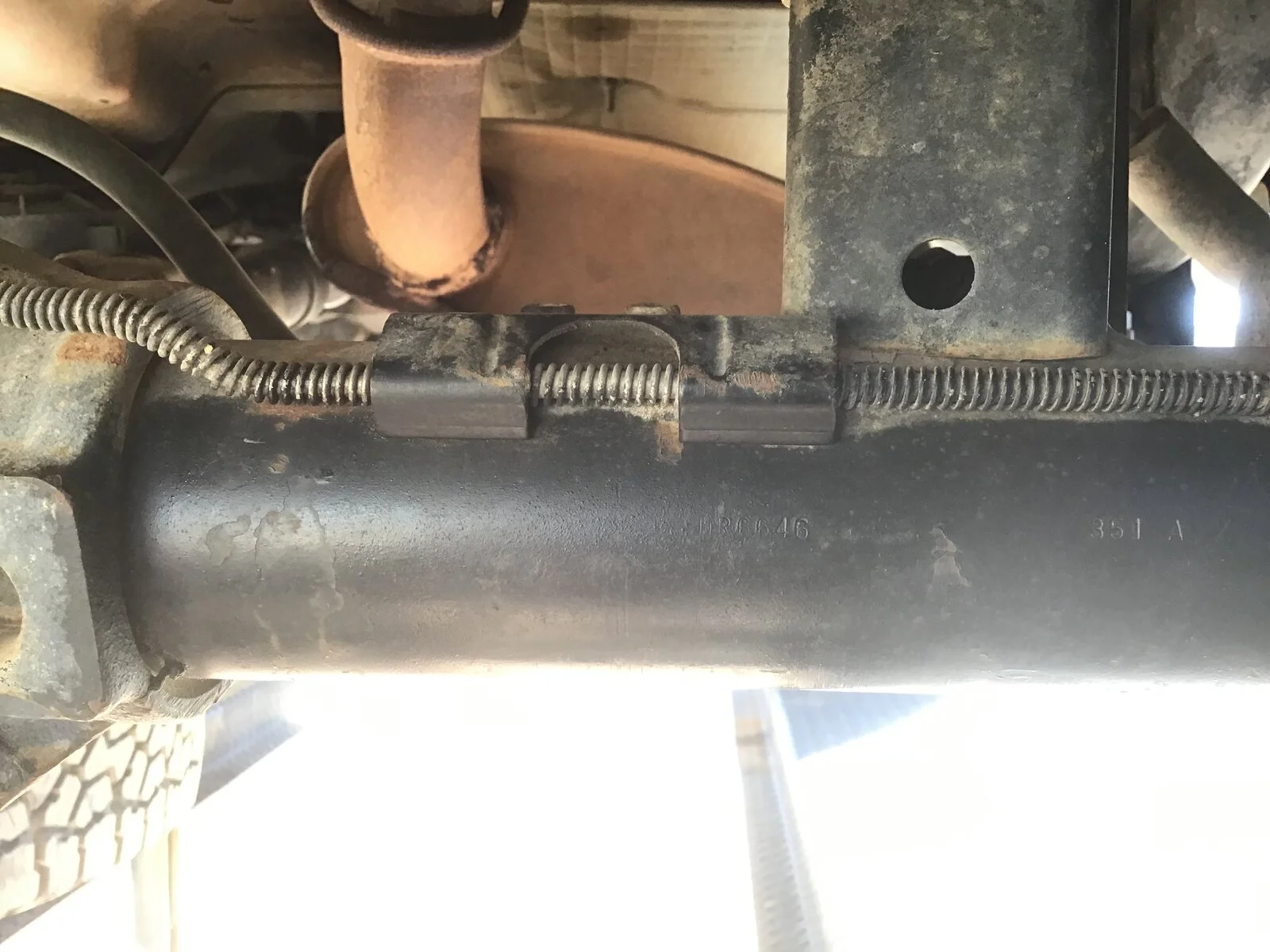

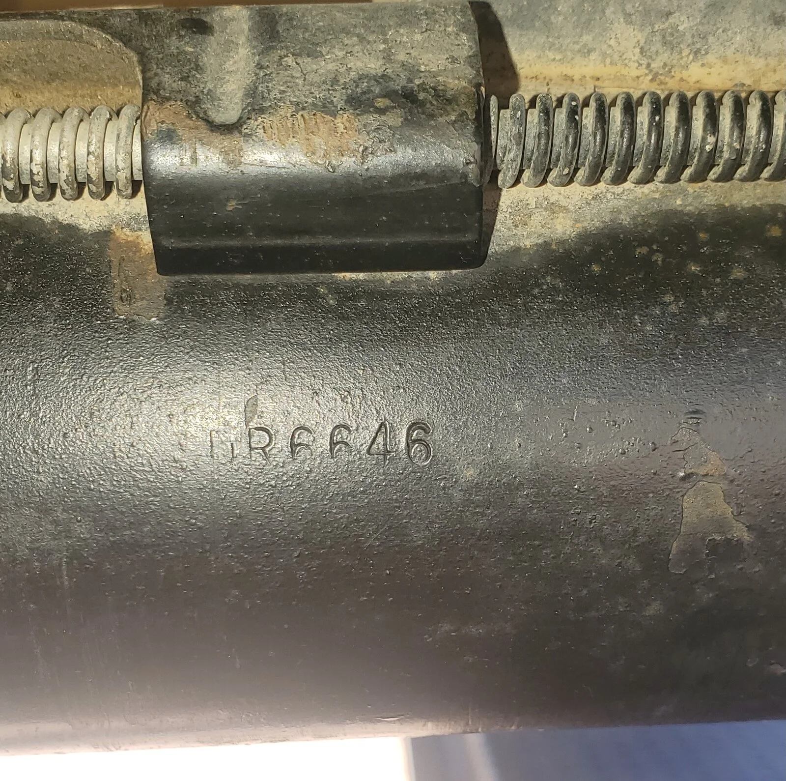

I need help identifying the Dana 44 rear axle in my 2003 Jeep TJ. The axle is not original to the 2003 and I was told it came from an earlier Sport. The location where I expected the manufacturing date to be appears to read “ R6646”. The location where the part number or BOM is shown to be appears to reads “ 351 A / “. Planning to install alloy axles and a disk brake conversion.

The brake line hold down clip shows that to be a TJ rear axle. A pic of the cover will tell the rest of the story which if it is a Dana 44, then the only thing you need to know is that it is a 44. The housing ends and brake solutions are the same for all TJ 44's.
