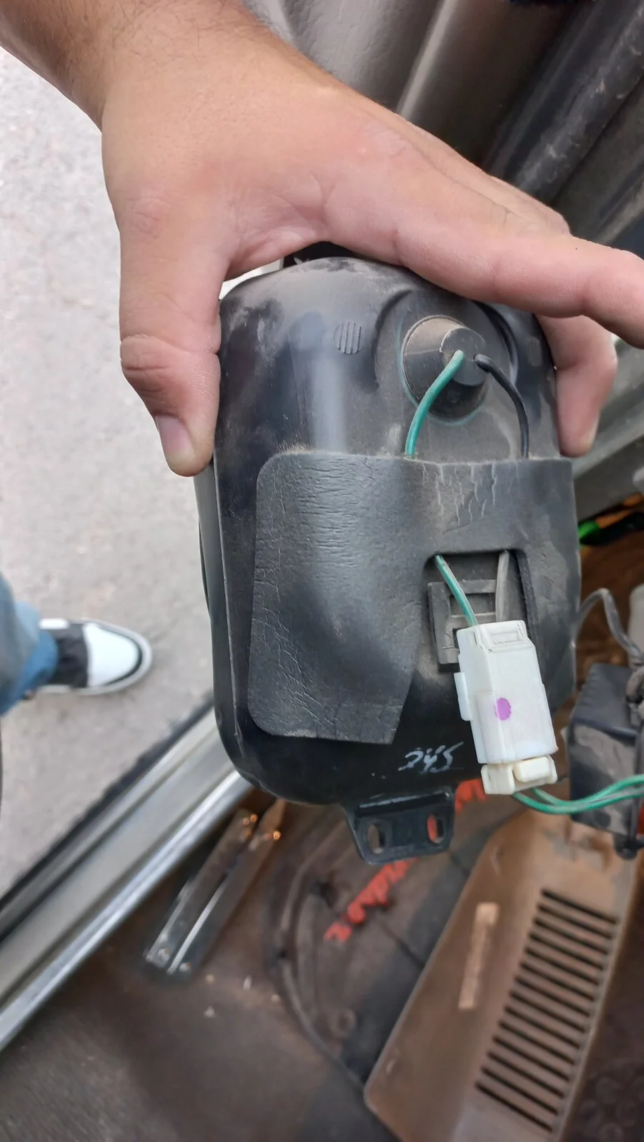

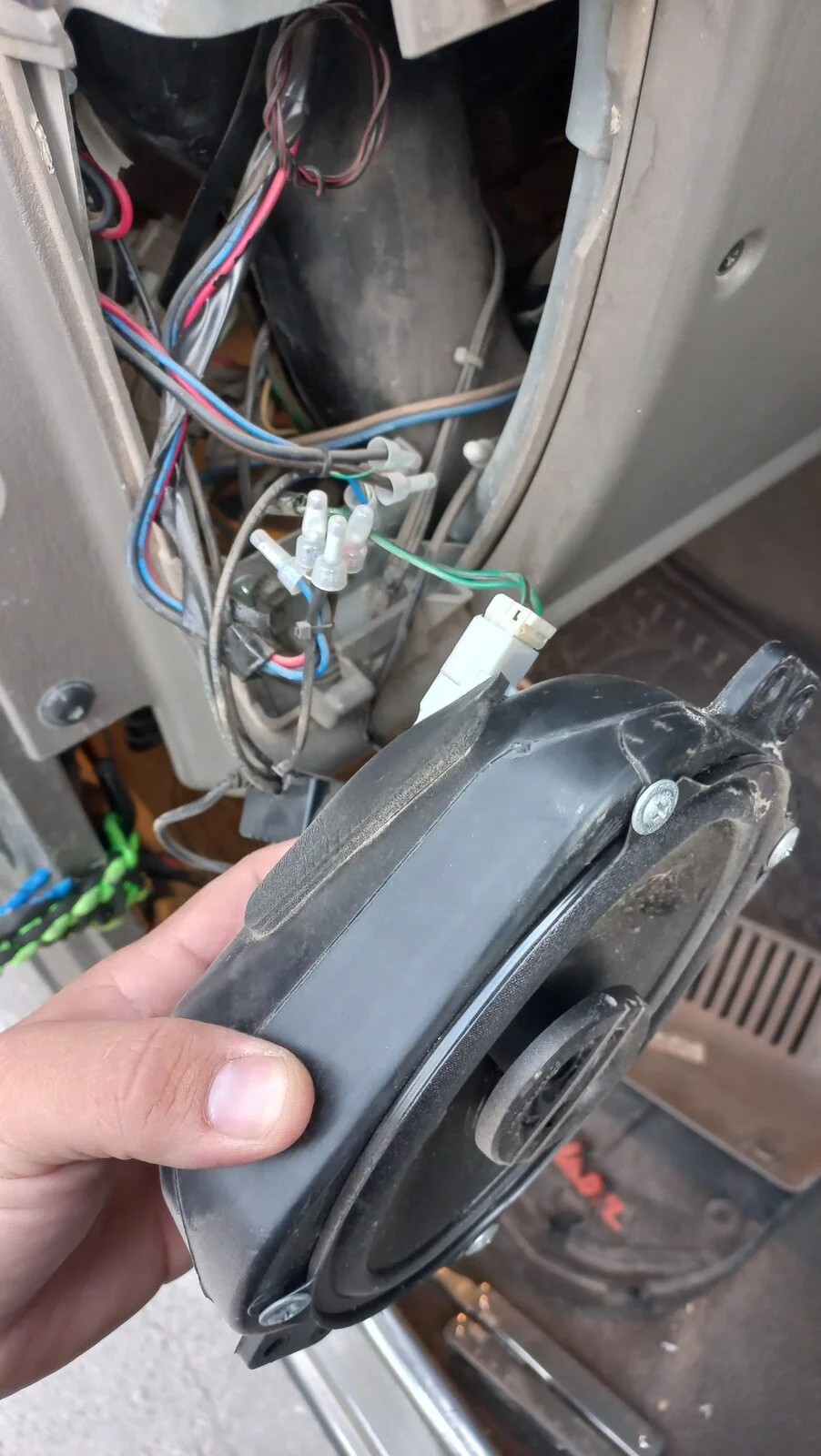

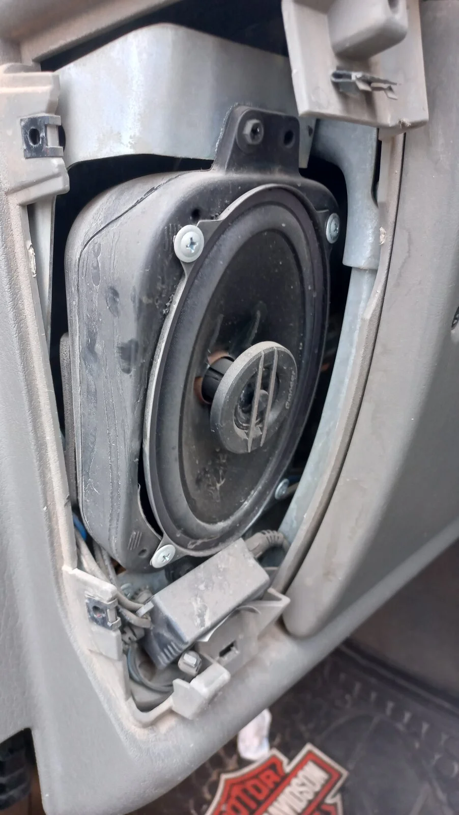

Hello,
I recently went for a several days trip and I noticed that the sound of my speakers were way in the rear part of my jeep, I do have an amp for all the speakers, the roll bar speakers, two 6x9s with pods in the rear as well, the dash and two subwoofers in the back so that's not the issue... the issue will be in the front because even with the good volume and clear sound of my set up the direction of the sound is just messing me up... way too in the rear part of the jeep and nothign in the front and when topless well.. even worse.. so I want to improve my almost-muted front 4x6s pioneers in the dash... when checking if they were wired to the amp they are.. (when I unplugged the sound bar channel in the amp the front speakers and the sound bar went mute at the same time) so I think they are wired in parallel or something like that with the soundbar.. so maybe I'm not being clear with my concern but... if the soundbar speakers sound way louder than the dash speakers (more than twice I'll say) and they are wired to same channel in the amp.... is the fact that the front pioneers are only 35 RMS vs the 100 RMS of my soundbar speakers are affecting the sound output? then.... if I add some polk audios (looking for the DB522 round 5.25in with the brackets) would they sound more like the ones in the soundbar since they are pluuged into the same channel of the amp? I checked and I have a pod for the 4x6's not sure if they worth something.. but.. opinions?
Ps. I'm planning in getting rid of the pods and connector and wire them directly with to the round speakers.

You can also get pods that accommodate 5.25s. If you go with components, you can also add tweeters to the dash. With the tweeters mounted higher, you get better sound-staging. That plus the improved front speakers (with pods, and amplified) means you won't have to fade your volume so far to the front.

As a start, you should definitely fade the stereo to the front as someone else has said. Sound should come from in front of you, not from behind. The next easy upgrade is to 5.25" speakers in front. I found some brackets on amazon last year that angled the speakers up so they're at least perpendicular to the ground and not aiming toward the ground as is the case with the stock mounting locations. These upgrades have given me a surprisingly high soundstage for a wrangler.
