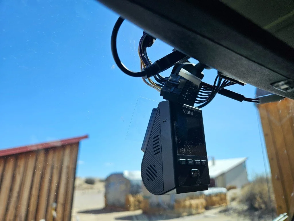

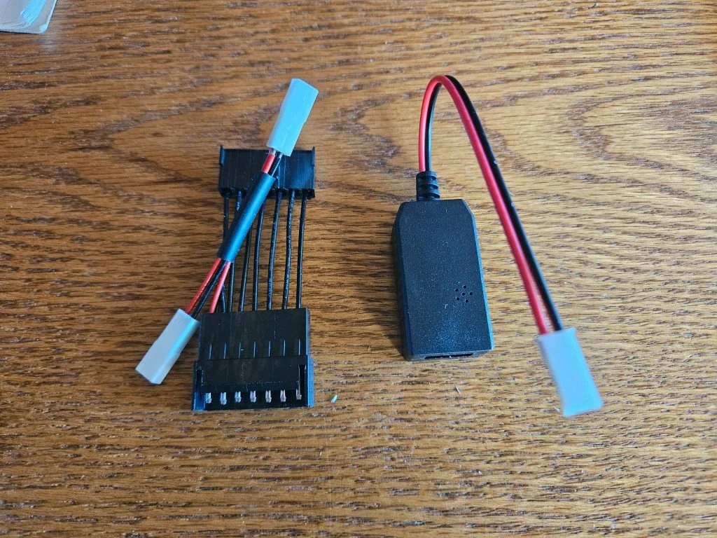

Hi Folks. Maybe someone can find this useful. We typically have dash cams in our vehicles. I noticed my TJ has a basic auto dimming mirror so set off to fine a dongle that would work. The mirror has a 7-pin Type B connector. I found a couple of dongles and bought this one from Amazon. It is NOT listed for a Jeep but it does work. Pretty simple. Unplug the mirror then put this in between. I used a VIOFO A119 MINI 2 Dash Cam. I put one in my daughter's car and it is pretty nice. Now days a dash cam is cheap insurance.
