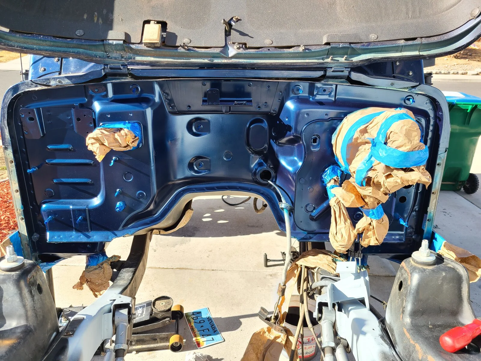

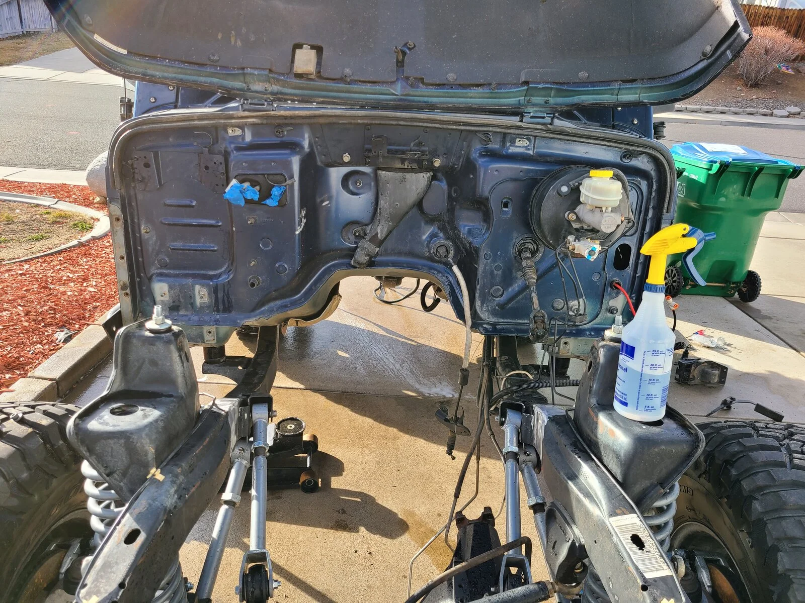

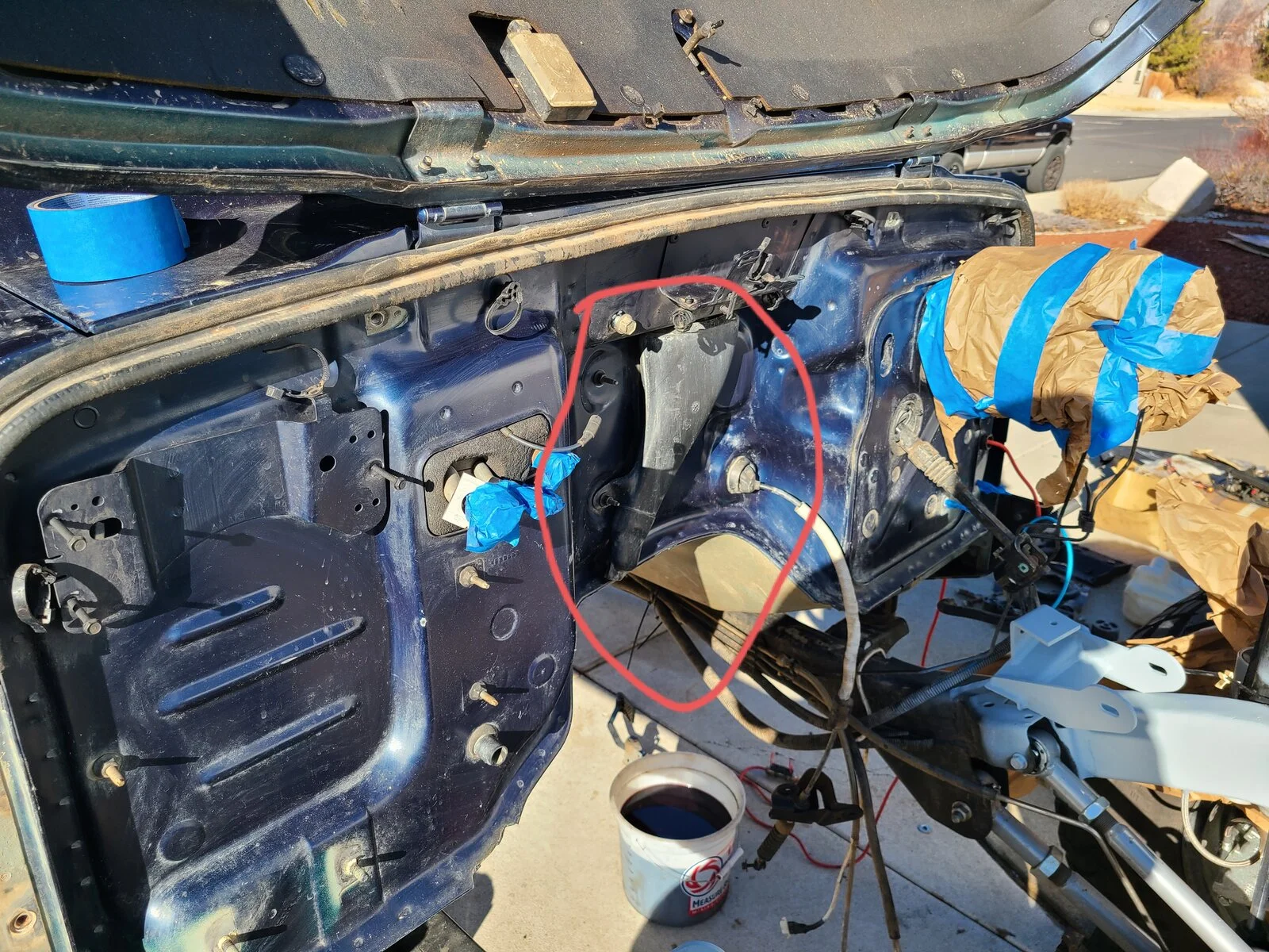

Got everything protected and sprayed the firewall. Soooooo satisfying. @Wildman If you get the chance to spray before you swap your motor....you definitely should.
After cleaning, before respray
After resparay

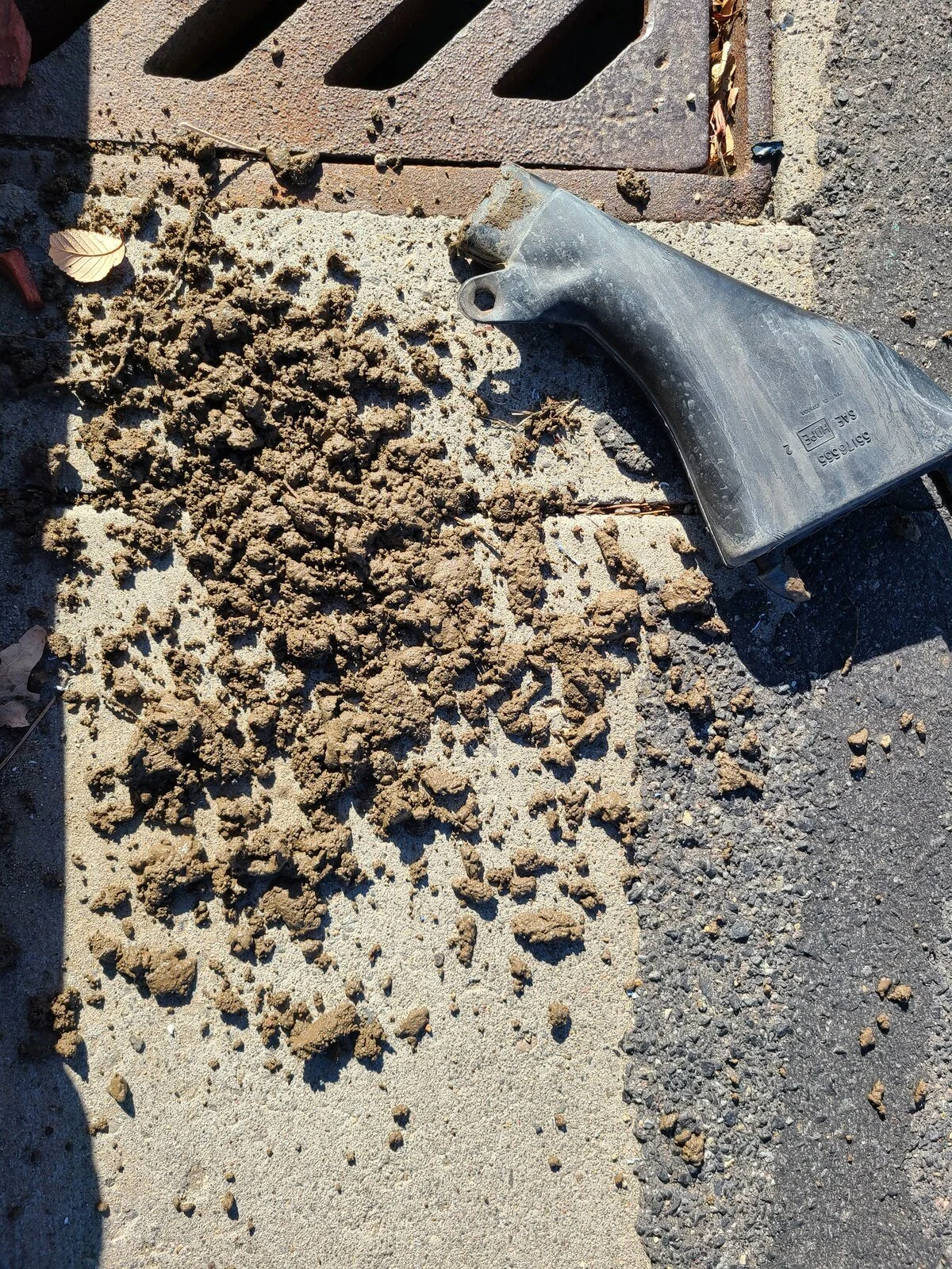

Also...found this little gem. When I pulled the cowl drain, it weighed a freaking ton. Lo and behold, the duct was literally packed solid with mud, sand, and shit.
That was fun. A screw driver and good rinsing later, and we were back in business.

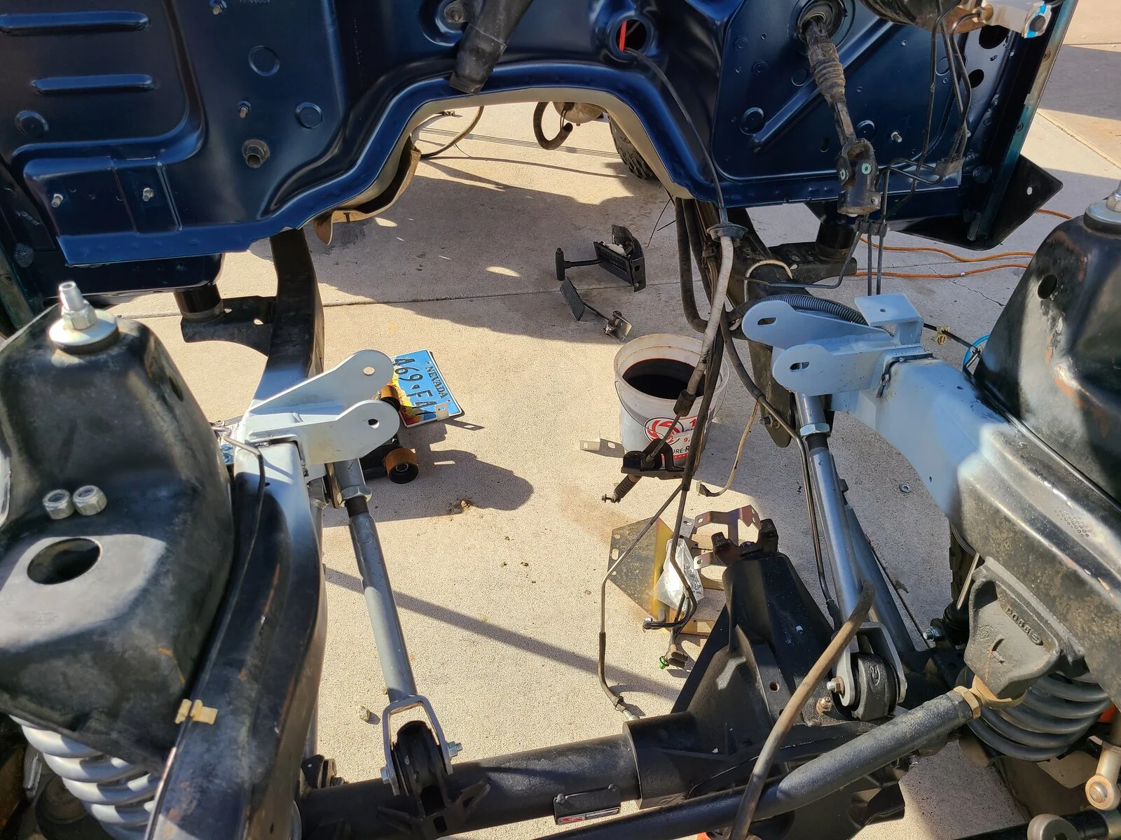

I did a little prep on the frame and shock towers, I'm going to repaint the front clip of the frame after the mounts are in and verified. Still some work to do there, but will definitely be worth it in the long run.

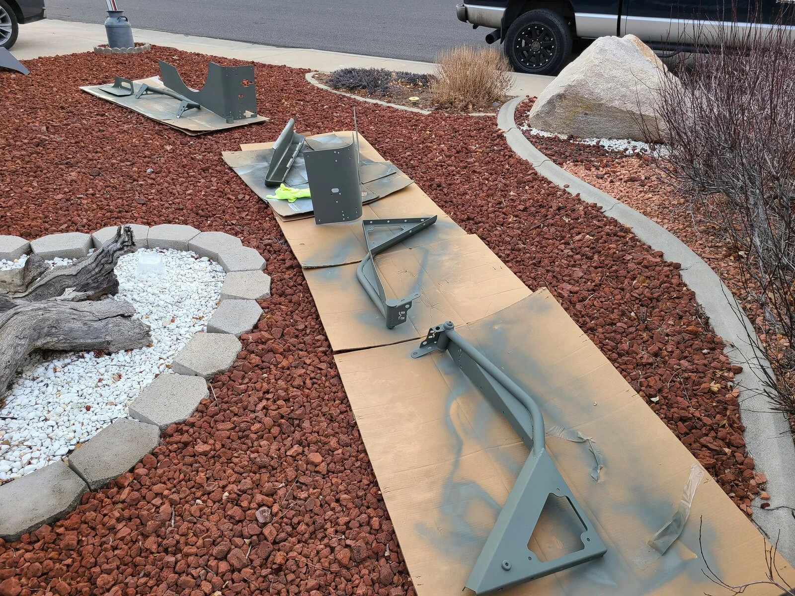

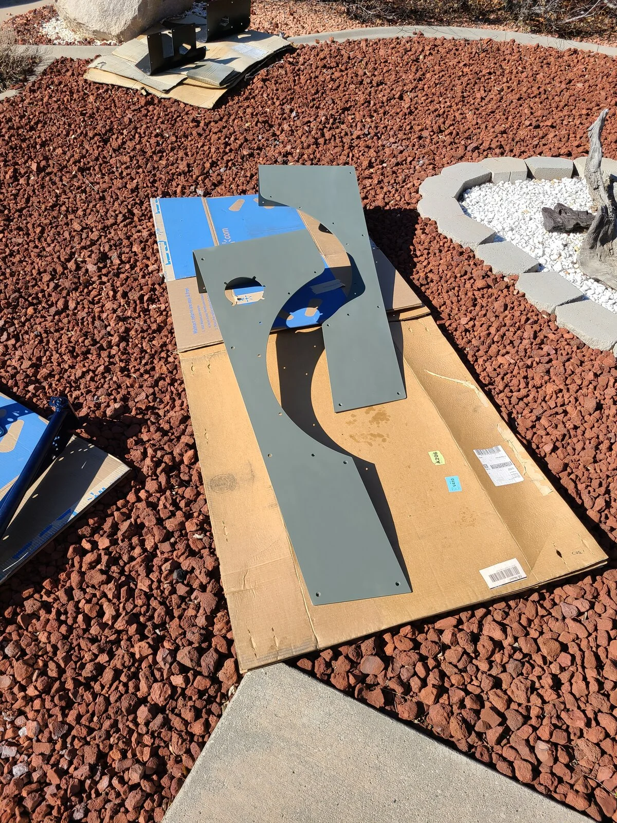

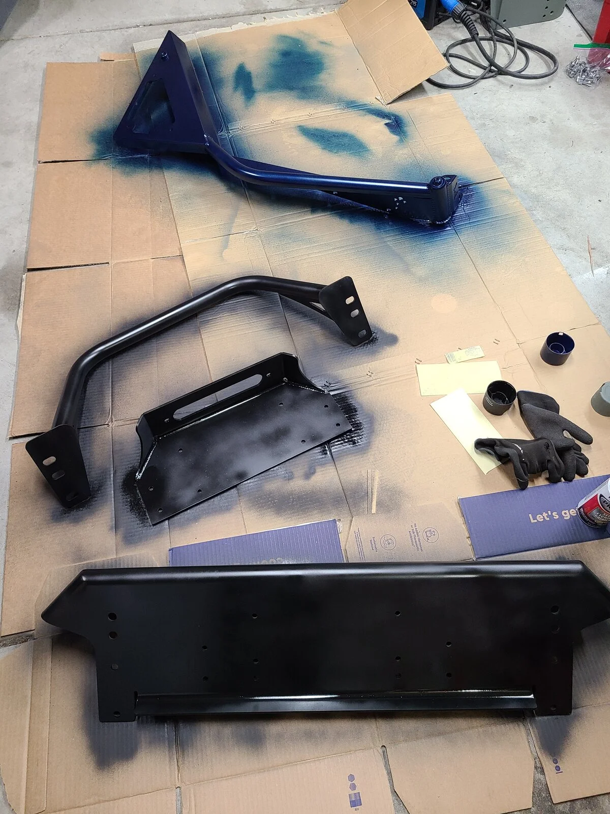

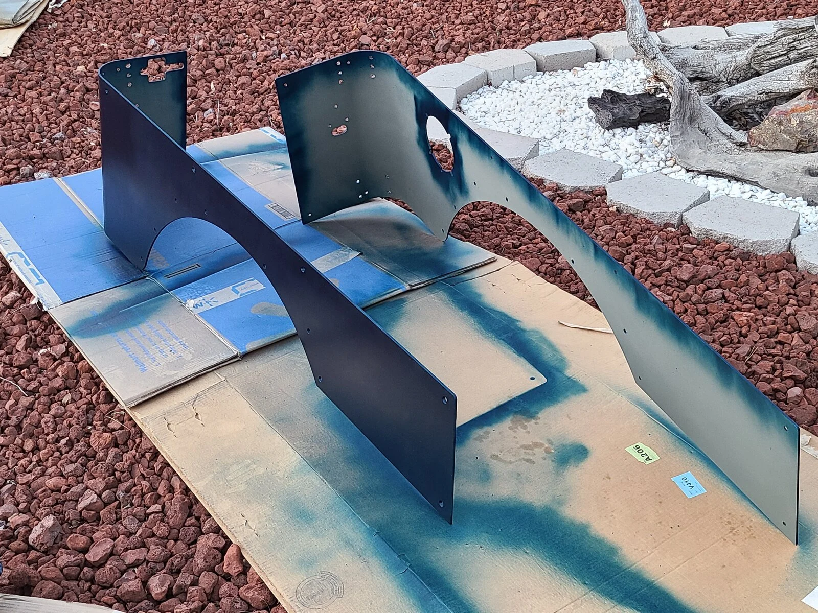

While the weather held, I grabbed all the remaining aluminum and cleaned, prepped, and hit them all with primer. Front bumper, loop, winch plate, corners, and front fenders.
Front fenders are going to be color matched blue, bumper and accessories will be satin black, I'm debating on the corners going silver or satin black. I had been going the satin black route, but the dark blue looked good with silver contrast when I was test fitting them. We'll see.

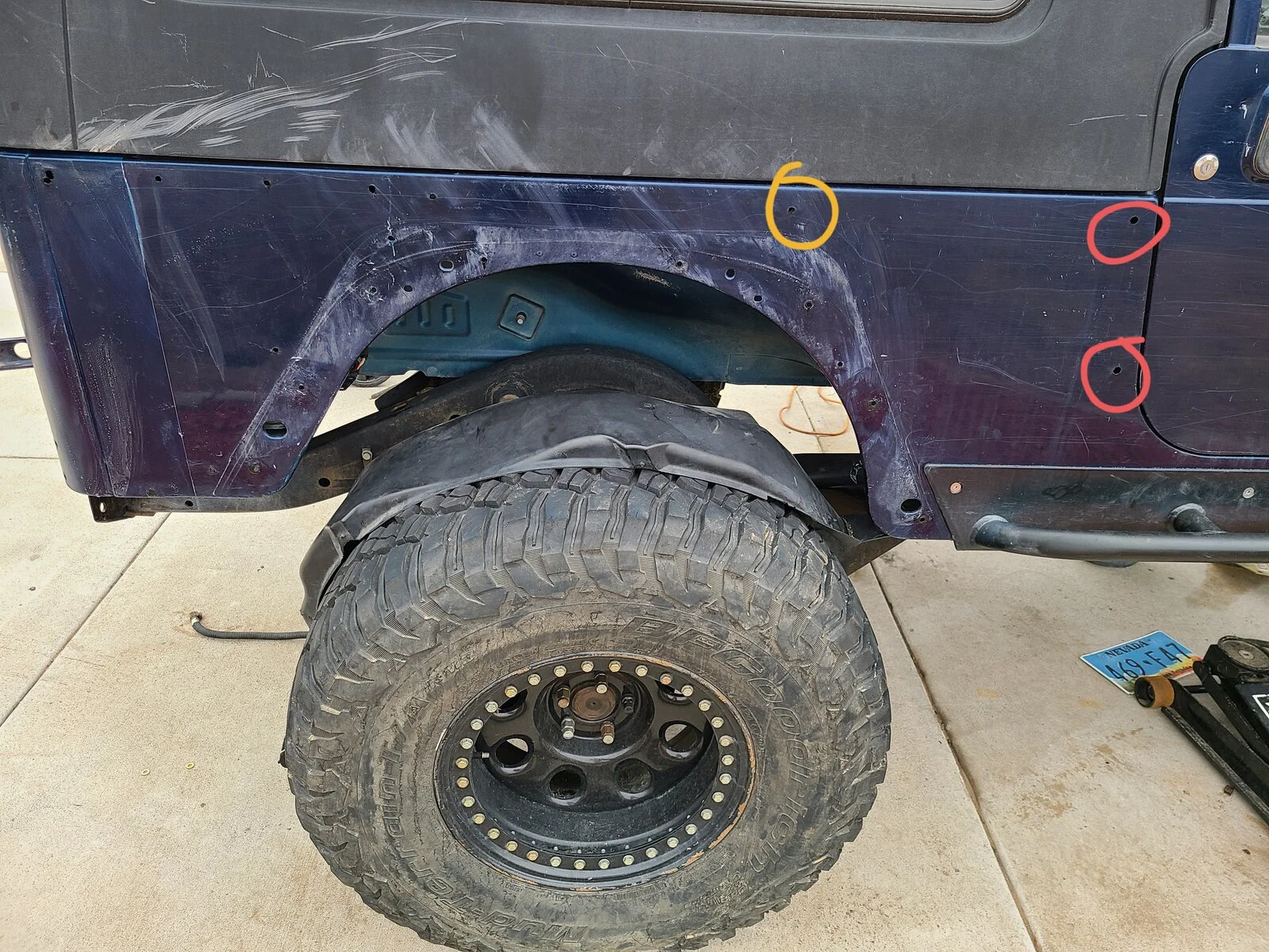

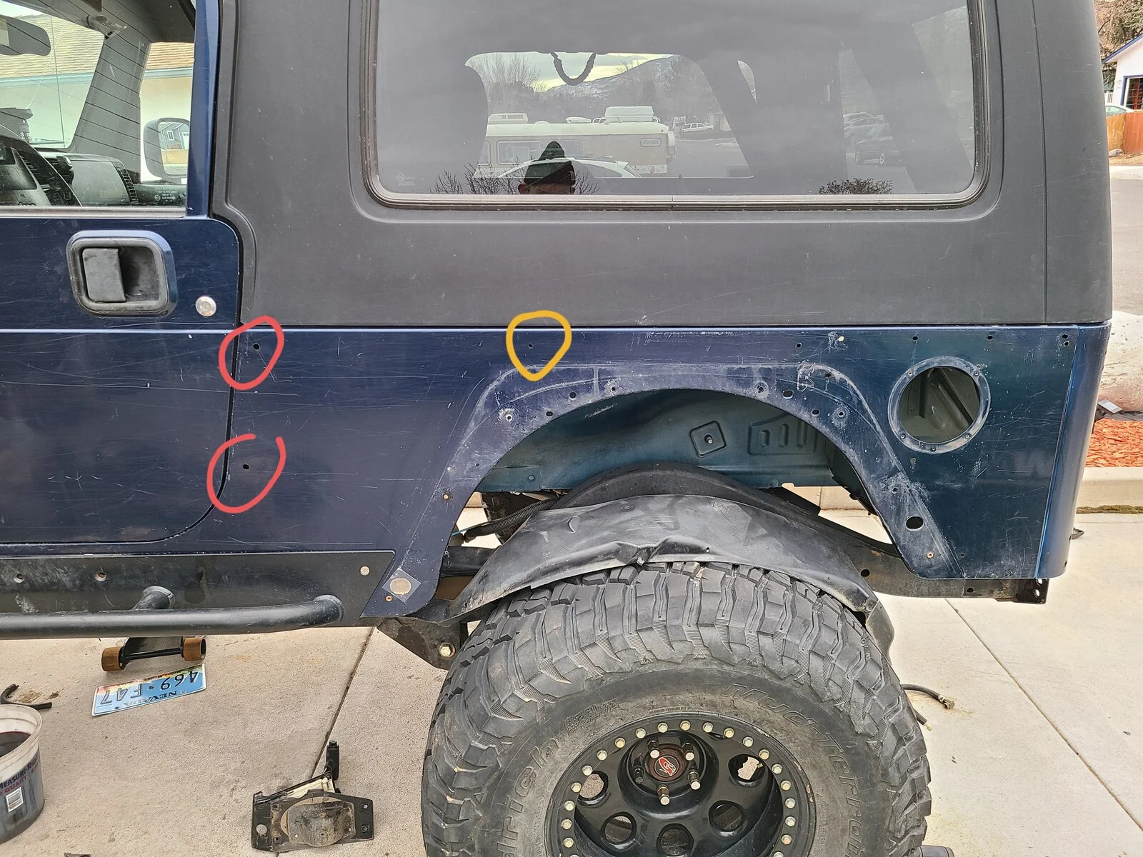

My tub looks a bit like Swiss cheese without the corners. I went through and deburred all the holes, then painted all the holes to prevent rust.
I had mentioned earlier that I went with longer bolts to avoid nutserts. In the pics below, the holes in red are the only ones that I used nutserts. The yellow replaced with a 1.5" bolt, and the purple on the rear took a 4" bolt.

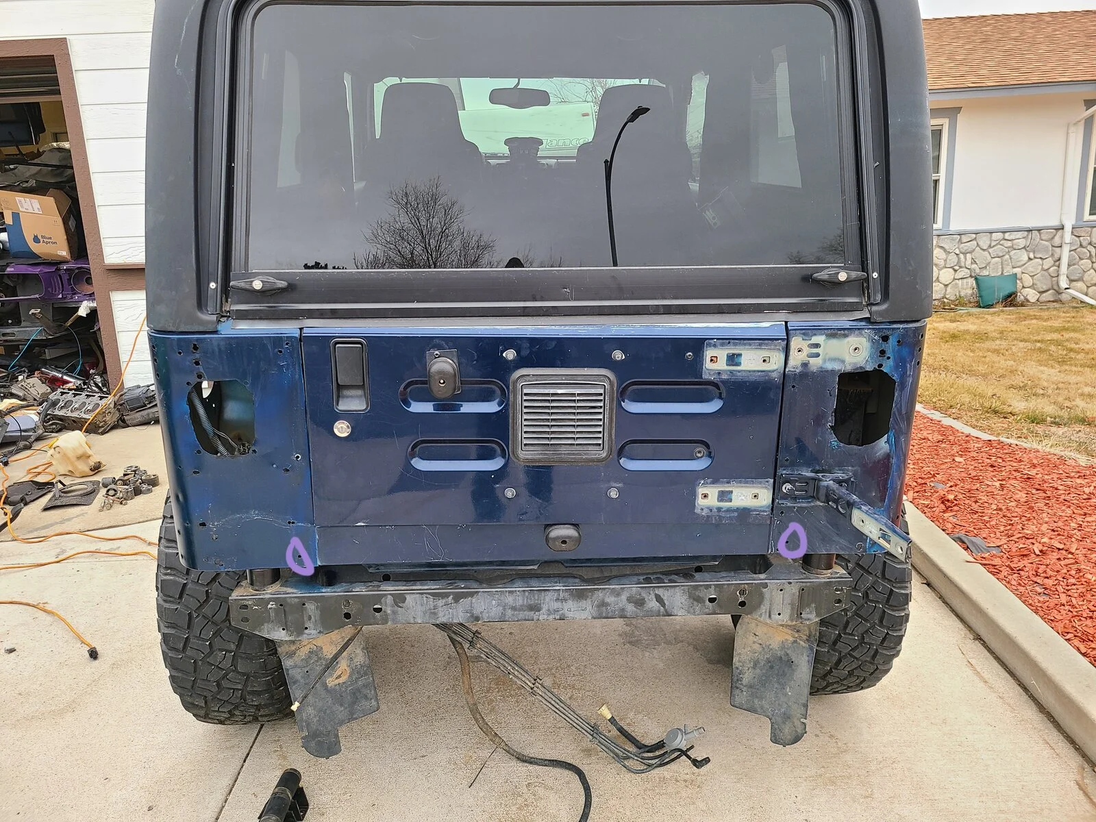

As you can see, the PO hacked the shit out of the tail lights...hence the corners in the first place.

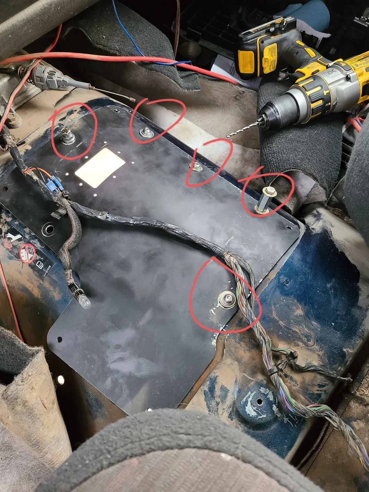

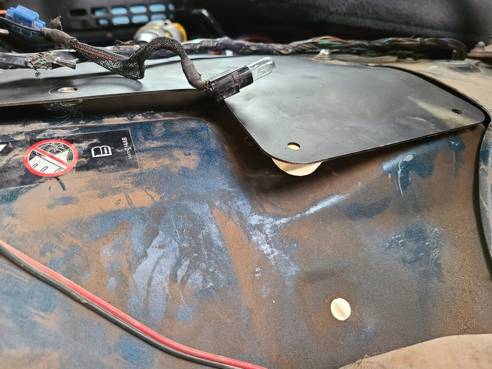

The last thing I got after before calling it quits was the genright tunnel cover. It shipped flat, so I started with bending a curve into it using the edge of the front tire. Then I continued to bend it as I added more bolts. The holes circled in red lined up with original holes in the tub. The other holes need to be drilled.
As you can see, the corner by the transfer case lever opening is going to need some serious...massaging....
Also, the inside of the tub is going to need a good cleaning too when I gut it =).

The rear sort of looks like the YJ I use to own. I hacked the rear to allow me to use the stock light but make them flush mounted. I took some cardboard and made a template but it still wasn't pretty.

Man that firewall spray job looks fantastic! the intake duct is hilarious. Where is this thing, under the cowl?
Thanks! It's all about distance from the can and speed. I typo'd, as @Wildman said, it's actually the drain duct, not an intake. It's behind the engine against the firewall. It was literally packed solid, crazy!

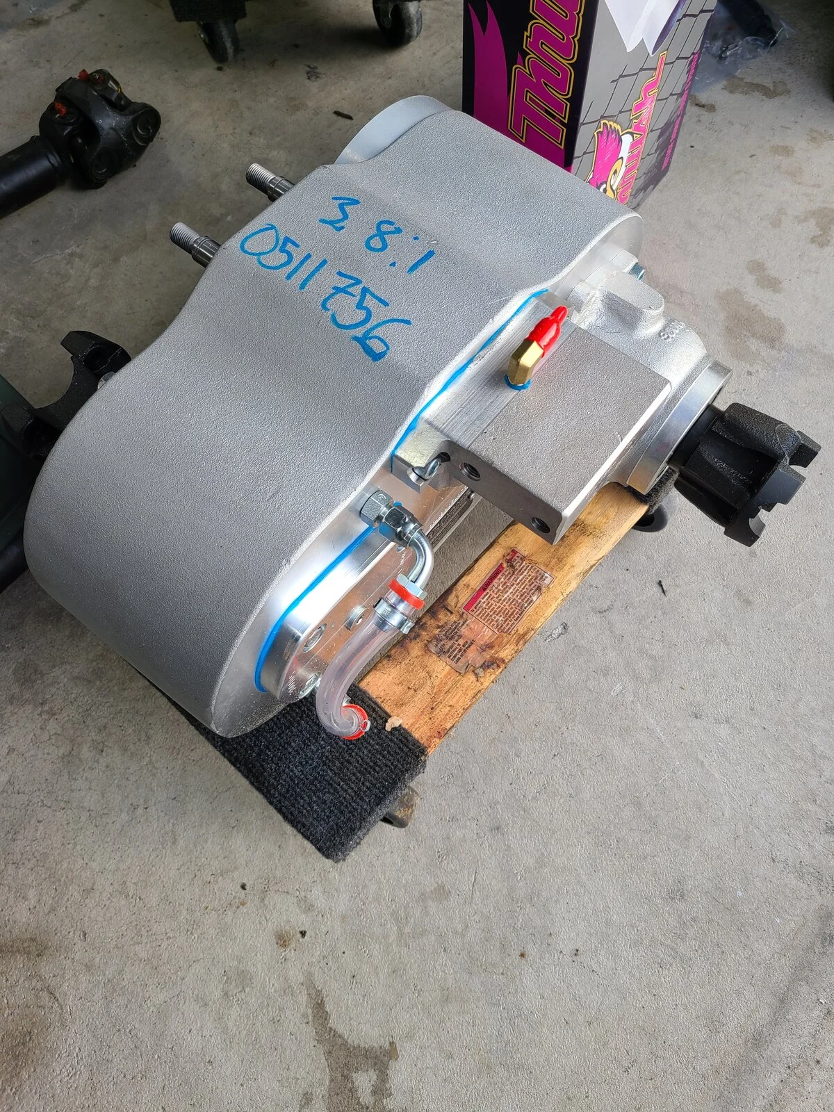

Atlas 3.8:1 showed up this week. Excited to get that under the Jeep. Not sure what degree I need to clock it at, so I'll leave it off the ass of the transmission and put them in one at a time.

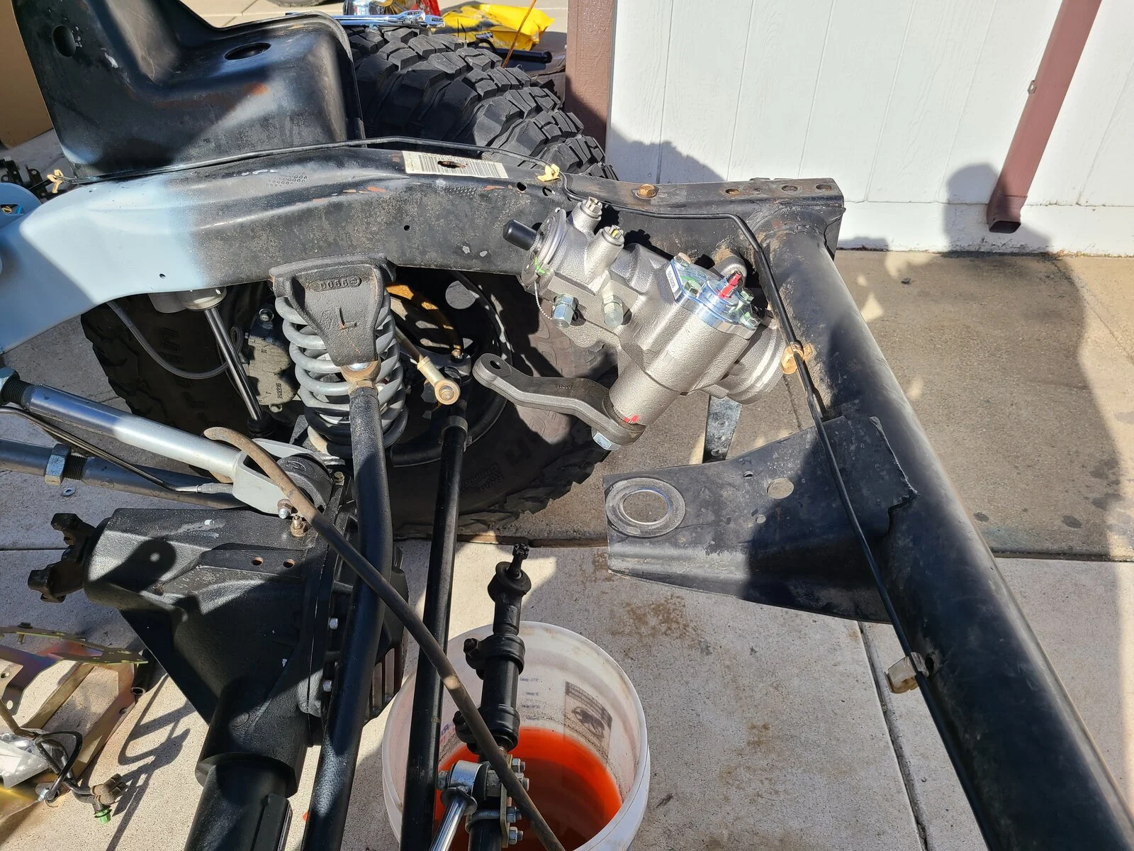

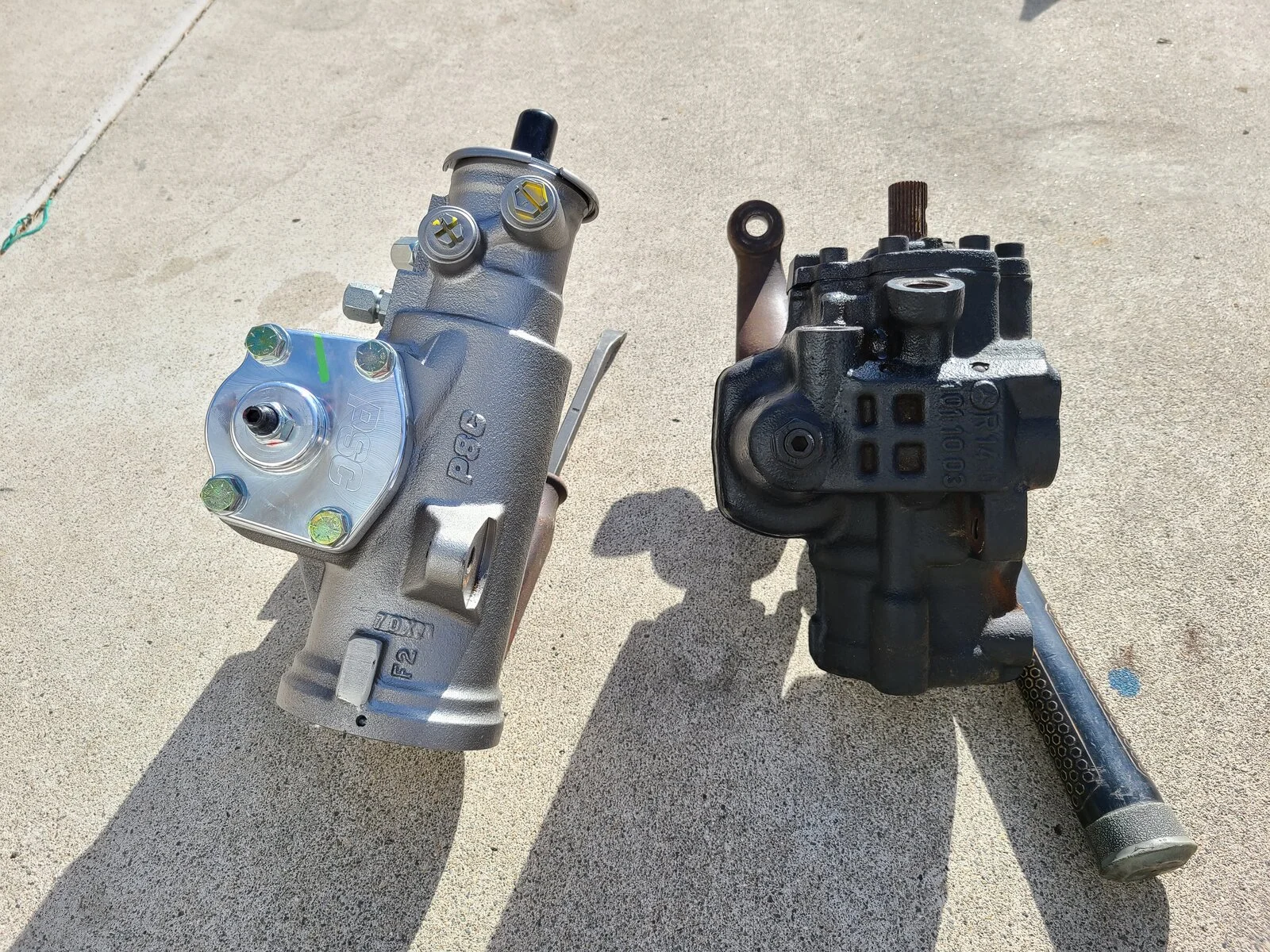

Got the PSC steering gear box installed. Check out the comparison between this one and OEM

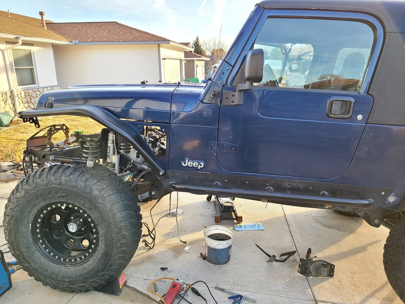

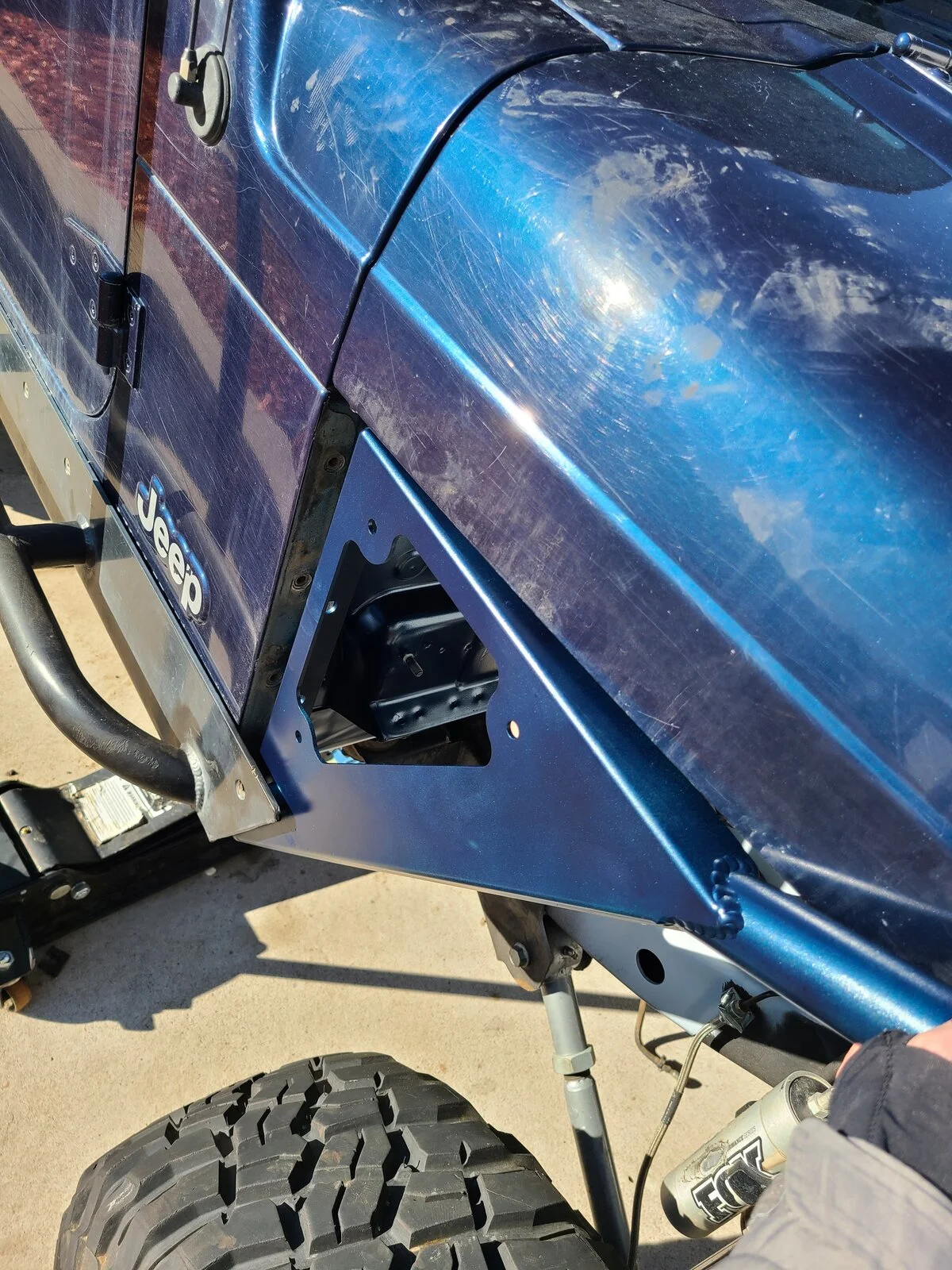

Got all the front fenders and flares painted over the week, as well as the new savvy front bumper. The fender color match is decent enough.

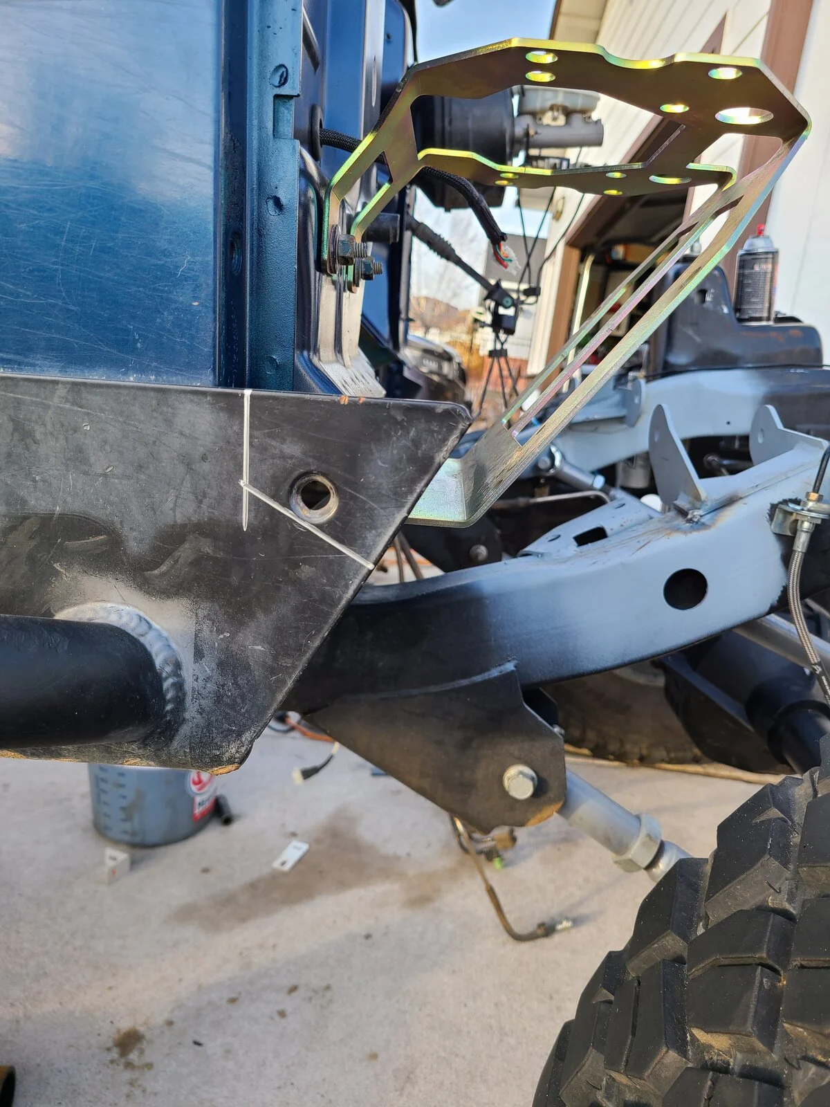

As you can see from above, I needed to trim the rockers to clear the nub for the front fender flares. I grabbed a square and sharpie and got to work
Sneak peek side view of metalcloak fenders
The rear corners are primed and ready to paint. I'm now debating whether I go color matched or stick with the satin black enamel. I'll get a couple weeks to decide that while I'm out of town.

Clock it as flat as you can. I should get brave and cut my tub and get my STaK's box a little flatter.

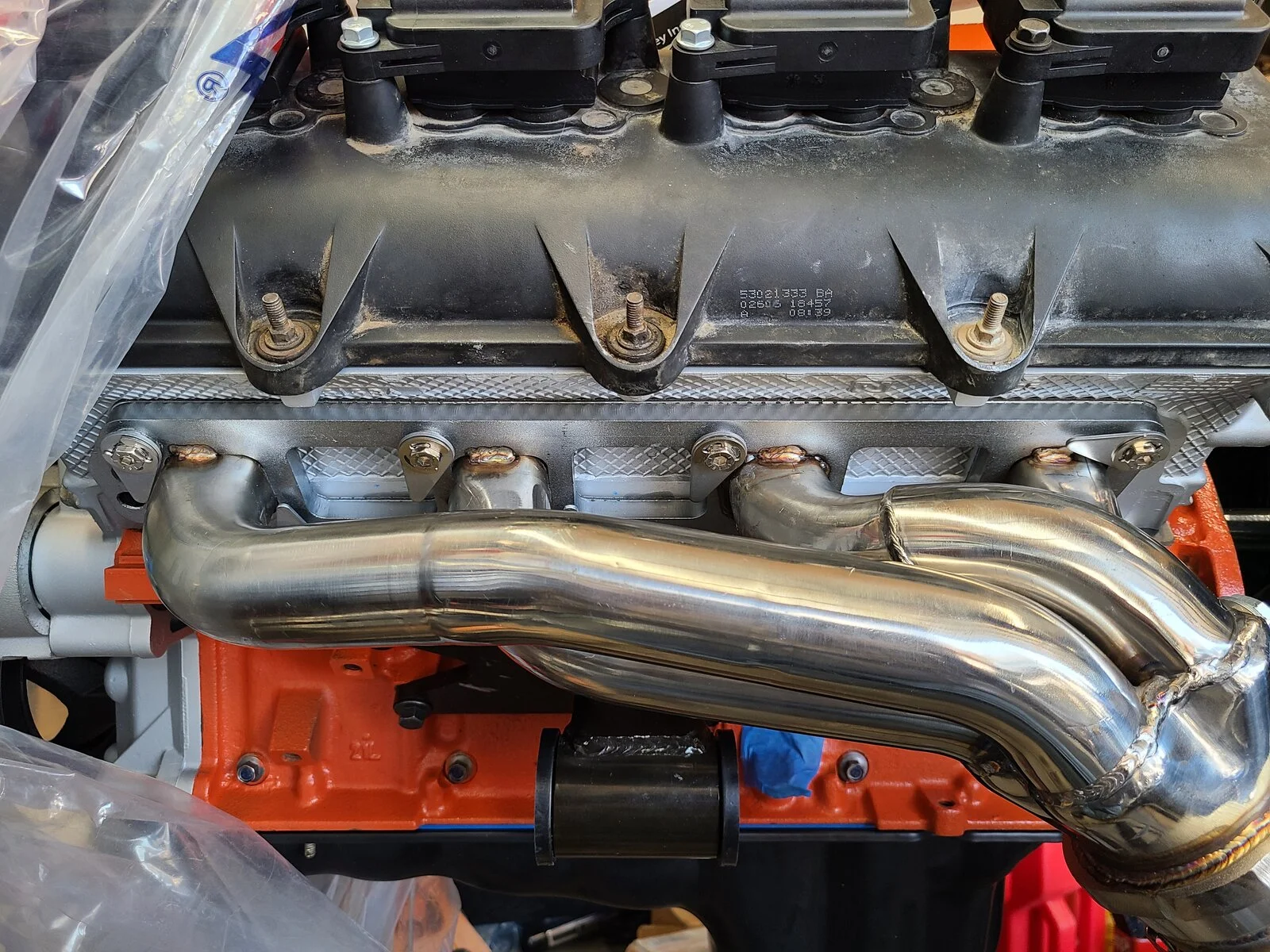

Did a once over to make sure all my bolts are right and tight. Installed stage 8 exhaust hardware due to the thinner castings of the aftermarket headers. Also got the dipstick tube put in and should be ready to drop between the rails for test fitting.

Decided to go color match on the side armor. Will go satin black on the rear aluminum fenders from Nemesis. Got the first few coats of paint on the corners.

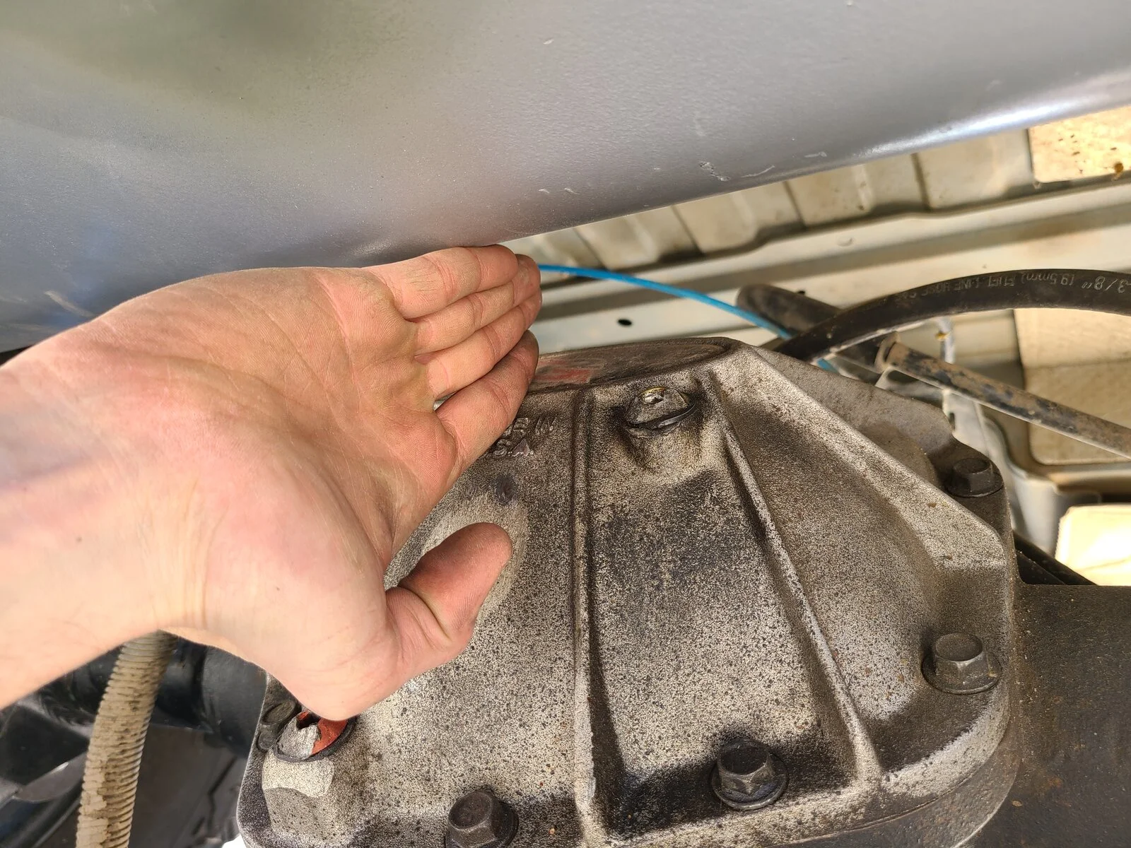

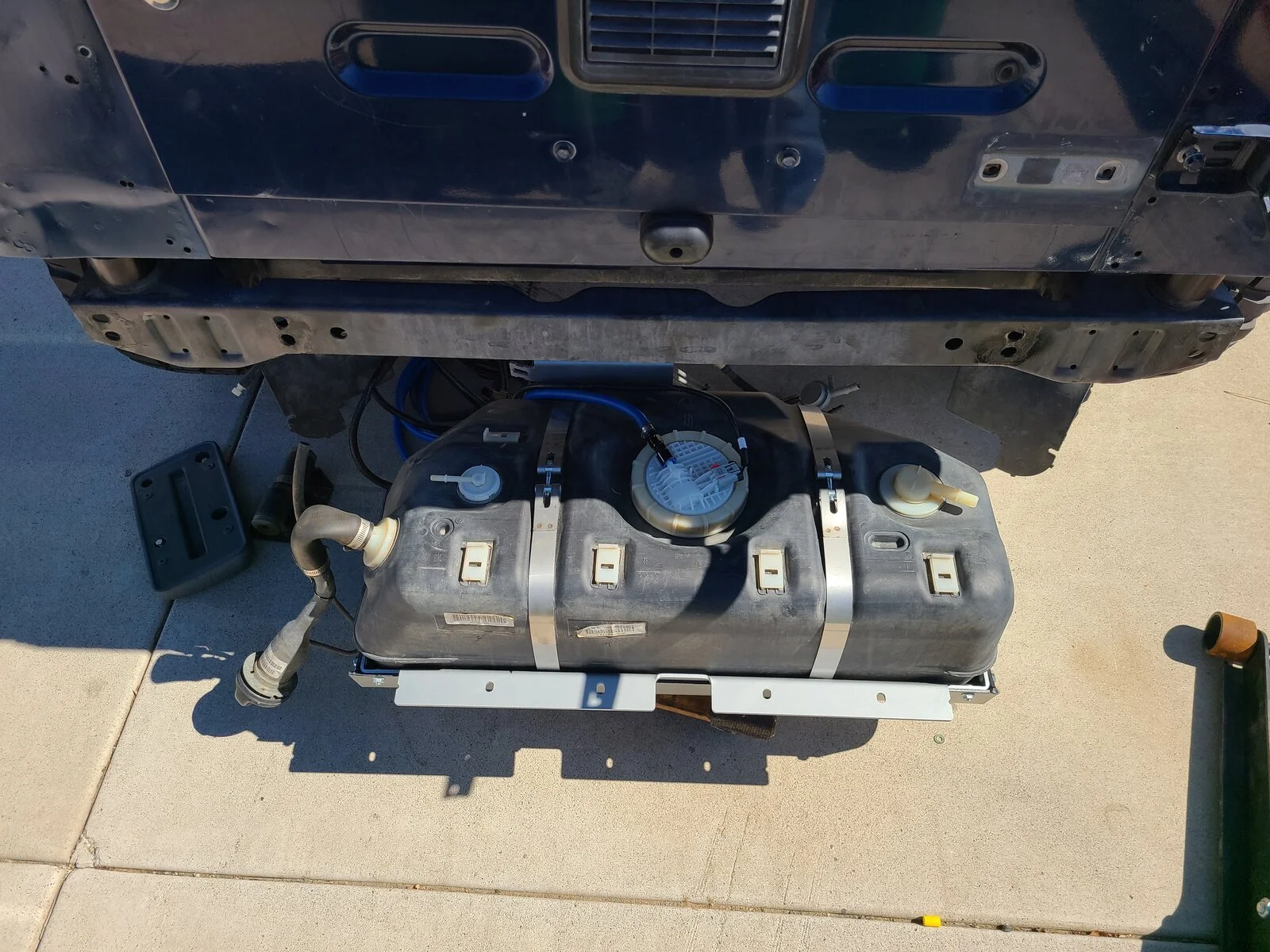

Finally got my savvy gas tank skid and gas tank installed. Fit up just fine without issue (was definitely tight up against the driver's side frame/bumper plate corner), and gave a fair amount more clearance from the rockjock 60 rear diff cover vs the oem skid. Hooked up and stashed the sub wiring harness and new fuel line, ready to snake that up to the engine bay and clean up all the electrical/air line spaghetti that is currently lining the frame rail. The skid is on the "high" setting.
Before: Oem skid
After: Savvy skid on "high" setting
What headers are these? Are the O-port or D-port?
