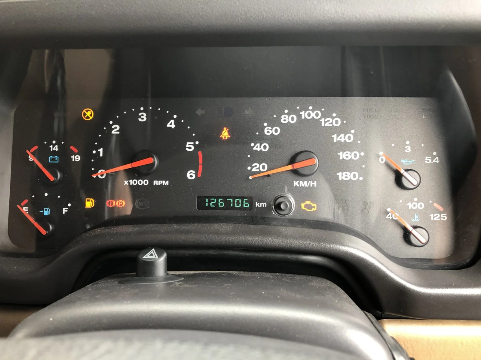

So a week ago I noticed a strange behavior. When I turned on my headlamps or the A/C, my gauges gone dead, the engine signal and the sentry key indicator lights were on. I also got a "no bus" signal.
when I turned off A/C or lights, the gauges became alive again, engine and key signals off instantly like magic.

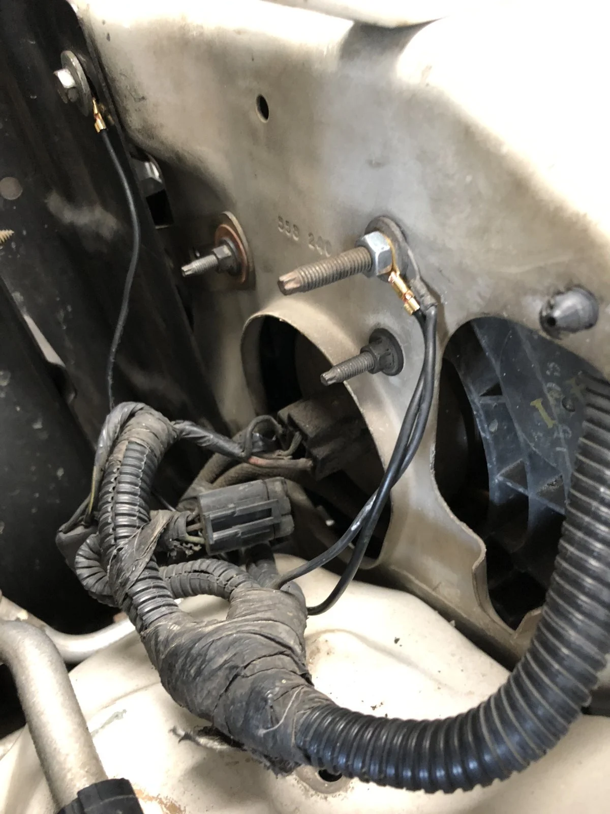

The Thai mechanic guy found the problem on the spot. These guys have lots of experience in off-road through the Jungles. He tighten the ground connection under the hood and added another ground connection to one of the headlamps.
No more dead gauges. Lights and A/C working fine, and this was the end of my "no bus" problem.
