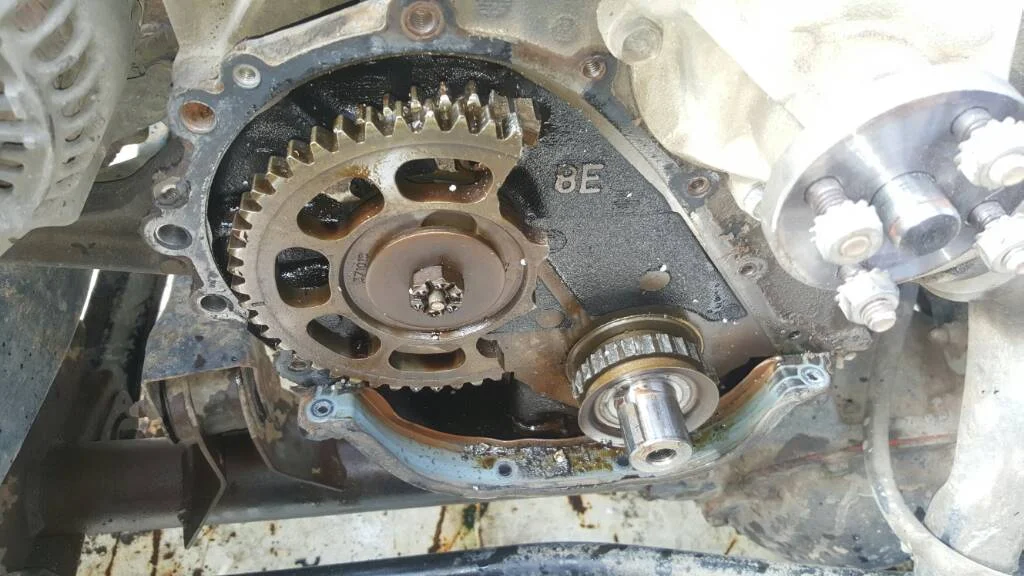

So this is where I'm at so far

Wow... Take the head off and see if there's any damage internally. You may be looking at a full rebuild.
